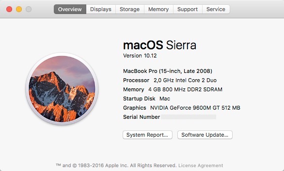

holyfield Posted October 24, 2016 Author Share Posted October 24, 2016 Sierra will boot with SMBIOS MBP5,1 once it's fully installed. I can vouch for that. That's what I use on my D630. Meantime, you may use MBP7,1 to install Sierra or complete your installation. Sierra is already installed on this laptop. I will test SMBIOS whan I have access to my desktop, to make sure that I can easily recover I something goes wrong Link to comment https://www.insanelymac.com/forum/topic/317116-no-usb2-slow-usb1-instead-of-usb2-on-ich9-hp-pavillion-dv7/#findComment-2305083 Share on other sites More sharing options...

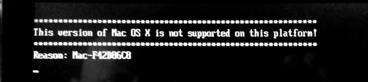

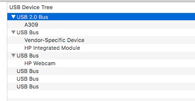

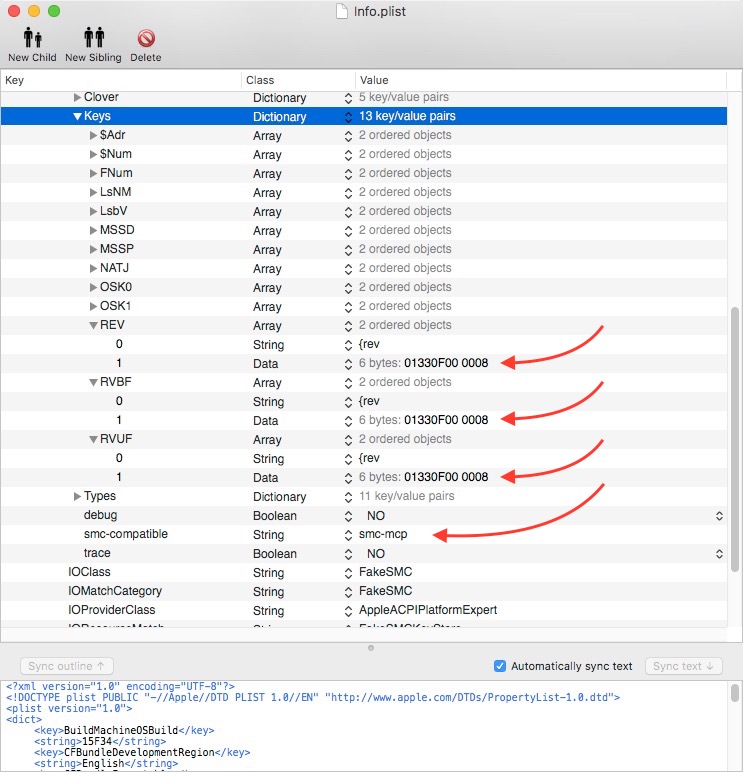

holyfield Posted October 26, 2016 Author Share Posted October 26, 2016 It's all explained in the article referenced in the link I posted. Thank you! I someone else who reads this thread and is also confused what shall be changed, then please check screenshot below: 1.33f8 = 01330F00 0008 REV, RVBF and RVUF and should be changes as I understand. I will test try now Sierra will boot with SMBIOS MBP5,1 once it's fully installed. I can vouch for that. That's what I use on my D630. I'm unable to boot MBP5,1 This version of Mac OS X is not supported on this platform Reason: Mac-F42D86C8 I managed to boot, I just needed to add -no_compat_check flag on Clover custom boot args. But still no luck with USB2, alll external ports are still USB1 instead of USB2. Link to comment https://www.insanelymac.com/forum/topic/317116-no-usb2-slow-usb1-instead-of-usb2-on-ich9-hp-pavillion-dv7/#findComment-2306832 Share on other sites More sharing options...

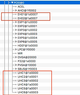

holyfield Posted October 27, 2016 Author Share Posted October 27, 2016 Hervé, thank you! In DSDT are deifined 2 EHCI and 6 UHCI devices. But why those 6 are UHCI if they under Linux and Windows act like USB2? If i connest on the left side USB port device, it appears under UHC6 and works like USB1. But under Linux and Windows it works like USB2. Link to comment https://www.insanelymac.com/forum/topic/317116-no-usb2-slow-usb1-instead-of-usb2-on-ich9-hp-pavillion-dv7/#findComment-2307255 Share on other sites More sharing options...

holyfield Posted October 28, 2016 Author Share Posted October 28, 2016 Ok, it seems like your USB controllers roots actually are UHC1 (@1D0000) and UHC4 (@1A0000). Here's a revised patched DSDT to try out. DSDT.aml.zip Great thank you! Which USBInjector I shall use? MBP5.1? O see you added hub on EHC? Device (EH02) { Name (_ADR, 0x001A0000) // _ADR: Address Name (_PRW, Package (0x02) // _PRW: Power Resources for Wake { 0x0E, Zero }) OperationRegion (USBR, PCI_Config, 0xC4, One) Field (USBR, AnyAcc, NoLock, Preserve) { URES, 8 } Method (_PSW, 1, NotSerialized) // _PSW: Power State Wake { If (Arg0) { Store (0x03, URES) } Else { Store (Zero, URES) } } Name (_S3D, 0x03) // _S3D: S3 Device State Name (_S4D, 0x03) // _S4D: S4 Device State Device (RHUB) { Name (_ADR, Zero) // _ADR: Address Device (PRT1) { Name (_ADR, One) // _ADR: Address Name (_UPC, Package (0x04) // _UPC: USB Port Capabilities { 0xFF, 0xFF, Zero, Zero }) Name (_PLD, Buffer (0x10) // _PLD: Physical Location of Device { 0x81, 0x00, 0x30, 0x00 }) } Device (PRT2) { Name (_ADR, 0x02) // _ADR: Address Name (_UPC, Package (0x04) // _UPC: USB Port Capabilities { 0xFF, 0xFF, Zero, Zero }) Name (_PLD, Buffer (0x10) // _PLD: Physical Location of Device { 0x81, 0x00, 0x30, 0x00 }) } } } Did you made any other patches on this DSDT too? Is it based on original or patched one? Link to comment https://www.insanelymac.com/forum/topic/317116-no-usb2-slow-usb1-instead-of-usb2-on-ich9-hp-pavillion-dv7/#findComment-2308506 Share on other sites More sharing options...

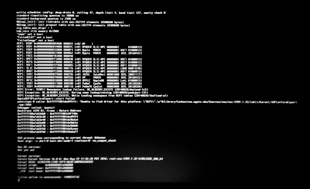

holyfield Posted October 28, 2016 Author Share Posted October 28, 2016 Use the same USBInjector I had posted (for MBP5,1). The patched DSDT is based on the raw/extracted/original one. I've only renamed UHC1 to EH01 and UHC4 to EH02. Thank you! Seems that something is wrong. I have panic with this DSDT. Link to comment https://www.insanelymac.com/forum/topic/317116-no-usb2-slow-usb1-instead-of-usb2-on-ich9-hp-pavillion-dv7/#findComment-2308572 Share on other sites More sharing options...
