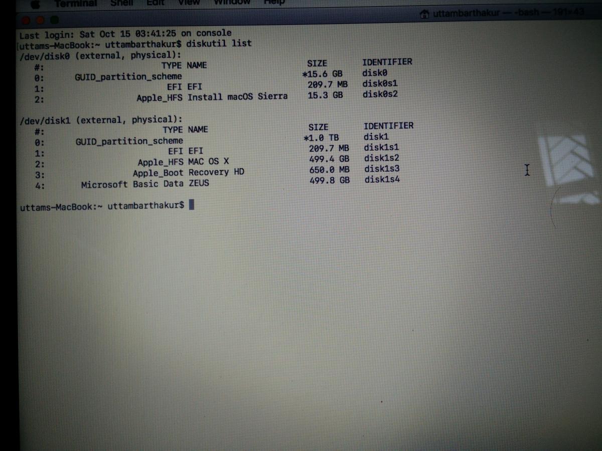

michaelspeed Posted October 15, 2016 Author Share Posted October 15, 2016 Is the hfs.efi in your clover / drivers64 folder? Sent from my SM-G900I using Tapatalk Nevermind I see that it is. Sent from my SM-G900I using Tapatalk I have HFSPlus.efi in Drive64UEFI. although the HDD came with Ubuntu installed. i have not formated it. Diskutil list also does not show the HDD Link to comment https://www.insanelymac.com/forum/topic/316845-help-dell-15-5559-sierra-installation/#findComment-2300098 Share on other sites More sharing options...

michaelspeed Posted October 15, 2016 Author Share Posted October 15, 2016 Have you got another hdd to test? Sent from my SM-G900I using Tapatalk external HDD detected, but no internal HDD Have you tried without SATA-100-series-unsupported.kext? And you dont need kexts in 10.12 and other folder. where do i put the kext? in the others or in the 10.12? Have you tried without SATA-100-series-unsupported.kext? And you dont need kexts in 10.12 and other folder. remove the SATA-100-series kext but still no HDD Link to comment https://www.insanelymac.com/forum/topic/316845-help-dell-15-5559-sierra-installation/#findComment-2300125 Share on other sites More sharing options...

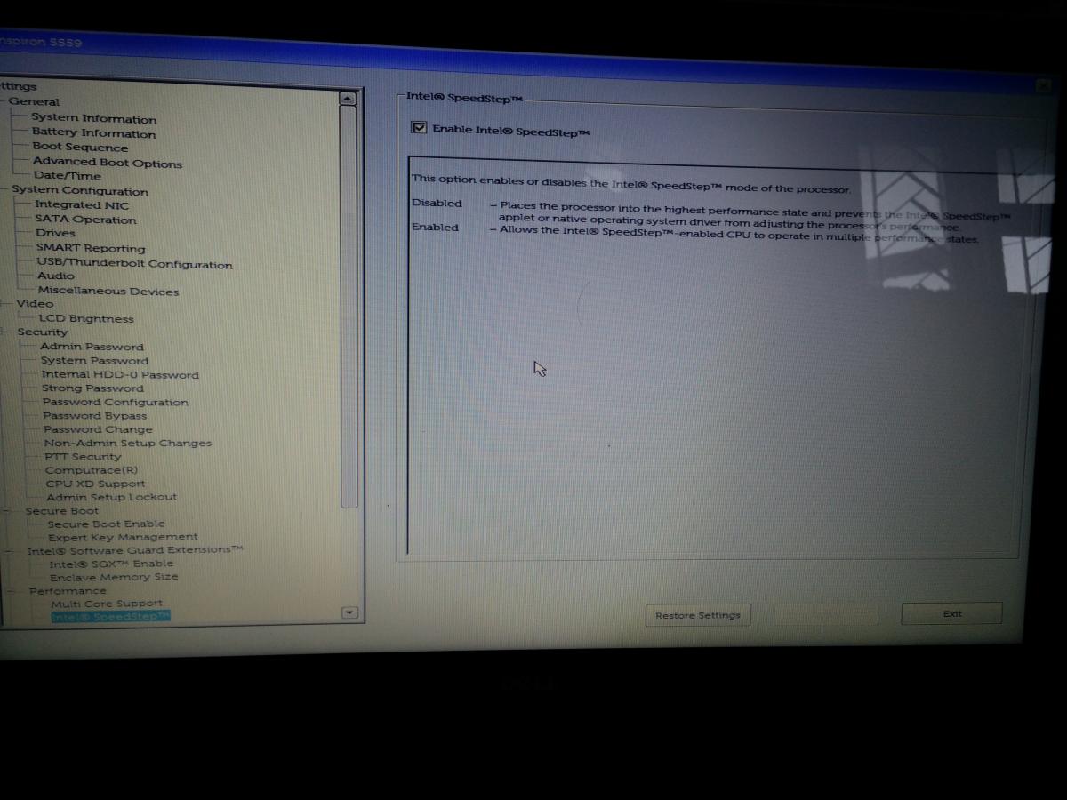

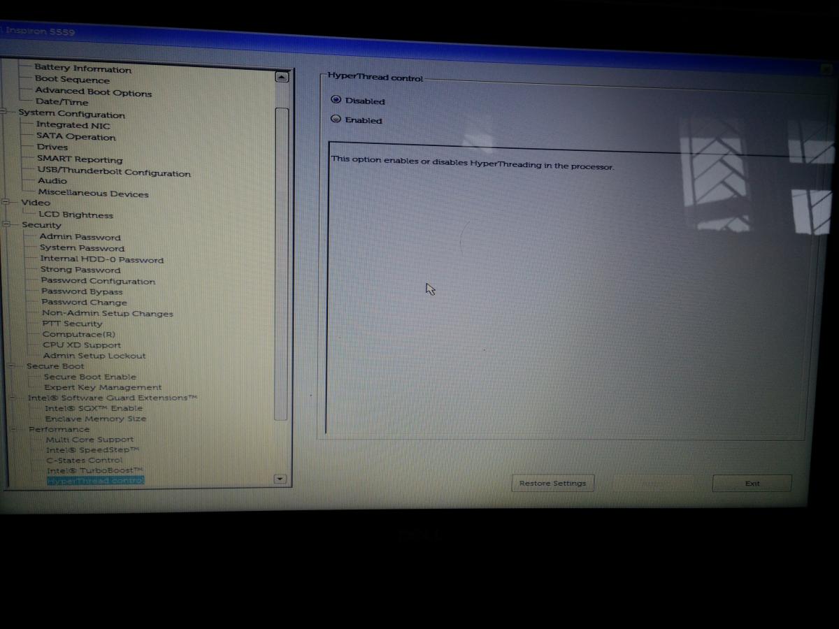

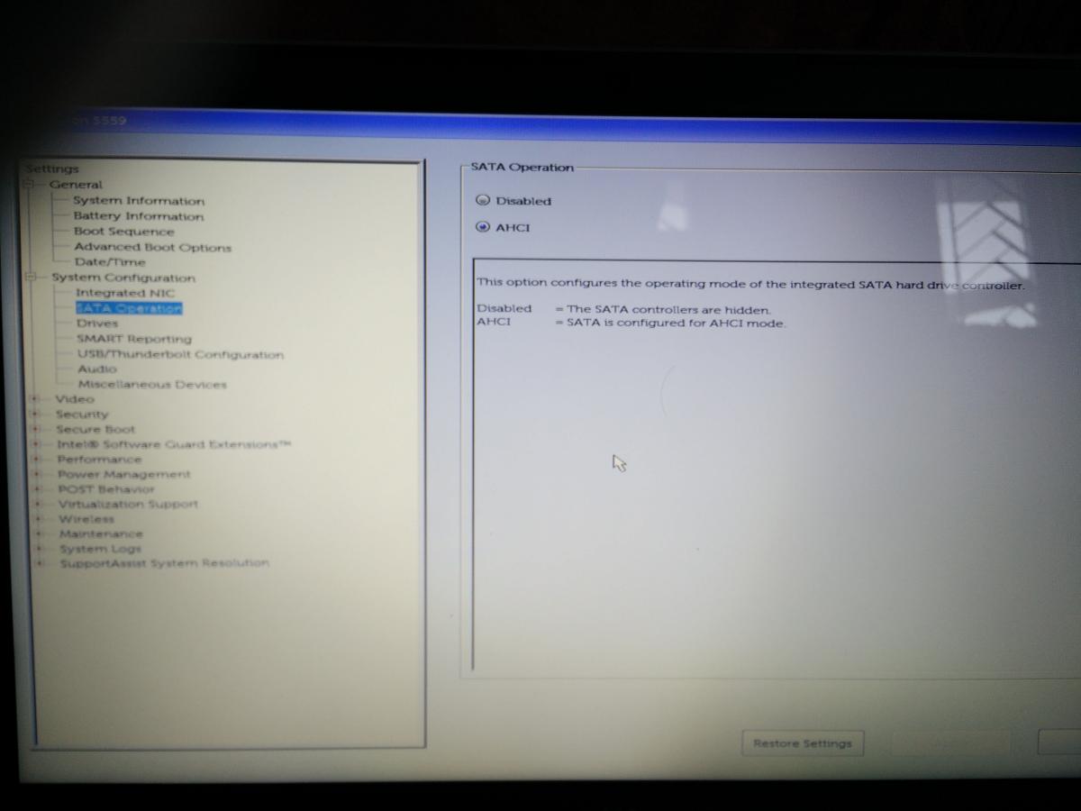

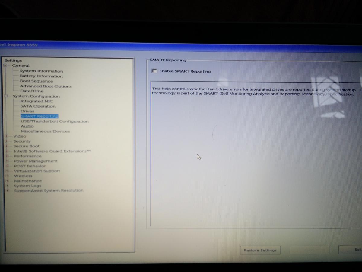

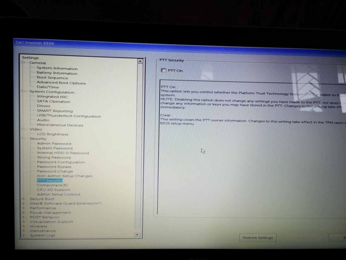

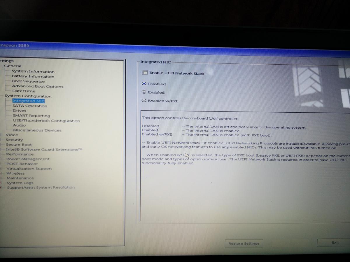

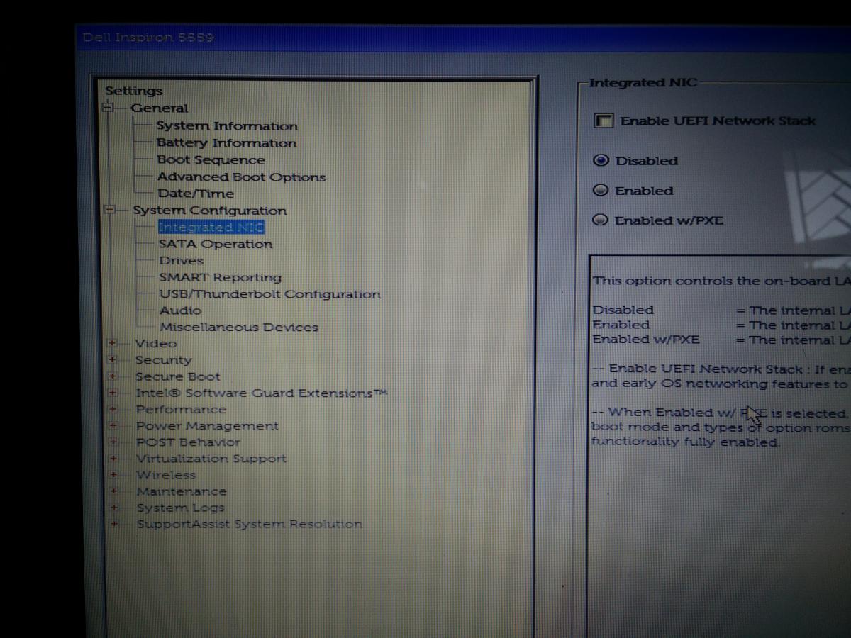

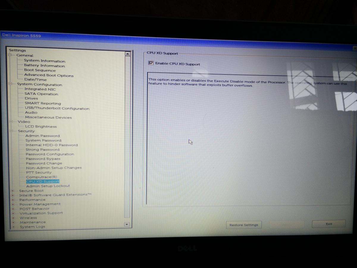

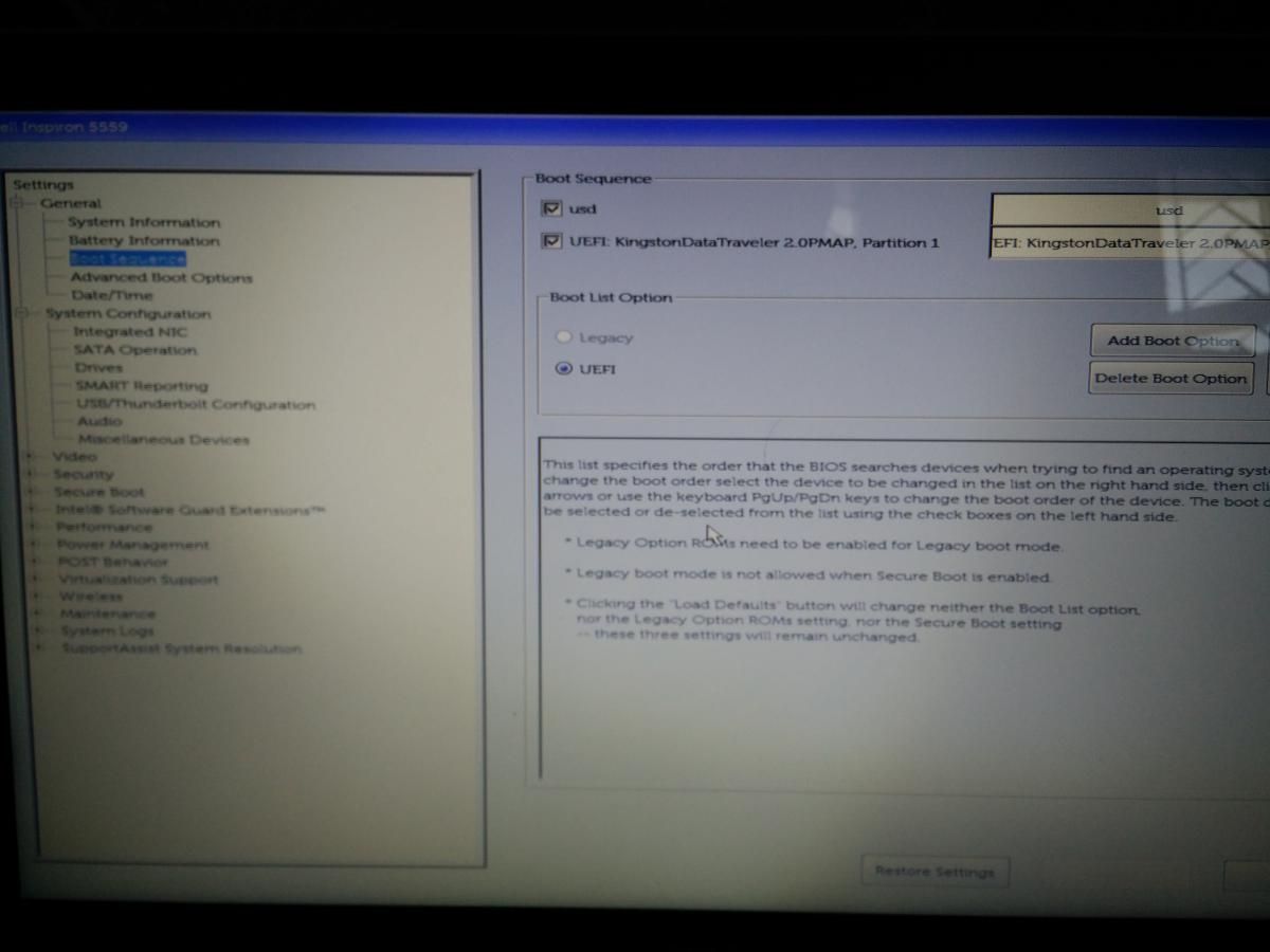

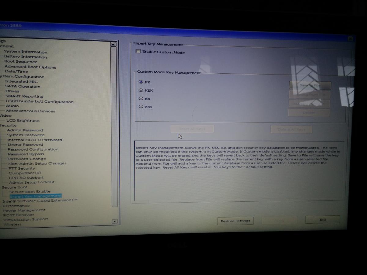

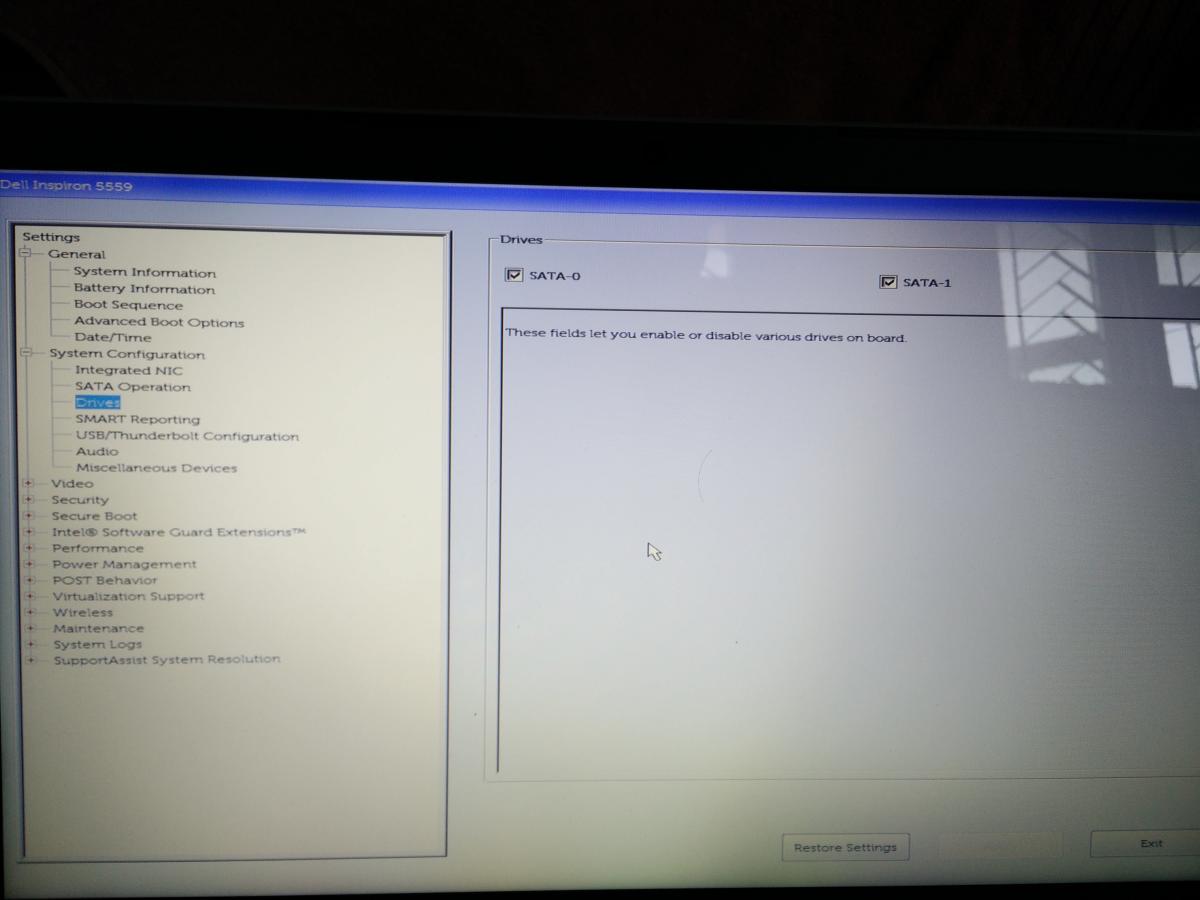

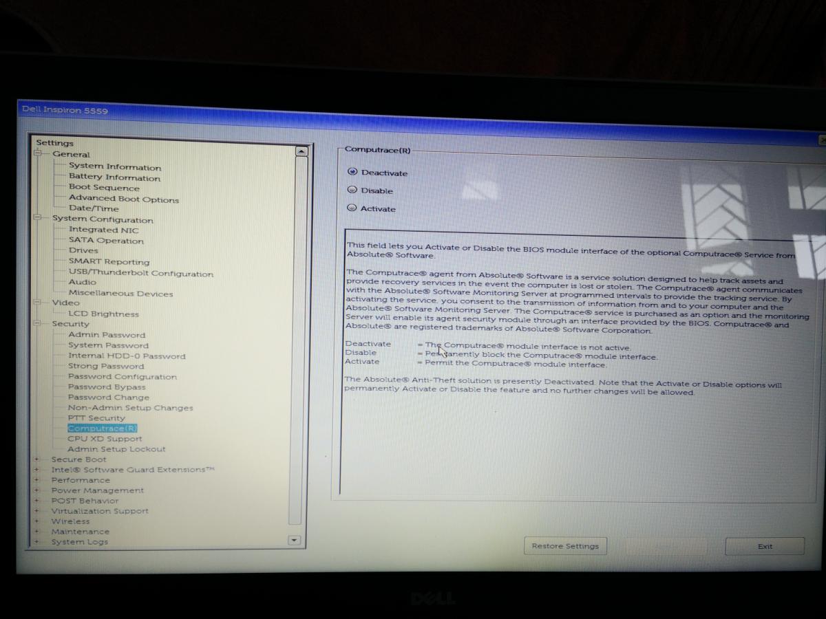

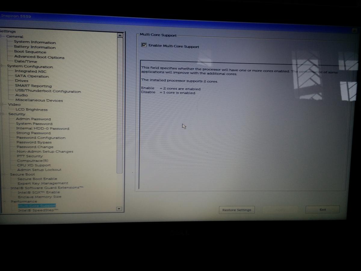

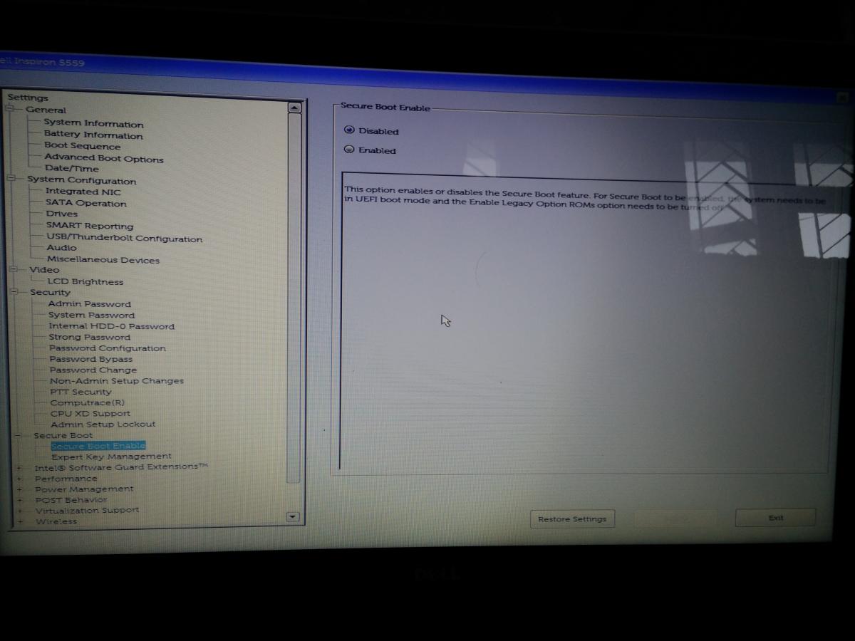

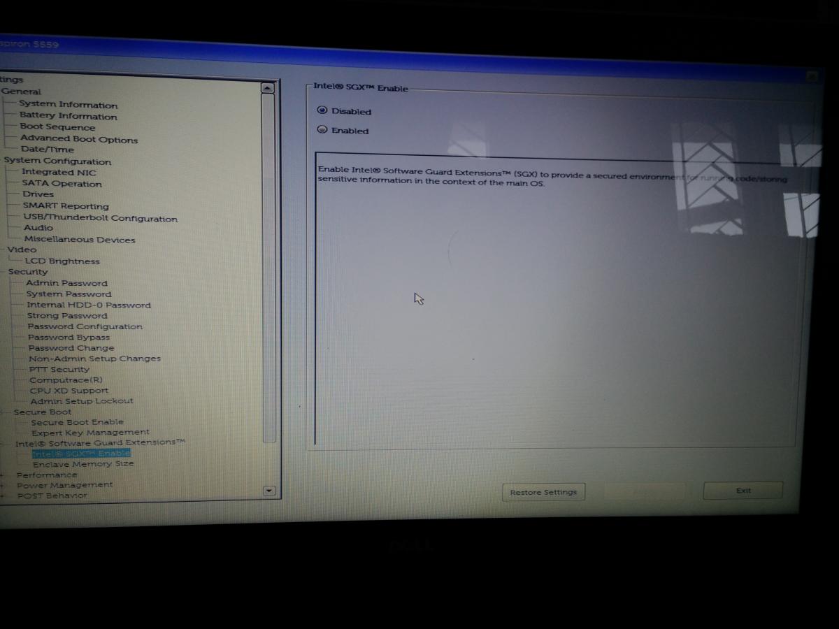

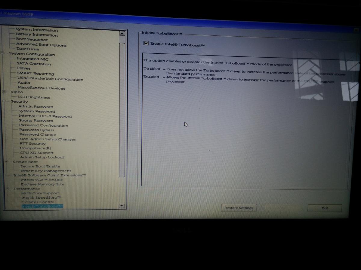

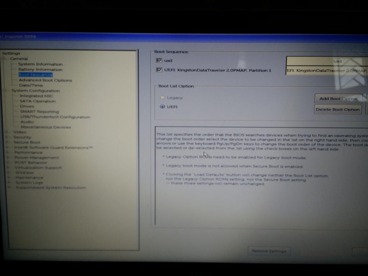

SavageAUS Posted October 15, 2016 Share Posted October 15, 2016 Can you post screen shots of all bios pages plz. Sent from my SM-G900I using Tapatalk Link to comment https://www.insanelymac.com/forum/topic/316845-help-dell-15-5559-sierra-installation/#findComment-2300185 Share on other sites More sharing options...
michaelspeed Posted October 15, 2016 Author Share Posted October 15, 2016 Can you post screen shots of all bios pages plz. Sent from my SM-G900I using Tapatalk here are the screen shots hello sure it don't work .. is old and don't have ur dev id try edit the injector and insert there ur dev id or try to use the fake id clover feature insert there 0x021E8086 <key>SATA</key> <string>0x25628086</string> good hack trying it now here are more hello sure it don't work .. is old and don't have ur dev id try edit the injector and insert there ur dev id or try to use the fake id clover feature insert there 0x021E8086 <key>SATA</key> <string>0x25628086</string> good hack this is not working, i put the kext in 10.12 folder Link to comment https://www.insanelymac.com/forum/topic/316845-help-dell-15-5559-sierra-installation/#findComment-2300206 Share on other sites More sharing options...

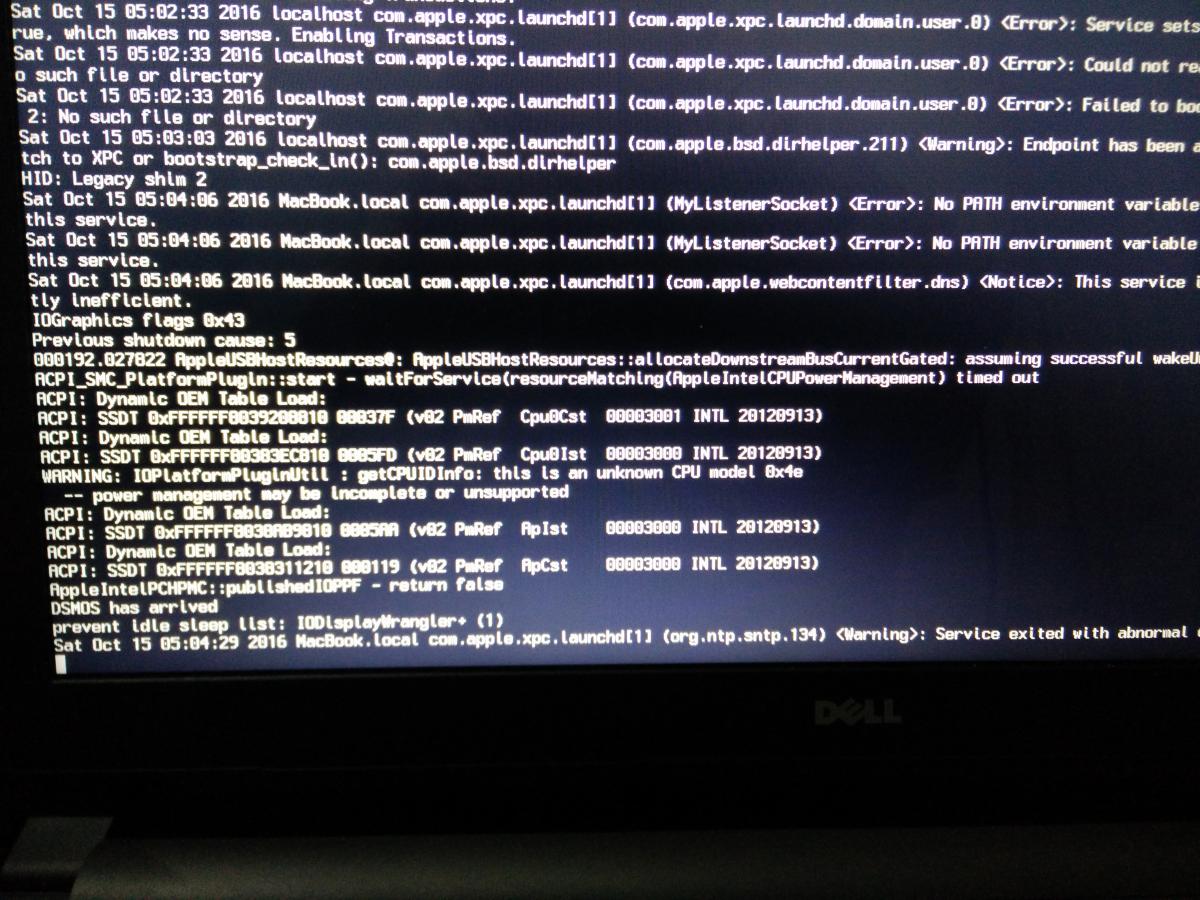

artur_pt Posted October 15, 2016 Share Posted October 15, 2016 hello try this config for sata config.plist.zip remove any injector in 10.12 good hack Link to comment https://www.insanelymac.com/forum/topic/316845-help-dell-15-5559-sierra-installation/#findComment-2300230 Share on other sites More sharing options...

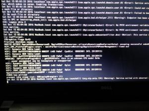

michaelspeed Posted October 15, 2016 Author Share Posted October 15, 2016 this is what it shows with the above code and the last line says service exited with abnormal code: 1 hangs there! no boot edit - usbinjectall is present. should i remove it to? here is an update it says Could not recover SATA after 5 attempts, terminating Link to comment https://www.insanelymac.com/forum/topic/316845-help-dell-15-5559-sierra-installation/#findComment-2300236 Share on other sites More sharing options...
