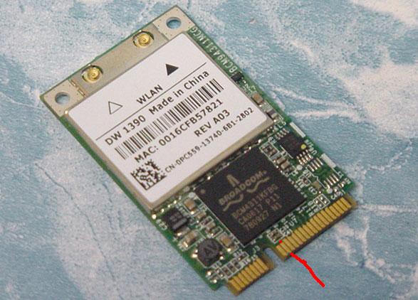

artur_pt Posted October 11, 2016 Share Posted October 11, 2016 hello try this one DSDT.zip if that don't work only remember this fix use tape to cover pin 20 good hack 1 Link to comment https://www.insanelymac.com/forum/topic/316639-atheros-ar9285-in-el-capitan-10116/#findComment-2297584 Share on other sites More sharing options...
