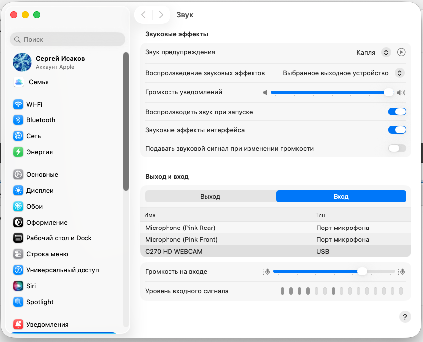

schrup21 Posted December 22, 2025 Share Posted December 22, 2025 (edited) @deeveedee I wish I hadn't overlooked your comment about the connection between AppleALC and VoodooHDA; it would have saved me my journey down the rabbit hole. 😅 I believed that using AppleALC together with VoodooHDA was causing my problem of the microphone not working, and therefore I wanted to find out the reason why VoodooHDA alone does not detect an audio device. This topic has become quite extensive, and although I enjoy reading up on it, I obviously hadn't found the right information (from you) regarding the potential conflict between VoodooHDA and AppleGFXHDA and its solution. I now understand that AppleALC only acts as a blocker in this scenario, and therefore its use in conjunction with VoodooHDA is perfectly suitable. My microphone works with reactivating AppleHDA, hence my question about whether this problem can be solved. I have a feeling VoodooHDA is detecting a wrong microphone, as it shows a "Microphone (Digital)" - but AppleHDA detects an "Internal Microphone". I get output with getdump but not if voodoohda detects no audiodevice.getdump_AppleALC.txt Edited December 22, 2025 by schrup21 1 1 Link to comment https://www.insanelymac.com/forum/topic/314406-voodoohda-3x/page/35/#findComment-2845309 Share on other sites More sharing options...
deeveedee Posted December 22, 2025 Share Posted December 22, 2025 (edited) @schrup21 I am not experienced with patching VoodooHDA.kext, but others in this thread are. The fact that your Mic works with AppleALC in macOS prior to Tahoe (and when you restore AppleHDA in Tahoe) should mean that you will be able to configure VoodooHDA to properly detect and activate your Mic. I wish I had more to offer. Patching VoodooHDA is something I want to learn, but I haven't studied it yet. Good luck! EDIT: I know you know this, but just so that others aren't confused when reading this post, VoodooHDA.kext and AppleALC.kext can coexist in Tahoe because Tahoe does not have AppleHDA and so AppleALC does not fully load (AppleALC renames HDAS->HDEF and blocks AppleGFXHDA, but that's it). Once AppleHDA is restored in Tahoe (using OCLP or similar patching technique), VoodooHDA and AppleALC cannot coexist in Tahoe. Edited December 22, 2025 by deeveedee 2 Link to comment https://www.insanelymac.com/forum/topic/314406-voodoohda-3x/page/35/#findComment-2845313 Share on other sites More sharing options...

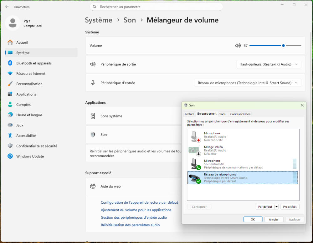

PG7 Posted January 24 Share Posted January 24 @Slice Hello team, I have a question: would the VoodooHDA.kext be compatible with the internal microphone of an All-in-One? Thanks for your answers. Spoiler codec0_dump.txt Link to comment https://www.insanelymac.com/forum/topic/314406-voodoohda-3x/page/35/#findComment-2846826 Share on other sites More sharing options...
schrup21 Posted January 25 Share Posted January 25 @PG7 Just give it a try, you've got nothing to lose 😉 My laptop's built-in microphone was recognized, but it didn't work. Perhaps further patches were needed... 1 Link to comment https://www.insanelymac.com/forum/topic/314406-voodoohda-3x/page/35/#findComment-2846831 Share on other sites More sharing options...
Slice Posted February 16 Author Share Posted February 16 Yes, some patches may be needed. Do a dump with VoodooHDA -> getdump and we will see what is wrong 2 Link to comment https://www.insanelymac.com/forum/topic/314406-voodoohda-3x/page/35/#findComment-2847432 Share on other sites More sharing options...

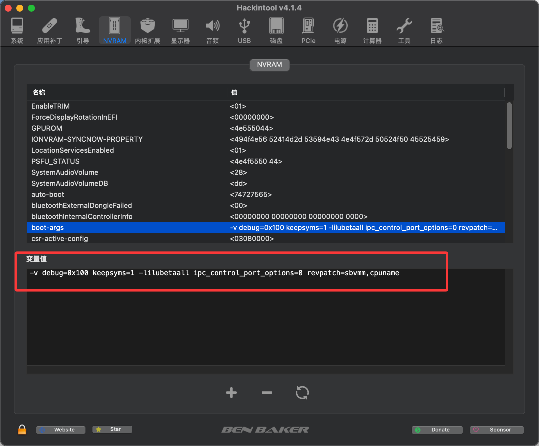

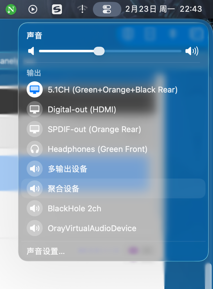

laobamac_yyds Posted February 23 Share Posted February 23 (edited) EDIT : Fortunately, VoodooHDA is an excellent project... My audio has been solved for the time being. But there is obvious noise and sound quality loss in my ALCS1220A... Alas... 2 minutes ago, MakAsrock said: Unfortunately, even -amfipassbeta doesn't help in my case. I immediately get a kernel panic. 🙁 Em? Strange. You use Clover? Normally saying just need shown in the figure (-lilubetaall and -amfipassbeta can be chosen, Lilu must be the latest development version) Edited February 23 by laobamac_yyds 3 Link to comment https://www.insanelymac.com/forum/topic/314406-voodoohda-3x/page/35/#findComment-2847687 Share on other sites More sharing options...
MakAsrock Posted February 23 Share Posted February 23 3 minutes ago, laobamac_yyds said: EDIT : Fortunately, VoodooHDA is an excellent project... My audio has been solved for the time being. But there is obvious noise and sound quality loss in my ALCS1220A... Alas... I have Realtek ALC897-I I have similar loss of sound quality and noise. For me, the sound through the built-in ALC897 codec is not important, since the monitor has a speaker output. 1 1 Link to comment https://www.insanelymac.com/forum/topic/314406-voodoohda-3x/page/35/#findComment-2847688 Share on other sites More sharing options...
laobamac_yyds Posted February 23 Share Posted February 23 Yes... Especially when playing low volume or bass/treble audio, there is an extremely obvious noise. I can only wait for Apple to release KDK as soon as possible, because I don't have monitor audio. 2 Link to comment https://www.insanelymac.com/forum/topic/314406-voodoohda-3x/page/35/#findComment-2847690 Share on other sites More sharing options...

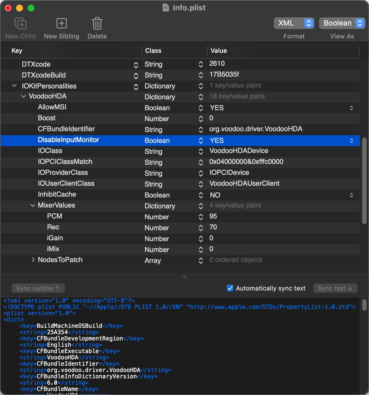

Slice Posted February 23 Author Share Posted February 23 1 hour ago, laobamac_yyds said: Yes... Especially when playing low volume or bass/treble audio, there is an extremely obvious noise. I can only wait for Apple to release KDK as soon as possible, because I don't have monitor audio. Check in VoodooHDA this line The InputMonitor may produce a noise. Also reduce Mixer values to 90-95. Value of 100 produces a noise. 3 hours ago, MakAsrock said: To prevent a potential null pointer dereference. This doesn't usually happen, but it can happen. I am waiting to see your find. 2 3 Link to comment https://www.insanelymac.com/forum/topic/314406-voodoohda-3x/page/35/#findComment-2847691 Share on other sites More sharing options...

laobamac_yyds Posted February 24 Share Posted February 24 Thanks @Slice! But there is no sound after this setting. The volume adjustment slider can be moved. 3 Link to comment https://www.insanelymac.com/forum/topic/314406-voodoohda-3x/page/35/#findComment-2847707 Share on other sites More sharing options...
Slice Posted February 24 Author Share Posted February 24 4 hours ago, laobamac_yyds said: Thanks @Slice! But there is no sound after this setting. The volume adjustment slider can be moved. Set also iMix to 95 2 Link to comment https://www.insanelymac.com/forum/topic/314406-voodoohda-3x/page/35/#findComment-2847715 Share on other sites More sharing options...
laobamac_yyds Posted February 24 Share Posted February 24 9 hours ago, Slice said: Set also iMix to 95 There is still no sound. 2 Link to comment https://www.insanelymac.com/forum/topic/314406-voodoohda-3x/page/35/#findComment-2847726 Share on other sites More sharing options...

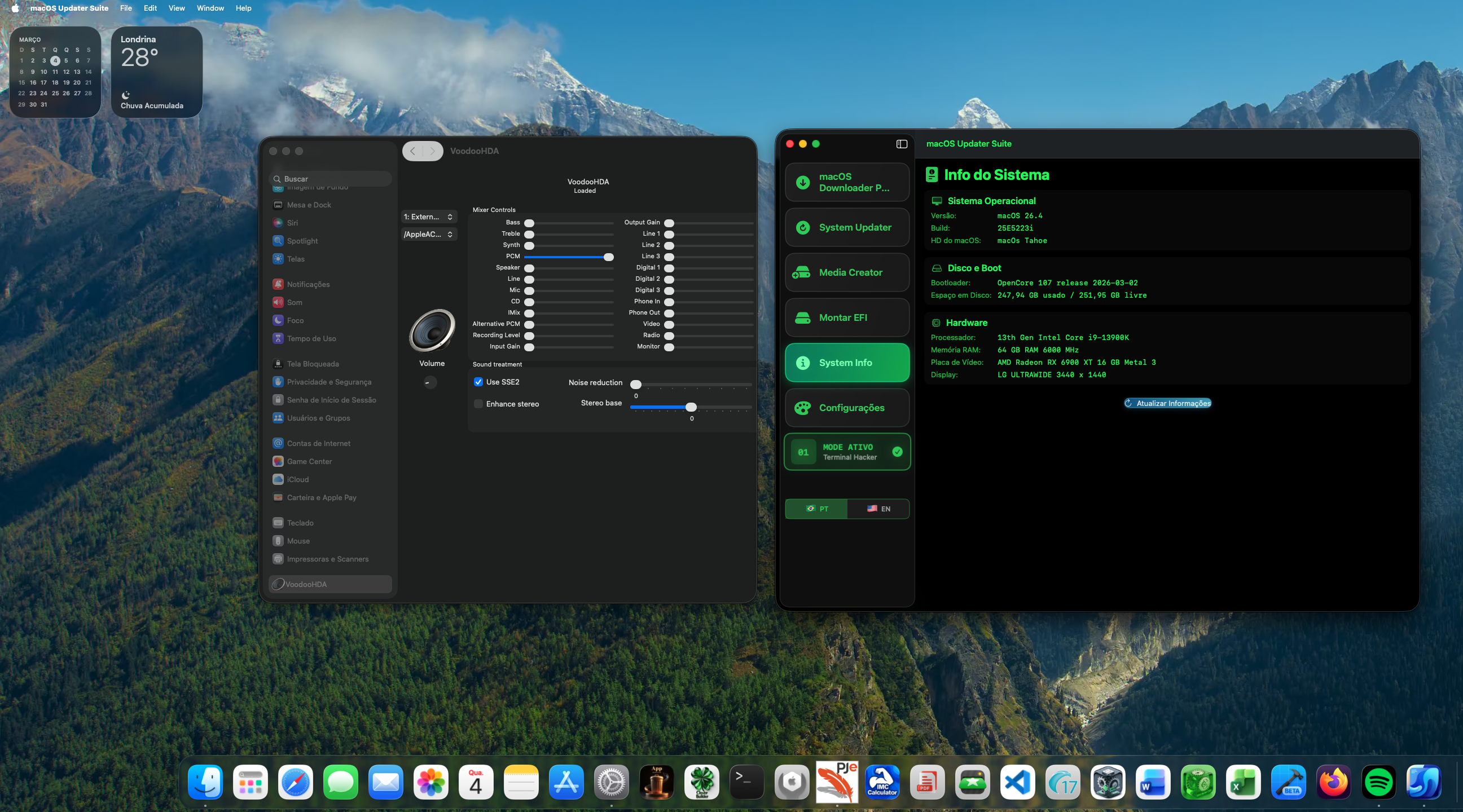

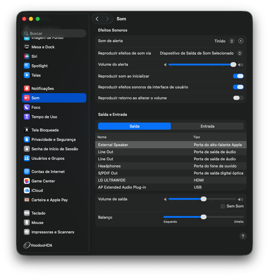

Slice Posted February 24 Author Share Posted February 24 14 minutes ago, laobamac_yyds said: There is still no sound. Look also for VoodooHDA.prefPane. Yes, it works even in Tahoe! Copy into /Library/PreferencePanes and double-click to install into System Settings. VoodooHDA.prefPane.zip 2 3 Link to comment https://www.insanelymac.com/forum/topic/314406-voodoohda-3x/page/35/#findComment-2847729 Share on other sites More sharing options...

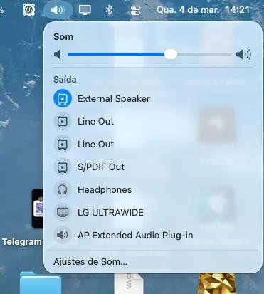

MaLd0n Posted March 4 Share Posted March 4 Very nice new things on VoodooHda. Thx to devs!!! https://github.com/CloverHackyColor/VoodooHDA/pull/10 https://github.com/rdmitry0911/VoodooHDA/commit/408152599f3d0ae5c17c69cb9562ab7aea12908f VoodooHDA.pkg.zip 5 2 Link to comment https://www.insanelymac.com/forum/topic/314406-voodoohda-3x/page/35/#findComment-2847911 Share on other sites More sharing options...

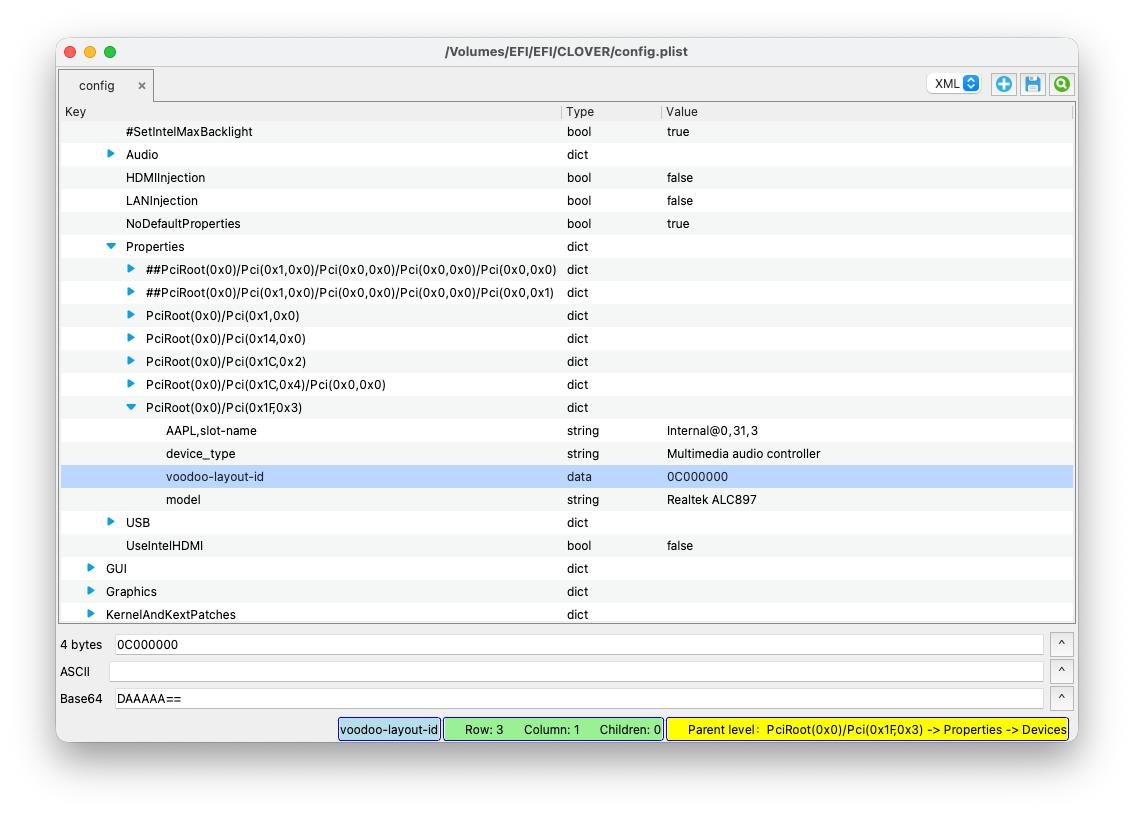

Max.1974 Posted March 4 Share Posted March 4 Works good and smooth my friends!!! Aproved!! Thanks @MaLd0n for send PM to test thanks all devs!! Don't forget to change name in Device Properties 2 Link to comment https://www.insanelymac.com/forum/topic/314406-voodoohda-3x/page/35/#findComment-2847915 Share on other sites More sharing options...
Pc Bacabal Posted March 4 Share Posted March 4 Work in OC too or only Clover? 1 Link to comment https://www.insanelymac.com/forum/topic/314406-voodoohda-3x/page/35/#findComment-2847916 Share on other sites More sharing options...
jlrycm Posted March 4 Share Posted March 4 1 hour ago, Pc Bacabal said: Work in OC too or only Clover? It should work in both OC and Clover 2 Link to comment https://www.insanelymac.com/forum/topic/314406-voodoohda-3x/page/35/#findComment-2847919 Share on other sites More sharing options...
Max.1974 Posted March 4 Share Posted March 4 1 hour ago, Pc Bacabal said: Work in OC too or only Clover? 46 minutes ago, jlrycm said: It should work in both OC and Clover Working good too on Opencore 4 Link to comment https://www.insanelymac.com/forum/topic/314406-voodoohda-3x/page/35/#findComment-2847920 Share on other sites More sharing options...

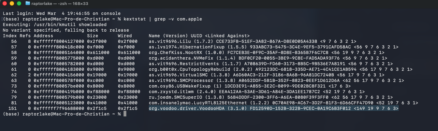

deeveedee Posted March 5 Share Posted March 5 (edited) On 3/4/2026 at 7:23 AM, MaLd0n said: Very nice new things on VoodooHda. Thx to devs!!! Generated with Claude Code? Very cool. Looking forward to testing. EDIT: Works very well! Auto-sensing of internal speaker / external headset works perfectly. Using with SIP csr-active-config = <01000000>. EDIT 2: I did not need to rename / change my "layout-id" property in DeviceProperties, since VoodooHDA.kext 3.1.0 is designed to "Read alc-layout-id (preferred) or layout-id from IORegistry". To install this new version, I did the following: Remove VoodooHDA.kext 3.0.3 from /Library/Extensions Relax SIP (csr-active-config) and reboot Install using VoodooHDA.pkg and reboot Restrict SIP (csr-active-config = <01000000>) Reboot and test Note that on first reboot following install, Volume in the menu bar showed the wrong output (headphones) even though audio played properly through speakers. A subsequent reboot fixed the Volume output icon. Edited March 5 by deeveedee 2 Link to comment https://www.insanelymac.com/forum/topic/314406-voodoohda-3x/page/35/#findComment-2847949 Share on other sites More sharing options...
jlrycm Posted March 6 Share Posted March 6 3 hours ago, deeveedee said: Generated with Claude Code? Very cool. Looking forward to testing. EDIT: Works very well! Auto-sensing of internal speaker / external headset works perfectly. Using with SIP csr-active-config = <01000000>. EDIT 2: I did not need to rename / change my "layout-id" property in DeviceProperties, since VoodooHDA.kext 3.1.0 is designed to "Read alc-layout-id (preferred) or layout-id from IORegistry". To install this new version, I did the following: Remove VoodooHDA.kext 3.0.3 from /Library/Extensions Relax SIP (csr-active-config) and reboot Install using VoodooHDA.pkg and reboot Restrict SIP (csr-active-config = <01000000>) Reboot and test Note that on first reboot following install, Volume in the menu bar showed the wrong output (headphones) even though audio played properly through speakers. A subsequent reboot fixed the Volume output icon. @deeveedee I thought I had to change csr to 03800000 to install the updated voodooHdA kext using the package that @MaLd0n shared above, but I forgot about it and tried to install it still having 01000000 and guess what? The new kext installed. 1 Link to comment https://www.insanelymac.com/forum/topic/314406-voodoohda-3x/page/35/#findComment-2847950 Share on other sites More sharing options...
LockDown Posted March 6 Share Posted March 6 (edited) 3 hours ago, deeveedee said: EDIT 2: I did not need to rename / change my "layout-id" property in DeviceProperties, since VoodooHDA.kext 3.1.0 is designed to "Read alc-layout-id (preferred) or layout-id from IORegistry". does this mean voodoohda will have an effect base on ID like AppleALC? Edited March 6 by LockDown Link to comment https://www.insanelymac.com/forum/topic/314406-voodoohda-3x/page/35/#findComment-2847951 Share on other sites More sharing options...
deeveedee Posted March 6 Share Posted March 6 (edited) 10 hours ago, jlrycm said: @deeveedee I thought I had to change csr to 03800000 to install the updated voodooHdA kext using the package that @MaLd0n shared above, but I forgot about it and tried to install it still having 01000000 and guess what? The new kext installed. Good observation! That should be the case if you install the new VoodooHDA.kext if you haven't rebooted after removing the old VoodooHDA.kext from /Library/Extensions. New installations of VoodooHDA.kext 3.1.0 will need relaxed SIP for the initial installation. 10 hours ago, LockDown said: does this mean voodoohda will have an effect base on ID like AppleALC? I'm not sure what you mean by "effect base on ID". I got the impression that if you already have the id configured for AppleALC, you don't need to change it for VoodooHDA 3.1.0. Edited March 6 by deeveedee 1 Link to comment https://www.insanelymac.com/forum/topic/314406-voodoohda-3x/page/35/#findComment-2847960 Share on other sites More sharing options...
