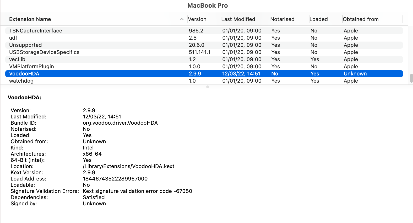

Slice Posted March 9, 2022 Author Share Posted March 9, 2022 1 hour ago, tmbt said: Hi Slice, i need your help to make VoodooHDA works. I have completely disabled SIP and copied the kext under /L/E. As you instructed after copied i got the warning from gatekeeper. I allowed the kext and after rebuilded the kernel cache the system rebooted. After that i can see VoodooHDA kext is loaded : mattia@Mattias-MacBook-Pro Extensions % kextstat | grep "Voodoo" Executing: /usr/bin/kmutil showloaded No variant specified, falling back to release 57 1 0 0x10000 0x10000 com.alexandred.VoodooI2CServices (1) 0356C79E-A02A-3739-8E68-23CF331EF37F <5 3> 69 1 0 0x2c000 0x2c000 org.coolstar.VoodooGPIO (1.1) 374D4E1A-3F46-3BC6-A909-D8AD3916CF1D <13 6 5 3> 76 1 0 0x40000 0x40000 com.alexandred.VoodooI2C (2.7) 85063110-ECD0-3B21-B824-AF696ACEF9C1 <69 58 57 14 13 6 5 3 1> 108 0 0 0x39000 0x39000 com.alexandred.VoodooI2CHID (1) 60F63B3B-AE97-3268-A807-C11653ED4DE0 <76 58 13 6 5 3> 110 0 0 0x19000 0x19000 me.kishorprins.VoodooInput (1.1.3) F3F0AEF0-FA53-3E76-823F-C9151C2B4A2F <58 6 5 3> 126 0 0xffffff7f9cd4e000 0x25000 0x25000 org.voodoo.driver.VoodooHDA (2.9.8) F71FC261-CDDD-3A05-8F65-3CA686B808C4 <123 14 8 6 5 3> But even if the kext is loaded i don't have any output source to chose from (i have a laptop with ALC256). No speaker nor Headphone. What can i do to debug the problem ? Thanks Mattia P.S. I've tried 2.9.8 and 2.9.9 version. P.P.S. I've also tried the getdump utility but in terminal it doesn't give me any output : mattia@Mattias-MacBook-Pro Downloads % ./getdump mattia@Mattias-MacBook-Pro Downloads % I've also checked under System Report -> Software -> Extensions and VoodooHDA has Signature Validation Errors: Kext signature validation error code -67050 Show me the list of PCI devices or better IOReg. IORegistryExplorer2.app.zip Link to comment https://www.insanelymac.com/forum/topic/314406-voodoohda-312/page/24/#findComment-2777887 Share on other sites More sharing options...

tmbt Posted March 11, 2022 Share Posted March 11, 2022 49 minutes ago, Slice said: If so let us begin from initial. Are you able to load VoodooHDA to be in ioreg? Can you use getdump utility when the VoodooHDA is loaded? I've followed the steps in the first post. Copied the VoodooHDA kext under /L/E. When gatekeeper asked me to restart because there was a new Extension i did so and after the reboot i can see VoodooHDA.kext loaded: 126 0 0xffffff7f9cd4e000 0x25000 0x25000 org.voodoo.driver.VoodooHDA (2.9.8) F71FC261-CDDD-3A05-8F65-3CA686B808C4 <123 14 8 6 5 3> After that i tried to run getdump utility but the i got an empty output. I'm not sure what else to check apart the fact that the kext is loaded using kextstat Link to comment https://www.insanelymac.com/forum/topic/314406-voodoohda-312/page/24/#findComment-2778037 Share on other sites More sharing options...
Slice Posted March 12, 2022 Author Share Posted March 12, 2022 11 hours ago, tmbt said: I've followed the steps in the first post. Copied the VoodooHDA kext under /L/E. When gatekeeper asked me to restart because there was a new Extension i did so and after the reboot i can see VoodooHDA.kext loaded: 126 0 0xffffff7f9cd4e000 0x25000 0x25000 org.voodoo.driver.VoodooHDA (2.9.8) F71FC261-CDDD-3A05-8F65-3CA686B808C4 <123 14 8 6 5 3> After that i tried to run getdump utility but the i got an empty output. I'm not sure what else to check apart the fact that the kext is loaded using kextstat If kextstat said loaded then the kext is loaded and must be present in ioreg. What is csr-active value? Link to comment https://www.insanelymac.com/forum/topic/314406-voodoohda-312/page/24/#findComment-2778066 Share on other sites More sharing options...
tmbt Posted March 12, 2022 Share Posted March 12, 2022 (edited) 9 hours ago, Slice said: If kextstat said loaded then the kext is loaded and must be present in ioreg. What is csr-active value? I'm using OC The value in config.plist for csr-active-config is 85020000 UPDATE: I've also tried with a value to completely disable SIP. Here is the crsutil status output : System Integrity Protection status: unknown (Custom Configuration). Configuration: Apple Internal: disabled Kext Signing: disabled Filesystem Protections: disabled Debugging Restrictions: disabled DTrace Restrictions: disabled NVRAM Protections: disabled BaseSystem Verification: disabled And here is a screenshot : Edited March 12, 2022 by tmbt Link to comment https://www.insanelymac.com/forum/topic/314406-voodoohda-312/page/24/#findComment-2778092 Share on other sites More sharing options...

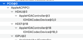

Bradamante Posted October 18, 2022 Share Posted October 18, 2022 (edited) Well, that might be a bit of a problem since the ALC3229 aka ALC282 is HDEF@1B and the HDMI audio is HDAU@3. Using OpenCore I can use AudioDxe to output the boot chime on the internal speakers via HDEF. So I guess I have to use AppleHDADisabler? How can I make sure that kexts are loaded in the right order (HDADisabler first, I assume)? Is the VoodooHDA edit with "IOPCIPrimaryMatch" still the way to go? Should I do a DSDT patch like: Quote <dict> <key>Comment</key> <string>Rename HDEF to HDAS</string> <key>Find</key> <data> SERFRg== </data> <key>Replace</key> <data> SERBUw== </data> </dict> Edited October 18, 2022 by Bradamante Link to comment https://www.insanelymac.com/forum/topic/314406-voodoohda-312/page/24/#findComment-2795445 Share on other sites More sharing options...
