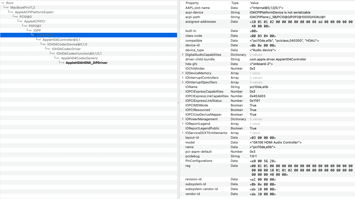

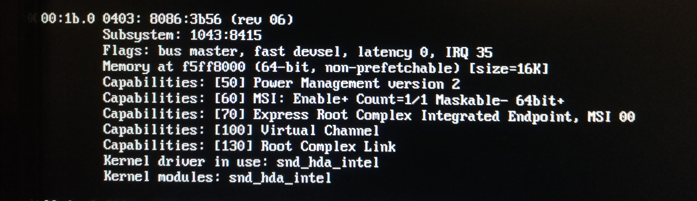

Hello,
can somebody look at my IOReg file for P7H55M-LX mainboard with VT1708S audio codec?
I have migrated Big Sur 11.7.2 to OpenCored 0.8.7 and try to enable sound but with no success as of this moment (otherwise system runs fine).
In ioregExplorer I  do not see any of HDAU, HDAS, HDEF devices and perhaps the problem is hidden there and I have not idea where to start look for the problem.
BIOS has two options for audio AC97 and HD Audio, when I found that there's no HD* device a thought that it might be BIOS setting causing the issue. I've attempted to change audio settings to AC97 option and the outcome is the same.
If I boot live Knoppix sound works fine, if I boot Catalina (Clover and other HDD) sound works fine.
in OpenCore config.plist csr-active-config set to 030A0000
(Note read through this group and seen values 0x0285, 0x0A03, 0x0864 -- which one is a correct one for most recent Big Sur)
Further investigation lead me to believe that audio device present and reported with gfxutil and ioregexplorer as following and not assigned HDAU, HDAS, HDEF
AppleACPIPlatformExpert->PCI0@0->AppleACPIPCI->pci8086,3b56@1B
00:1b.0 8086:3b56 /PCI0@0/pci8086,3b56@1B = PciRoot(0x0)/Pci(0x1B,0x0)
I assume that in Clover boot loader terms I need to fix DSDT FixMask (Fix_DTGP, Fix_HDA or AddDTGP_0001,FixHDA_8000)
https://sourceforge.net/p/cloverefiboot/wiki/ACPI/#dsdt-fixmask
OpenCore documentation has section related to Clover config conversion. Unfortunately the section of my interest only mention that required DSDT bits taken care by AppleALC which not applicable in this particular case as AppleALC does not support VT1708S chip
https://dortania.github.io/OpenCore-Install-Guide/clover-conversion/Clover-config.html
I am looking for a guidance what further steps to take to uncover mystery why VoodooHDA.kext 3.0.2 does not work in Big Sur 11.7.2.
Your assistance greatly appreciate,
osx151212
P7H55M-LX_AC97_BS_1172.ioreg
Edited by osx151212

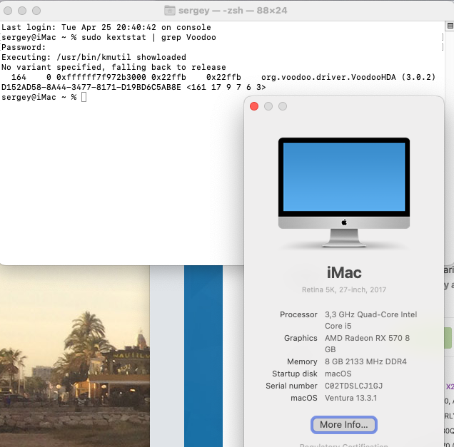

See my signature and this screen shot

Did you see a link in my signature? Did you follow the instructions exactly step by step without words like "I know better"?
I shown screenshot with working 3.0.2 in Ventura.

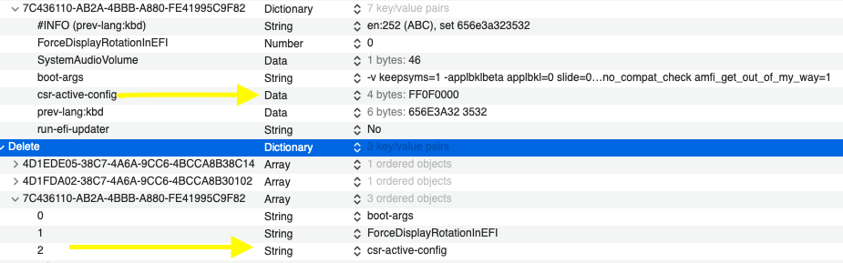

@slice,
The followed exactly the only thing is I am on Opencore v0.9.1 and set SIP to disable everything what do you mean Enable Restricted?  Is disabling SIP entirely will work for VoodooHDA or I have to make sure Set Restricted is Enabled?  Is Clover section RT Variables, CsrActiveConfig you set to 0x0285 do I need to set this exactly the same in Opencore?
1. Set restricted enabled SIP
            <key>CsrActiveConfig</key>
            <string>0x0285</string>
@Slice, SIP set to disable everything in Opencore including root so this is not the problem.  Maybe its not working with this Audio Card ALC282 in MacOS 13.2.1 VoodooHDA version 3.02 although only version VoodooHDA 2.9.8 is working for me  in Monterey and Ventura explain that??
I want to point out one more time using your signature link to install and setup v3.02, the only version that works for me is v2.9.8 so there is something going on with the new version in both Monterey and Ventura for ALC282.  My ALC282 is what I guess you call v2 or v3 of the ALC282 series since it is unique, it has Subwoofer and on its own channel.

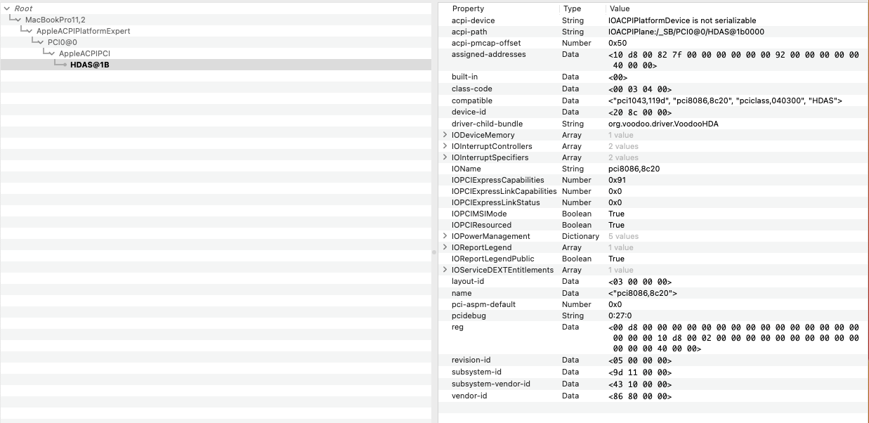

See last Screenshot I am fairly sure I have setup Nvram setting correctly in Opencore if anyone else using VoodooHDA v3.02 in Ventura with Opencore can comment?

With such csr-active-config <FF0F0000> you will have no updates so you will enable SIP back and then you'll loose VoodooHDA again.
There are no principal differences between 2.98 and 3.02. I just made secure fixes to kext no crash. I don't know why 2.98 is better for you. May be the difference is located in their Info.plists?
VoodooHDA works with all chips supporting HDA standard. All early ALC**, all Sigmatels, all Connexants and all future chips.
It will not support audio living with own standards like Creative or Aureal.

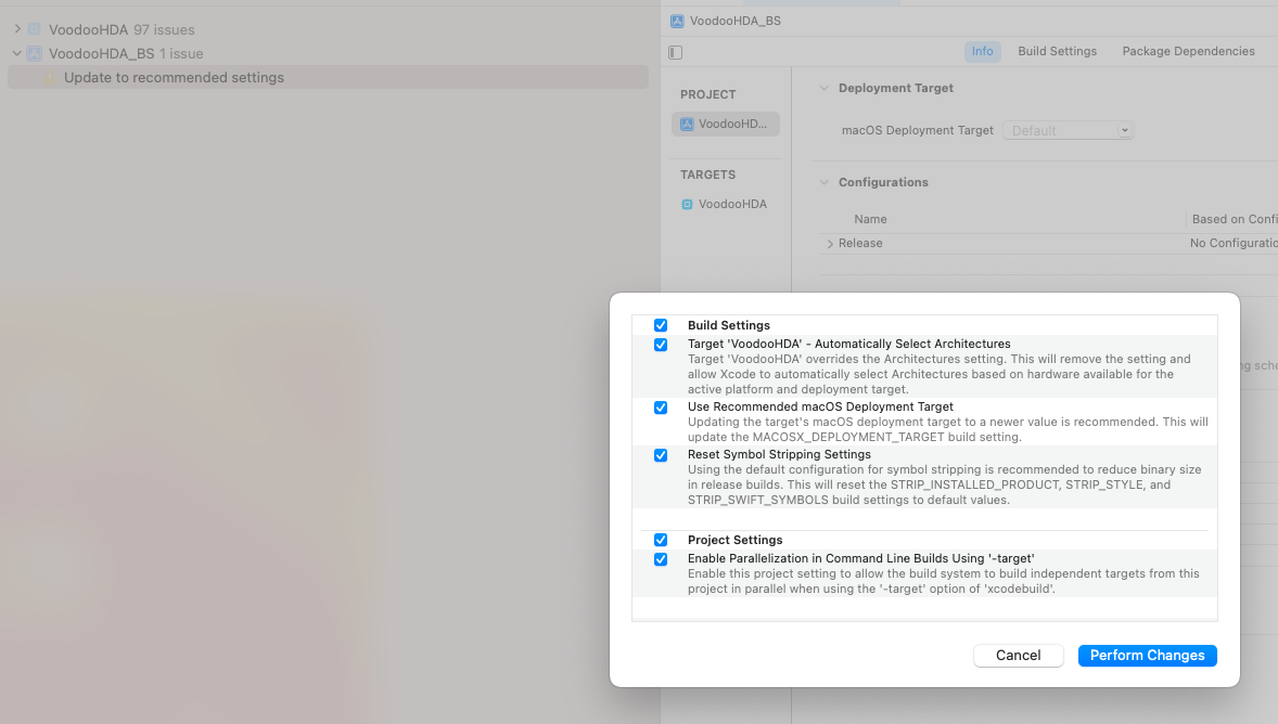

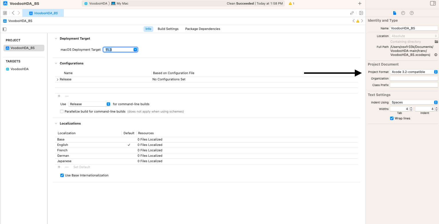

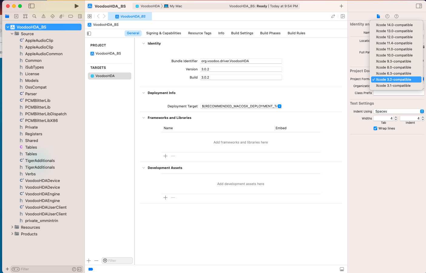

Do you leave the project format as default "xcode 3.2-Compatible" or drop down to version 14 then compile?  97 issues?  Also should I update to recommend setting?  See first screenshoit.
Edited by oSxFr33k

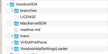

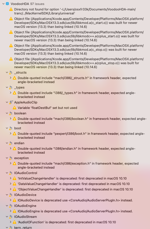

As I see MacKernelSDK is not found. See Readme again.
@Slice that symlink belongs under trunc no?  Below is in Readme, I went ahead and symlink to root instead.  Look the the log below a TON of deprecation.
cd /path_to/VoodooHDA/tranc/
ln -s /path_to/MacKernelSDK MacKernelSDK
Build Log
Showing Recent Issues
Build target VoodooHDA of project VoodooHDA_BS with configuration Release

/Users/osxfr33k/Documents/VoodooHDA-main/MacKernelSDK/Headers/IOKit/audio/IOAudioDevice.h:132:4: IOAudioDevice is deprecated use <CoreAudio/AudioServerPlugIn.h> instead.
/Users/osxfr33k/Documents/VoodooHDA-main/tranc/Parser.cpp:3055:52: Variable 'result' may be uninitialized when used here
/Users/osxfr33k/Documents/VoodooHDA-main/tranc/Parser.cpp:3282:23: Variable 'id' set but not used
/Users/osxfr33k/Documents/VoodooHDA-main/tranc/Parser.cpp:3468:21: Variable 'id' set but not used
/Users/osxfr33k/Documents/VoodooHDA-main/tranc/Parser.cpp:3790:9: Variable 'cmd' set but not used
CompileC /Users/osxfr33k/Library/Developer/Xcode/DerivedData/VoodooHDA_BS-dztogptxvqwestgaxhobuhfpymsp/Build/Intermediates.noindex/VoodooHDA_BS.build/Release/VoodooHDA.build/Objects-normal/x86_64/VoodooHDAEngine.o /Users/osxfr33k/Documents/VoodooHDA-main/tranc/VoodooHDAEngine.cpp normal x86_64 c++ com.apple.compilers.llvm.clang.1_0.compiler (in target 'VoodooHDA' from project 'VoodooHDA_BS')
    cd /Users/osxfr33k/Documents/VoodooHDA-main/tranc
    /Applications/Xcode.app/Contents/Developer/Toolchains/XcodeDefault.xctoolchain/usr/bin/clang -x c++ -ivfsstatcache /Users/osxfr33k/Library/Developer/Xcode/DerivedData/SDKStatCaches.noindex/macosx13.3-22E245-.sdkstatcache -target x86_64-apple-macos13.2 -fmessage-length\=0 -fdiagnostics-show-note-include-stack -fmacro-backtrace-limit\=0 -nostdinc -fno-builtin -Wno-trigraphs -fno-exceptions -fno-rtti -fno-sanitize\=vptr -Ofast -fno-common -mkernel -Wno-missing-field-initializers -Wno-missing-prototypes -Wunreachable-code -Wquoted-include-in-framework-header -Wno-non-virtual-dtor -Wno-overloaded-virtual -Wno-exit-time-destructors -Wno-missing-braces -Wparentheses -Wswitch -Wunused-function -Wunused-label -Wno-unused-parameter -Wunused-variable -Wunused-value -Wempty-body -Wuninitialized -Wno-unknown-pragmas -Wno-shadow -Wno-four-char-constants -Wno-conversion -Wconstant-conversion -Wint-conversion -Wbool-conversion -Wenum-conversion -Wno-float-conversion -Wnon-literal-null-conversion -Wobjc-literal-conversion -Wsign-compare -Wshorten-64-to-32 -Wno-newline-eof -Wno-c++11-extensions -Wno-implicit-fallthrough -DMULTICHANNEL -DKERNEL -DKERNEL_PRIVATE -DDRIVER_PRIVATE -DAPPLE -DNeXT -isysroot /Applications/Xcode.app/Contents/Developer/Platforms/MacOSX.platform/Developer/SDKs/MacOSX13.3.sdk -fapple-kext -fasm-blocks -fstrict-aliasing -Wdeprecated-declarations -Winvalid-offsetof -Wno-sign-conversion -Winfinite-recursion -Wmove -Wcomma -Wblock-capture-autoreleasing -Wstrict-prototypes -Wrange-loop-analysis -Wno-semicolon-before-method-body -iquote /Users/osxfr33k/Library/Developer/Xcode/DerivedData/VoodooHDA_BS-dztogptxvqwestgaxhobuhfpymsp/Build/Intermediates.noindex/VoodooHDA_BS.build/Release/VoodooHDA.build/VoodooHDA-generated-files.hmap -I/Users/osxfr33k/Library/Developer/Xcode/DerivedData/VoodooHDA_BS-dztogptxvqwestgaxhobuhfpymsp/Build/Intermediates.noindex/VoodooHDA_BS.build/Release/VoodooHDA.build/VoodooHDA-own-target-headers.hmap -I/Users/osxfr33k/Library/Developer/Xcode/DerivedData/VoodooHDA_BS-dztogptxvqwestgaxhobuhfpymsp/Build/Intermediates.noindex/VoodooHDA_BS.build/Release/VoodooHDA.build/VoodooHDA-all-target-headers.hmap -iquote /Users/osxfr33k/Library/Developer/Xcode/DerivedData/VoodooHDA_BS-dztogptxvqwestgaxhobuhfpymsp/Build/Intermediates.noindex/VoodooHDA_BS.build/Release/VoodooHDA.build/VoodooHDA-project-headers.hmap -I/Users/osxfr33k/Library/Developer/Xcode/DerivedData/VoodooHDA_BS-dztogptxvqwestgaxhobuhfpymsp/Build/Products/Release/include -I/Users/osxfr33k/Documents/VoodooHDA-main/MacKernelSDK/Headers -I/Applications/Xcode.app/Contents/Developer/Platforms/MacOSX.platform/Developer/SDKs/MacOSX13.3.sdk/System/Library/Frameworks/Kernel.framework/PrivateHeaders -I/Applications/Xcode.app/Contents/Developer/Platforms/MacOSX.platform/Developer/SDKs/MacOSX13.3.sdk/System/Library/Frameworks/Kernel.framework/Headers -I/Users/osxfr33k/Library/Developer/Xcode/DerivedData/VoodooHDA_BS-dztogptxvqwestgaxhobuhfpymsp/Build/Intermediates.noindex/VoodooHDA_BS.build/Release/VoodooHDA.build/DerivedSources-normal/x86_64 -I/Users/osxfr33k/Library/Developer/Xcode/DerivedData/VoodooHDA_BS-dztogptxvqwestgaxhobuhfpymsp/Build/Intermediates.noindex/VoodooHDA_BS.build/Release/VoodooHDA.build/DerivedSources/x86_64 -I/Users/osxfr33k/Library/Developer/Xcode/DerivedData/VoodooHDA_BS-dztogptxvqwestgaxhobuhfpymsp/Build/Intermediates.noindex/VoodooHDA_BS.build/Release/VoodooHDA.build/DerivedSources -Wall -Wextra -F/Users/osxfr33k/Library/Developer/Xcode/DerivedData/VoodooHDA_BS-dztogptxvqwestgaxhobuhfpymsp/Build/Products/Release -fno-stack-protector -DMULTICHANNEL -MMD -MT dependencies -MF /Users/osxfr33k/Library/Developer/Xcode/DerivedData/VoodooHDA_BS-dztogptxvqwestgaxhobuhfpymsp/Build/Intermediates.noindex/VoodooHDA_BS.build/Release/VoodooHDA.build/Objects-normal/x86_64/VoodooHDAEngine.d --serialize-diagnostics /Users/osxfr33k/Library/Developer/Xcode/DerivedData/VoodooHDA_BS-dztogptxvqwestgaxhobuhfpymsp/Build/Intermediates.noindex/VoodooHDA_BS.build/Release/VoodooHDA.build/Objects-normal/x86_64/VoodooHDAEngine.dia -c /Users/osxfr33k/Documents/VoodooHDA-main/tranc/VoodooHDAEngine.cpp -o /Users/osxfr33k/Library/Developer/Xcode/DerivedData/VoodooHDA_BS-dztogptxvqwestgaxhobuhfpymsp/Build/Intermediates.noindex/VoodooHDA_BS.build/Release/VoodooHDA.build/Objects-normal/x86_64/VoodooHDAEngine.o
In file included from /Users/osxfr33k/Documents/VoodooHDA-main/tranc/VoodooHDAEngine.cpp:3:
In file included from /Users/osxfr33k/Documents/VoodooHDA-main/tranc/VoodooHDAEngine.h:8:
/Users/osxfr33k/Documents/VoodooHDA-main/MacKernelSDK/Headers/IOKit/audio/IOAudioEngine.h:142:4: warning: IOAudioEngine is deprecated use <CoreAudio/AudioServerPlugIn.h> instead. [-W#warnings]
                #warning IOAudioEngine is deprecated use <CoreAudio/AudioServerPlugIn.h> instead.
In file included from /Users/osxfr33k/Documents/VoodooHDA-main/tranc/VoodooHDAEngine.cpp:4:
In file included from /Users/osxfr33k/Documents/VoodooHDA-main/tranc/VoodooHDADevice.h:9:
In file included from /Users/osxfr33k/Documents/VoodooHDA-main/MacKernelSDK/Headers/IOKit/audio/IOAudioDevice.h:35:
/Users/osxfr33k/Documents/VoodooHDA-main/MacKernelSDK/Headers/IOKit/audio/IOAudioStream.h:118:5: warning: 'AudioIOFunction' is deprecated: first deprecated in macOS 10.10 [-Wdeprecated-declarations]
    AudioIOFunction                             *audioIOFunctions;
/Users/osxfr33k/Documents/VoodooHDA-main/MacKernelSDK/Headers/IOKit/audio/IOAudioStream.h:74:24: note: 'AudioIOFunction' has been explicitly marked deprecated here
    typedef IOReturn (*AudioIOFunction)(const void *mixBuf, void *sampleBuf, UInt32 firstSampleFrame, UInt32 numSampleFrames, const IOAudioStreamFormat *streamFormat, IOAudioStream *audioStream) AVAILABLE_MAC_OS_X_VERSION_10_4_AND_LATER_BUT_DEPRECATED_IN_MAC_OS_X_VERSION_10_10;
/Users/osxfr33k/Documents/VoodooHDA-main/MacKernelSDK/Headers/IOKit/audio/IOAudioDevice.h:132:4: warning: IOAudioDevice is deprecated use <CoreAudio/AudioServerPlugIn.h> instead. [-W#warnings]
                #warning IOAudioDevice is deprecated use <CoreAudio/AudioServerPlugIn.h> instead.
In file included from /Users/osxfr33k/Documents/VoodooHDA-main/tranc/VoodooHDAEngine.cpp:13:
In file included from /Users/osxfr33k/Documents/VoodooHDA-main/MacKernelSDK/Headers/IOKit/audio/IOAudioSelectorControl.h:29:
/Users/osxfr33k/Documents/VoodooHDA-main/MacKernelSDK/Headers/IOKit/audio/IOAudioControl.h:143:9: warning: 'IntValueChangeHandler' is deprecated: first deprecated in macOS 10.10 [-Wdeprecated-declarations]
        IntValueChangeHandler           intHandler;
/Users/osxfr33k/Documents/VoodooHDA-main/MacKernelSDK/Headers/IOKit/audio/IOAudioControl.h:100:24: note: 'IntValueChangeHandler' has been explicitly marked deprecated here
    typedef IOReturn (*IntValueChangeHandler)(OSObject *target, IOAudioControl *audioControl, SInt32 oldValue, SInt32 newValue ) AVAILABLE_MAC_OS_X_VERSION_10_4_AND_LATER_BUT_DEPRECATED_IN_MAC_OS_X_VERSION_10_10;
/Users/osxfr33k/Documents/VoodooHDA-main/MacKernelSDK/Headers/IOKit/audio/IOAudioControl.h:144:9: warning: 'DataValueChangeHandler' is deprecated: first deprecated in macOS 10.10 [-Wdeprecated-declarations]
        DataValueChangeHandler          dataHandler;
/Users/osxfr33k/Documents/VoodooHDA-main/MacKernelSDK/Headers/IOKit/audio/IOAudioControl.h:101:24: note: 'DataValueChangeHandler' has been explicitly marked deprecated here
    typedef IOReturn (*DataValueChangeHandler)(OSObject *target, IOAudioControl *audioControl, const void *oldData, UInt32 oldDataSize, const void *newData, UInt32 newDataSize ) AVAILABLE_MAC_OS_X_VERSION_10_4_AND_LATER_BUT_DEPRECATED_IN_MAC_OS_X_VERSION_10_10;
/Users/osxfr33k/Documents/VoodooHDA-main/MacKernelSDK/Headers/IOKit/audio/IOAudioControl.h:145:9: warning: 'ObjectValueChangeHandler' is deprecated: first deprecated in macOS 10.10 [-Wdeprecated-declarations]
        ObjectValueChangeHandler        objectHandler;
/Users/osxfr33k/Documents/VoodooHDA-main/MacKernelSDK/Headers/IOKit/audio/IOAudioControl.h:102:24: note: 'ObjectValueChangeHandler' has been explicitly marked deprecated here
    typedef IOReturn (*ObjectValueChangeHandler)(OSObject *target, IOAudioControl *audioControl, OSObject *oldValue, OSObject *newValue ) AVAILABLE_MAC_OS_X_VERSION_10_4_AND_LATER_BUT_DEPRECATED_IN_MAC_OS_X_VERSION_10_10;
/Users/osxfr33k/Documents/VoodooHDA-main/tranc/VoodooHDAEngine.cpp:65:26: warning: 'init' is deprecated: first deprecated in macOS 10.10 [-Wdeprecated-declarations]
        if (!channel || !super::init(NULL))
/Users/osxfr33k/Documents/VoodooHDA-main/MacKernelSDK/Headers/IOKit/audio/IOAudioEngine.h:456:18: note: 'init' has been explicitly marked deprecated here
    virtual bool init(OSDictionary *properties ) AVAILABLE_MAC_OS_X_VERSION_10_4_AND_LATER_BUT_DEPRECATED_IN_MAC_OS_X_VERSION_10_10;
/Users/osxfr33k/Documents/VoodooHDA-main/tranc/VoodooHDAEngine.cpp:85:9: warning: 'free' is deprecated: first deprecated in macOS 10.10 [-Wdeprecated-declarations]
        super::free();
/Users/osxfr33k/Documents/VoodooHDA-main/MacKernelSDK/Headers/IOKit/audio/IOAudioEngine.h:464:18: note: 'free' has been explicitly marked deprecated here
    virtual void free( ) AVAILABLE_MAC_OS_X_VERSION_10_4_AND_LATER_BUT_DEPRECATED_IN_MAC_OS_X_VERSION_10_10;
/Users/osxfr33k/Documents/VoodooHDA-main/tranc/VoodooHDAEngine.cpp:341:14: warning: 'initHardware' is deprecated: first deprecated in macOS 10.10 [-Wdeprecated-declarations]
        if (!super::initHardware(provider)) {
/Users/osxfr33k/Documents/VoodooHDA-main/MacKernelSDK/Headers/IOKit/audio/IOAudioEngine.h:513:18: note: 'initHardware' has been explicitly marked deprecated here
    virtual bool initHardware(IOService *provider ) AVAILABLE_MAC_OS_X_VERSION_10_4_AND_LATER_BUT_DEPRECATED_IN_MAC_OS_X_VERSION_10_10;
/Users/osxfr33k/Documents/VoodooHDA-main/tranc/VoodooHDAEngine.cpp:352:2: warning: 'setDescription' is deprecated: first deprecated in macOS 10.10 [-Wdeprecated-declarations]
        setDescription(mPortName);
/Users/osxfr33k/Documents/VoodooHDA-main/MacKernelSDK/Headers/IOKit/audio/IOAudioEngine.h:536:18: note: 'setDescription' has been explicitly marked deprecated here
    virtual void setDescription(const char *description ) AVAILABLE_MAC_OS_X_VERSION_10_4_AND_LATER_BUT_DEPRECATED_IN_MAC_OS_X_VERSION_10_10;
/Users/osxfr33k/Documents/VoodooHDA-main/tranc/VoodooHDAEngine.cpp:354:2: warning: 'setSampleOffset' is deprecated: first deprecated in macOS 10.10 [-Wdeprecated-declarations]
        setSampleOffset(SAMPLE_OFFSET);
/Users/osxfr33k/Documents/VoodooHDA-main/MacKernelSDK/Headers/IOKit/audio/IOAudioEngine.h:800:18: note: 'setSampleOffset' has been explicitly marked deprecated here
    virtual void setSampleOffset(UInt32 numSamples ) AVAILABLE_MAC_OS_X_VERSION_10_4_AND_LATER_BUT_DEPRECATED_IN_MAC_OS_X_VERSION_10_10;
/Users/osxfr33k/Documents/VoodooHDA-main/tranc/VoodooHDAEngine.cpp:355:2: warning: 'setInputSampleOffset' is deprecated: first deprecated in macOS 10.10 [-Wdeprecated-declarations]
        setInputSampleOffset(SAMPLE_OFFSET);
/Users/osxfr33k/Documents/VoodooHDA-main/MacKernelSDK/Headers/IOKit/audio/IOAudioEngine.h:335:18: note: 'setInputSampleOffset' has been explicitly marked deprecated here
    virtual void setInputSampleOffset(UInt32 numSamples ) AVAILABLE_MAC_OS_X_VERSION_10_4_AND_LATER_BUT_DEPRECATED_IN_MAC_OS_X_VERSION_10_10;
/Users/osxfr33k/Documents/VoodooHDA-main/tranc/VoodooHDAEngine.cpp:356:2: warning: 'setSampleLatency' is deprecated: first deprecated in macOS 10.10 [-Wdeprecated-declarations]
        setSampleLatency(SAMPLE_LATENCY);
/Users/osxfr33k/Documents/VoodooHDA-main/MacKernelSDK/Headers/IOKit/audio/IOAudioEngine.h:797:18: note: 'setSampleLatency' has been explicitly marked deprecated here
    virtual void setSampleLatency(UInt32 numSamples ) AVAILABLE_MAC_OS_X_VERSION_10_4_AND_LATER_BUT_DEPRECATED_IN_MAC_OS_X_VERSION_10_10;
/Users/osxfr33k/Documents/VoodooHDA-main/tranc/VoodooHDAEngine.cpp:358:5: warning: 'setClockIsStable' is deprecated: first deprecated in macOS 10.10 [-Wdeprecated-declarations]
          setClockIsStable(true);
/Users/osxfr33k/Documents/VoodooHDA-main/MacKernelSDK/Headers/IOKit/audio/IOAudioEngine.h:293:15: note: 'setClockIsStable' has been explicitly marked deprecated here
        virtual void setClockIsStable(bool clockIsStable ) AVAILABLE_MAC_OS_X_VERSION_10_4_AND_LATER_BUT_DEPRECATED_IN_MAC_OS_X_VERSION_10_10;
/Users/osxfr33k/Documents/VoodooHDA-main/tranc/VoodooHDAEngine.cpp:379:3: warning: 'stop' is deprecated: first deprecated in macOS 10.10 [-Wdeprecated-declarations]
                stop(provider);
/Users/osxfr33k/Documents/VoodooHDA-main/MacKernelSDK/Headers/IOKit/audio/IOAudioEngine.h:522:18: note: 'stop' has been explicitly marked deprecated here
    virtual void stop(IOService *provider ) AVAILABLE_MAC_OS_X_VERSION_10_4_AND_LATER_BUT_DEPRECATED_IN_MAC_OS_X_VERSION_10_10;
/Users/osxfr33k/Documents/VoodooHDA-main/tranc/VoodooHDAEngine.cpp:479:16: warning: 'initWithAudioEngine' is deprecated: first deprecated in macOS 10.10 [-Wdeprecated-declarations]
        if (!mStream->initWithAudioEngine(this, direction, 1)) {
/Users/osxfr33k/Documents/VoodooHDA-main/MacKernelSDK/Headers/IOKit/audio/IOAudioStream.h:235:18: note: 'initWithAudioEngine' has been explicitly marked deprecated here
    virtual bool initWithAudioEngine(IOAudioEngine *engine, IOAudioStreamDirection dir, UInt32 startChannelID, const char *streamDescription = NULL, OSDictionary *properties = 0) AVAILABLE_MAC_OS_X_VERSION_10_4_AND_LATER_BUT_DEPRECATED_IN_MAC_OS_X_VERSION_10_10;
/Users/osxfr33k/Documents/VoodooHDA-main/tranc/VoodooHDAEngine.cpp:484:11: warning: 'setSampleBuffer' is deprecated: first deprecated in macOS 10.10 [-Wdeprecated-declarations]
        mStream->setSampleBuffer(sampleBuffer, sampleBufferSize); // also creates mix buffer
/Users/osxfr33k/Documents/VoodooHDA-main/MacKernelSDK/Headers/IOKit/audio/IOAudioStream.h:246:18: note: 'setSampleBuffer' has been explicitly marked deprecated here
    virtual void setSampleBuffer(void *buffer, UInt32 size) AVAILABLE_MAC_OS_X_VERSION_10_4_AND_LATER_BUT_DEPRECATED_IN_MAC_OS_X_VERSION_10_10;
/Users/osxfr33k/Documents/VoodooHDA-main/tranc/VoodooHDAEngine.cpp:515:22: warning: 'addAvailableFormat' is deprecated: first deprecated in macOS 10.10 [-Wdeprecated-declarations]
            mStream->addAvailableFormat(&format, &formatEx, &sampleRate, &sampleRate);
/Users/osxfr33k/Documents/VoodooHDA-main/MacKernelSDK/Headers/IOKit/audio/IOAudioStream.h:165:18: note: 'addAvailableFormat' has been explicitly marked deprecated here
    virtual void addAvailableFormat(const IOAudioStreamFormat *streamFormat, const IOAudioStreamFormatExtension *formatExtension, const IOAudioSampleRate *minRate, const IOAudioSampleRate *maxRate, const AudioIOFunction *ioFunctionList = NULL, UInt32 numFunctions = 0) AVAILABLE_MAC_OS_X_VERSION_10_4_AND_LATER_BUT_DEPRECATED_IN_MAC_OS_X_VERSION_10_10;
/Users/osxfr33k/Documents/VoodooHDA-main/tranc/VoodooHDAEngine.cpp:525:22: warning: 'addAvailableFormat' is deprecated: first deprecated in macOS 10.10 [-Wdeprecated-declarations]
/Users/osxfr33k/Documents/VoodooHDA-main/tranc/VoodooHDAEngine.cpp:531:22: warning: 'addAvailableFormat' is deprecated: first deprecated in macOS 10.10 [-Wdeprecated-declarations]
/Users/osxfr33k/Documents/VoodooHDA-main/tranc/VoodooHDAEngine.cpp:536:22: warning: 'addAvailableFormat' is deprecated: first deprecated in macOS 10.10 [-Wdeprecated-declarations]
/Users/osxfr33k/Documents/VoodooHDA-main/tranc/VoodooHDAEngine.cpp:555:22: warning: 'addAvailableFormat' is deprecated: first deprecated in macOS 10.10 [-Wdeprecated-declarations]
/Users/osxfr33k/Documents/VoodooHDA-main/tranc/VoodooHDAEngine.cpp:565:2: warning: 'setSampleRate' is deprecated: first deprecated in macOS 10.10 [-Wdeprecated-declarations]
        setSampleRate(&sampleRate);
/Users/osxfr33k/Documents/VoodooHDA-main/MacKernelSDK/Headers/IOKit/audio/IOAudioEngine.h:787:18: note: 'setSampleRate' has been explicitly marked deprecated here
    virtual void setSampleRate(const IOAudioSampleRate *newSampleRate ) AVAILABLE_MAC_OS_X_VERSION_10_4_AND_LATER_BUT_DEPRECATED_IN_MAC_OS_X_VERSION_10_10;
/Users/osxfr33k/Documents/VoodooHDA-main/tranc/VoodooHDAEngine.cpp:567:2: warning: 'addAudioStream' is deprecated: first deprecated in macOS 10.10 [-Wdeprecated-declarations]
        addAudioStream(mStream);
/Users/osxfr33k/Documents/VoodooHDA-main/MacKernelSDK/Headers/IOKit/audio/IOAudioEngine.h:565:22: note: 'addAudioStream' has been explicitly marked deprecated here
    virtual IOReturn addAudioStream(IOAudioStream *stream ) AVAILABLE_MAC_OS_X_VERSION_10_4_AND_LATER_BUT_DEPRECATED_IN_MAC_OS_X_VERSION_10_10;
/Users/osxfr33k/Documents/VoodooHDA-main/tranc/VoodooHDAEngine.cpp:569:11: warning: 'setFormat' is deprecated: first deprecated in macOS 10.10 [-Wdeprecated-declarations]
        mStream->setFormat(&format, &formatEx); // set widest format as default
/Users/osxfr33k/Documents/VoodooHDA-main/MacKernelSDK/Headers/IOKit/audio/IOAudioStream.h:161:22: note: 'setFormat' has been explicitly marked deprecated here
    virtual IOReturn setFormat(const IOAudioStreamFormat *streamFormat, const IOAudioStreamFormatExtension *formatExtension, bool callDriver = true) AVAILABLE_MAC_OS_X_VERSION_10_4_AND_LATER_BUT_DEPRECATED_IN_MAC_OS_X_VERSION_10_10;
/Users/osxfr33k/Documents/VoodooHDA-main/tranc/VoodooHDAEngine.cpp:571:11: warning: 'setTerminalType' is deprecated: first deprecated in macOS 10.10 [-Wdeprecated-declarations]
        mStream->setTerminalType(selectionAndDirectionToTerminalType(mPortType, direction));
/Users/osxfr33k/Documents/VoodooHDA-main/MacKernelSDK/Headers/IOKit/audio/IOAudioStream.h:171:15: note: 'setTerminalType' has been explicitly marked deprecated here
        virtual void setTerminalType(const UInt32 terminalType) AVAILABLE_MAC_OS_X_VERSION_10_4_AND_LATER_BUT_DEPRECATED_IN_MAC_OS_X_VERSION_10_10;
/Users/osxfr33k/Documents/VoodooHDA-main/tranc/VoodooHDAEngine.cpp:680:19: warning: 'getDirection' is deprecated: first deprecated in macOS 10.10 [-Wdeprecated-declarations]
                ASSERT(mStream->getDirection() == direction);
/Users/osxfr33k/Documents/VoodooHDA-main/MacKernelSDK/Headers/IOKit/audio/IOAudioStream.h:244:36: note: 'getDirection' has been explicitly marked deprecated here
    virtual IOAudioStreamDirection getDirection() AVAILABLE_MAC_OS_X_VERSION_10_4_AND_LATER_BUT_DEPRECATED_IN_MAC_OS_X_VERSION_10_10;
/Users/osxfr33k/Documents/VoodooHDA-main/tranc/VoodooHDAEngine.cpp:699:2: warning: 'takeTimeStamp' is deprecated: first deprecated in macOS 10.10 [-Wdeprecated-declarations]
        takeTimeStamp(false);
/Users/osxfr33k/Documents/VoodooHDA-main/MacKernelSDK/Headers/IOKit/audio/IOAudioEngine.h:737:18: note: 'takeTimeStamp' has been explicitly marked deprecated here
    virtual void takeTimeStamp(bool incrementLoopCount = true, AbsoluteTime *timestamp = NULL ) AVAILABLE_MAC_OS_X_VERSION_10_4_AND_LATER_BUT_DEPRECATED_IN_MAC_OS_X_VERSION_10_10;
/Users/osxfr33k/Documents/VoodooHDA-main/tranc/VoodooHDAEngine.cpp:734:19: warning: 'getSampleRate' is deprecated: first deprecated in macOS 10.10 [-Wdeprecated-declarations]
                newSampleRate = getSampleRate();
/Users/osxfr33k/Documents/VoodooHDA-main/MacKernelSDK/Headers/IOKit/audio/IOAudioEngine.h:667:38: note: 'getSampleRate' has been explicitly marked deprecated here
    virtual const IOAudioSampleRate *getSampleRate( ) AVAILABLE_MAC_OS_X_VERSION_10_4_AND_LATER_BUT_DEPRECATED_IN_MAC_OS_X_VERSION_10_10;
/Users/osxfr33k/Documents/VoodooHDA-main/tranc/VoodooHDAEngine.cpp:803:3: warning: 'setNumSampleFramesPerBuffer' is deprecated: first deprecated in macOS 10.10 [-Wdeprecated-declarations]
                setNumSampleFramesPerBuffer(mNumSampleFrames);
/Users/osxfr33k/Documents/VoodooHDA-main/MacKernelSDK/Headers/IOKit/audio/IOAudioEngine.h:764:18: note: 'setNumSampleFramesPerBuffer' has been explicitly marked deprecated here
    virtual void setNumSampleFramesPerBuffer(UInt32 numSampleFrames ) AVAILABLE_MAC_OS_X_VERSION_10_4_AND_LATER_BUT_DEPRECATED_IN_MAC_OS_X_VERSION_10_10;
/Users/osxfr33k/Documents/VoodooHDA-main/tranc/VoodooHDAEngine.cpp:882:33: warning: 'createVolumeControl' is deprecated: first deprecated in macOS 10.10 [-Wdeprecated-declarations]
        control = IOAudioLevelControl::createVolumeControl(mDevice->mMixerDefaults[initOssDev],
In file included from /Users/osxfr33k/Documents/VoodooHDA-main/tranc/VoodooHDAEngine.cpp:14:
/Users/osxfr33k/Documents/VoodooHDA-main/MacKernelSDK/Headers/IOKit/audio/IOAudioLevelControl.h:122:33: note: 'createVolumeControl' has been explicitly marked deprecated here
    static IOAudioLevelControl *createVolumeControl(SInt32 initialValue,
/Users/osxfr33k/Documents/VoodooHDA-main/tranc/VoodooHDAEngine.cpp:896:53: warning: 'IntValueChangeHandler' is deprecated: first deprecated in macOS 10.10 [-Wdeprecated-declarations]
    control->setValueChangeHandler((IOAudioControl::IntValueChangeHandler)volumeChangeHandler, this);
/Users/osxfr33k/Documents/VoodooHDA-main/tranc/VoodooHDAEngine.cpp:896:14: warning: 'setValueChangeHandler' is deprecated: first deprecated in macOS 10.10 [-Wdeprecated-declarations]
/Users/osxfr33k/Documents/VoodooHDA-main/MacKernelSDK/Headers/IOKit/audio/IOAudioControl.h:384:18: note: 'setValueChangeHandler' has been explicitly marked deprecated here
    virtual void setValueChangeHandler(IntValueChangeHandler intValueChangeHandler, OSObject *target) AVAILABLE_MAC_OS_X_VERSION_10_4_AND_LATER_BUT_DEPRECATED_IN_MAC_OS_X_VERSION_10_10;
/Users/osxfr33k/Documents/VoodooHDA-main/tranc/VoodooHDAEngine.cpp:897:11: warning: 'addDefaultAudioControl' is deprecated: first deprecated in macOS 10.10 [-Wdeprecated-declarations]
    this->addDefaultAudioControl(control);
/Users/osxfr33k/Documents/VoodooHDA-main/MacKernelSDK/Headers/IOKit/audio/IOAudioEngine.h:748:22: note: 'addDefaultAudioControl' has been explicitly marked deprecated here
    virtual IOReturn addDefaultAudioControl(IOAudioControl *defaultAudioControl ) AVAILABLE_MAC_OS_X_VERSION_10_4_AND_LATER_BUT_DEPRECATED_IN_MAC_OS_X_VERSION_10_10;
/Users/osxfr33k/Documents/VoodooHDA-main/tranc/VoodooHDAEngine.cpp:901:33: warning: 'createVolumeControl' is deprecated: first deprecated in macOS 10.10 [-Wdeprecated-declarations]
/Users/osxfr33k/Documents/VoodooHDA-main/tranc/VoodooHDAEngine.cpp:915:53: warning: 'IntValueChangeHandler' is deprecated: first deprecated in macOS 10.10 [-Wdeprecated-declarations]
/Users/osxfr33k/Documents/VoodooHDA-main/tranc/VoodooHDAEngine.cpp:915:14: warning: 'setValueChangeHandler' is deprecated: first deprecated in macOS 10.10 [-Wdeprecated-declarations]
/Users/osxfr33k/Documents/VoodooHDA-main/tranc/VoodooHDAEngine.cpp:916:11: warning: 'addDefaultAudioControl' is deprecated: first deprecated in macOS 10.10 [-Wdeprecated-declarations]
/Users/osxfr33k/Documents/VoodooHDA-main/tranc/VoodooHDAEngine.cpp:921:37: warning: 'createMuteControl' is deprecated: first deprecated in macOS 10.10 [-Wdeprecated-declarations]
    control = IOAudioToggleControl::createMuteControl(false,    // initial state - unmuted
In file included from /Users/osxfr33k/Documents/VoodooHDA-main/tranc/VoodooHDAEngine.cpp:15:
/Users/osxfr33k/Documents/VoodooHDA-main/MacKernelSDK/Headers/IOKit/audio/IOAudioToggleControl.h:98:34: note: 'createMuteControl' has been explicitly marked deprecated here
    static IOAudioToggleControl *createMuteControl(bool initialValue,
/Users/osxfr33k/Documents/VoodooHDA-main/tranc/VoodooHDAEngine.cpp:931:53: warning: 'IntValueChangeHandler' is deprecated: first deprecated in macOS 10.10 [-Wdeprecated-declarations]
    control->setValueChangeHandler((IOAudioControl::IntValueChangeHandler)muteChangeHandler, this);
/Users/osxfr33k/Documents/VoodooHDA-main/tranc/VoodooHDAEngine.cpp:931:14: warning: 'setValueChangeHandler' is deprecated: first deprecated in macOS 10.10 [-Wdeprecated-declarations]
/Users/osxfr33k/Documents/VoodooHDA-main/tranc/VoodooHDAEngine.cpp:932:11: warning: 'addDefaultAudioControl' is deprecated: first deprecated in macOS 10.10 [-Wdeprecated-declarations]
/Users/osxfr33k/Documents/VoodooHDA-main/tranc/VoodooHDAEngine.cpp:937:41: warning: 'createOutputSelector' is deprecated: first deprecated in macOS 10.10 [-Wdeprecated-declarations]
                mSelControl = IOAudioSelectorControl::createOutputSelector(mPortType,
/Users/osxfr33k/Documents/VoodooHDA-main/MacKernelSDK/Headers/IOKit/audio/IOAudioSelectorControl.h:51:33: note: 'createOutputSelector' has been explicitly marked deprecated here
        static IOAudioSelectorControl *createOutputSelector(SInt32 initialValue,
/Users/osxfr33k/Documents/VoodooHDA-main/tranc/VoodooHDAEngine.cpp:942:41: warning: 'createInputSelector' is deprecated: first deprecated in macOS 10.10 [-Wdeprecated-declarations]
                mSelControl = IOAudioSelectorControl::createInputSelector(mPortType,
/Users/osxfr33k/Documents/VoodooHDA-main/MacKernelSDK/Headers/IOKit/audio/IOAudioSelectorControl.h:103:36: note: 'createInputSelector' has been explicitly marked deprecated here
    static IOAudioSelectorControl *createInputSelector(SInt32 initialValue,
/Users/osxfr33k/Documents/VoodooHDA-main/tranc/VoodooHDAEngine.cpp:948:16: warning: 'addAvailableSelection' is deprecated: first deprecated in macOS 10.10 [-Wdeprecated-declarations]
                mSelControl->addAvailableSelection(mPortType, mPortName);
/Users/osxfr33k/Documents/VoodooHDA-main/MacKernelSDK/Headers/IOKit/audio/IOAudioSelectorControl.h:118:22: note: 'addAvailableSelection' has been explicitly marked deprecated here
    virtual IOReturn addAvailableSelection(SInt32 selectionValue, const char *selectionDescription) AVAILABLE_MAC_OS_X_VERSION_10_4_AND_LATER_BUT_DEPRECATED_IN_MAC_OS_X_VERSION_10_10;
/Users/osxfr33k/Documents/VoodooHDA-main/tranc/VoodooHDAEngine.cpp:949:16: warning: 'setValueChangeHandler' is deprecated: first deprecated in macOS 10.10 [-Wdeprecated-declarations]
                mSelControl->setValueChangeHandler(SelectorChanged, this);
/Users/osxfr33k/Documents/VoodooHDA-main/tranc/VoodooHDAEngine.cpp:950:9: warning: 'addDefaultAudioControl' is deprecated: first deprecated in macOS 10.10 [-Wdeprecated-declarations]
                this->addDefaultAudioControl(mSelControl);
/Users/osxfr33k/Documents/VoodooHDA-main/tranc/VoodooHDAEngine.cpp:968:2: warning: 'beginConfigurationChange' is deprecated: first deprecated in macOS 10.10 [-Wdeprecated-declarations]
        beginConfigurationChange();
/Users/osxfr33k/Documents/VoodooHDA-main/MacKernelSDK/Headers/IOKit/audio/IOAudioEngine.h:744:18: note: 'beginConfigurationChange' has been explicitly marked deprecated here
    virtual void beginConfigurationChange( ) AVAILABLE_MAC_OS_X_VERSION_10_4_AND_LATER_BUT_DEPRECATED_IN_MAC_OS_X_VERSION_10_10;
/Users/osxfr33k/Documents/VoodooHDA-main/tranc/VoodooHDAEngine.cpp:969:2: warning: 'setDescription' is deprecated: first deprecated in macOS 10.10 [-Wdeprecated-declarations]
        setDescription(name);
/Users/osxfr33k/Documents/VoodooHDA-main/tranc/VoodooHDAEngine.cpp:971:3: warning: 'completeConfigurationChange' is deprecated: first deprecated in macOS 10.10 [-Wdeprecated-declarations]
                completeConfigurationChange();
/Users/osxfr33k/Documents/VoodooHDA-main/MacKernelSDK/Headers/IOKit/audio/IOAudioEngine.h:745:18: note: 'completeConfigurationChange' has been explicitly marked deprecated here
    virtual void completeConfigurationChange( ) AVAILABLE_MAC_OS_X_VERSION_10_4_AND_LATER_BUT_DEPRECATED_IN_MAC_OS_X_VERSION_10_10;
/Users/osxfr33k/Documents/VoodooHDA-main/tranc/VoodooHDAEngine.cpp:975:15: warning: 'removeAvailableSelection' is deprecated: first deprecated in macOS 10.10 [-Wdeprecated-declarations]
        mSelControl->removeAvailableSelection(previousPortType);
/Users/osxfr33k/Documents/VoodooHDA-main/MacKernelSDK/Headers/IOKit/audio/IOAudioSelectorControl.h:67:19: note: 'removeAvailableSelection' has been explicitly marked deprecated here
        virtual IOReturn removeAvailableSelection(SInt32 selectionValue) AVAILABLE_MAC_OS_X_VERSION_10_4_AND_LATER_BUT_DEPRECATED_IN_MAC_OS_X_VERSION_10_10;
/Users/osxfr33k/Documents/VoodooHDA-main/tranc/VoodooHDAEngine.cpp:976:15: warning: 'addAvailableSelection' is deprecated: first deprecated in macOS 10.10 [-Wdeprecated-declarations]
        mSelControl->addAvailableSelection(mPortType, name);
/Users/osxfr33k/Documents/VoodooHDA-main/tranc/VoodooHDAEngine.cpp:977:15: warning: 'setValue' is deprecated: first deprecated in macOS 10.10 [-Wdeprecated-declarations]
        mSelControl->setValue(mPortType);
/Users/osxfr33k/Documents/VoodooHDA-main/MacKernelSDK/Headers/IOKit/audio/IOAudioControl.h:421:22: note: 'setValue' has been explicitly marked deprecated here
    virtual IOReturn setValue(SInt32 intValue ) AVAILABLE_MAC_OS_X_VERSION_10_4_AND_LATER_BUT_DEPRECATED_IN_MAC_OS_X_VERSION_10_10;
/Users/osxfr33k/Documents/VoodooHDA-main/tranc/VoodooHDAEngine.cpp:978:2: warning: 'completeConfigurationChange' is deprecated: first deprecated in macOS 10.10 [-Wdeprecated-declarations]
/Users/osxfr33k/Documents/VoodooHDA-main/tranc/VoodooHDAEngine.cpp:1010:23: warning: 'getChannelID' is deprecated: first deprecated in macOS 10.10 [-Wdeprecated-declarations]
                                if(volumeControl->getChannelID() == 1) {
/Users/osxfr33k/Documents/VoodooHDA-main/MacKernelSDK/Headers/IOKit/audio/IOAudioControl.h:455:20: note: 'getChannelID' has been explicitly marked deprecated here
    virtual UInt32 getChannelID( ) AVAILABLE_MAC_OS_X_VERSION_10_4_AND_LATER_BUT_DEPRECATED_IN_MAC_OS_X_VERSION_10_10;
/Users/osxfr33k/Documents/VoodooHDA-main/tranc/VoodooHDAEngine.cpp:1020:28: warning: 'getChannelID' is deprecated: first deprecated in macOS 10.10 [-Wdeprecated-declarations]
                                else if(volumeControl->getChannelID() == 2) {
/Users/osxfr33k/Documents/VoodooHDA-main/tranc/VoodooHDAEngine.cpp:1104:18: warning: 'getLocalUniqueID' is deprecated: first deprecated in macOS 10.10 [-Wdeprecated-declarations]
                        return super::getLocalUniqueID();
/Users/osxfr33k/Documents/VoodooHDA-main/MacKernelSDK/Headers/IOKit/audio/IOAudioEngine.h:753:23: note: 'getLocalUniqueID' has been explicitly marked deprecated here
    virtual OSString *getLocalUniqueID( ) AVAILABLE_MAC_OS_X_VERSION_10_4_AND_LATER_BUT_DEPRECATED_IN_MAC_OS_X_VERSION_10_10;
/Users/osxfr33k/Documents/VoodooHDA-main/tranc/VoodooHDAEngine.cpp:1108:18: warning: 'getLocalUniqueID' is deprecated: first deprecated in macOS 10.10 [-Wdeprecated-declarations]
58 warnings generated.
/Users/osxfr33k/Documents/VoodooHDA-main/MacKernelSDK/Headers/IOKit/audio/IOAudioEngine.h:142:4: IOAudioEngine is deprecated use <CoreAudio/AudioServerPlugIn.h> instead.
/Users/osxfr33k/Documents/VoodooHDA-main/MacKernelSDK/Headers/IOKit/audio/IOAudioStream.h:118:5: 'AudioIOFunction' is deprecated: first deprecated in macOS 10.10
/Users/osxfr33k/Documents/VoodooHDA-main/MacKernelSDK/Headers/IOKit/audio/IOAudioControl.h:143:9: 'IntValueChangeHandler' is deprecated: first deprecated in macOS 10.10
/Users/osxfr33k/Documents/VoodooHDA-main/MacKernelSDK/Headers/IOKit/audio/IOAudioControl.h:144:9: 'DataValueChangeHandler' is deprecated: first deprecated in macOS 10.10
/Users/osxfr33k/Documents/VoodooHDA-main/MacKernelSDK/Headers/IOKit/audio/IOAudioControl.h:145:9: 'ObjectValueChangeHandler' is deprecated: first deprecated in macOS 10.10
/Users/osxfr33k/Documents/VoodooHDA-main/tranc/VoodooHDAEngine.cpp:65:26: 'init' is deprecated: first deprecated in macOS 10.10
/Users/osxfr33k/Documents/VoodooHDA-main/tranc/VoodooHDAEngine.cpp:85:9: 'free' is deprecated: first deprecated in macOS 10.10
/Users/osxfr33k/Documents/VoodooHDA-main/tranc/VoodooHDAEngine.cpp:341:14: 'initHardware' is deprecated: first deprecated in macOS 10.10
/Users/osxfr33k/Documents/VoodooHDA-main/tranc/VoodooHDAEngine.cpp:352:2: 'setDescription' is deprecated: first deprecated in macOS 10.10
/Users/osxfr33k/Documents/VoodooHDA-main/tranc/VoodooHDAEngine.cpp:354:2: 'setSampleOffset' is deprecated: first deprecated in macOS 10.10
/Users/osxfr33k/Documents/VoodooHDA-main/tranc/VoodooHDAEngine.cpp:355:2: 'setInputSampleOffset' is deprecated: first deprecated in macOS 10.10
/Users/osxfr33k/Documents/VoodooHDA-main/tranc/VoodooHDAEngine.cpp:356:2: 'setSampleLatency' is deprecated: first deprecated in macOS 10.10
/Users/osxfr33k/Documents/VoodooHDA-main/tranc/VoodooHDAEngine.cpp:358:5: 'setClockIsStable' is deprecated: first deprecated in macOS 10.10
/Users/osxfr33k/Documents/VoodooHDA-main/tranc/VoodooHDAEngine.cpp:379:3: 'stop' is deprecated: first deprecated in macOS 10.10
/Users/osxfr33k/Documents/VoodooHDA-main/tranc/VoodooHDAEngine.cpp:479:16: 'initWithAudioEngine' is deprecated: first deprecated in macOS 10.10
/Users/osxfr33k/Documents/VoodooHDA-main/tranc/VoodooHDAEngine.cpp:484:11: 'setSampleBuffer' is deprecated: first deprecated in macOS 10.10
/Users/osxfr33k/Documents/VoodooHDA-main/tranc/VoodooHDAEngine.cpp:515:22: 'addAvailableFormat' is deprecated: first deprecated in macOS 10.10
/Users/osxfr33k/Documents/VoodooHDA-main/tranc/VoodooHDAEngine.cpp:525:22: 'addAvailableFormat' is deprecated: first deprecated in macOS 10.10
/Users/osxfr33k/Documents/VoodooHDA-main/tranc/VoodooHDAEngine.cpp:531:22: 'addAvailableFormat' is deprecated: first deprecated in macOS 10.10
/Users/osxfr33k/Documents/VoodooHDA-main/tranc/VoodooHDAEngine.cpp:536:22: 'addAvailableFormat' is deprecated: first deprecated in macOS 10.10
/Users/osxfr33k/Documents/VoodooHDA-main/tranc/VoodooHDAEngine.cpp:555:22: 'addAvailableFormat' is deprecated: first deprecated in macOS 10.10
/Users/osxfr33k/Documents/VoodooHDA-main/tranc/VoodooHDAEngine.cpp:565:2: 'setSampleRate' is deprecated: first deprecated in macOS 10.10
/Users/osxfr33k/Documents/VoodooHDA-main/tranc/VoodooHDAEngine.cpp:567:2: 'addAudioStream' is deprecated: first deprecated in macOS 10.10
/Users/osxfr33k/Documents/VoodooHDA-main/tranc/VoodooHDAEngine.cpp:569:11: 'setFormat' is deprecated: first deprecated in macOS 10.10
/Users/osxfr33k/Documents/VoodooHDA-main/tranc/VoodooHDAEngine.cpp:571:11: 'setTerminalType' is deprecated: first deprecated in macOS 10.10
/Users/osxfr33k/Documents/VoodooHDA-main/tranc/VoodooHDAEngine.cpp:680:19: 'getDirection' is deprecated: first deprecated in macOS 10.10
/Users/osxfr33k/Documents/VoodooHDA-main/tranc/VoodooHDAEngine.cpp:699:2: 'takeTimeStamp' is deprecated: first deprecated in macOS 10.10
/Users/osxfr33k/Documents/VoodooHDA-main/tranc/VoodooHDAEngine.cpp:734:19: 'getSampleRate' is deprecated: first deprecated in macOS 10.10
/Users/osxfr33k/Documents/VoodooHDA-main/tranc/VoodooHDAEngine.cpp:803:3: 'setNumSampleFramesPerBuffer' is deprecated: first deprecated in macOS 10.10
/Users/osxfr33k/Documents/VoodooHDA-main/tranc/VoodooHDAEngine.cpp:882:33: 'createVolumeControl' is deprecated: first deprecated in macOS 10.10
/Users/osxfr33k/Documents/VoodooHDA-main/tranc/VoodooHDAEngine.cpp:896:53: 'IntValueChangeHandler' is deprecated: first deprecated in macOS 10.10
/Users/osxfr33k/Documents/VoodooHDA-main/tranc/VoodooHDAEngine.cpp:896:14: 'setValueChangeHandler' is deprecated: first deprecated in macOS 10.10
/Users/osxfr33k/Documents/VoodooHDA-main/tranc/VoodooHDAEngine.cpp:897:11: 'addDefaultAudioControl' is deprecated: first deprecated in macOS 10.10
/Users/osxfr33k/Documents/VoodooHDA-main/tranc/VoodooHDAEngine.cpp:901:33: 'createVolumeControl' is deprecated: first deprecated in macOS 10.10
/Users/osxfr33k/Documents/VoodooHDA-main/tranc/VoodooHDAEngine.cpp:915:53: 'IntValueChangeHandler' is deprecated: first deprecated in macOS 10.10
/Users/osxfr33k/Documents/VoodooHDA-main/tranc/VoodooHDAEngine.cpp:915:14: 'setValueChangeHandler' is deprecated: first deprecated in macOS 10.10
/Users/osxfr33k/Documents/VoodooHDA-main/tranc/VoodooHDAEngine.cpp:916:11: 'addDefaultAudioControl' is deprecated: first deprecated in macOS 10.10
/Users/osxfr33k/Documents/VoodooHDA-main/tranc/VoodooHDAEngine.cpp:921:37: 'createMuteControl' is deprecated: first deprecated in macOS 10.10
/Users/osxfr33k/Documents/VoodooHDA-main/tranc/VoodooHDAEngine.cpp:931:53: 'IntValueChangeHandler' is deprecated: first deprecated in macOS 10.10
/Users/osxfr33k/Documents/VoodooHDA-main/tranc/VoodooHDAEngine.cpp:931:14: 'setValueChangeHandler' is deprecated: first deprecated in macOS 10.10
/Users/osxfr33k/Documents/VoodooHDA-main/tranc/VoodooHDAEngine.cpp:932:11: 'addDefaultAudioControl' is deprecated: first deprecated in macOS 10.10
/Users/osxfr33k/Documents/VoodooHDA-main/tranc/VoodooHDAEngine.cpp:937:41: 'createOutputSelector' is deprecated: first deprecated in macOS 10.10
/Users/osxfr33k/Documents/VoodooHDA-main/tranc/VoodooHDAEngine.cpp:942:41: 'createInputSelector' is deprecated: first deprecated in macOS 10.10
/Users/osxfr33k/Documents/VoodooHDA-main/tranc/VoodooHDAEngine.cpp:948:16: 'addAvailableSelection' is deprecated: first deprecated in macOS 10.10
/Users/osxfr33k/Documents/VoodooHDA-main/tranc/VoodooHDAEngine.cpp:949:16: 'setValueChangeHandler' is deprecated: first deprecated in macOS 10.10
/Users/osxfr33k/Documents/VoodooHDA-main/tranc/VoodooHDAEngine.cpp:950:9: 'addDefaultAudioControl' is deprecated: first deprecated in macOS 10.10
/Users/osxfr33k/Documents/VoodooHDA-main/tranc/VoodooHDAEngine.cpp:968:2: 'beginConfigurationChange' is deprecated: first deprecated in macOS 10.10
/Users/osxfr33k/Documents/VoodooHDA-main/tranc/VoodooHDAEngine.cpp:969:2: 'setDescription' is deprecated: first deprecated in macOS 10.10
/Users/osxfr33k/Documents/VoodooHDA-main/tranc/VoodooHDAEngine.cpp:971:3: 'completeConfigurationChange' is deprecated: first deprecated in macOS 10.10
/Users/osxfr33k/Documents/VoodooHDA-main/tranc/VoodooHDAEngine.cpp:975:15: 'removeAvailableSelection' is deprecated: first deprecated in macOS 10.10
/Users/osxfr33k/Documents/VoodooHDA-main/tranc/VoodooHDAEngine.cpp:976:15: 'addAvailableSelection' is deprecated: first deprecated in macOS 10.10
/Users/osxfr33k/Documents/VoodooHDA-main/tranc/VoodooHDAEngine.cpp:977:15: 'setValue' is deprecated: first deprecated in macOS 10.10
/Users/osxfr33k/Documents/VoodooHDA-main/tranc/VoodooHDAEngine.cpp:978:2: 'completeConfigurationChange' is deprecated: first deprecated in macOS 10.10
/Users/osxfr33k/Documents/VoodooHDA-main/tranc/VoodooHDAEngine.cpp:1010:23: 'getChannelID' is deprecated: first deprecated in macOS 10.10
/Users/osxfr33k/Documents/VoodooHDA-main/tranc/VoodooHDAEngine.cpp:1020:28: 'getChannelID' is deprecated: first deprecated in macOS 10.10
/Users/osxfr33k/Documents/VoodooHDA-main/tranc/VoodooHDAEngine.cpp:1104:18: 'getLocalUniqueID' is deprecated: first deprecated in macOS 10.10
/Users/osxfr33k/Documents/VoodooHDA-main/tranc/VoodooHDAEngine.cpp:1108:18: 'getLocalUniqueID' is deprecated: first deprecated in macOS 10.10
CompileC /Users/osxfr33k/Library/Developer/Xcode/DerivedData/VoodooHDA_BS-dztogptxvqwestgaxhobuhfpymsp/Build/Intermediates.noindex/VoodooHDA_BS.build/Release/VoodooHDA.build/Objects-normal/x86_64/VoodooHDADevice.o /Users/osxfr33k/Documents/VoodooHDA-main/tranc/VoodooHDADevice.cpp normal x86_64 c++ com.apple.compilers.llvm.clang.1_0.compiler (in target 'VoodooHDA' from project 'VoodooHDA_BS')
    /Applications/Xcode.app/Contents/Developer/Toolchains/XcodeDefault.xctoolchain/usr/bin/clang -x c++ -ivfsstatcache /Users/osxfr33k/Library/Developer/Xcode/DerivedData/SDKStatCaches.noindex/macosx13.3-22E245-.sdkstatcache -target x86_64-apple-macos13.2 -fmessage-length\=0 -fdiagnostics-show-note-include-stack -fmacro-backtrace-limit\=0 -nostdinc -fno-builtin -Wno-trigraphs -fno-exceptions -fno-rtti -fno-sanitize\=vptr -Ofast -fno-common -mkernel -Wno-missing-field-initializers -Wno-missing-prototypes -Wunreachable-code -Wquoted-include-in-framework-header -Wno-non-virtual-dtor -Wno-overloaded-virtual -Wno-exit-time-destructors -Wno-missing-braces -Wparentheses -Wswitch -Wunused-function -Wunused-label -Wno-unused-parameter -Wunused-variable -Wunused-value -Wempty-body -Wuninitialized -Wno-unknown-pragmas -Wno-shadow -Wno-four-char-constants -Wno-conversion -Wconstant-conversion -Wint-conversion -Wbool-conversion -Wenum-conversion -Wno-float-conversion -Wnon-literal-null-conversion -Wobjc-literal-conversion -Wsign-compare -Wshorten-64-to-32 -Wno-newline-eof -Wno-c++11-extensions -Wno-implicit-fallthrough -DMULTICHANNEL -DKERNEL -DKERNEL_PRIVATE -DDRIVER_PRIVATE -DAPPLE -DNeXT -isysroot /Applications/Xcode.app/Contents/Developer/Platforms/MacOSX.platform/Developer/SDKs/MacOSX13.3.sdk -fapple-kext -fasm-blocks -fstrict-aliasing -Wdeprecated-declarations -Winvalid-offsetof -Wno-sign-conversion -Winfinite-recursion -Wmove -Wcomma -Wblock-capture-autoreleasing -Wstrict-prototypes -Wrange-loop-analysis -Wno-semicolon-before-method-body -iquote /Users/osxfr33k/Library/Developer/Xcode/DerivedData/VoodooHDA_BS-dztogptxvqwestgaxhobuhfpymsp/Build/Intermediates.noindex/VoodooHDA_BS.build/Release/VoodooHDA.build/VoodooHDA-generated-files.hmap -I/Users/osxfr33k/Library/Developer/Xcode/DerivedData/VoodooHDA_BS-dztogptxvqwestgaxhobuhfpymsp/Build/Intermediates.noindex/VoodooHDA_BS.build/Release/VoodooHDA.build/VoodooHDA-own-target-headers.hmap -I/Users/osxfr33k/Library/Developer/Xcode/DerivedData/VoodooHDA_BS-dztogptxvqwestgaxhobuhfpymsp/Build/Intermediates.noindex/VoodooHDA_BS.build/Release/VoodooHDA.build/VoodooHDA-all-target-headers.hmap -iquote /Users/osxfr33k/Library/Developer/Xcode/DerivedData/VoodooHDA_BS-dztogptxvqwestgaxhobuhfpymsp/Build/Intermediates.noindex/VoodooHDA_BS.build/Release/VoodooHDA.build/VoodooHDA-project-headers.hmap -I/Users/osxfr33k/Library/Developer/Xcode/DerivedData/VoodooHDA_BS-dztogptxvqwestgaxhobuhfpymsp/Build/Products/Release/include -I/Users/osxfr33k/Documents/VoodooHDA-main/MacKernelSDK/Headers -I/Applications/Xcode.app/Contents/Developer/Platforms/MacOSX.platform/Developer/SDKs/MacOSX13.3.sdk/System/Library/Frameworks/Kernel.framework/PrivateHeaders -I/Applications/Xcode.app/Contents/Developer/Platforms/MacOSX.platform/Developer/SDKs/MacOSX13.3.sdk/System/Library/Frameworks/Kernel.framework/Headers -I/Users/osxfr33k/Library/Developer/Xcode/DerivedData/VoodooHDA_BS-dztogptxvqwestgaxhobuhfpymsp/Build/Intermediates.noindex/VoodooHDA_BS.build/Release/VoodooHDA.build/DerivedSources-normal/x86_64 -I/Users/osxfr33k/Library/Developer/Xcode/DerivedData/VoodooHDA_BS-dztogptxvqwestgaxhobuhfpymsp/Build/Intermediates.noindex/VoodooHDA_BS.build/Release/VoodooHDA.build/DerivedSources/x86_64 -I/Users/osxfr33k/Library/Developer/Xcode/DerivedData/VoodooHDA_BS-dztogptxvqwestgaxhobuhfpymsp/Build/Intermediates.noindex/VoodooHDA_BS.build/Release/VoodooHDA.build/DerivedSources -Wall -Wextra -F/Users/osxfr33k/Library/Developer/Xcode/DerivedData/VoodooHDA_BS-dztogptxvqwestgaxhobuhfpymsp/Build/Products/Release -fno-stack-protector -DMULTICHANNEL -MMD -MT dependencies -MF /Users/osxfr33k/Library/Developer/Xcode/DerivedData/VoodooHDA_BS-dztogptxvqwestgaxhobuhfpymsp/Build/Intermediates.noindex/VoodooHDA_BS.build/Release/VoodooHDA.build/Objects-normal/x86_64/VoodooHDADevice.d --serialize-diagnostics /Users/osxfr33k/Library/Developer/Xcode/DerivedData/VoodooHDA_BS-dztogptxvqwestgaxhobuhfpymsp/Build/Intermediates.noindex/VoodooHDA_BS.build/Release/VoodooHDA.build/Objects-normal/x86_64/VoodooHDADevice.dia -c /Users/osxfr33k/Documents/VoodooHDA-main/tranc/VoodooHDADevice.cpp -o /Users/osxfr33k/Library/Developer/Xcode/DerivedData/VoodooHDA_BS-dztogptxvqwestgaxhobuhfpymsp/Build/Intermediates.noindex/VoodooHDA_BS.build/Release/VoodooHDA.build/Objects-normal/x86_64/VoodooHDADevice.o
In file included from /Users/osxfr33k/Documents/VoodooHDA-main/tranc/VoodooHDADevice.cpp:3:
In file included from /Users/osxfr33k/Documents/VoodooHDA-main/MacKernelSDK/Headers/IOKit/audio/IOAudioStream.h:30:
/Users/osxfr33k/Documents/VoodooHDA-main/tranc/VoodooHDADevice.cpp:55:14: warning: 'init' is deprecated: first deprecated in macOS 10.10 [-Wdeprecated-declarations]
        if (!super::init(dict))
/Users/osxfr33k/Documents/VoodooHDA-main/MacKernelSDK/Headers/IOKit/audio/IOAudioDevice.h:300:18: note: 'init' has been explicitly marked deprecated here
/Users/osxfr33k/Documents/VoodooHDA-main/tranc/VoodooHDADevice.cpp:458:26: warning: 'initHardware' is deprecated: first deprecated in macOS 10.10 [-Wdeprecated-declarations]
        if (!mPciNub || !super::initHardware(provider))
/Users/osxfr33k/Documents/VoodooHDA-main/MacKernelSDK/Headers/IOKit/audio/IOAudioDevice.h:360:18: note: 'initHardware' has been explicitly marked deprecated here
/Users/osxfr33k/Documents/VoodooHDA-main/tranc/VoodooHDADevice.cpp:487:2: warning: 'setDeviceName' is deprecated: first deprecated in macOS 10.10 [-Wdeprecated-declarations]
        setDeviceName(string);
/Users/osxfr33k/Documents/VoodooHDA-main/MacKernelSDK/Headers/IOKit/audio/IOAudioDevice.h:370:18: note: 'setDeviceName' has been explicitly marked deprecated here
    virtual void setDeviceName(const char *deviceName ) AVAILABLE_MAC_OS_X_VERSION_10_4_AND_LATER_BUT_DEPRECATED_IN_MAC_OS_X_VERSION_10_10;
/Users/osxfr33k/Documents/VoodooHDA-main/tranc/VoodooHDADevice.cpp:488:2: warning: 'setDeviceShortName' is deprecated: first deprecated in macOS 10.10 [-Wdeprecated-declarations]
        setDeviceShortName("VoodooHDA ");
/Users/osxfr33k/Documents/VoodooHDA-main/MacKernelSDK/Headers/IOKit/audio/IOAudioDevice.h:379:18: note: 'setDeviceShortName' has been explicitly marked deprecated here
    virtual void setDeviceShortName(const char *shortName ) AVAILABLE_MAC_OS_X_VERSION_10_4_AND_LATER_BUT_DEPRECATED_IN_MAC_OS_X_VERSION_10_10;
/Users/osxfr33k/Documents/VoodooHDA-main/tranc/VoodooHDADevice.cpp:489:2: warning: 'setManufacturerName' is deprecated: first deprecated in macOS 10.10 [-Wdeprecated-declarations]
        setManufacturerName("Voodoo ");
/Users/osxfr33k/Documents/VoodooHDA-main/MacKernelSDK/Headers/IOKit/audio/IOAudioDevice.h:387:18: note: 'setManufacturerName' has been explicitly marked deprecated here
    virtual void setManufacturerName(const char *manufacturerName ) AVAILABLE_MAC_OS_X_VERSION_10_4_AND_LATER_BUT_DEPRECATED_IN_MAC_OS_X_VERSION_10_10;
/Users/osxfr33k/Documents/VoodooHDA-main/tranc/VoodooHDADevice.cpp:492:3: warning: 'setDeviceModelName' is deprecated: first deprecated in macOS 10.10 [-Wdeprecated-declarations]
  setDeviceModelName(string);
/Users/osxfr33k/Documents/VoodooHDA-main/MacKernelSDK/Headers/IOKit/audio/IOAudioDevice.h:248:15: note: 'setDeviceModelName' has been explicitly marked deprecated here
        virtual void setDeviceModelName(const char * modelName ) AVAILABLE_MAC_OS_X_VERSION_10_4_AND_LATER_BUT_DEPRECATED_IN_MAC_OS_X_VERSION_10_10;
/Users/osxfr33k/Documents/VoodooHDA-main/tranc/VoodooHDADevice.cpp:493:2: warning: 'setDeviceTransportType' is deprecated: first deprecated in macOS 10.10 [-Wdeprecated-declarations]
        setDeviceTransportType(kIOAudioDeviceTransportTypeBuiltIn);
/Users/osxfr33k/Documents/VoodooHDA-main/MacKernelSDK/Headers/IOKit/audio/IOAudioDevice.h:203:15: note: 'setDeviceTransportType' has been explicitly marked deprecated here
        virtual void setDeviceTransportType(const UInt32 transportType ) AVAILABLE_MAC_OS_X_VERSION_10_4_AND_LATER_BUT_DEPRECATED_IN_MAC_OS_X_VERSION_10_10;
/Users/osxfr33k/Documents/VoodooHDA-main/tranc/VoodooHDADevice.cpp:652:9: warning: 'stop' is deprecated: first deprecated in macOS 10.10 [-Wdeprecated-declarations]
        super::stop(provider);
/Users/osxfr33k/Documents/VoodooHDA-main/MacKernelSDK/Headers/IOKit/audio/IOAudioDevice.h:344:18: note: 'stop' has been explicitly marked deprecated here
/Users/osxfr33k/Documents/VoodooHDA-main/tranc/VoodooHDADevice.cpp:717:9: warning: 'free' is deprecated: first deprecated in macOS 10.10 [-Wdeprecated-declarations]
        super::free();
/Users/osxfr33k/Documents/VoodooHDA-main/MacKernelSDK/Headers/IOKit/audio/IOAudioDevice.h:314:18: note: 'free' has been explicitly marked deprecated here
/Users/osxfr33k/Documents/VoodooHDA-main/tranc/VoodooHDADevice.cpp:743:9: warning: 'activateAudioEngine' is deprecated: first deprecated in macOS 10.10 [-Wdeprecated-declarations]
    if (activateAudioEngine(audioEngine) != kIOReturnSuccess) {
/Users/osxfr33k/Documents/VoodooHDA-main/MacKernelSDK/Headers/IOKit/audio/IOAudioDevice.h:420:22: note: 'activateAudioEngine' has been explicitly marked deprecated here
    virtual IOReturn activateAudioEngine(IOAudioEngine *audioEngine ) AVAILABLE_MAC_OS_X_VERSION_10_4_AND_LATER_BUT_DEPRECATED_IN_MAC_OS_X_VERSION_10_10;
/Users/osxfr33k/Documents/VoodooHDA-main/tranc/VoodooHDADevice.cpp:1515:10: warning: 'takeTimeStamp' is deprecated: first deprecated in macOS 10.10 [-Wdeprecated-declarations]
        engine->takeTimeStamp(true, reinterpret_cast<AbsoluteTime*>(&mIntrTimeStamp));
/Users/osxfr33k/Documents/VoodooHDA-main/tranc/VoodooHDADevice.cpp:2062:24: warning: variable 'id' set but not used [-Wunused-but-set-variable]
        UInt32 mask, recmask, id;
15 warnings generated.
/Users/osxfr33k/Documents/VoodooHDA-main/tranc/VoodooHDADevice.cpp:55:14: 'init' is deprecated: first deprecated in macOS 10.10
/Users/osxfr33k/Documents/VoodooHDA-main/tranc/VoodooHDADevice.cpp:458:26: 'initHardware' is deprecated: first deprecated in macOS 10.10
/Users/osxfr33k/Documents/VoodooHDA-main/tranc/VoodooHDADevice.cpp:487:2: 'setDeviceName' is deprecated: first deprecated in macOS 10.10
/Users/osxfr33k/Documents/VoodooHDA-main/tranc/VoodooHDADevice.cpp:488:2: 'setDeviceShortName' is deprecated: first deprecated in macOS 10.10
/Users/osxfr33k/Documents/VoodooHDA-main/tranc/VoodooHDADevice.cpp:489:2: 'setManufacturerName' is deprecated: first deprecated in macOS 10.10
/Users/osxfr33k/Documents/VoodooHDA-main/tranc/VoodooHDADevice.cpp:492:3: 'setDeviceModelName' is deprecated: first deprecated in macOS 10.10
/Users/osxfr33k/Documents/VoodooHDA-main/tranc/VoodooHDADevice.cpp:493:2: 'setDeviceTransportType' is deprecated: first deprecated in macOS 10.10
/Users/osxfr33k/Documents/VoodooHDA-main/tranc/VoodooHDADevice.cpp:652:9: 'stop' is deprecated: first deprecated in macOS 10.10
/Users/osxfr33k/Documents/VoodooHDA-main/tranc/VoodooHDADevice.cpp:717:9: 'free' is deprecated: first deprecated in macOS 10.10
/Users/osxfr33k/Documents/VoodooHDA-main/tranc/VoodooHDADevice.cpp:743:9: 'activateAudioEngine' is deprecated: first deprecated in macOS 10.10
/Users/osxfr33k/Documents/VoodooHDA-main/tranc/VoodooHDADevice.cpp:1515:10: 'takeTimeStamp' is deprecated: first deprecated in macOS 10.10
/Users/osxfr33k/Documents/VoodooHDA-main/tranc/VoodooHDADevice.cpp:2062:24: Variable 'id' set but not used
CompileC /Users/osxfr33k/Library/Developer/Xcode/DerivedData/VoodooHDA_BS-dztogptxvqwestgaxhobuhfpymsp/Build/Intermediates.noindex/VoodooHDA_BS.build/Release/VoodooHDA.build/Objects-normal/x86_64/AppleAudioClip.o /Users/osxfr33k/Documents/VoodooHDA-main/tranc/AppleAudioClip.cpp normal x86_64 c++ com.apple.compilers.llvm.clang.1_0.compiler (in target 'VoodooHDA' from project 'VoodooHDA_BS')
    /Applications/Xcode.app/Contents/Developer/Toolchains/XcodeDefault.xctoolchain/usr/bin/clang -x c++ -ivfsstatcache /Users/osxfr33k/Library/Developer/Xcode/DerivedData/SDKStatCaches.noindex/macosx13.3-22E245-.sdkstatcache -target x86_64-apple-macos13.2 -fmessage-length\=0 -fdiagnostics-show-note-include-stack -fmacro-backtrace-limit\=0 -nostdinc -fno-builtin -Wno-trigraphs -fno-exceptions -fno-rtti -fno-sanitize\=vptr -Ofast -fno-common -mkernel -Wno-missing-field-initializers -Wno-missing-prototypes -Wunreachable-code -Wquoted-include-in-framework-header -Wno-non-virtual-dtor -Wno-overloaded-virtual -Wno-exit-time-destructors -Wno-missing-braces -Wparentheses -Wswitch -Wunused-function -Wunused-label -Wno-unused-parameter -Wunused-variable -Wunused-value -Wempty-body -Wuninitialized -Wno-unknown-pragmas -Wno-shadow -Wno-four-char-constants -Wno-conversion -Wconstant-conversion -Wint-conversion -Wbool-conversion -Wenum-conversion -Wno-float-conversion -Wnon-literal-null-conversion -Wobjc-literal-conversion -Wsign-compare -Wshorten-64-to-32 -Wno-newline-eof -Wno-c++11-extensions -Wno-implicit-fallthrough -DMULTICHANNEL -DKERNEL -DKERNEL_PRIVATE -DDRIVER_PRIVATE -DAPPLE -DNeXT -isysroot /Applications/Xcode.app/Contents/Developer/Platforms/MacOSX.platform/Developer/SDKs/MacOSX13.3.sdk -fapple-kext -fasm-blocks -fstrict-aliasing -Wdeprecated-declarations -Winvalid-offsetof -Wno-sign-conversion -Winfinite-recursion -Wmove -Wcomma -Wblock-capture-autoreleasing -Wstrict-prototypes -Wrange-loop-analysis -Wno-semicolon-before-method-body -iquote /Users/osxfr33k/Library/Developer/Xcode/DerivedData/VoodooHDA_BS-dztogptxvqwestgaxhobuhfpymsp/Build/Intermediates.noindex/VoodooHDA_BS.build/Release/VoodooHDA.build/VoodooHDA-generated-files.hmap -I/Users/osxfr33k/Library/Developer/Xcode/DerivedData/VoodooHDA_BS-dztogptxvqwestgaxhobuhfpymsp/Build/Intermediates.noindex/VoodooHDA_BS.build/Release/VoodooHDA.build/VoodooHDA-own-target-headers.hmap -I/Users/osxfr33k/Library/Developer/Xcode/DerivedData/VoodooHDA_BS-dztogptxvqwestgaxhobuhfpymsp/Build/Intermediates.noindex/VoodooHDA_BS.build/Release/VoodooHDA.build/VoodooHDA-all-target-headers.hmap -iquote /Users/osxfr33k/Library/Developer/Xcode/DerivedData/VoodooHDA_BS-dztogptxvqwestgaxhobuhfpymsp/Build/Intermediates.noindex/VoodooHDA_BS.build/Release/VoodooHDA.build/VoodooHDA-project-headers.hmap -I/Users/osxfr33k/Library/Developer/Xcode/DerivedData/VoodooHDA_BS-dztogptxvqwestgaxhobuhfpymsp/Build/Products/Release/include -I/Users/osxfr33k/Documents/VoodooHDA-main/MacKernelSDK/Headers -I/Applications/Xcode.app/Contents/Developer/Platforms/MacOSX.platform/Developer/SDKs/MacOSX13.3.sdk/System/Library/Frameworks/Kernel.framework/PrivateHeaders -I/Applications/Xcode.app/Contents/Developer/Platforms/MacOSX.platform/Developer/SDKs/MacOSX13.3.sdk/System/Library/Frameworks/Kernel.framework/Headers -I/Users/osxfr33k/Library/Developer/Xcode/DerivedData/VoodooHDA_BS-dztogptxvqwestgaxhobuhfpymsp/Build/Intermediates.noindex/VoodooHDA_BS.build/Release/VoodooHDA.build/DerivedSources-normal/x86_64 -I/Users/osxfr33k/Library/Developer/Xcode/DerivedData/VoodooHDA_BS-dztogptxvqwestgaxhobuhfpymsp/Build/Intermediates.noindex/VoodooHDA_BS.build/Release/VoodooHDA.build/DerivedSources/x86_64 -I/Users/osxfr33k/Library/Developer/Xcode/DerivedData/VoodooHDA_BS-dztogptxvqwestgaxhobuhfpymsp/Build/Intermediates.noindex/VoodooHDA_BS.build/Release/VoodooHDA.build/DerivedSources -Wall -Wextra -F/Users/osxfr33k/Library/Developer/Xcode/DerivedData/VoodooHDA_BS-dztogptxvqwestgaxhobuhfpymsp/Build/Products/Release -fno-stack-protector -DMULTICHANNEL -Wno-unused-function -fvisibility\=hidden -MMD -MT dependencies -MF /Users/osxfr33k/Library/Developer/Xcode/DerivedData/VoodooHDA_BS-dztogptxvqwestgaxhobuhfpymsp/Build/Intermediates.noindex/VoodooHDA_BS.build/Release/VoodooHDA.build/Objects-normal/x86_64/AppleAudioClip.d --serialize-diagnostics /Users/osxfr33k/Library/Developer/Xcode/DerivedData/VoodooHDA_BS-dztogptxvqwestgaxhobuhfpymsp/Build/Intermediates.noindex/VoodooHDA_BS.build/Release/VoodooHDA.build/Objects-normal/x86_64/AppleAudioClip.dia -c /Users/osxfr33k/Documents/VoodooHDA-main/tranc/AppleAudioClip.cpp -o /Users/osxfr33k/Library/Developer/Xcode/DerivedData/VoodooHDA_BS-dztogptxvqwestgaxhobuhfpymsp/Build/Intermediates.noindex/VoodooHDA_BS.build/Release/VoodooHDA.build/Objects-normal/x86_64/AppleAudioClip.o
In file included from /Users/osxfr33k/Documents/VoodooHDA-main/tranc/AppleAudioClip.cpp:36:
/Users/osxfr33k/Documents/VoodooHDA-main/tranc/AppleAudioClip.cpp:3941:10: warning: variable 'floatDestBuf' set but not used [-Wunused-but-set-variable]
        float   *floatDestBuf;
4 warnings generated.
/Users/osxfr33k/Documents/VoodooHDA-main/tranc/AppleAudioClip.cpp:3941:10: Variable 'floatDestBuf' set but not used
Build succeeded    5/3/23, 9:06 PM    1.8 seconds
Edited by oSxFr33k
Yes, deprecated. Apple wants all drivers will be in user space and made with new technology "DriverKit" while the VoodooHDA is very old driver written over IOKit.
One will make it.
But this moment The project can be compiled with warning and work in Ventura 13.3.1 very fine. Just agree with Apple that you are using safe software.
Loading VoodooHDA from OpenCore is still not possible whatever you do.
@Slice  I can just read the Xcode docs but do you know a way to start from a clean build or you just delete from library developer Xcode build from their?   I remember in old days when I was configuring and compiling Linux kernels there was a clean command before starting a new compile.
Edited by oSxFr33k
I just delete DerivedData folder.
You are right, this is the mistake in readme. Fixed.
@Slice
Thanks for your patience since I changed HDEF to HDAS with v2.9.8 VoodooHDA every boot loads instead of partial time not loaded.  I am thinking changing HDAU to HDMI is better or not this does not load into VoodooHDA is this what should be?  See IOregistry screenshots below.
Last question is last screenshot do you leave Xcode Project Format to default as in screenshot?
VoodooHDA v3.0.2 still does not load and does not attach to AppleHDA when its not loaded so this is not the issue and racking my brains as to why it won't load.
I am sorry one more thing do you remember which Xcode version was used to compile v2.9.8 VoodooHDA?
HDEF to HDAS
HDAU to HDMI
Project Format Default in Xcode
Edited by oSxFr33k
For 2.9.8 I used Xcode11.2 most probably and without MacKernelSDK.
Now I am using Xcode14,3 with MacKernelSDK with the same result.
ACPI names:
NDEF for AppleHDA, HDAS for VoodooHDA
HDAU for AppleHDA, HDMI for AppleGFXHDA. VoodooHDA works with HDMI controller only Nvidia not AMD.
FOR AMD graphics card with HDMI output you have to use system AppleGFXHDA.kext. Exclude VoodooHDA for this case.

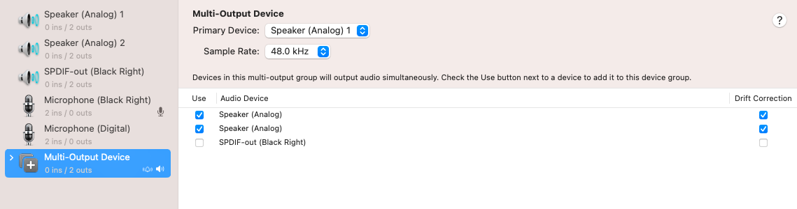

In Sonoma I encounter that multichannel is no more working.
So I have to tune Info.plist so way that all output will be in different groups.
getdump utility shows me
 nid 17 0x99430130 as  3 seq  0 SPDIF-out     Fixed ATAPI   Special Internal Unknown misc 0 NoPresenceDetect
 nid 20 0x01014010 as  1 seq  0 Line-out      Jack  1/8     Rear    External Green   misc 0
 nid 21 0x01011012 as  1 seq  2 Line-out      Jack  1/8     Rear    External Black   misc 0
 nid 22 0x01016011 as  1 seq  1 Line-out      Jack  1/8     Rear    External Orange  misc 0
 nid 23 0x4037c500 as  0 seq  0 CD            None  Analog  N/A     External Res.C   misc 2 NoPresenceDetect
 nid 24 0x01a19050 as  5 seq  0 Microphone    Jack  1/8     Rear    External Pink    misc 0
 nid 25 0x02a19060 as  6 seq  0 Microphone    Jack  1/8     Front   External Pink    misc 0
 nid 26 0x0181305f as  5 seq 15 Line-in       Jack  1/8     Rear    External Blue    misc 0
 nid 27 0x02214020 as  2 seq  0 Headphones    Jack  1/8     Front   External Green   misc 0
As we see nodes 20,21,and 22 lies is the same first group 0x01014010, 0x01011012, 0x0101601- red digits.
It was possible up to Ventura but not in Sonoma.
See groups 4,7 is not occupied so make
0x01014010, 0x01011042, 0x01016071 - green color.
To do this we have to edit VoodooHDA/Contents/Info.plist by simple TextEdit
