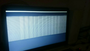

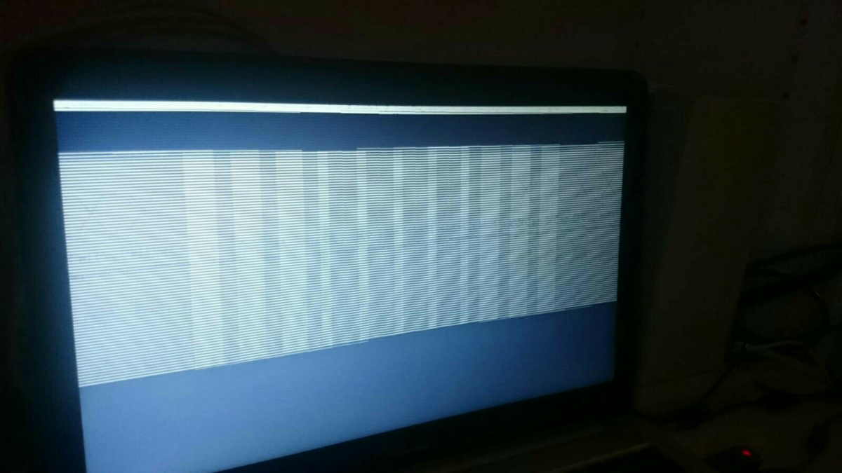

Arkist0 Posted November 15, 2016 Share Posted November 15, 2016 Hi there !First of all, I want to thank you for your awesome guide, it helped me a lot Then I got a few questions about this hackintosh.Before I ask you those questions, here's my computer's configuration : Asus K501LX with an i5 5200U, GTX 950M, 1TB HDD and 12Gigs of RAM. My bundled wifi isn't working so I ordered the one you took in the guide.The first minor issue is about the screen right after booting. My screen is "striated" and unusable... until I close the laptop and open it after about 10sec. Yup, that's strange. When connected to HDMI, the integrated screen is "striated" but the external looks normal. It did this during the installation too. So I wondered if you had this problem and maybe how to solve it. (Iv'e attached a picture of the phenomenon during the OS X installation process)The second question is about updating to Sierra. I know you tried and then got back to El Capitan because mouse and Keyboard aren't fully supported, but I don't really care about this kind of details. Anyway, so I wanted to update to Sierra but Clover doesn't find the "Install macOS" option. So I updated Clover to the lastest version available, I installed it properly but when I hit enter, either on the "Install macOS" option or on the El Capitan partition, it won't boot.To be more precise, It shows the Apple logo, no loading bar appears, and then it quickly reboots, that's really strange. I tried almost everything, editing the config.plist, updating the Kexts etc... none of those solutions works. Then I got one last question about the touchpad : every gesture is working, even with 3 fingers for the launchpad etc... But I can't scroll with two fingers. The option is ticked in "System Preferences > Trackpad" and other two fingers gesture like the right click are working. I'm pretty sure that the Kext are installed properly.Hope we can get those little things working, Arkisto Link to comment Share on other sites More sharing options...
nguyenlc1993 Posted November 15, 2016 Author Share Posted November 15, 2016 Hello Im happy to see your guide... good work I have an ASUS k751l with i7 broadwell u cpu and Intel HD graphics 5500 Does following your tutorial would work for me? thanks.. Look at the first post. I already stated that any model other than K501LX/K501LB should use this guide as reference only. Hi there ! First of all, I want to thank you for your awesome guide, it helped me a lot Then I got a few questions about this hackintosh. Before I ask you those questions, here's my computer's configuration : Asus K501LX with an i5 5200U, GTX 950M, 1TB HDD and 12Gigs of RAM. My bundled wifi isn't working so I ordered the one you took in the guide. The first minor issue is about the screen right after booting. My screen is "striated" and unusable... until I close the laptop and open it after about 10sec. Yup, that's strange. When connected to HDMI, the integrated screen is "striated" but the external looks normal. It did this during the installation too. So I wondered if you had this problem and maybe how to solve it. (Iv'e attached a picture of the phenomenon during the OS X installation process) The second question is about updating to Sierra. I know you tried and then got back to El Capitan because mouse and Keyboard aren't fully supported, but I don't really care about this kind of details. Anyway, so I wanted to update to Sierra but Clover doesn't find the "Install macOS" option. So I updated Clover to the lastest version available, I installed it properly but when I hit enter, either on the "Install macOS" option or on the El Capitan partition, it won't boot. To be more precise, It shows the Apple logo, no loading bar appears, and then it quickly reboots, that's really strange. I tried almost everything, editing the config.plist, updating the Kexts etc... none of those solutions works. Then I got one last question about the touchpad : every gesture is working, even with 3 fingers for the launchpad etc... But I can't scroll with two fingers. The option is ticked in "System Preferences > Trackpad" and other two fingers gesture like the right click are working. I'm pretty sure that the Kext are installed properly. Hope we can get those little things working, Arkisto - About the first issue, try to enable CSM in BIOS settings. - I don't recommend upgrade to Sierra yet, as some of the hardware/functions are not working well on Sierra. You are responsible for your own actions. - For the last issue, you can try to change the scrolling speed, untick and retick two finger scrolling and see if it worked. 1 Link to comment Share on other sites More sharing options...

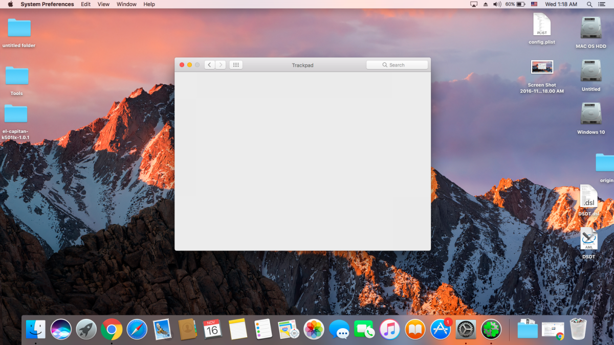

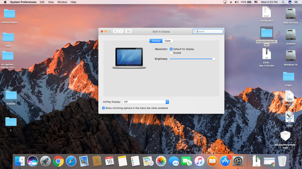

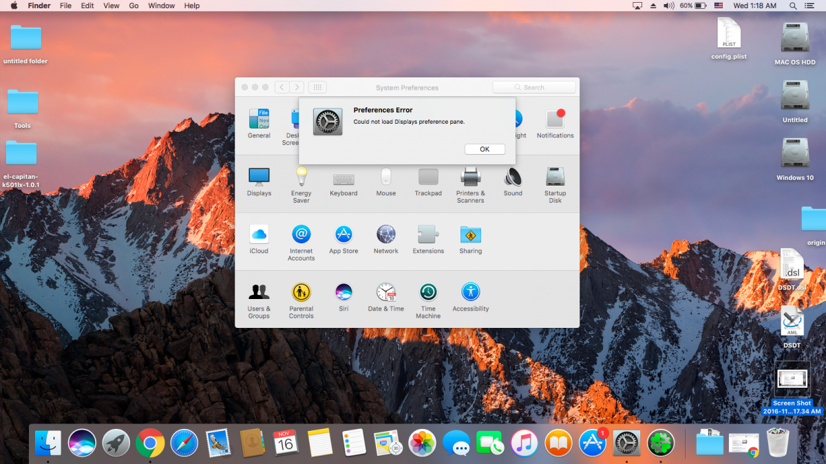

MOUDAR Posted November 16, 2016 Share Posted November 16, 2016 ASUS k751LB i7 broadwell u intel HD 5500 nvidia 940m (disable) SSD 500 GB windows 10 + 1TB HDD MAC OS X sierra hello again I would like to thank you for this wonderful guide i used as reference but with os x sierra USB INSTALER Laptop works great Except for two problems I could not find a solution for them 1- open display preferences [preferences not load displays preference pane] Hd 5500 work and backlight is work 2- trakpad work but no click and no preferences Any possible solutions ???? thanks Link to comment Share on other sites More sharing options...
MOUDAR Posted November 16, 2016 Share Posted November 16, 2016 update (displays preference pane not load ) FIXED 1. Darwin Dumper 2. FixEDID trakpad issue no fixed yet . Link to comment Share on other sites More sharing options...

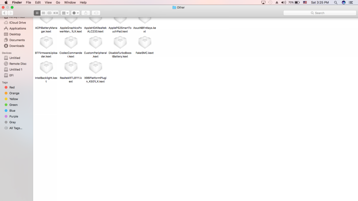

Arkist0 Posted November 19, 2016 Share Posted November 19, 2016 Thank you, no more startup graphic bug and no more scroll problem. I would like to thank you for this wonderful guide i used as reference but with os x sierra USB INSTALER Oh nice, I haven't tried Sierra with this method, I tried with a [url="http://www.insanelymac.com/forum/topic/279450-why-insanelymac-does-not-support-tonymacx86/"]#####[/url] stick but I had graphical issues (no blur effect and bad resolution)...May I ask you which kexts you used for your installation ? The ones in this guide or the lastests versions downloaded somewhere ? 1 Link to comment Share on other sites More sharing options...
MOUDAR Posted November 19, 2016 Share Posted November 19, 2016 Thank you, no more startup graphic bug and no more scroll problem. Oh nice, I haven't tried Sierra with this method, I tried with a ##### stick but I had graphical issues (no blur effect and bad resolution)... May I ask you which kexts you used for your installation ? The ones in this guide or the lastests versions downloaded somewhere ? Glad to hear this Success installation 1- Update clover bootloader to last version to make USB Sierra installation after instal copy past the clover partition from Usb to efi partition on disk 2- remove all Kext number keep other kext only in usb and efi partition after install 3-Change Pre-DVMT Allocated to 64/128MB in BIOS settings. 4-Use SwitchResX if you want to switch to custom HiDPI resolution3 use this to FixEDID Link to comment Share on other sites More sharing options...
