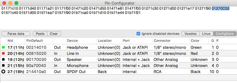

MacPeet Posted May 8, 2016 Share Posted May 8, 2016 (edited) This is a new patch project: for AD1984 - older laptops IBM/Lenovo ThinkPad T61 and others. (Speakers and HP in single configuration) AppleHDA.kext_AD1984_laptop_variant_try_1.zip LayoutID 1 all connections are working (laptop and docking station), only one problem: HP working only for 30 seconds Do you know this problem? (Speakers and HP in Switch Mode) AppleHDA.kext_AD1984_laptop_variant_try_2.zip LayoutID 1 changes to HP, but no sound dump: dump.zip Edited May 8, 2016 by Allan Topic title edited, we are in a public Forum. 1 Link to comment https://www.insanelymac.com/forum/topic/312126-sound-for-ad1984-can-you-help-me/ Share on other sites More sharing options...

Mirone Posted May 8, 2016 Share Posted May 8, 2016 @MacPeet, try this, change Verbs: HeadPhones: 01171c10 01171d40 01171e21 01171f00 --> 01171c10 01171d40 01171e21 01171f02 LineIn: 01471c20 01471d50 01471ea1 01471f00 --> 01471c20 01471d50 01471e81 01471f02 Use CodecCommander. 1 Link to comment https://www.insanelymac.com/forum/topic/312126-sound-for-ad1984-can-you-help-me/#findComment-2236853 Share on other sites More sharing options...

MacPeet Posted May 12, 2016 Author Share Posted May 12, 2016 No, I do not have this hardware. The hardware has griven (Admin of hackintosh-forum.de). We have new information which we test tonight. Linux dump says: Internal Speakers 18->10->4 Headphone 17->7->34->3 (HP only 30 seconds) With VoodooHDA works Headphone and Voodoo dump says: Internal Speakers 18->10->4 Headphone 17->7->34->4 tonight will griven test it with 4 I will report and thank you for your Help. Link to comment https://www.insanelymac.com/forum/topic/312126-sound-for-ad1984-can-you-help-me/#findComment-2237530 Share on other sites More sharing options...
Mirone Posted May 12, 2016 Share Posted May 12, 2016 No, I do not have this hardware. The hardware has griven (Admin of hackintosh-forum.de). We have new information which we test tonight. Linux dump says: Internal Speakers 18->10->4 Headphone 17->7->34->3 (HP only 30 seconds) With VoodooHDA works Headphone and Voodoo dump says: Internal Speakers 18->10->4 Headphone 17->7->34->4 tonight will griven test it with 4 I will report and thank you for your Help. Within your layout in key Headphone add a MuteGPIO = 872480791. let's see if something changes. Link to comment https://www.insanelymac.com/forum/topic/312126-sound-for-ad1984-can-you-help-me/#findComment-2237563 Share on other sites More sharing options...

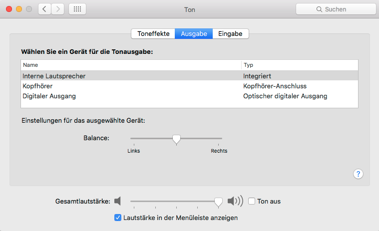

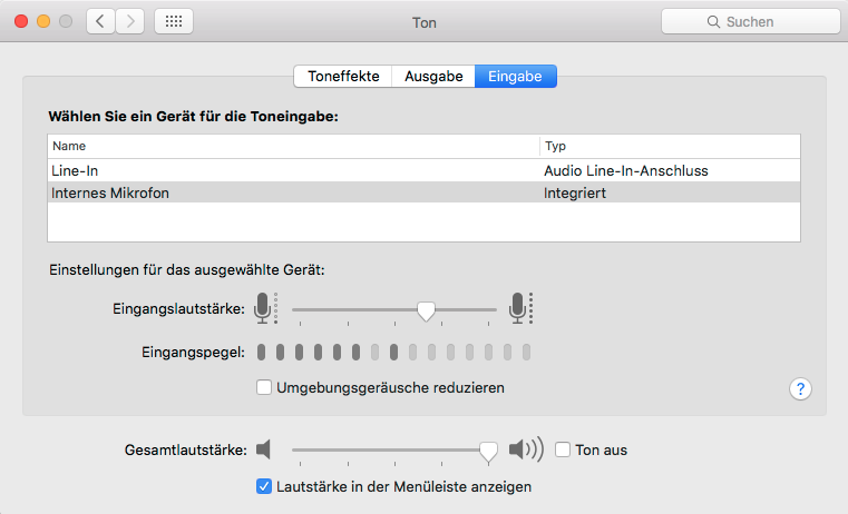

MacPeet Posted May 13, 2016 Author Share Posted May 13, 2016 status report: realtekALC.kext.zip layout3.xml.zip Platforms.xml_SingleMode.zip HP operates continuously when HP plugged, but not HP is selected. If HP is selected, then works only 30 seconds. That's better, but still not perfect. Platforms.xml_SwitchMode.zip HP is not working We are now trying to MuteGPIO=872480791. I will report. thank you Link to comment https://www.insanelymac.com/forum/topic/312126-sound-for-ad1984-can-you-help-me/#findComment-2237686 Share on other sites More sharing options...
