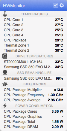

snam11 Posted October 6, 2016 Share Posted October 6, 2016 Frank Nitty: i have same mobo as yours but different processor (i7 6700k), everything works almost perfect but i can't get any fan icon or readings at all using hwsensors app (and of course fakesmc+plugins). i've tried almost every combination of fakesmc and kext... does the fan detection works on your system? i'm on 10.11.6 atm. Link to comment https://www.insanelymac.com/forum/topic/311747-guide-how-to-install-el-capitan-on-asus-z170m-plus-with-clover-using-pentium-g4500/page/2/#findComment-2294053 Share on other sites More sharing options...

Frank Nitty Posted October 25, 2016 Author Share Posted October 25, 2016 Frank Nitty: i have same mobo as yours but different processor (i7 6700k), everything works almost perfect but i can't get any fan icon or readings at all using hwsensors app (and of course fakesmc+plugins). i've tried almost every combination of fakesmc and kext... does the fan detection works on your system? i'm on 10.11.6 atm. Sorry for the delay... Below is a screenshot of my temps being shown in HWSensors with the 'Fan Detection' included: Be sure to check that your fans are connected to ports that says "CHA FAN#" on the motherboard as shown below: If that doesn't work then I don't know what else to tell you... Link to comment https://www.insanelymac.com/forum/topic/311747-guide-how-to-install-el-capitan-on-asus-z170m-plus-with-clover-using-pentium-g4500/page/2/#findComment-2305816 Share on other sites More sharing options...
snam11 Posted October 25, 2016 Share Posted October 25, 2016 i have 3 fans on the motherboard, so all the fan slots (cpu, cha1 and cha2) are used, 2 fans have 3 pin (cpu/cha1), and one has 4 pins (cha2), but i can see and set speed/profile just on bios. as i can see in your pic you have also problems with the fans... the pic is showing only 2 fans: one system fan is recognized but not showing any rpm. only "working" fan is the integrated fan of the gpu, and btw has strange value on it (19rpm is sloooooooow). Link to comment https://www.insanelymac.com/forum/topic/311747-guide-how-to-install-el-capitan-on-asus-z170m-plus-with-clover-using-pentium-g4500/page/2/#findComment-2305854 Share on other sites More sharing options...

Frank Nitty Posted October 26, 2016 Author Share Posted October 26, 2016 i have 3 fans on the motherboard, so all the fan slots (cpu, cha1 and cha2) are used, 2 fans have 3 pin (cpu/cha1), and one has 4 pins (cha2), but i can see and set speed/profile just on bios. as i can see in your pic you have also problems with the fans... the pic is showing only 2 fans: one system fan is recognized but not showing any rpm. only "working" fan is the integrated fan of the gpu, and btw has strange value on it (19rpm is sloooooooow). O ok, didn't pay it any mind before I posted it... HWSensors is an ok tool, but monitoring my fan speeds hasn't been much of a concern to me... As long as your BIOS doesnt indicate any alerts I wouldn't worry too much a/b it if I were u. I wanted to know if we can follow the tutorial to install MacOS Sierra or we must do differently? sorry for my bad english You can follow my guide to install Sierra the same way except your system def needs to be changed to MacPro5,1, iMac14,2, etc. (anything above MacPro3,1 but released after 2010). Also use the latest version of Clover and select 'OsxAptioFix2Drv-64'. You may need to create a 10.12 'kext' folder in the EFI partition (since from my experience Clover didn't create one for me). I will eventually post a guide with all the necessary changes to successfully install Sierra. 1 Link to comment https://www.insanelymac.com/forum/topic/311747-guide-how-to-install-el-capitan-on-asus-z170m-plus-with-clover-using-pentium-g4500/page/2/#findComment-2306613 Share on other sites More sharing options...

snam11 Posted October 28, 2016 Share Posted October 28, 2016 O ok, didn't pay it any mind before I posted it... HWSensors is an ok tool, but monitoring my fan speeds hasn't been much of a concern to me... As long as your BIOS doesnt indicate any alerts I wouldn't worry too much a/b it if I were u. you should because if u can't control or read fan speed value u can't increase rpm if the cpu or gpu is getting too hot, i dunno if system can auto manage speed if needed. as soon u use cpu/gpu for intense video editing or any other stuff u can only see temp getting higher and higher, and no way to cool it down increasing the fan(s) speed . Link to comment https://www.insanelymac.com/forum/topic/311747-guide-how-to-install-el-capitan-on-asus-z170m-plus-with-clover-using-pentium-g4500/page/2/#findComment-2308207 Share on other sites More sharing options...
