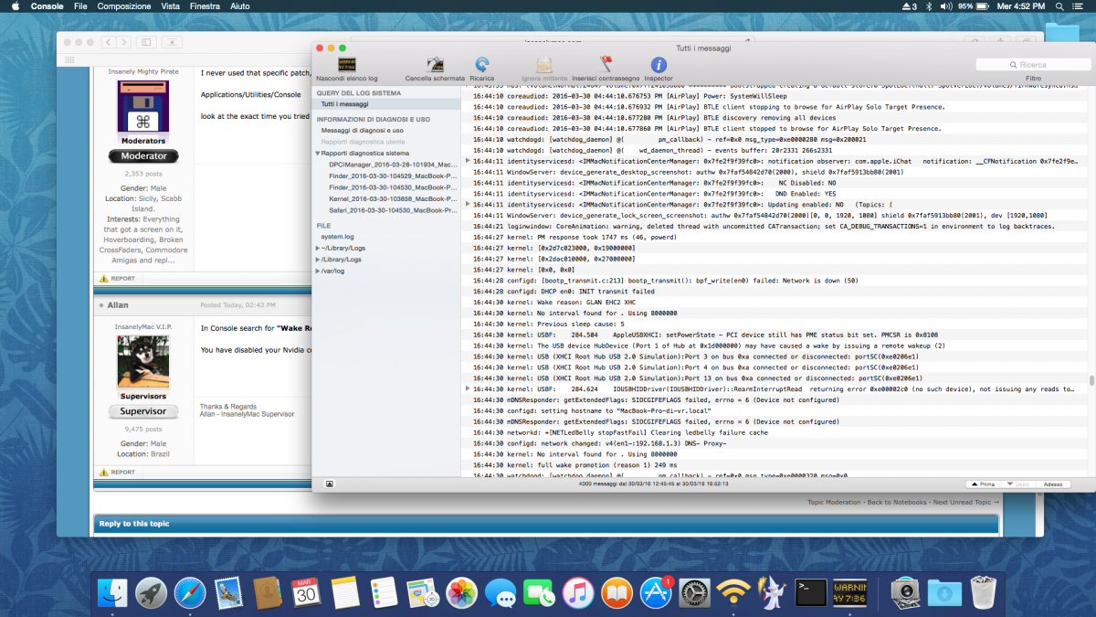

JahStories Posted March 30, 2016 Share Posted March 30, 2016 I never used that specific patch, but to enable it you should use Enabled. Applications/Utilities/Console look at the exact time you tried sleep and post on a spoiler here if you want. Link to comment https://www.insanelymac.com/forum/topic/311610-hp-omen-15-touch-5004-nl/#findComment-2228605 Share on other sites More sharing options...
Allan Posted March 30, 2016 Share Posted March 30, 2016 In Console search for "Wake Reason:" You have disabled your Nvidia correctly? Have all the USB ports injected? Link to comment https://www.insanelymac.com/forum/topic/311610-hp-omen-15-touch-5004-nl/#findComment-2228656 Share on other sites More sharing options...
vrondena Posted March 30, 2016 Author Share Posted March 30, 2016 wake reason GLAN EHC2 XHC Link to comment https://www.insanelymac.com/forum/topic/311610-hp-omen-15-touch-5004-nl/#findComment-2228690 Share on other sites More sharing options...

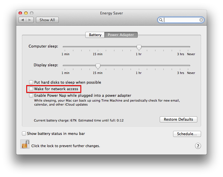

Allan Posted March 30, 2016 Share Posted March 30, 2016 Send me your DSDT+config.plist. See if this box are selected, if yes, uncheck: Link to comment https://www.insanelymac.com/forum/topic/311610-hp-omen-15-touch-5004-nl/#findComment-2228772 Share on other sites More sharing options...
