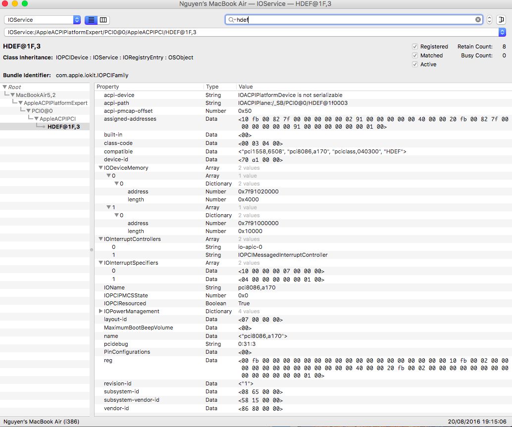

If you don't use a DSDT search with ioregistryexplorer for the HDEF device, if it's there you don't need the FixHDA patch, else add this to your config.plist

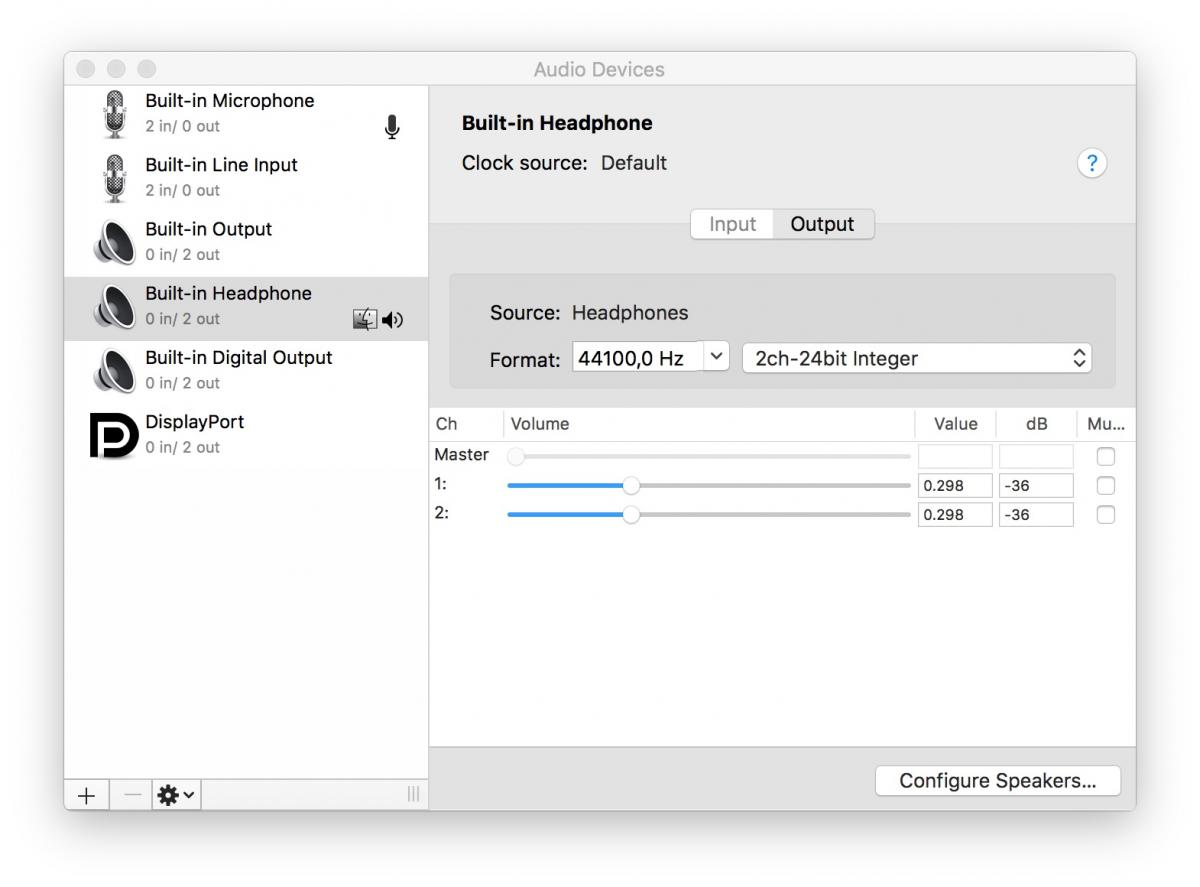

Have you also tried the kext i've linked ?, start the audio-midi tool and see how many dB you have at full volume, and see if the sound is distorted at 0 dB.
Yes, tried. Sound again is distorted when is 70-80%+. About audio-midi - never used before and don't know how to do what you said :D Btw, my english is not good enough. Sorry
ioregistryexplorer not work under my el capitan. double click and nothing happens. Have to force quit ioregistryexplorer.
It doesn't matter, if you have sound your device name is already "HDEF"
Start the Audio-Midi-Setup tool, and move the volume slider to max, then look at the dB value, it should be 0 dB.

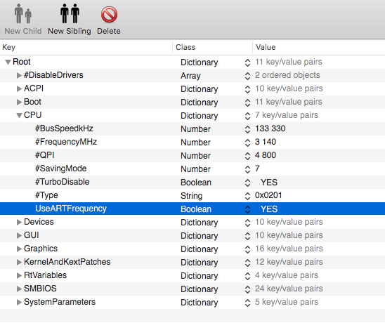

If you have Skylake mobo include UseARTFrequency=True in your config.plist

For Skylake mobos use key UseATRFrequency->True or False to avoid distortions. Also check your clover revision. Must be latest available. Now it's r3696
I am currently using that UseARTFrequency=false entry in my config.plist but I still have distortion...

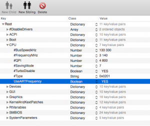

edit: Installed last clover
bootloader r3696. UseARTFrequency missing. I added UseARTFrequency=false. For now not heard distortion, but will see.
edit2: if I delete config.pllist before update clover boot loader the new version add many different things. If not delete config plist before clover bootloader update, config.plist is the same like before (see screenshot). I'm confused. What is the correct way to update clover bootloader?

edit: Installed last clover bootloader r3696. UseARTFrequency missing. I added UseARTFrequency=false. For now not heard distortion, but will see.

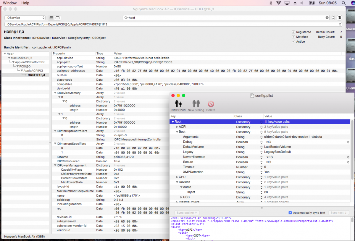

Hello,
my alc 269VC doesn't work on sierra public beta 16A293a
i tried layout 28, 6, 7 but it doesn't work. can you support me please
Codec: Realtek ALC269VC
Address: 0
Vendor Id: 0x10ec0269
Subsystem Id: 0x15586508
Revision Id: 0x100202
