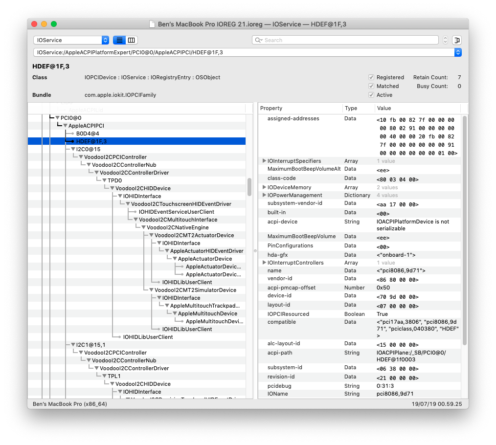

Hey guys, so after reading this guide, I am a little lost, see below
https://github.com/acidanthera/AppleALC/wiki/Adding-codec-support
I have a lenovo yoga 910 (alc 299) and need some help adding my codec. I have attached the codec dump for linux and just need help applying the correct patches. The current layout ids for alc299 do not work for me (21 and 22). If anyone knows how to do this any help is greatly appreciated.
Thanks,
Ben
codec.txt

First, use layoutID 21 and LayoutID 22. After that upload IOREG Output for each layoutID. So we will see if you need new resources or not

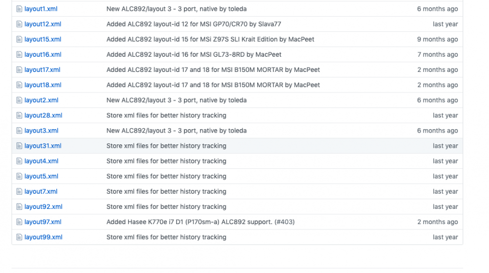

Hello All,
 My last problem is audio.
 The audio component is not recognize.
 I didn't win with AppleALC v1.3.9 (with Lilu.kext v1.3.6 and WhateverGreen.kext v1.3.8)
My configuration hardware is :
- Mother board : Intel DP67BG - i72600k (3.4Ghz)
- Ram : 16Go GSkill Triden XMP-1866
- Samsung SSD 850 EVO 500 Go
- Raid 5 : 3ware 9650SE
- video board : Asus Mars GTX 760x2
- Webcam : Logitech webcam 720p - Lecteur / Graveur : PLEXTOR DVDR PX-L890SA
- Trial boot managed by Clover 2.4 r_r4972 : (my SSD have 4 partitions, MBR mode)
   Windows    10 (1903)  (241 Go)
   Yosemite   10.10.0  (112 Go)
   Linux Mint 19.03  (112 Go)
   1st partition is 100 Mb created by Windows 7.
   I didn't know if it is necessary for Windows 10.
   I have moved the Windows 10 recover partition in second HD with size of 4Go.
 How can I help you to create a new xml file ?
 How can I do creating of the new xml file ?
 Currently in the bdmesg file I have :
3:434  0:000  === [ GetDevices ] ========================================
3:434  0:000  PCI (00|00:1A.00) : 8086 1C2D class=0C0320
3:434  0:000  PCI (00|00:1B.00) : 8086 1C20 class=040300    for Realtek ALC 892 audio codec
3:435  0:000  PCI (00|00:1C.00) : 8086 1C10 class=060400
this shell command :
sudo lspci
00:1b.0 Audio device: Intel Corporation 6 Series/C200 Series Chip-set Family High Definition Audio Controller (rev 05)
note :
 On windows 10 the name is "High Definition Audio"
 On Windows 7 the driver was a Realtek ALC 892 High Definition Audio System Software Ver: R2.74
Thank you very much,
Best regards.

There are bunch of layoutID for ALC892,, you can try with LayoutID = 1 and 2 for first step
Edited by Andres ZeroCross
https://drive.google.com/open?id=1PIG9yCd590gw1wX8hSW_PScseGfLAD7g
My IOREGs were 23.6 mb so heres a link to them. Thanks
If you want to upload to google drive, don't lock it with permission access. You're slow response

9 hours ago, ben130 said:
https://drive.google.com/drive/folders/1JOlQnMWHfMFl6HNLxHSNPTel0w7q31mW
Sorry about that, ended up on my school google drive originally should be good now thanks
Your codec is not detected in IOREG,, nothing to do with appleALC.
Try to fix your IRQ Flag. Open your config.plist with CLover Configuratior. Then tick HPET, IRQ, TIMR, IPIC in ACPI section. Set layout ID as 21 / 22. Reboot and check your audio, don't forget to upload IOREG again

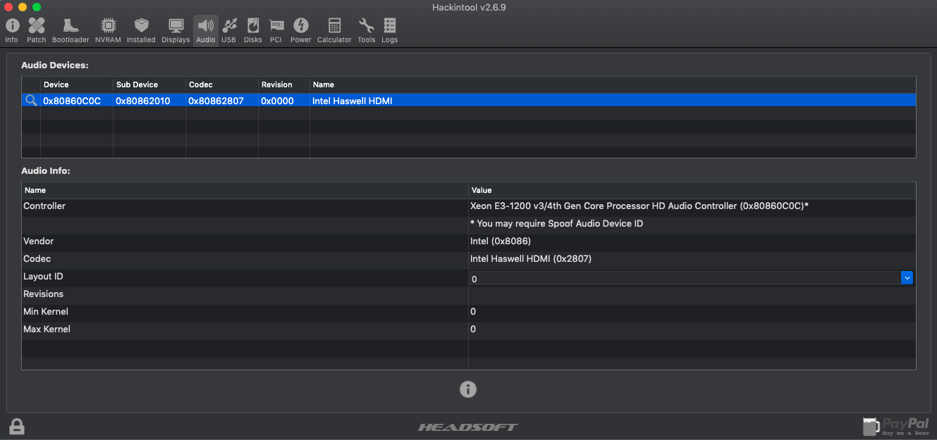

Hello,
I am trying to configure the AppleALC kext in my system but each time that I set a layout the system stalls.
As you can see the hackintool doesn't list my card and on the IORegistry Dump I cannot see the codec model.
My computers is an Asus G750JY and I think that it has a ALC282 codec. I am using Mojave as OS. The kext VoodooHDA work fine but the audio is really low.
Please let me know if you require another info to help me to find the problem
Many thanks
config_foro.plist
kext_list.txt
Edited by lordrafa

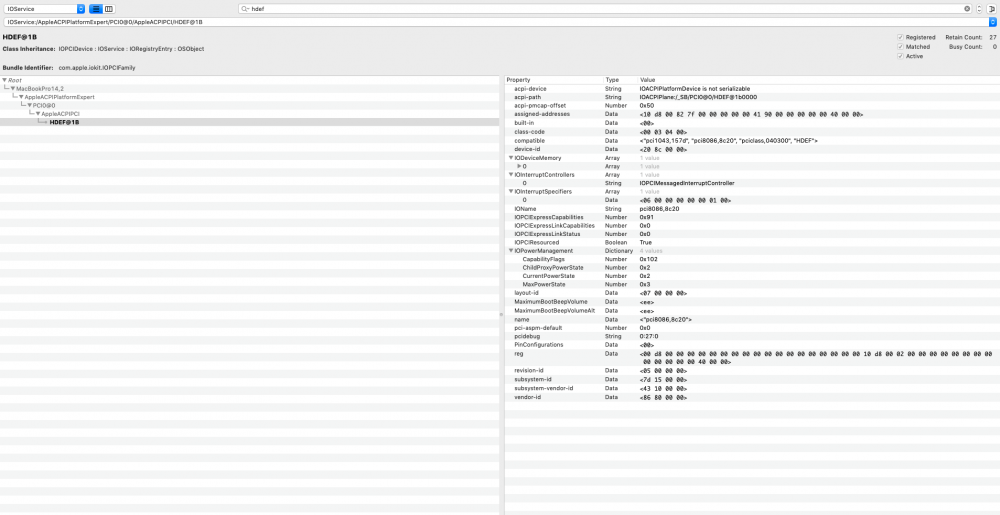

Hi @vit9696 all ALC developers
I can't get sound (except HDMI) with AppleALC 1.3.9 or AppleALC 1.4.0.
Motherboard: Gigabyte Aorus Master (Bios F9)
Try layout-id: 1, 7, 16, 29
Codec: ALC1220-VB
Graphic card: MSI Radeon RX 580 Armor
OS: macOS Catalina 10.15
Please help.:)
Edited by Matgen84
Codec: ALC1220-VB
Please help.:)
Can you upload your IOREG? And so it mean, everything is good with AppleALC.kext 1.3.8???
