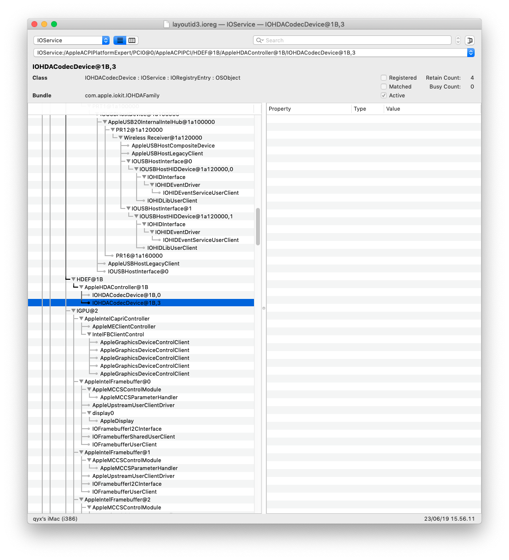

here are the ioregs.. for each id i injected, i rebooted then save copy as..
layoutid3.ioreg
idlayout7.ioreg
1 hour ago, Andres ZeroCross said:
It mean you have made wrong patch to layoutID.
Follow this,, use layout id 3, 7, and 13 after that upload your IOREG Output for each layouid used.
can't upload the 13.ioreg file limit reached...

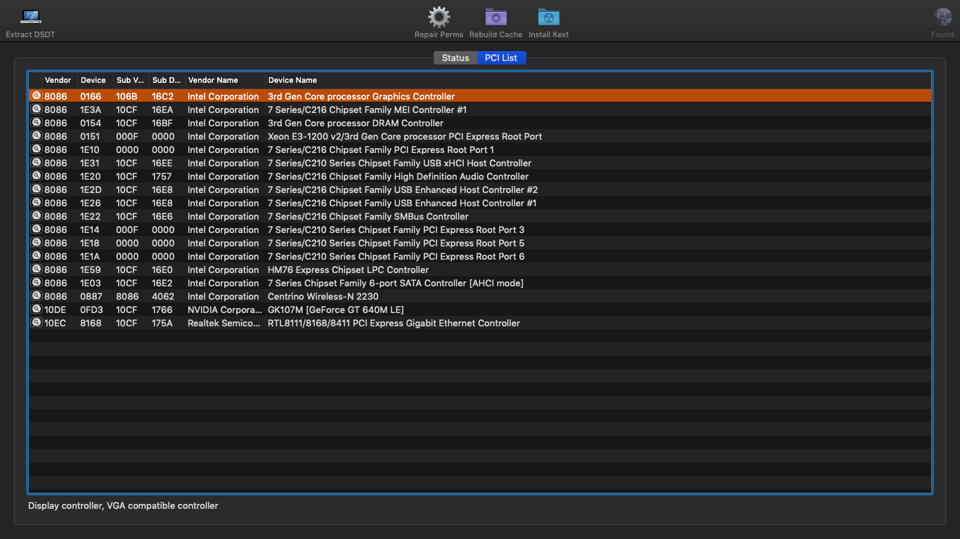

Open DPCIManager.app dan take screenshot
@notmacowner
The Inject method is ok.
alc-layout-id and layout-id are set in the ioreg

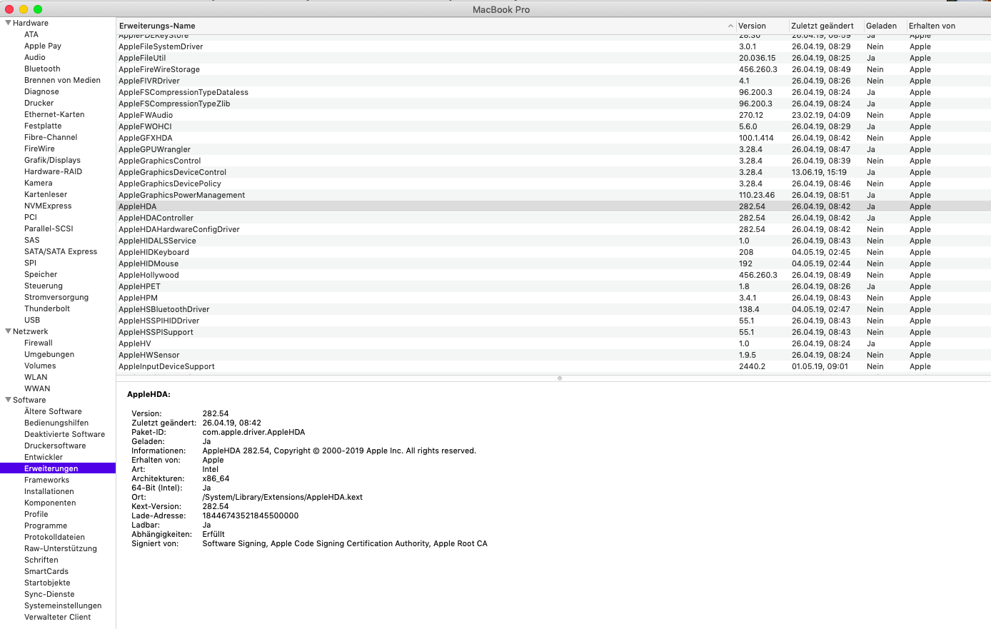

Is your AppleHDA in S/L/E still original ???
see in system information / extensions:
Is AppleHDA loaded and original ?
1 minute ago, MacPeet said:
@notmacowner
some codecs should go at least partially

here's layoutid13.ioreg and screenshot of pci tab...
i used the dpcimanager from https://github.com/MuntashirAkon/DPCIManager
idlayout13.ioreg
Wrong screenshot, you must take screensho in Status, i don't need your pci list, i can see pci list from IOREG.
Btw, your problem is caused by wrong IRQ. Patch manual IRQ to your DSDT or OTF patch with clover. I have write the step about IRQ patch in config.plis above. Check it
@MacPeet my AppleHDA in S/L/E is untouched as this is a clean install and tried this guide first as linked by toleda from the 'other' forum.
