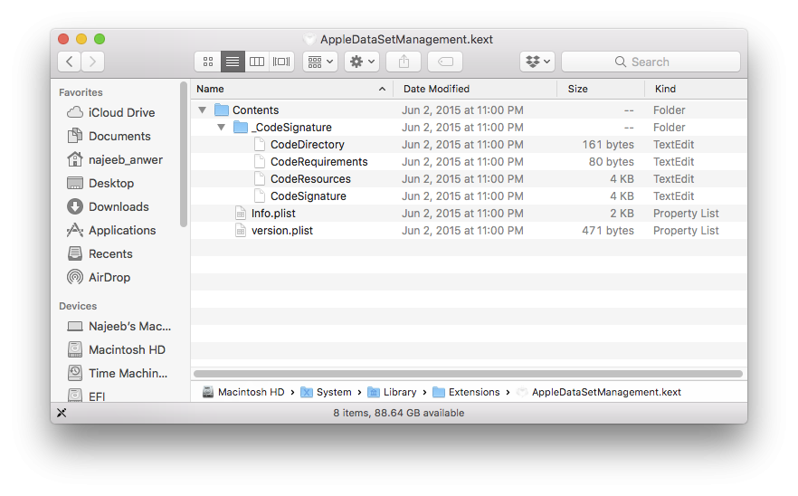

I am concerned about the kexts that you say I have modified. I don't see how that is possible. For example, here is the AppleDataSetManagement.kext. All of the file modification dates are from 2015. I don't have time travel technology...yet :P

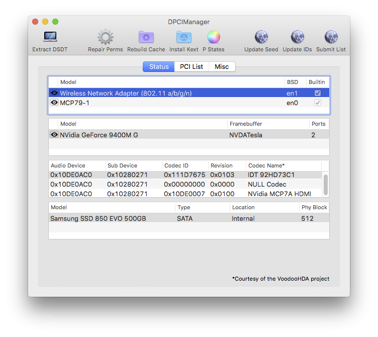

Open DPCIManager.app, and please take a screenshot of status tab.
Sent from my Mi Note 2 using Tapatalk
It's all shown. IRQ is patched well,
Will check it tommorow. Maybe debug files will be usefull. Use RunMe.app dan upload the result
Re: DPCIManager, why is there a NULL Codec in the list. I have not seen that before when I have used DPCIManager.

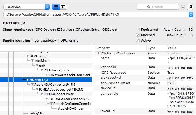

New codec, what causes this debug message:
2018-11-29 12:57:27.295688-0800  localhost kernel[0]: (Lilu) <Lilu`lilu_os_log (kern_util.cpp:47)> AppleALC:     alc @ alc-layout-id was not provided by controller at HDEF
IOReg:
Suggestions?
IOReg:
Suggestions?
Hmm,, i never checked debug log with debug ALC kext :D
