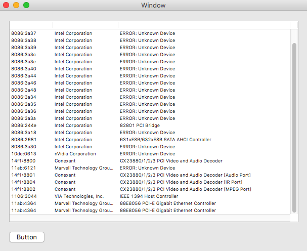

gengik84 Posted December 30, 2015 Share Posted December 30, 2015 Download dpcimanager, take a picture at the PCI list, and post it Link to comment https://www.insanelymac.com/forum/topic/310109-marvell-yukon-88e8056-in-el-capitan/#findComment-2201758 Share on other sites More sharing options...

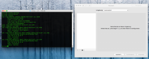

Typhoon_Master Posted December 30, 2015 Author Share Posted December 30, 2015 Download dpcimanager, take a picture at the PCI list, and post it i added the screenshot of dpcimanager. weired thing i just noticed: my nic's are listet in ifconfig, but are not listet in the network-preferrences. i also got them to "status: active" in ifconfig by plugging a networkcable in and do "ifconfig en0 up; ifconfig en1 up", but i can't ping anything in my network. // Edit HELL YEAH I SOLVED IT! :-) I deleted the folder /Library/Preferences/SystemConfiguration and rebootet, so that it got recreated, now my ethernet works! Seems like an update-process-faiur. If anyone knows, i would be very interested what exactly the problem now was. 1 Link to comment https://www.insanelymac.com/forum/topic/310109-marvell-yukon-88e8056-in-el-capitan/#findComment-2201760 Share on other sites More sharing options...
