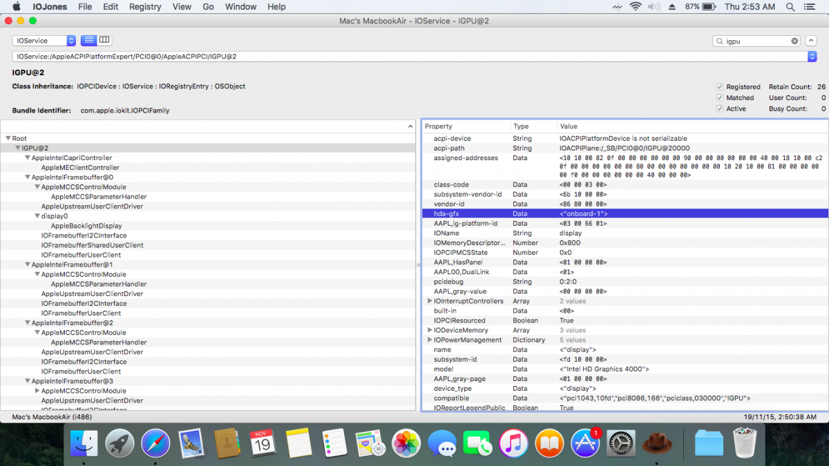

TheRacerMaster Posted November 18, 2015 Share Posted November 18, 2015 Do you see the "hda-gfx" property in IOReg under the IGPU device? Link to comment https://www.insanelymac.com/forum/topic/309402-is-it-a-must-to-use-patched-applehda-in-order-for-hdmi-audio-to-work-hd4000/#findComment-2189657 Share on other sites More sharing options...
Sen Posted November 19, 2015 Author Share Posted November 19, 2015 Do you see the "hda-gfx" property in IOReg under the IGPU device? Hi are you referring to this? If so, yes there is. Link to comment https://www.insanelymac.com/forum/topic/309402-is-it-a-must-to-use-patched-applehda-in-order-for-hdmi-audio-to-work-hd4000/#findComment-2189754 Share on other sites More sharing options...

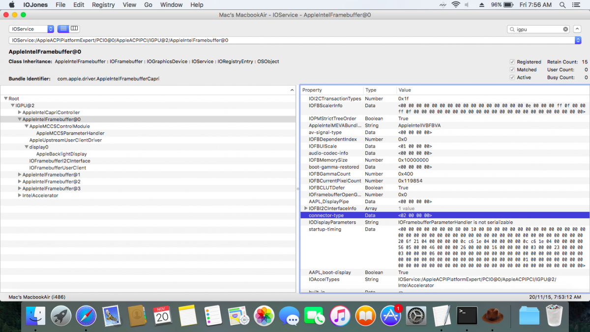

TheRacerMaster Posted November 19, 2015 Share Posted November 19, 2015 Hi are you referring to this? If so, yes there is. OK, good. Now check under AppleIntelFramebuffer@0 and see what the connector type is. Link to comment https://www.insanelymac.com/forum/topic/309402-is-it-a-must-to-use-patched-applehda-in-order-for-hdmi-audio-to-work-hd4000/#findComment-2189922 Share on other sites More sharing options...
Sen Posted November 20, 2015 Author Share Posted November 20, 2015 OK, good. Now check under AppleIntelFramebuffer@0 and see what the connector type is. The connector type says <02 00 00 00>. which means lvds display. Link to comment https://www.insanelymac.com/forum/topic/309402-is-it-a-must-to-use-patched-applehda-in-order-for-hdmi-audio-to-work-hd4000/#findComment-2190093 Share on other sites More sharing options...
TheRacerMaster Posted November 20, 2015 Share Posted November 20, 2015 Look at the connector type for your external HDMI display. Make sure it's seen as HDMI and not DisplayPort. Link to comment https://www.insanelymac.com/forum/topic/309402-is-it-a-must-to-use-patched-applehda-in-order-for-hdmi-audio-to-work-hd4000/#findComment-2190096 Share on other sites More sharing options...
Sen Posted November 20, 2015 Author Share Posted November 20, 2015 Look at the connector type for your external HDMI display. Make sure it's seen as HDMI and not DisplayPort. Sorry for my incompetence, what you mean is that i have to plug in the HDMI first after that open ioreg and see if its is hdmi rather than display port?? Link to comment https://www.insanelymac.com/forum/topic/309402-is-it-a-must-to-use-patched-applehda-in-order-for-hdmi-audio-to-work-hd4000/#findComment-2190109 Share on other sites More sharing options...
TheRacerMaster Posted November 20, 2015 Share Posted November 20, 2015 Sorry for my incompetence, what you mean is that i have to plug in the HDMI first after that open ioreg and see if its is hdmi rather than display port?? Yes, plug the HDMI display in first and see if it's properly recognized as HDMI. Link to comment https://www.insanelymac.com/forum/topic/309402-is-it-a-must-to-use-patched-applehda-in-order-for-hdmi-audio-to-work-hd4000/#findComment-2190127 Share on other sites More sharing options...
Sen Posted November 20, 2015 Author Share Posted November 20, 2015 Yes, plug the HDMI display in first and see if it's properly recognized as HDMI. Ok, so i have plugged and the connector type is still 02 00 00 00. So what should i do? Thanks! Link to comment https://www.insanelymac.com/forum/topic/309402-is-it-a-must-to-use-patched-applehda-in-order-for-hdmi-audio-to-work-hd4000/#findComment-2190156 Share on other sites More sharing options...

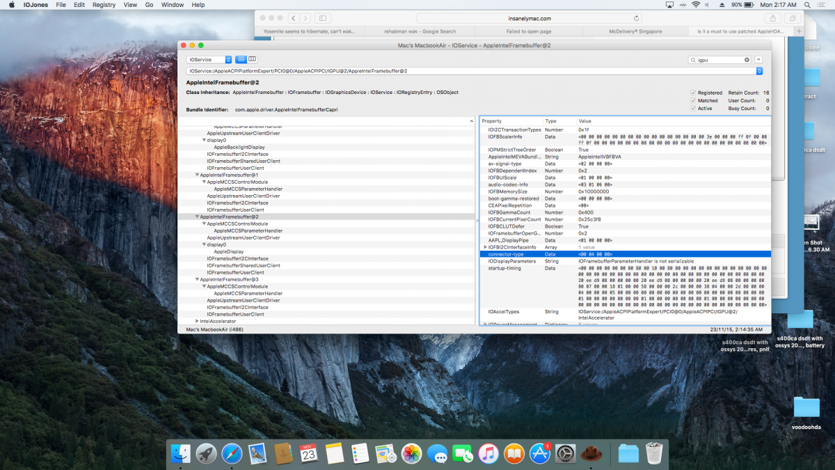

TheRacerMaster Posted November 20, 2015 Share Posted November 20, 2015 Look at the connector under a different display (not your laptop's LVDS display). Link to comment https://www.insanelymac.com/forum/topic/309402-is-it-a-must-to-use-patched-applehda-in-order-for-hdmi-audio-to-work-hd4000/#findComment-2190175 Share on other sites More sharing options...
Sen Posted November 23, 2015 Author Share Posted November 23, 2015 Look at the connector under a different display (not your laptop's LVDS display). Hi theracermaster, sorry for the late reply. I just checked other appleintelframebuffer and my samsung smart tv is detected as apple display(presumably). The connector type is 00 04 00 00 which is DP. I have attached my ioreg. Thanks. Mac’s MacbookAir.zip Link to comment https://www.insanelymac.com/forum/topic/309402-is-it-a-must-to-use-patched-applehda-in-order-for-hdmi-audio-to-work-hd4000/#findComment-2191068 Share on other sites More sharing options...
Sen Posted November 23, 2015 Author Share Posted November 23, 2015 So I was browsing through my clover config.plist, realised there is an option to patch kext on the fly. And in that, there is hdmi audio for hd4000. Because the config.plist I'm using is from rehab man. So I enable it by ticking the port 0304 which is for i think frame buffer@2 because when i plug the hdmi it shows as apple display in frame buffer 2. Also I'm following this guide by allan http://www.hackintoshosx.com/topic/21732-guide-enable-hdmi-audio-intel-hd-4000/is to put the dsdt patch under igpu. But to no avail. The guide says that you need to have audio working using either voodoo or applehda. The hdmi audio still doesnt work for me though. And also in sys information under display, it detected my samsung tv as television. Link to comment https://www.insanelymac.com/forum/topic/309402-is-it-a-must-to-use-patched-applehda-in-order-for-hdmi-audio-to-work-hd4000/#findComment-2191188 Share on other sites More sharing options...

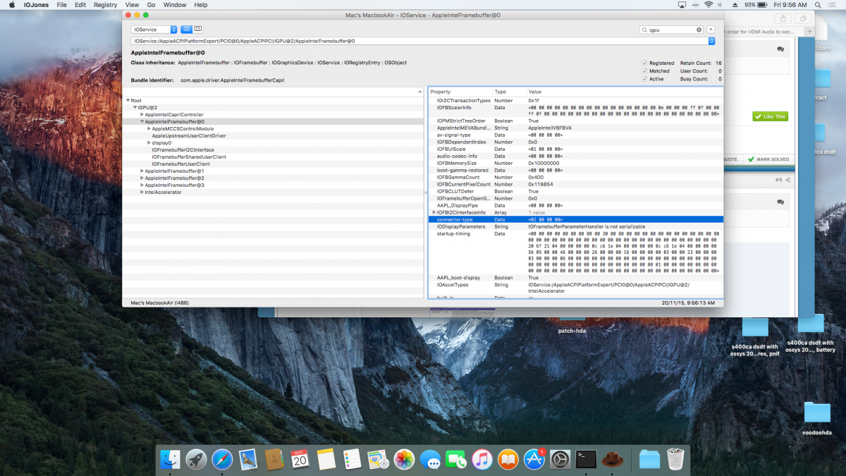

TheRacerMaster Posted November 24, 2015 Share Posted November 24, 2015 Your external display needs to be recognized as HDMI (connector-type) for HDMI audio to work. You'll need to patch the framebuffer to accomplish this, either by editing the kext or by using Clover kext patches. Link to comment https://www.insanelymac.com/forum/topic/309402-is-it-a-must-to-use-patched-applehda-in-order-for-hdmi-audio-to-work-hd4000/#findComment-2191344 Share on other sites More sharing options...
Sen Posted November 24, 2015 Author Share Posted November 24, 2015 Your external display needs to be recognized as HDMI (connector-type) for HDMI audio to work. You'll need to patch the framebuffer to accomplish this, either by editing the kext or by using Clover kext patches. Hi i've patched the capri frame buffer kext using this guide http://www.hackintoshosx.com/topic/21732-guide-enable-hdmi-audio-intel-hd-4000/ .Now my ioreg says its connector-type is 00 08 00 00 but then the hdmi audio still doesn't work. I even applied the patch to my dsdt for both hdef and igpu. I think maybe something wrong with voodoohda? Because when i plugged the hdmi, the sound system preferences under output says Digital Out (HDMI) not samsung tv.Thanks Link to comment https://www.insanelymac.com/forum/topic/309402-is-it-a-must-to-use-patched-applehda-in-order-for-hdmi-audio-to-work-hd4000/#findComment-2191412 Share on other sites More sharing options...
