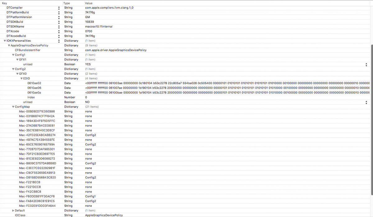

Micky1979 Posted October 22, 2015 Share Posted October 22, 2015 I pasted it into here and unless there's something wrong with that site my EDID is practically empty. Check at /System/Library/Extensions/AppleGraphicsControl.kext/Contents/PlugIns/AppleGraphicsDevicePolicy.kext's Info.plist, your SMBIOS can make the differences. See the follow: something is injected already, with different device id (can't be the one used by you if smbios match one listed). Ok, I don't know what Clover do, maybe is already taken into account. EDID contains colors setting and much more Manufacturer: SAM Model 686 Serial Number 1129067058 Made week 37 of 2010 EDID version: 1.3 Digital display Maximum image size: 48 cm x 27 cm Gamma: 2.20 DPMS levels: Off Supported color formats: RGB 4:4:4, YCrCb 4:2:2 First detailed timing is preferred timing Chroma Info: Red X: 0.649414 Y: 0.334961 Green X: 0.283203 Y: 0.605469 Blue X: 0.151367 Y: 0.073242 White X: 0.312500 Y: 0.329102 Detailed mode: Clock 148.500 MHz, 477 mm x 268 mm 1920 2008 2052 2200 hborder 0 1080 1084 1089 1125 vborder 0 +hsync +vsync Monitor ranges (GTF): 56-75Hz V, 30-81kHz H, max dotclock 170MHz Monitor name: SMEX2220 Serial number: H9XZ905065 See DarwinDumper to get same information. Yea, but 3 years ago I learn that the EEPROM can be buggie (on my skin, my display EEPROM was bad), especially on laptops, so dump from Windows and re-inject it can be the better cure (because EDID Override may already have been done, result data is surely better). What to do if OSX read bad data? That's why apple has a database in OSX (updated frequently) for some TVs/Monitors, just to override the EEPROM with working one, when possible (sure not on someone else brand Laptop). Link to comment https://www.insanelymac.com/forum/topic/308908-os-x-el-capitan-10111-is-out/page/2/#findComment-2180960 Share on other sites More sharing options...

Slice Posted October 23, 2015 Share Posted October 23, 2015 Check at /System/Library/Extensions/AppleGraphicsControl.kext/Contents/PlugIns/AppleGraphicsDevicePolicy.kext's Info.plist, your SMBIOS can make the differences. See the follow: AppleGraphicsDevicePolicy.kext.png something is injected already, with different device id (can't be the one used by you if smbios match one listed). Ok, I don't know what Clover do, maybe is already taken into account. Yea, but 3 years ago I learn that the EEPROM can be buggie (on my skin, my display EEPROM was bad), especially on laptops, so dump from Windows and re-inject it can be the better cure (because EDID Override may already have been done, result data is surely better). What to do if OSX read bad data? That's why apple has a database in OSX (updated frequently) for some TVs/Monitors, just to override the EEPROM with working one, when possible (sure not on someone else brand Laptop). Completely agree! Clover get EDID from EEPROM and it may be bad. OSX also get it from EEPROM or rather from a bootloader. So Clover function "CustomEDID" will help to do the thing better. The custom EDID should be taken from Windows if it has OEM monitor driver. Or somehow edit EDID by some tool to make it the best. I ported Viewsonic EDID Editor to Wineskin and used it on Mac. Thanks for clearing that up Slice. What I mean is I dragged Garageband from the main monitor to the secondary monitor I'd attached to the VGA port and it still displayed incorrectly. Different monitor, different port, different EDID, same problem. I dumped the EDID from the main (and now the only) monitor with DarwinDumper. The txt output file is empty but here's the contents of the hex file. Extracted contents: header: 00 ff ff ff ff ff ff 00 serial number: 1e 6d 6b 56 6b 07 00 00 0a 11 version: 01 03 basic params: ea 31 20 78 ea chroma info: ae c5 a2 57 4a 9c 25 12 50 54 established: a7 6b 80 standard: 95 00 81 80 81 40 71 4f 01 01 01 01 01 01 01 01 descriptor 1: 7c 2e 90 a0 60 1a 1e 40 30 20 36 00 da 28 11 00 00 1a descriptor 2: 21 39 90 30 62 1a 27 40 68 b0 36 00 da 28 11 00 00 1c descriptor 3: 00 00 00 fd 00 38 4b 1c 53 0f 00 0a 20 20 20 20 20 20 descriptor 4: 00 00 00 fc 00 4c 32 32 36 57 20 0a 20 20 20 20 20 20 extensions: 00 checksum: e4 Manufacturer: GSM Model 566b Serial Number 1899 Made week 10 of 2007 EDID version: 1.3 Digital display Maximum image size: 49 cm x 32 cm Gamma: 2.20 DPMS levels: Standby Suspend Off Supported color formats: RGB 4:4:4, YCrCb 4:2:2 First detailed timing is preferred timing Chroma Info: Red X: 0.634766 Y: 0.341797 Green X: 0.291992 Y: 0.611328 Blue X: 0.147461 Y: 0.070312 White X: 0.313477 Y: 0.329102 Established timings supported: 720x400@70Hz 640x480@60Hz 640x480@75Hz 800x600@56Hz 800x600@60Hz 800x600@75Hz 832x624@75Hz 1024x768@60Hz 1024x768@75Hz 1280x1024@75Hz 1152x870@75Hz Standard timings supported: 1440x900@60Hz 1280x1024@60Hz 1280x960@60Hz 1152x864@75Hz Detailed mode: Clock 119.000 MHz, 474 mm x 296 mm 1680 1728 1760 1840 hborder 0 1050 1053 1059 1080 vborder 0 +hsync -vsync Detailed mode: Clock 146.250 MHz, 474 mm x 296 mm 1680 1784 1960 2240 hborder 0 1050 1053 1059 1089 vborder 0 -hsync +vsync Monitor ranges (GTF): 56-75Hz V, 28-83kHz H, max dotclock 150MHz Monitor name: L226W Checksum: 0xe4 (valid) EDID block does NOT conform to EDID 1.3! Digital display field contains garbage: 6a Detailed block string not properly terminated See! EDID block does NOT conform to EDID 1.3! 1 Link to comment https://www.insanelymac.com/forum/topic/308908-os-x-el-capitan-10111-is-out/page/2/#findComment-2181109 Share on other sites More sharing options...
