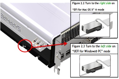

Jolly Posted October 18, 2015 Share Posted October 18, 2015 Attenzione che potrebbe essere uno switch sulla scheda PC/MAC. Link to comment https://www.insanelymac.com/forum/topic/308764-installazione-asus-z97-pro-wifi-ac-i7-4790k-hd7950/page/3/#findComment-2179062 Share on other sites More sharing options...
Patrick78 Posted October 18, 2015 Author Share Posted October 18, 2015 Sulla mia scheda c'e' il pulsante con il simbolo della Sapphire che si accende o spegne...ho comunque provato in entrambi i modi. Link to comment https://www.insanelymac.com/forum/topic/308764-installazione-asus-z97-pro-wifi-ac-i7-4790k-hd7950/page/3/#findComment-2179106 Share on other sites More sharing options...
