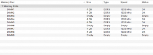

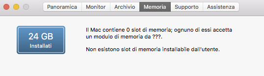

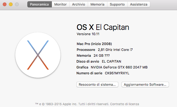

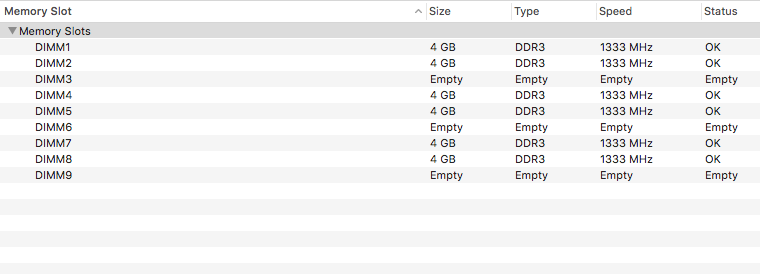

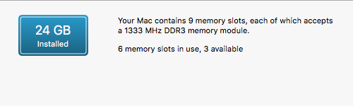

dimosgmx Posted October 3, 2015 Share Posted October 3, 2015 EVGA SR-2 48 GB of RAM 2 x Intel® Xeon® CPU E5649 @ 2.53GHzWas working perfectly with Yosemite no DSDT using Clover.Upgraded to El Capitan no problems(had to completely remove SLE and copy over contents from freshly installed El Capitan and fix permissions to boot), but now El Capitan reports 24GB of RAM and 9 total RAM slots, 6 populated x 4GB and 3 empty. While troubleshooting, I rebooted back to the USB installer and under system info I also have 24GB of RAM.SMBIOS: Mac Pro 3,1I attempted to changed SMBIOS but I get KP.While booting I noticed the following:mem_actual: 0x000000000legacy_sane_size: 0xc0000000RTC: Only single RAM bank (128 bytes)Currently have audio, usb 2.0 , gfx, firewire, bluetooth and nic working.Not working: USB 3, Incorrect RAMAny advice as to what to try would be greatly appreciated.I already tried to add memory slots in clover but I get a KP (could be doing something wrong if someone and comment on how to do it properly)I attached some screenshots for reference.Thanks guys, good luck to all with their upgrades! Link to comment Share on other sites More sharing options...

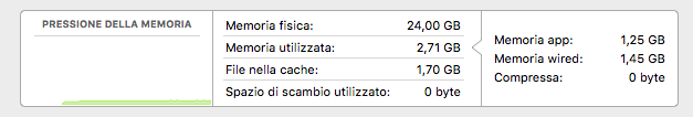

fearandleb Posted October 5, 2015 Share Posted October 5, 2015 Hi, can you check your Activity Monitor on the Memory Page, down on the Physical Memory Page, what reports "Memory Used" and "Wired Memory" there? I have also Memory Issues, only detects half of the Memory. http://www.insanelymac.com/forum/topic/308438-osx-detects-1596tb-of-wired-real-memory/ Link to comment Share on other sites More sharing options...
dimosgmx Posted October 7, 2015 Author Share Posted October 7, 2015 Hi, thanks for the reply. Yes it appears to be the exact same issue. 15,96 TB of Wire Memory. Did you find anything so far. From looking around it seems to be an issue with the boot loader not detecting the ram correctly. I think Revoboot mentions something about it. I was hoping that clover 3280 would fix it but unfortunately that wasn't the case. Link to comment Share on other sites More sharing options...
