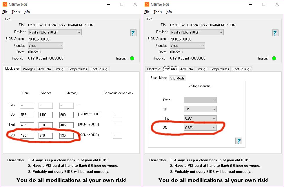

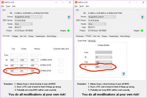

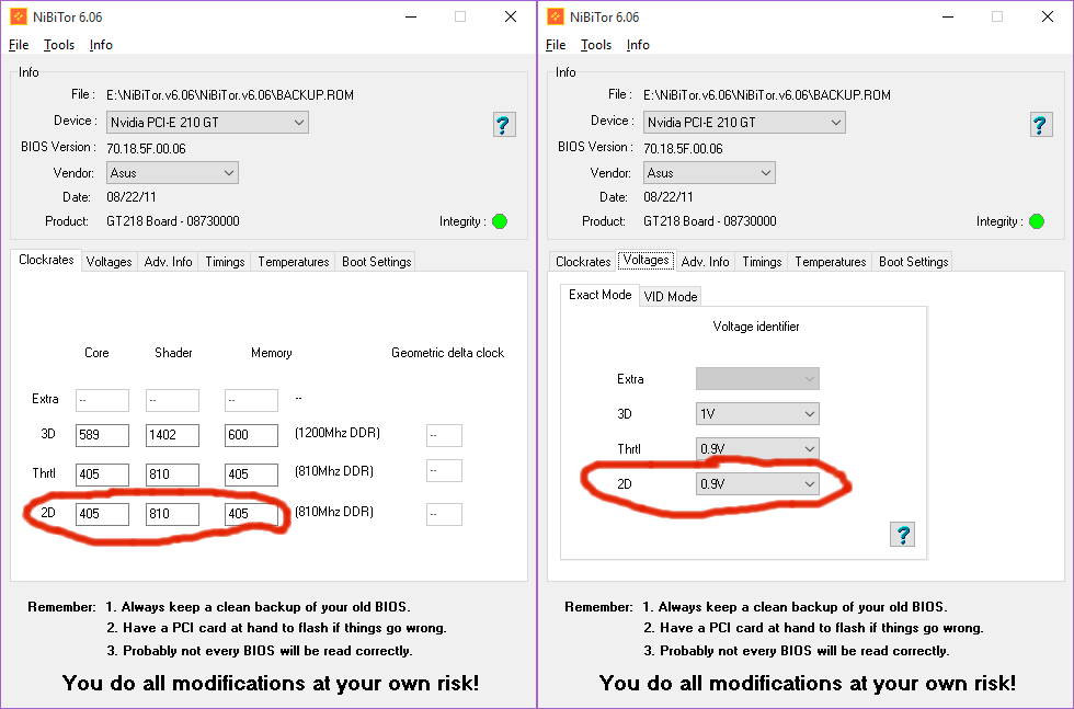

Riley Freeman Posted October 6, 2015 Share Posted October 6, 2015 Sorry for the English, but I also have a Asus GeForce 210. As you know the poor performance comes from the card dropping down to it's lowest (2D) power state. Initially I fixed this with a AGPM kext. But then I modified the clock speeds in the card BIOS. I replaced the speeds and voltages of the lowest state with the values from the middle state. Now the card never drops below 405/810. 2 Link to comment https://www.insanelymac.com/forum/topic/308361-nvidia-geforce-gt-210-prestazioni-scadenti/page/2/#findComment-2174087 Share on other sites More sharing options...

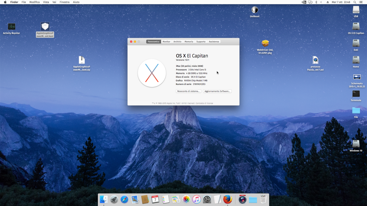

HenryXP Posted October 6, 2015 Author Share Posted October 6, 2015 Quale kext modificato? AppleGraphicsPowerManagement.kext Sorry for the English, but I also have a Asus GeForce 210. As you know the poor performance comes from the card dropping down to it's lowest (2D) power state. Initially I fixed this with a AGPM kext. But then I modified the clock speeds in the card BIOS. I replaced the speeds and voltages of the lowest state with the values from the middle state. Now the card never drops below 405/810. but if you change these values, it is then that the video card is damaged? Link to comment https://www.insanelymac.com/forum/topic/308361-nvidia-geforce-gt-210-prestazioni-scadenti/page/2/#findComment-2174161 Share on other sites More sharing options...
Riley Freeman Posted October 6, 2015 Share Posted October 6, 2015 AppleGraphicsPowerManagement.kext but if you change these values, it is then that the video card is damaged? It shouldn't damage the card. It just prevents it from ever going down to the lowest state. This is also what the AGPM kext does but by modifying the card BIOS the kext isn't needed.. 1 Link to comment https://www.insanelymac.com/forum/topic/308361-nvidia-geforce-gt-210-prestazioni-scadenti/page/2/#findComment-2174168 Share on other sites More sharing options...

HenryXP Posted October 6, 2015 Author Share Posted October 6, 2015 Sorry for the English, but I also have a Asus GeForce 210. As you know the poor performance comes from the card dropping down to it's lowest (2D) power state. Initially I fixed this with a AGPM kext. But then I modified the clock speeds in the card BIOS. I replaced the speeds and voltages of the lowest state with the values from the middle state. Now the card never drops below 405/810. The program, with Windows 10, it does not work Link to comment https://www.insanelymac.com/forum/topic/308361-nvidia-geforce-gt-210-prestazioni-scadenti/page/2/#findComment-2174225 Share on other sites More sharing options...

Riley Freeman Posted October 6, 2015 Share Posted October 6, 2015 The program, with Windows 10, it does not work You need to dump the BIOS file from the card first. This program only edits the file. You can do this with NVFlash. The archive includes a Windows version of NVFlash but I've never really trusted Windows BIOS flash tools. I feel safer doing this from DOS. Plus, I don't have Windows on my X79. I'd recommend a DOS-bootable USB stick with NVflash for this. You can make a bootable USB stick with Rufus (use the FreeDOS option). Boot the usb stick and from the command line type these commands: To backup the BIOS: nvflash -b backup.rom (keep this file in case you ever want to flash back the original BIOS) To flash the file to the card once you've changed it in NiBiTor: nvflash --protectoff nvflash -4 -5 -6 yourbiosfile.rom nvflash --protecton Then shutdown and restart. Link to comment https://www.insanelymac.com/forum/topic/308361-nvidia-geforce-gt-210-prestazioni-scadenti/page/2/#findComment-2174241 Share on other sites More sharing options...
