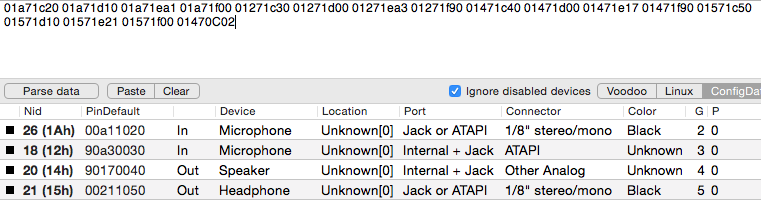

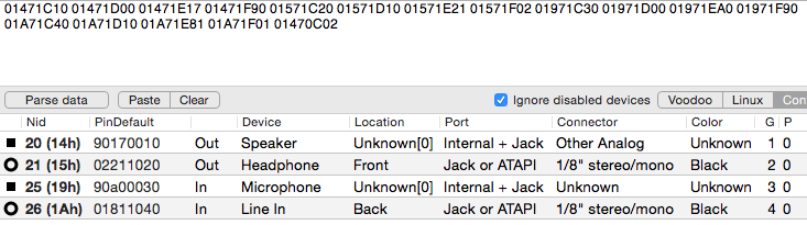

MacPeet Posted July 13, 2015 Share Posted July 13, 2015 @Mirone Nodes 18 instead of 25 Pic1 = 290 by Mirone Pic2 = 290 by babibada codec_dump Mic intern: 9 34 18 ??? Mic extern 8 35 26 ??? Speaker: 20 13 3 ok HP: 21 12 2 ok 1 Link to comment Share on other sites More sharing options...
babibada Posted July 13, 2015 Author Share Posted July 13, 2015 @Mirone Nodes 18 instead of 25 Pic1 = 290 by Mirone Pic2 = 290 by babibada codec_dump Mic intern: 9 34 18 ??? Mic extern 8 35 26 ??? Speaker: 20 13 3 ok HP: 21 12 2 ok Yes sir that's correct.. I can't understand why the mics didn't work... Link to comment Share on other sites More sharing options...
