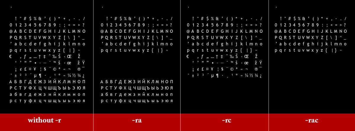

You can try passing a negative value to the -l option to close the line spacing but if the font includes extended ascii or cyrillic chars then the tops/bottoms of those characters may appear in the adjacent cells.
EDIT:

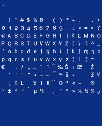

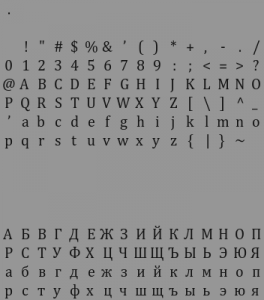

Here's a screenshot showing what I mean.
Baskerville 24pt. With line spacing reduced by -4 and without adjusting line spacing.
You can see one of the extended ascii chararcters is too tall and ends up in the 'z' cell.
Maybe I could add an option to the script to only produce ascii chars 32-126?
This way, there will not be any extended ascii chars to move in to the characters mostly used?
Exclude extended but save cyrillic?

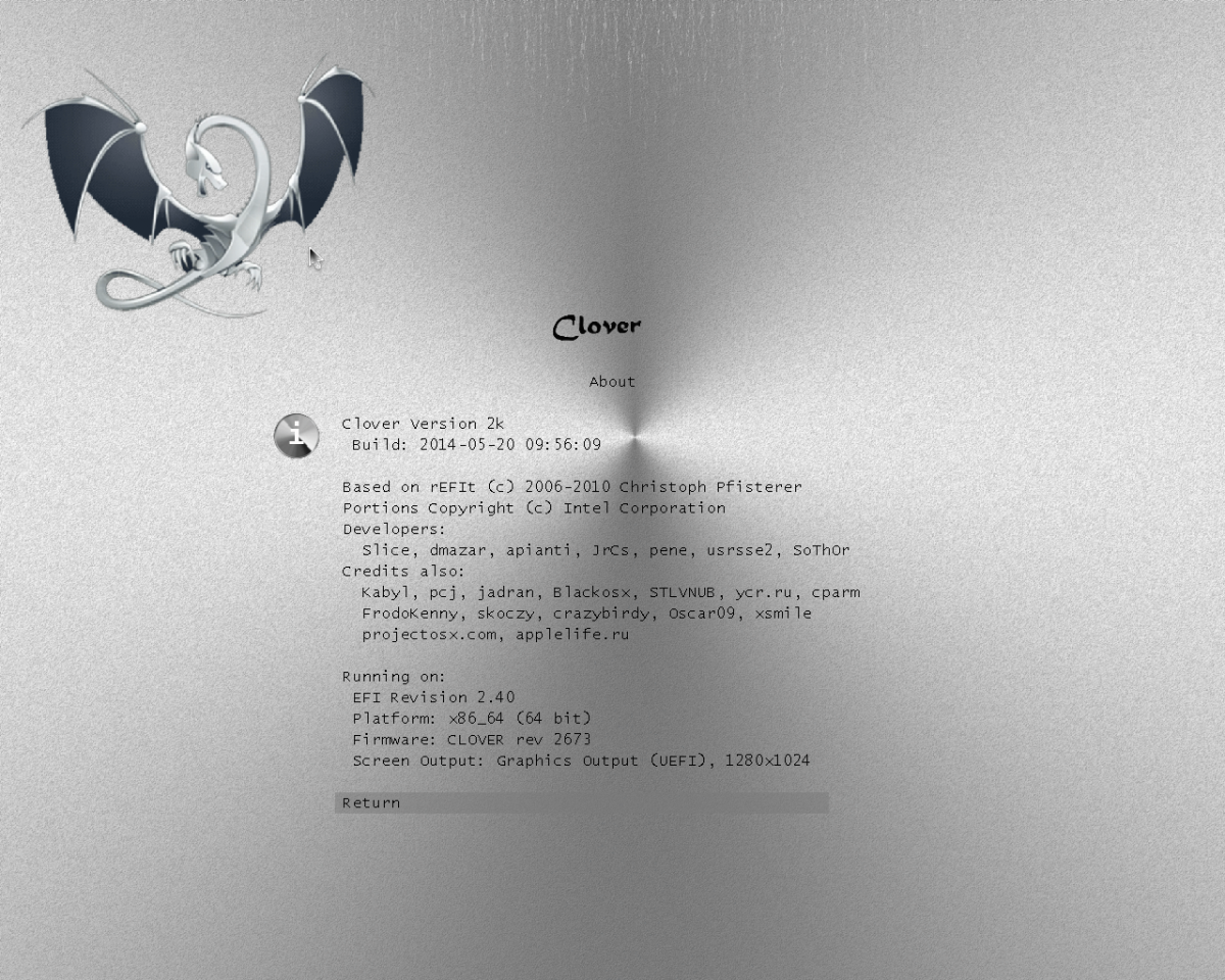

I also can't find why About menu is narrow. There is a bug with menu width.

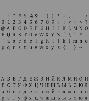

Looks good

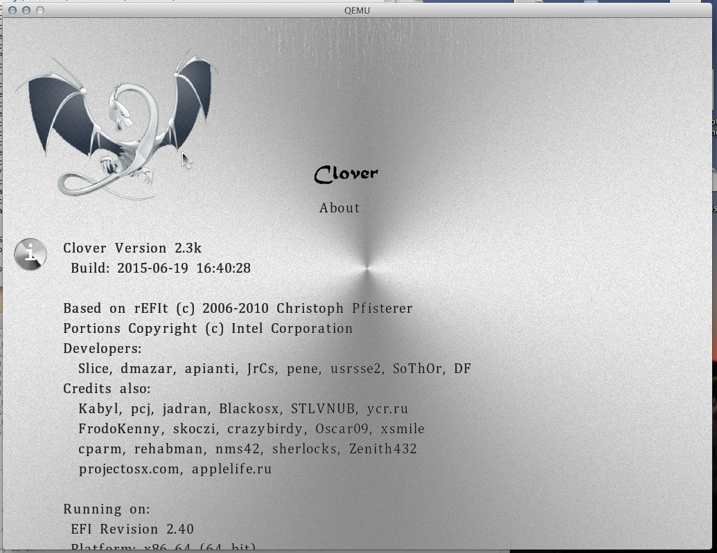

slice$ ./createFont.sh -t2 -s20 -l -2 -fCambria -b150,150,150 -c 20,20,20 -ra
Scanning font character metrics
Widest Char is at index 87 | W at 20 pixels
Canvas size will be 352x400 using cell size 22x25
Building ImageMagick code sequence
Running ImageMagick to create image
Optimising /Users/slice/Downloads/createFont_v0.86/type2_Cambria_20pt_Cell_22x25_l-2_ra.png
Opening /Users/slice/Downloads/createFont_v0.86/type2_Cambria_20pt_Cell_22x25_l-2_ra.png
Good news! Well done Slice.
I see your image shows the text and icon left justified. Can it be centred like before?
Before it also was left adjusted. Just I made it wider 640pt -> 800pt to be used with wide fonts
OK. Great.

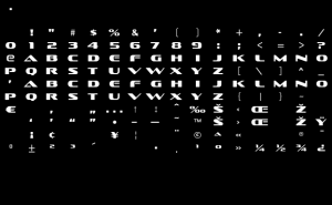

Does Clover have to show a fixed dimension of 800px or can it be dynamic based on the width of the screen resolution with 800px as a minimum?

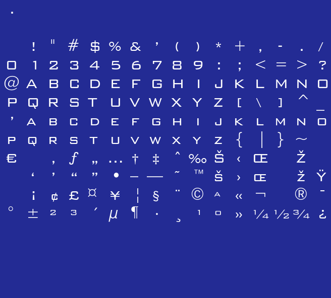

This could be useful for fonts with wide characters which have not been usable so far.
http://il.static.1001fonts.net/s/o/sofachrome-font-4-original.jpeg
OK. Great.
Will this apply to the options menu, and help page too?

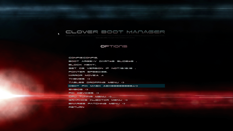

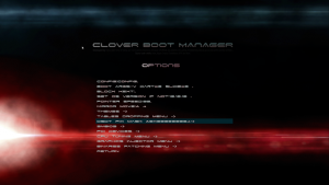

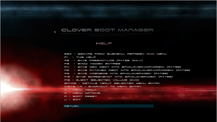

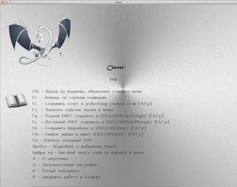

This is Help menu with font Candara (as set in svn)
I can't precalculate menu width if the font is proportional so why I made fixed width menu 800px.
If some text will not fit in this width it will be truncated before output.
You may use characters of any width just not sure if all text will be visible.

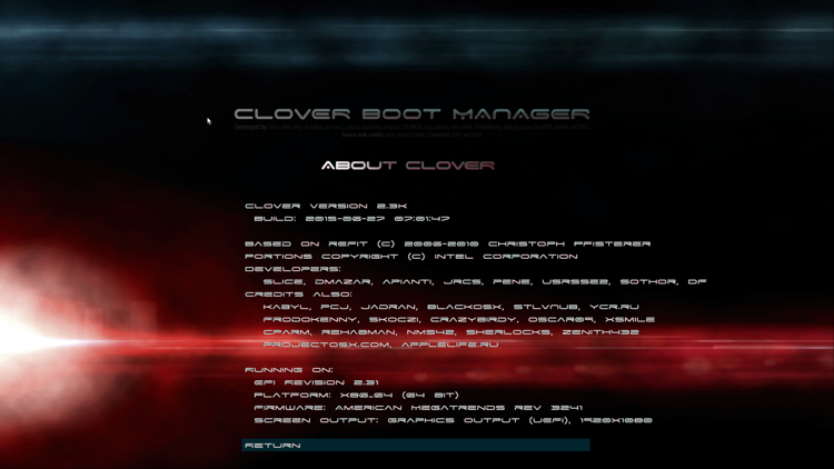

Hi Slice
I have looked in to a good way to adjust Clover’s menu width to try to accommodate wider fonts and it’s actually quite difficult. I’ve played with LAYOUT_TEXT_WIDTH while also trying to take in to account placement of animations but it’s tricky.
So the best solution I have come up with is to simply draw the text with a wider width and not change the placement of the menu.
/rEFIt_UEFI/refit/menu.c - line #1883
-    //TextBuffer = egCreateImage(LAYOUT_TEXT_WIDTH, TextHeight, TRUE);
+    TextBuffer = egCreateImage(UGAWidth-XPos, TextHeight, TRUE);
post-331032-0-27029500-1435385849_thumb.pngpost-331032-0-35596800-1435385857_thumb.pngpost-331032-0-72705400-1435385865_thumb.png

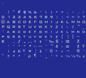

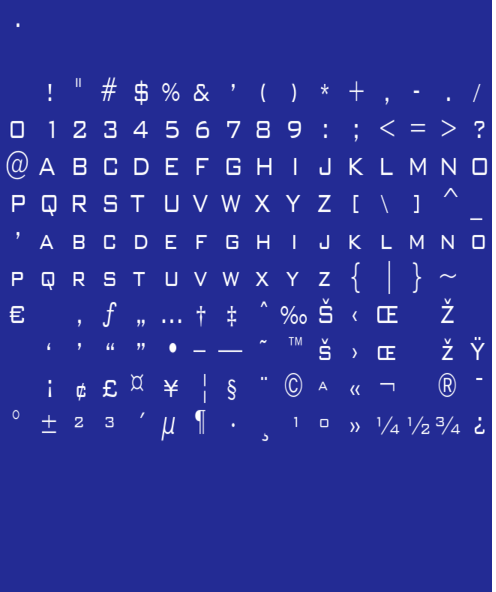

Here's a font image; original and resized by 75% width
I will test on a smaller font also..

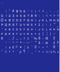

Create normal font image:
$ ./createFont.sh -t2 -b 12,46,128 -f /Users/blackosx/Library/Fonts/Bedizen.ttf -s18
Results in generated file: type2_Bedizen_18pt_Cell_21x26_l0.png
Character grid is made using 16x16 chars:
21x16=336
26x16=416
So final image size is 336 x 416px
If we resize to 75% width:
$ convert type2_Bedizen_18pt_Cell_21x26_l0.png -resize 75%x100 type2_Bedizen_18pt_Cell_21x26_l0_resized.png
It won't work as final image is only 252px wide.
The character grid is made using 16x16 chars so width has to be multiple of 16.
Nearest multiple of 16 to 252px is 256px, so 256/336 = 0.762
So we can use:
$ convert type2_Bedizen_18pt_Cell_21x26_l0.png -resize 76.2%x100 type2_Bedizen_18pt_Cell_21x26_l0_resized.png
Results in image sized 256x416 px.
Now add to theme and set the following in theme.plist
