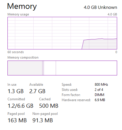

Furthermore, the information in "Windows"  :D , is correct except the memory type, which is Unknown.

Update Windows!
Clover has no relation to memory type detection in Windows.

Shall I write a new version of Windows? ? As I am using the latest one.
That's what you said last time. And it turns out that the code in clover's repository was the reason.
Well, clover does not affect the Windows boot, but the "UEFI firmware" that is included in the repository surely does.
However, what was done in r. 3528 is quite enough, indeed.
Best regards.

The default windows bootloader shows for me "unknown" either. It has nothing to do with clover...
Can you show that Windows booted by Clover shows other hardware information then booted directly from BIOS?

Below are 2 screenshots of task manager, I suppose you'll understand what those represent by the names.
In Windows, I see Speed, Slots, and Form factor and don't see Unknown. It's the same whether I boot from Clover 3526, or from the BIOS boot menu (skipping Clover). Maybe mine doesn't say Unknown because I have DDR4? I don't know what Unknown is supposed to mean, unless someone sees something other than Unknown and blank in that upper right corner.

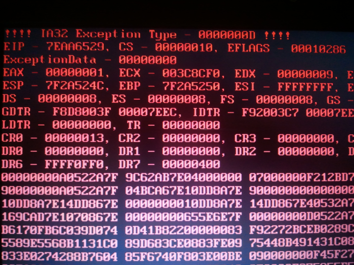

Build with: [Args: ./ebuild.sh -xcode5 -mc | Command: build -D USE_BIOS_BLOCKIO -D USE_LOW_EBDA -D CLANG -p Clover/Clover.dsc -a X64 -b RELEASE -t XCODE5 -n 5 | OS: 10.11.5 | XCODE: 7.3.1]
UEFI ok, boot6 ok, boot7 unfurtunately crash:
rev 3513
install log
Backing up EFI files
Backing up stage2 file /Volumes/Pandora Installer/EFIROOTDIR/boot  to /Volumes/Pandora Installer/EFI-Backups/r3513/2016-05-09-21h05/boot
Backing up /Volumes/Pandora Installer/EFIROOTDIR/EFI folder to /Volumes/Pandora Installer/EFI-Backups/r3513/2016-05-09-21h05/EFI
No Active Partition
Stage 0 - Writting boot0af to /dev/disk2
/Volumes/Pandora Installer/usr/local/bin/fdisk440 -u -f /Volumes/Pandora Installer/usr/standalone/i386/boot0af -y /dev/disk2
Stage 1 - Writting boot1f32 to /dev/rdisk2s1
dd if=/dev/rdisk2s1 count=1 bs=512 of=/tmp/origbs
boot volume format is FAT32
