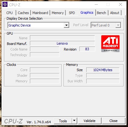

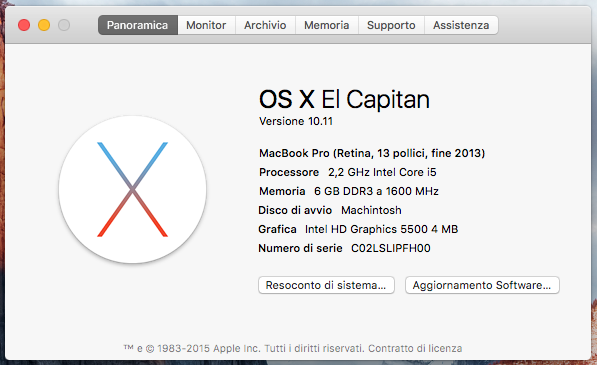

Solaris82 Posted December 10, 2015 Share Posted December 10, 2015 (edited) video card problem, but it is recognized by 4 mb Edited December 10, 2015 by Allan Why you Quote @Austere.J's posts? Link to comment https://www.insanelymac.com/forum/topic/305710-guide-intel-hd-graphics-5500-on-os-x-yosemite-10103/page/2/#findComment-2195699 Share on other sites More sharing options...
Allan Posted December 10, 2015 Share Posted December 10, 2015 So the problem is the memory size. But this is aesthetic thing not a problem. You can watch videos in YouTube, and open some Apps, in OS X? Link to comment https://www.insanelymac.com/forum/topic/305710-guide-intel-hd-graphics-5500-on-os-x-yosemite-10103/page/2/#findComment-2195700 Share on other sites More sharing options...

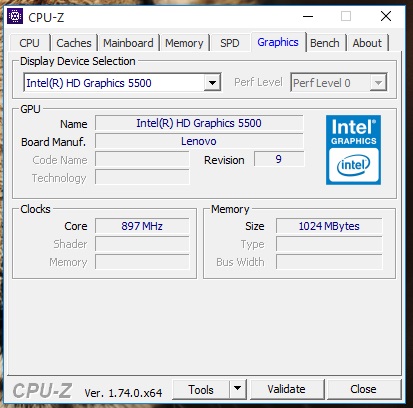

Shingo198199 Posted December 11, 2015 Share Posted December 11, 2015 I think I got it. Set the Bios DVM to 64Meg, even though Windows states 160Meg It's a almost perfect build. Just some of the little extras like keyboard function keys , keyboard light and battery meter a little odd and crazy. I would say this car checks out fine. 1 Link to comment https://www.insanelymac.com/forum/topic/305710-guide-intel-hd-graphics-5500-on-os-x-yosemite-10103/page/2/#findComment-2195872 Share on other sites More sharing options...

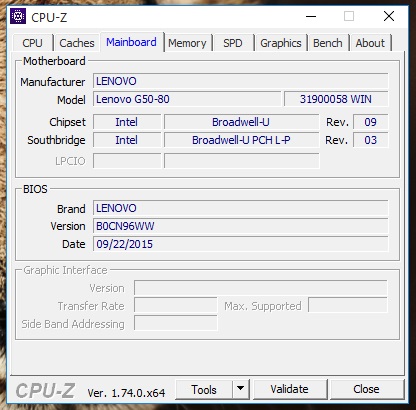

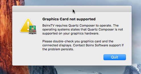

Solaris82 Posted December 12, 2015 Share Posted December 12, 2015 So the problem is the memory size. But this is aesthetic thing not a problem. You can watch videos in YouTube, and open some Apps, in OS X? yes, I can see the video on youtube , if I open BoinxTV me errorSend me you config.plist Lenovo G50-80.zip DSDT+SSDT Lenovo G50-80.zip config.plist Link to comment https://www.insanelymac.com/forum/topic/305710-guide-intel-hd-graphics-5500-on-os-x-yosemite-10103/page/2/#findComment-2196296 Share on other sites More sharing options...

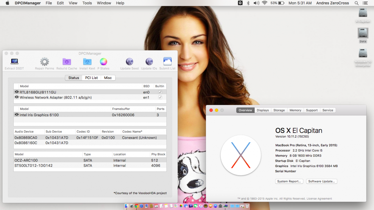

Andres ZeroCross Posted December 13, 2015 Share Posted December 13, 2015 I don't know why you need to hard work making IHD5500 full QE/CI Support I used Asus A455LF-WX016D and work perfectly. Just enter bios and set DVMT to 64MB and it works.Sleep, Restart, shutdown, full QE/CI just MIC PROBLEM with Conexant CX20752.I know i am lucky because there is option to change DVMT at my BIOS 1 Link to comment https://www.insanelymac.com/forum/topic/305710-guide-intel-hd-graphics-5500-on-os-x-yosemite-10103/page/2/#findComment-2196731 Share on other sites More sharing options...

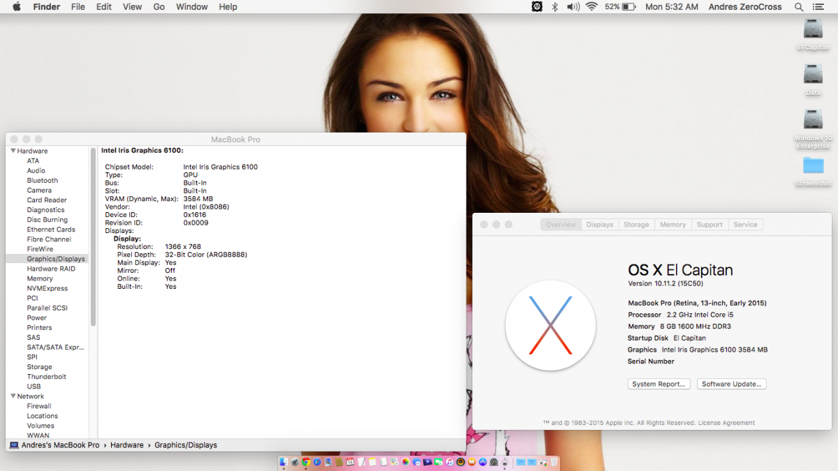

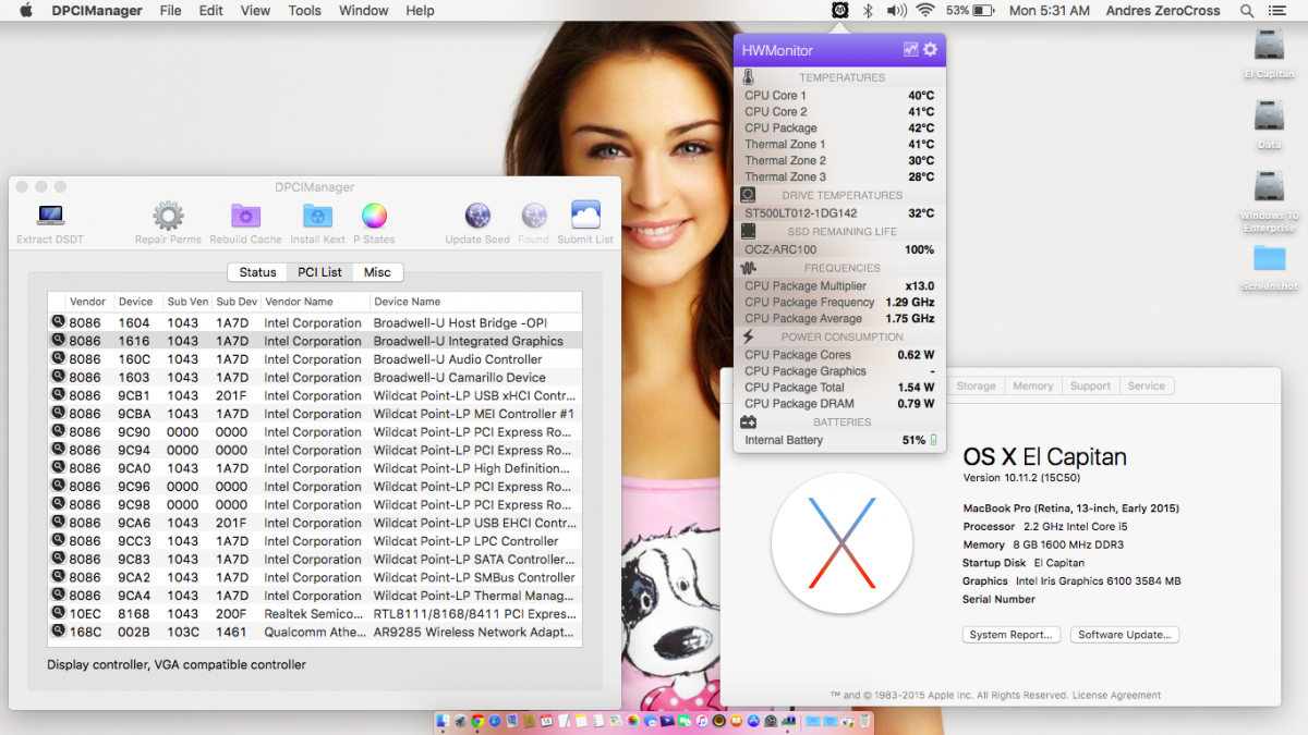

Andres ZeroCross Posted December 13, 2015 Share Posted December 13, 2015 What should i explain?? I just make USB installer El Capitan with CreateInstallMedia method, use latest clover, set DVMT at BIOS = 64MB. Then boot.Oh i almost forgot, i set ig-platform-id = 0x16260006.Working :- Full QE/CI - HDMI Out- Audio HDMI - VGA Output but not correct resolution - Sleep, restart, shutdown - Good Power Management You can see this screenshots 1 Link to comment https://www.insanelymac.com/forum/topic/305710-guide-intel-hd-graphics-5500-on-os-x-yosemite-10103/page/2/#findComment-2196891 Share on other sites More sharing options...
Solaris82 Posted December 13, 2015 Share Posted December 13, 2015 What should i explain?? I just make USB installer El Capitan with CreateInstallMedia method, use latest clover, set DVMT at BIOS = 64MB. Then boot. Oh i almost forgot, i set ig-platform-id = 0x16260006. Working : - Full QE/CI - HDMI Out - Audio HDMI - VGA Output but not correct resolution - Sleep, restart, shutdown - Good Power Management You can see this screenshots You can pass the guide used?It has intel hd 5500? Link to comment https://www.insanelymac.com/forum/topic/305710-guide-intel-hd-graphics-5500-on-os-x-yosemite-10103/page/2/#findComment-2196893 Share on other sites More sharing options...
Andres ZeroCross Posted December 13, 2015 Share Posted December 13, 2015 Yes,, you can see device id of my graphics card. See at screenshot it's "0x16168086". It's Intel HD Graphics 5500. I just edited model name to Intel HD 6100 with DSDT 1 Link to comment https://www.insanelymac.com/forum/topic/305710-guide-intel-hd-graphics-5500-on-os-x-yosemite-10103/page/2/#findComment-2196898 Share on other sites More sharing options...

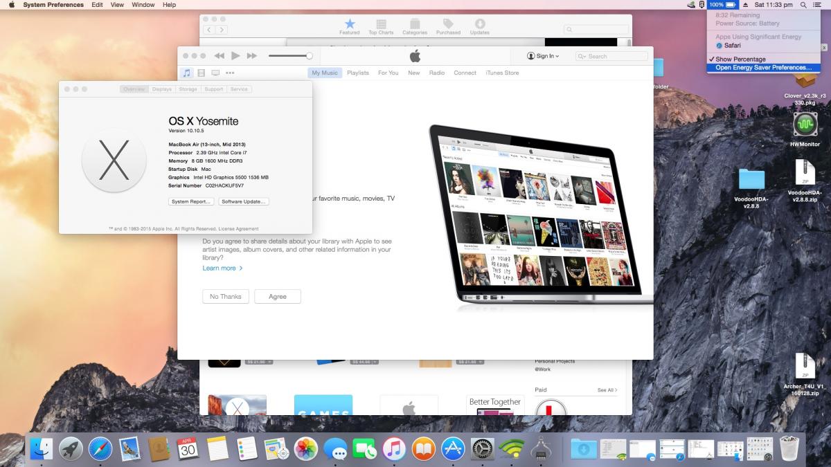

Shingo198199 Posted January 5, 2016 Share Posted January 5, 2016 Hi everyone, I am back again. I have actually succeeded in a Hackintosh on a Asus 303 LNB model. For this model, I have managed to work on it till almost everything is working, multi-tap, brightness controls, audio controls and I have even managed to DSDT an error free DSDT with battery patch with MACIASL. I am trying to help someone with an almost exact model. Asus 303L. In fact, what I can conclude from the specs , it is the exact same machine, same graphics, same Nvidia chip. Except that it comes with a small 32GB internal flash and a normal 750 GB HDD instead of SSD. The bootable USB booted up fine, no errors, no hiccups and I can proceed with everything that I am all too familiar with, since I have re-done my own Hackintosh a gazillion number of times while I am trying to get all the kexts and features in place. Everything worked without a glitch. However, the system hanged with the attached error. To make matters much more amazing. I can use the thumb drive as the bootable boot loader to boot up the HDD Mac OS and it will work fine. Say for instance, if I were to install Wi-Fi , it will work as long as I use the thumb drive as the bootloader to select the laptop's HDD. But If I use the clover on its own, it will hang. And the best part of it all, is that to determine what could be the cause. I only added FakeSMC.kext which is a mandatory kext and restarted to check if it will boot. Nope.. It hangs. With just one FakeSMC.kext And to top it off , if I simply wait it out, as it would only load like one quarter of the apple logo and hangs there, the whole laptop, actually goes to sleep . But I am not able to actually wake it up anyways. How is that even possible when the Mac OS is not even half loaded. I cannot even boot in safe mode, cpus=1 and I tried quite a handful of flags, but nope. I can pop in the thumb drive and it will load perfectly fine. What I cannot understand is that how can a laptop, load a thumb drive without issues, but yet fails to load on its own? A few additional things to note is that, the laptop does not seem be successful in loading the HD 5500 hex config 16160002 even though I have checked to ensure that it is correct. But the laptop is HD5500. I can bet my last dollar on it. Any ideas on this error as attached? Thanks in advance. Attach file as it seemed to have failed to attach in the previous post Link to comment https://www.insanelymac.com/forum/topic/305710-guide-intel-hd-graphics-5500-on-os-x-yosemite-10103/page/2/#findComment-2203068 Share on other sites More sharing options...

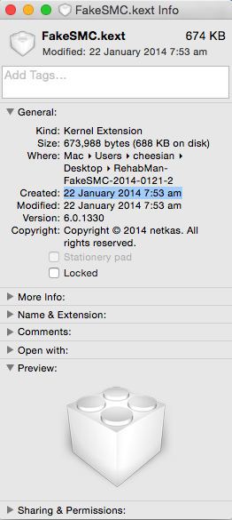

Shingo198199 Posted April 24, 2016 Share Posted April 24, 2016 Hi all, Just to update. Finalised build. I used the 6.0.1330 FakeSMC Kext dated 22 January 2014 7:53 am https://sourceforge.net/projects/hwsensors/files/ After which, simply let the Mac go to sleep once. Then wake it up and it will never hang or crash anymore. Runs a lot cooler as well. A notebook cooler is still highly recommended. As for Internal Wi-Fi for this model Asus 303LN . It is a work in progress here. https://github.com/ammulder/AppleIntelWiFiMVM This model looks like a good one to Hackintosh. Some forums say El-Captain will solve the random crash and freeze for good. Well.... time for a break before the El-Captain experiment. Link to comment https://www.insanelymac.com/forum/topic/305710-guide-intel-hd-graphics-5500-on-os-x-yosemite-10103/page/2/#findComment-2234104 Share on other sites More sharing options...
