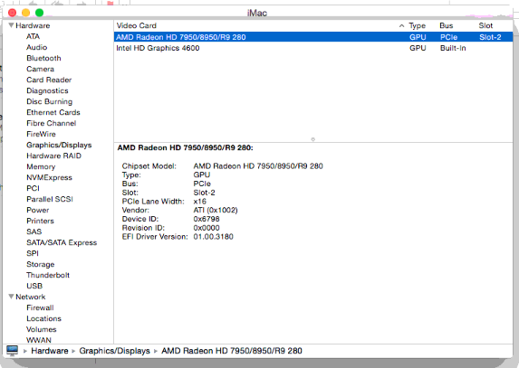

ledoktre Posted April 18, 2015 Author Share Posted April 18, 2015 Trying this : http://clover-wiki.zetam.org/Configuration/Devices#Inject With ID 0x67981002 (280x, vs my 280). They looked very similar, worth a shot!!! EDIT 1: Ok, with the primary graphics in bios set to Intel HD 4600, system will boot, and card appears to be detected as an AMD card now. It does not show the ACD, nor does it turn on. Could it be because ATI card requires to be primary over HD 4600? The bad part is, when I switch the primary graphics to PCI slot 1 or 2 (the card showed as slot 2 when booted up- irregardless neither made a difference) it hangs during boot as it did before. Tried ACD and a monitor on DVI port both - no difference. Ive attached what the system see's when the ATI is not the primary display. It is showing the new device id, so detecting should no longer be an issue. What would then cause the hang during boot? Any suggestions?? Quote Link to comment https://www.insanelymac.com/forum/topic/305694-having-trouble-with-an-r9-280-detecting/#findComment-2128976 Share on other sites More sharing options...
ledoktre Posted April 23, 2015 Author Share Posted April 23, 2015 I jumped on the chat here at InsanelyMac and people there had two things to say. I needed to patch the FB (frame buffer?) to see any results or since the card was new, return it and get a different one (their suggestion was to get the real R9 280x, not the R9 280 I had). Supposed to work OOTB. What I did in the end was tried another video card I had on hand, an older Raedeon with regular DP not Mini DP, and it worked like a charm. I bought a Mini DP to DP adapter from Amazon and called it good for now. Later on I'll probably buy a new card, but I'll be sure to check out which id's are supported first. Just wanted to write here in case it ends up helping anyone else. 1 Quote Link to comment https://www.insanelymac.com/forum/topic/305694-having-trouble-with-an-r9-280-detecting/#findComment-2130418 Share on other sites More sharing options...
