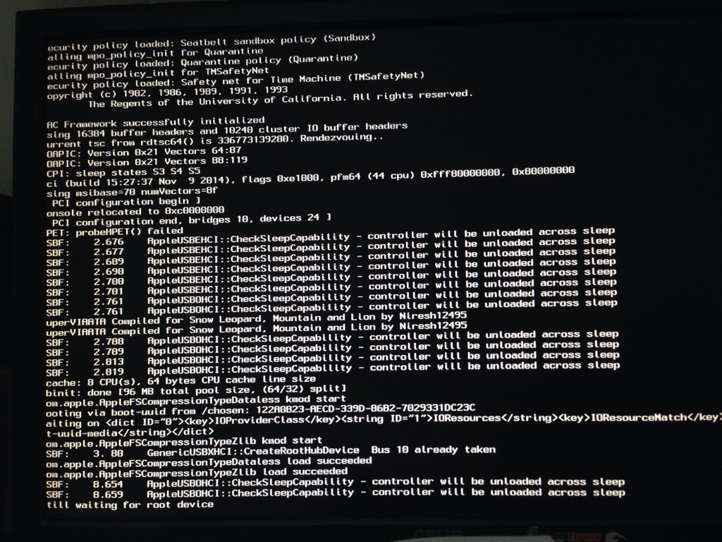

Askancy Posted April 2, 2015 Author Share Posted April 2, 2015 Ho avviato con /amd -v -x -f npci=0x2000 dart=0 Ora mi da in loop still waiting for root device Link to comment https://www.insanelymac.com/forum/topic/305400-yosemite-retail-su-fx9370/#findComment-2124895 Share on other sites More sharing options...
Agostino9446 Posted April 2, 2015 Share Posted April 2, 2015 ImageUploadedByTapatalk1427986447.010771.jpgImageUploadedByTapatalk1427986472.548966.jpg Ho avviato con /amd -v -x -f npci=0x2000 dart=0 Ora mi da in loop still waiting for root device Metti GraphicsEnabler=NoProva anche a cambiare porta usb alla pendrive...usando porte 2.0 Link to comment https://www.insanelymac.com/forum/topic/305400-yosemite-retail-su-fx9370/#findComment-2124901 Share on other sites More sharing options...
Askancy Posted April 2, 2015 Author Share Posted April 2, 2015 Metti GraphicsEnabler=NoGrazie mille per l'aiuto, ho rimesso la stringa che avevo prima e ho aggiunto questo pezzo ma solito erroreEdit: ora provo Link to comment https://www.insanelymac.com/forum/topic/305400-yosemite-retail-su-fx9370/#findComment-2124905 Share on other sites More sharing options...
Agostino9446 Posted April 2, 2015 Share Posted April 2, 2015 Prova USBBusFix=1 Link to comment https://www.insanelymac.com/forum/topic/305400-yosemite-retail-su-fx9370/#findComment-2124907 Share on other sites More sharing options...
Askancy Posted April 2, 2015 Author Share Posted April 2, 2015 Prova USBBusFix=1 Grazie mille funziona perfettamente! Ovviamente manca l'accelerazione grafica. proseguo con l'installazione normalmente? Link to comment https://www.insanelymac.com/forum/topic/305400-yosemite-retail-su-fx9370/#findComment-2124915 Share on other sites More sharing options...

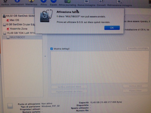

Askancy Posted April 2, 2015 Author Share Posted April 2, 2015 Si è ottimo chameleon ottimo, solo che non sò come mai, ma non mi legge nessun hdd esterno o pendrive... e quindi non sò come poter installare il bootloader o i kext... anche perchè internet non va lì Edit: ho notato che niresh mi ha installato in automatico clover... C'é la cartella EFI sull'hd mac os Link to comment https://www.insanelymac.com/forum/topic/305400-yosemite-retail-su-fx9370/#findComment-2124951 Share on other sites More sharing options...
Agostino9446 Posted April 2, 2015 Share Posted April 2, 2015 Resta su clover....usa clover configurator per inserire le stringhe nel config.plist cosi da non metterle piu al boot Link to comment https://www.insanelymac.com/forum/topic/305400-yosemite-retail-su-fx9370/#findComment-2124952 Share on other sites More sharing options...
Askancy Posted April 2, 2015 Author Share Posted April 2, 2015 Resta su clover....usa clover configurator per inserire le stringhe nel config.plist cosi da non metterle piu al boot ok grazie mille! invece, per far funzionare la rete o almeno gli hdd esterni (o anche pen drive) hai idee? Link to comment https://www.insanelymac.com/forum/topic/305400-yosemite-retail-su-fx9370/#findComment-2124954 Share on other sites More sharing options...
Agostino9446 Posted April 2, 2015 Share Posted April 2, 2015 Per gli hdd esterni ci sono due opzioni:nel desktop di yosemite clicca sulla mela vai su preferenze e spunti hdd esterni oppure vai utility disco selezioni l'hard disk e lo attivi Scarica il kext lo installi in system library extensions tramite kext wizard poi semprr da quest'ultimo ripari permessi e cache e riavvia il pc Ecco il link per il kext : http://www.hackintosh.zone/downloads/download/480-realtek-rtl8111-8168-kext/ Link to comment https://www.insanelymac.com/forum/topic/305400-yosemite-retail-su-fx9370/#findComment-2124958 Share on other sites More sharing options...
Askancy Posted April 2, 2015 Author Share Posted April 2, 2015 Per gli hdd esterni ci sono due opzioni:nel desktop di yosemite clicca sulla mela vai su preferenze e spunti hdd esterni oppure vai utility disco selezioni l'hard disk e lo attivi Scarica il kext lo installi in system library extensions tramite kext wizard poi semprr da quest'ultimo ripari permessi e cache e riavvia il pc Ecco il link per il kext : http://www.hackintosh.zone/downloads/download/480-realtek-rtl8111-8168-kext/ Con tutti gli hdd ho questo odioso problema, e se non riesco a risolverlo non posso installare nulla... :S Link to comment https://www.insanelymac.com/forum/topic/305400-yosemite-retail-su-fx9370/#findComment-2124974 Share on other sites More sharing options...
Agostino9446 Posted April 2, 2015 Share Posted April 2, 2015 Per questo problema non so aiutarti...per internet hai risolto? Link to comment https://www.insanelymac.com/forum/topic/305400-yosemite-retail-su-fx9370/#findComment-2124976 Share on other sites More sharing options...
Askancy Posted April 2, 2015 Author Share Posted April 2, 2015 Per questo problema non so aiutarti...per internet hai risolto?Purtroppo se non mi trova le periferiche di massa non posso installare il kext... Link to comment https://www.insanelymac.com/forum/topic/305400-yosemite-retail-su-fx9370/#findComment-2124978 Share on other sites More sharing options...
