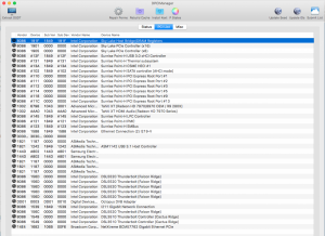

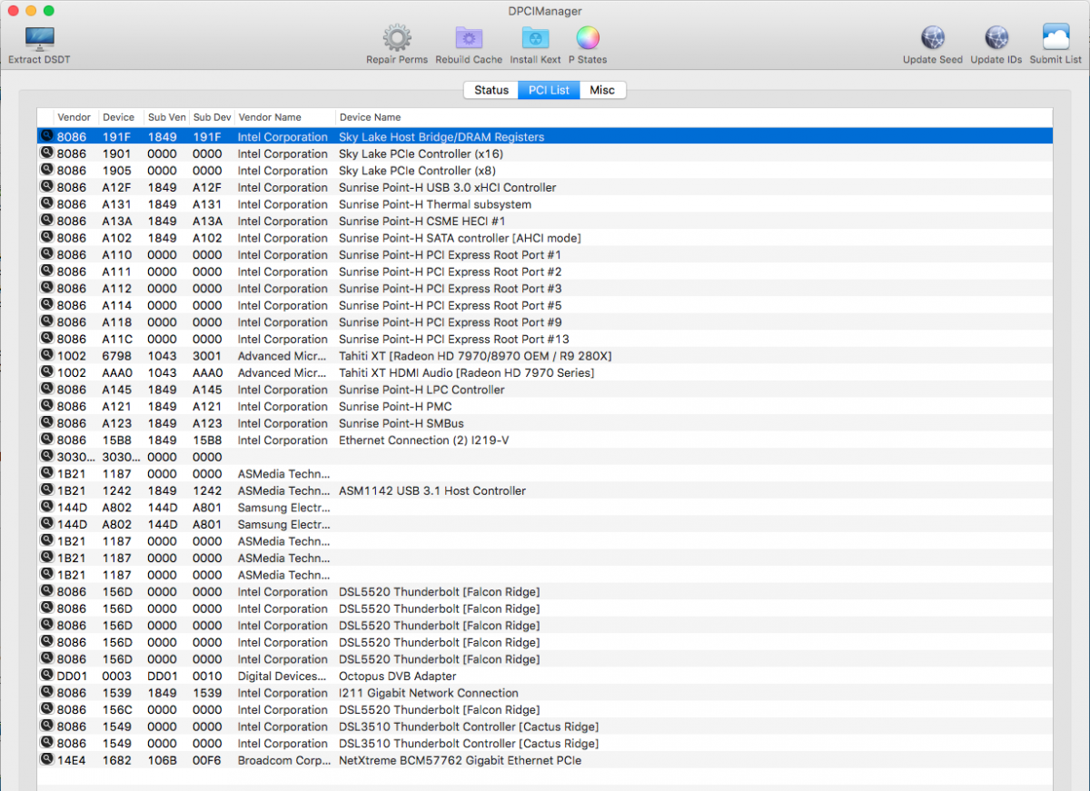

On my ASRock Extreme7+ Z170 Skylake machine i updated the card under Windows, restart the machin under El Capitan, and... NOTHING!?!
Restartet, deactivated Thunderbolt in BIOS (v3.00) and rebooted into El Capitan, and... BINGO, all connected Thunderbolt devices are availlable under El Capitan! Don't ask me why - but its the truth.
After shutdown and restart (with disabled Thunderbolt in BIOS): no Thunderbolt devices under WINDOWS or El Capitan. Have to restart with enabled Thunderbolt, boot into El Capitan, restart with disabled Thunderbolt in BIOS, boot into El Capitan - et voila... all thunderbolt devices avail. Don't understand why.... but who cares if it is working (this way).
Thats the way i configured my CLOVER config.plist:

First entry is for R9 280x GFX card, the rest for the ASUS Thunderbolt EX II DUAL card. DPCIManager lists the following PCIdevices:
