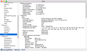

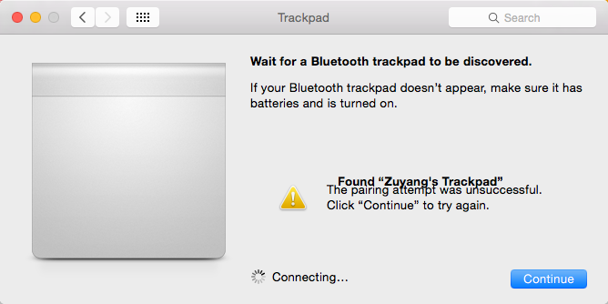

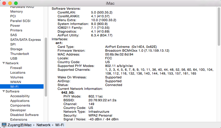

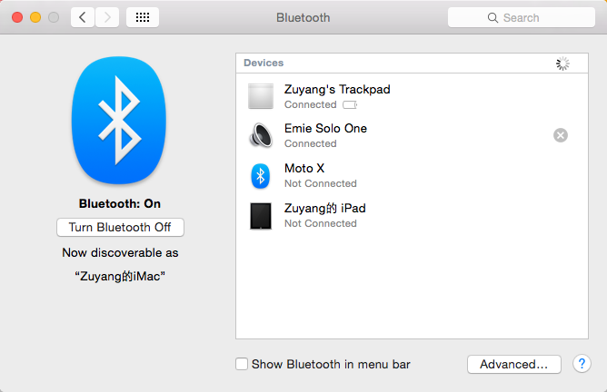

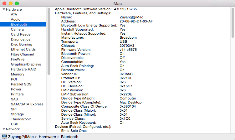

duguzuyang Posted March 13, 2015 Share Posted March 13, 2015 I have a BCM94352 card and I enable it's WIFI and Blurtooth on 10.10 Yosemite following instructions below:Bluetooth Firmware Uploader:Airport - PCIe Half Mini It works really fine, I got really fast 5G wifi and bluetoothWiFi:Bluetooth:The bluetooth works fine, I connect it to the speaker and it works really smooth.The only problem is that it can not connect to the Magic Trackpad: I try to pair with it, it sometimes says "connected" but do not show the battery status nor response to any movements on trackpad:Pairing in Preference-Trackpad also failed:Really need some help 1 Link to comment Share on other sites More sharing options...
