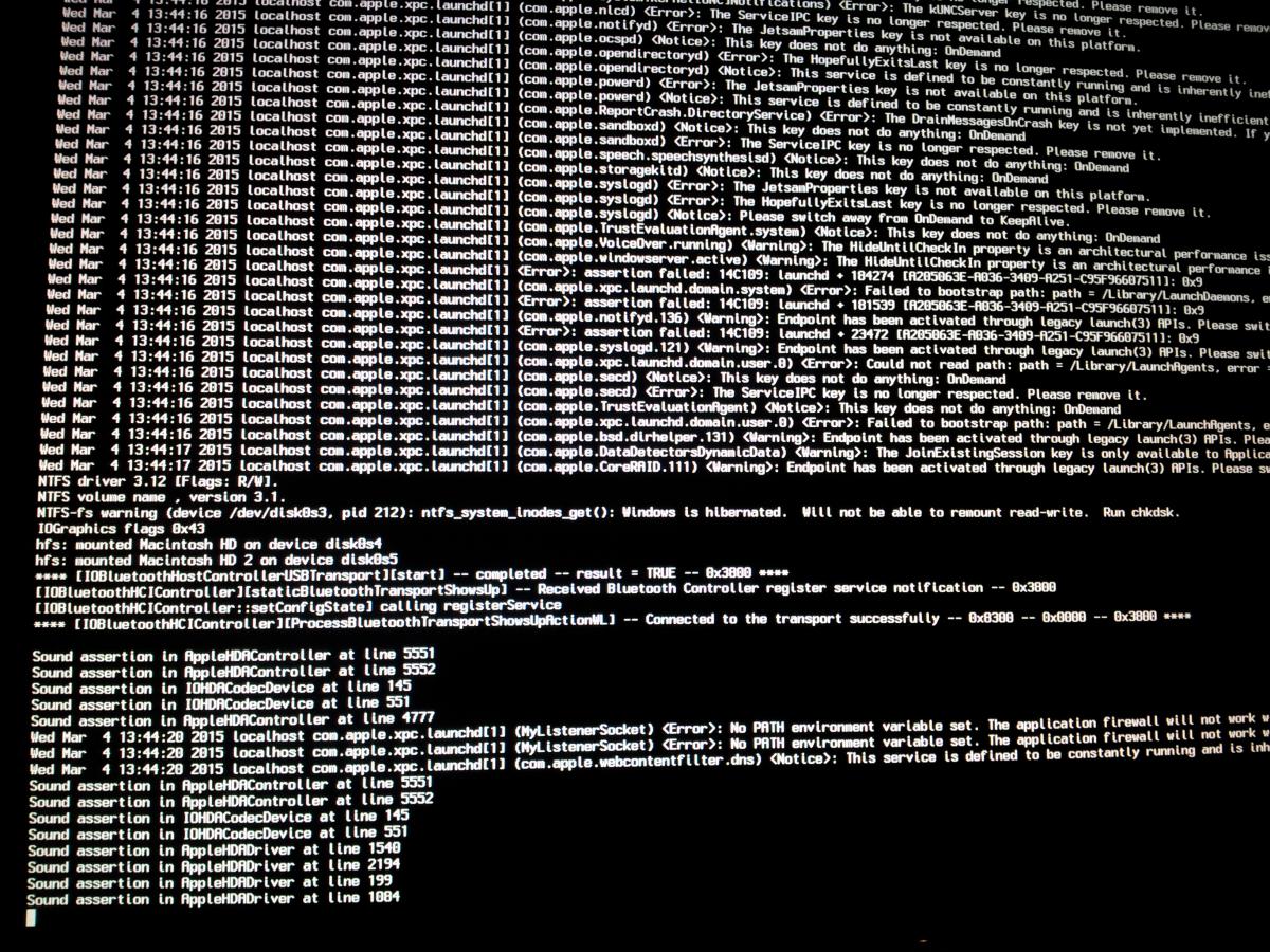

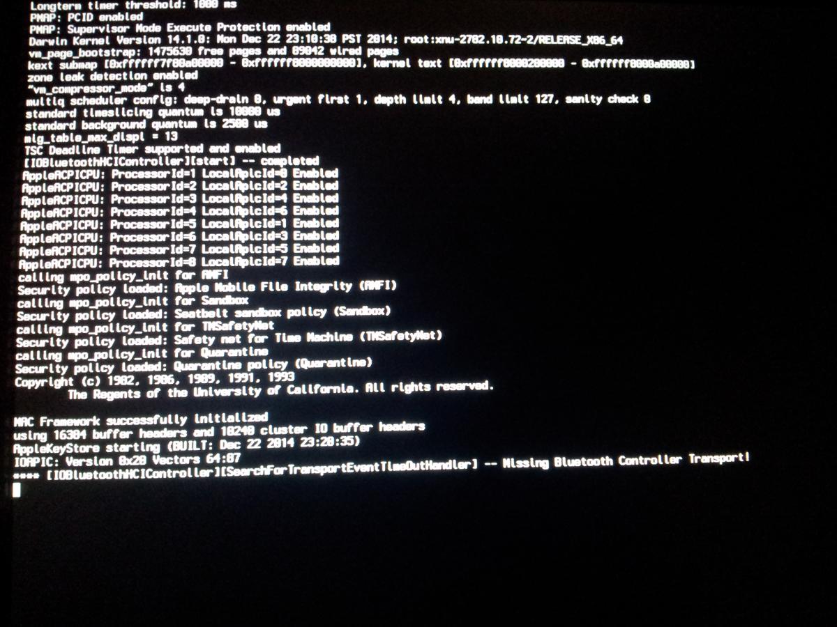

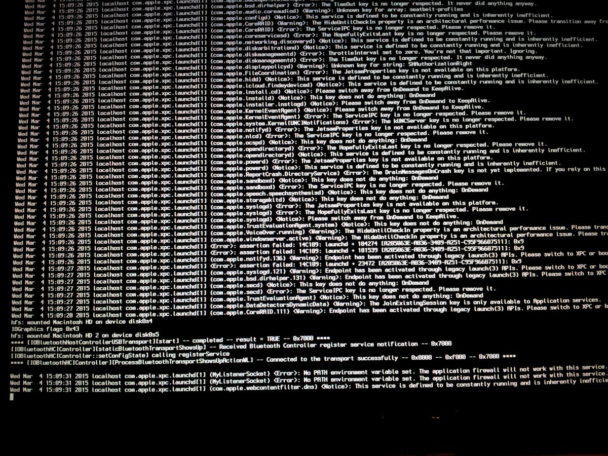

Tona102 Posted March 4, 2015 Author Share Posted March 4, 2015 Oh, looks like a tough on with this Atheros, as seen on forums… Anyway, here are two pics from Yosemite install boot from USB, with Clover and verbose mode! Here was the first stop, for about a minute... And here it eventually freezes, after a beach ball! Truth is, i use this configuration to boot into mavericks, and had made a lot of edits of plists for Clover to actually boot! I have a DSDT also, in clover efi partition too… Seems to be an audio issue?? And here, boot in safe mode: Stops here, about a minute into install. Link to comment https://www.insanelymac.com/forum/topic/304921-installed-mavericks-1092-on-asus-n750jv-dual-boot-with-win-81/#findComment-2117831 Share on other sites More sharing options...

Jithin Chandran Posted March 5, 2015 Share Posted March 5, 2015 I am not sure whether your AR9485 will natively support by OS X. Might be you have to do necessary DSDT changes to make your AR9485 detect. For installation, it is better to remove the DSDT and all patched kexts. Make the bootable USB with kexts which are Mandatory required for running OS X Installer (FakeSMC.kext,VoodooPS2Controller,etc) Link to comment https://www.insanelymac.com/forum/topic/304921-installed-mavericks-1092-on-asus-n750jv-dual-boot-with-win-81/#findComment-2117937 Share on other sites More sharing options...

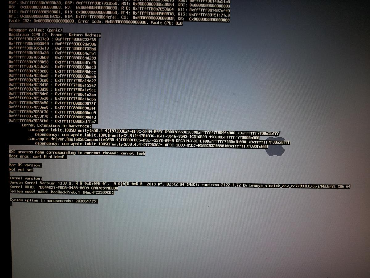

Tona102 Posted March 5, 2015 Author Share Posted March 5, 2015 Right, should mention this also; my boot every once in a while (but quite often!) KPs with this: And after reboot, it usually goes ok! hello 9485 is not supported in os x 2 options usb wifi change it by a compatible card good hack Ok, thanks Artur-pt! I guess there's no way then… Will concentrate on other things, such as bluetooth and Geforce! This laptop has two Graphics cards supposedly, Intel and Geforce GT 750M, see if i can make it work! Link to comment https://www.insanelymac.com/forum/topic/304921-installed-mavericks-1092-on-asus-n750jv-dual-boot-with-win-81/#findComment-2117984 Share on other sites More sharing options...
