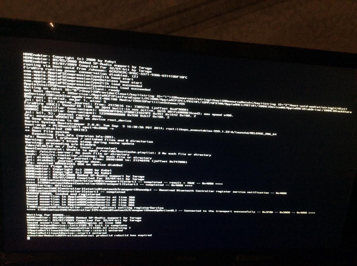

christyfernando Posted January 10, 2015 Share Posted January 10, 2015 Hi friends I managed to install Yosemite on my pic without any problems.but now after installation on reboot it hangs on start.I attached also the image where it get hang.any solutions please.thank you all Link to comment https://www.insanelymac.com/forum/topic/303827-problem-after-install/ Share on other sites More sharing options...
artur_pt Posted January 10, 2015 Share Posted January 10, 2015 hello must use kext-dev-mode=1 flag u have unsigned kext then rebuild cache good hack Link to comment https://www.insanelymac.com/forum/topic/303827-problem-after-install/#findComment-2102027 Share on other sites More sharing options...
