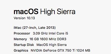

Nikhil Chandran Posted July 14, 2018 Share Posted July 14, 2018 Same here, VGA Works fine. But all the 3 port are disabled. And in About this Mac tab VRam shows only 1024MB , But mine is 2GB Link to comment Share on other sites More sharing options...
