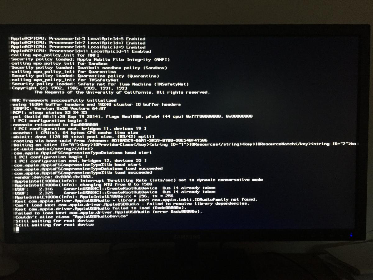

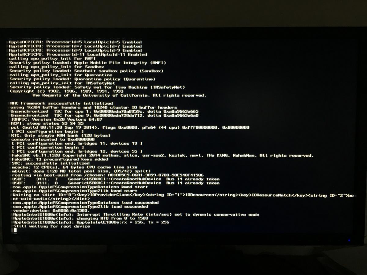

micha2411 Posted January 2, 2015 Share Posted January 2, 2015 Hey guys, first of all I want to wish everyone a happy new year. I got a problem with installing OS X onto my Computer. The installation stucks every time. Hardware Specs: GigaByte X79-UD3 X79 RG SA Intel Core i7-4930k 3400 2011 XFX 4GB D5 X R9 290 Core Edition R DDR3 16 GB 1600 128 GB SSD + 1 TB HDD I am using the bootflags -v -x npci=0x3000 USBBusFix=Yes Additionaly I have added the GenericUSBXHC 432 kext to the stick. A picture of the problem is attached. Thanks for your help in advance. ///// EDIT: Hi guys, its me again. I fixed this issue by adding cpus=1 / npci=0x2000 instead of 0x3000 to the bootflags. Now the installer is stuck at another point. I added a picture. Link to comment https://www.insanelymac.com/forum/topic/303696-yosemite-installer-stuck/ Share on other sites More sharing options...
