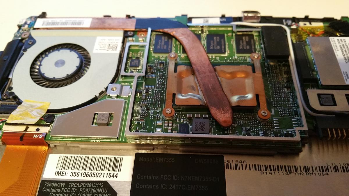

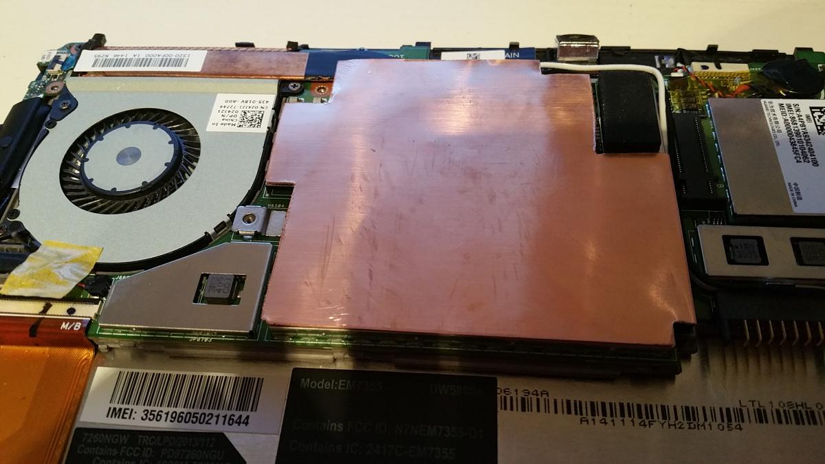

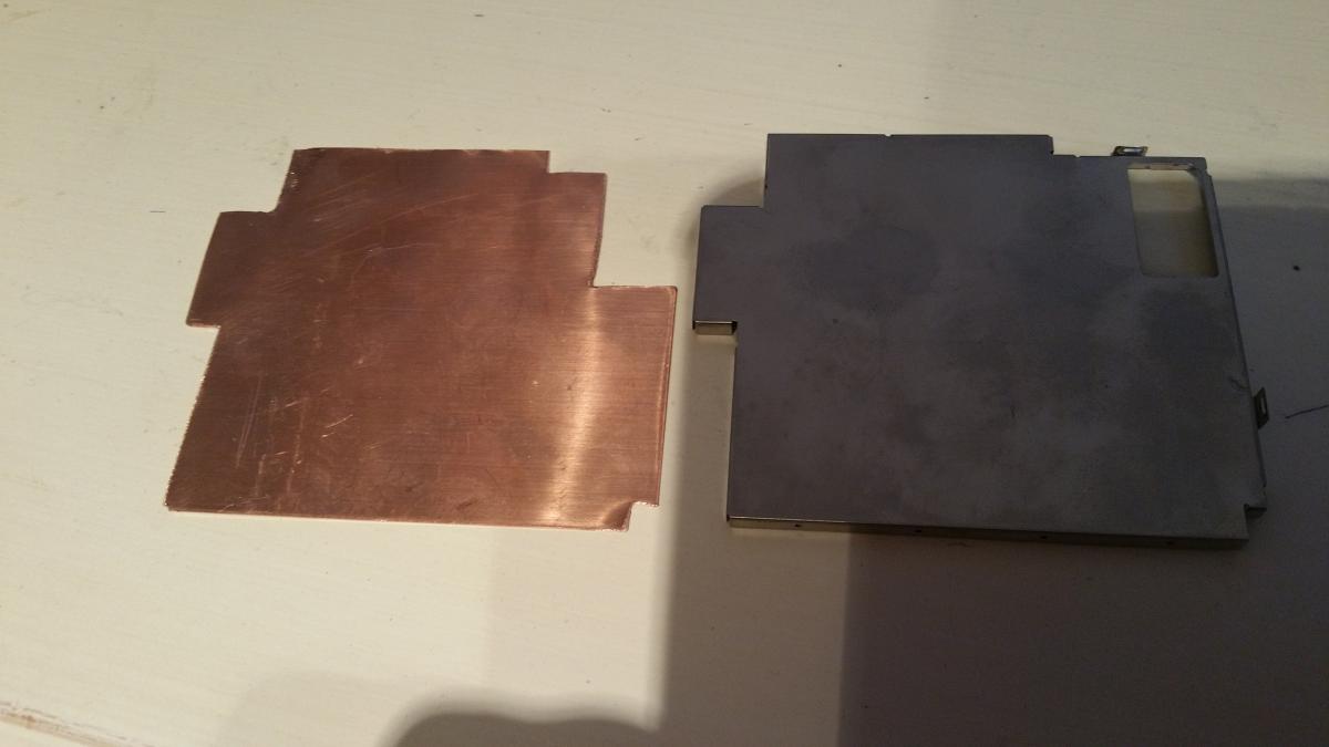

wokawoka Posted April 3, 2015 Share Posted April 3, 2015 I replaced the aluminum shield with a copper plate and used thermal adhesive to permanently bond it to the CPU heatsink and heatpipe. I drilled holes in the plate so that the entire heatsink assembly can be removed as one unit. It made a tremendous difference in the cooling system under Windows at least. Very interesting! Would it be possible to have a picture of this mod? It sounds really useful. Does the copper plate stays over the battery as well? I've seen some mods where they were using a large copper plate but that was lying over the battery as well, and I think that the battery would be damaged from the heat on the long run. Link to comment Share on other sites More sharing options...
blankmac Posted April 3, 2015 Share Posted April 3, 2015 Very interesting! Would it be possible to have a picture of this mod? It sounds really useful. Does the copper plate stays over the battery as well? I've seen some mods where they were using a large copper plate but that was lying over the battery as well, and I think that the battery would be damaged from the heat on the long run. I only have some photos of the test fitting. It basically covers the area of the original aluminum shield. The only difference in the final version is that I drilled some holes where the original heatsink screws are so that the assembly can be removed just in case I need to revert it to stock for some reason. I used 26 gauge copper. You might be able to go a little thicker but not much more. It's also very important to be careful with the thermal adhesive because it's pretty much permanent so if it oozes onto the board that could be trouble. If you're upping the TDP it really helps, otherwise there's no need to do this. Removing the exhaust vent mesh is another way to increase efficiency. Link to comment Share on other sites More sharing options...
wokawoka Posted April 4, 2015 Share Posted April 4, 2015 Thank you so much for the pictures! Very nice mod. I'm thinking about starting by removing the exaust vent mesh, as already suggested. I'm just a little concerned about the possibility that on the long run dust and dirt could get inside the unit more easily from there. What do you think about it? Just the last question, guys: last week I got an i5 4300Y 4GB model, but I still have to find the time to try an OSX install on this machine though. Before starting, I just would like to know which is the situation about the compatibility at the moment. I don't mind if the touchscreen doesn't work, but I just would like to know if you guys in the meanwhile were able to get standby and the touchpad of the mobile keyboard to work. Link to comment Share on other sites More sharing options...

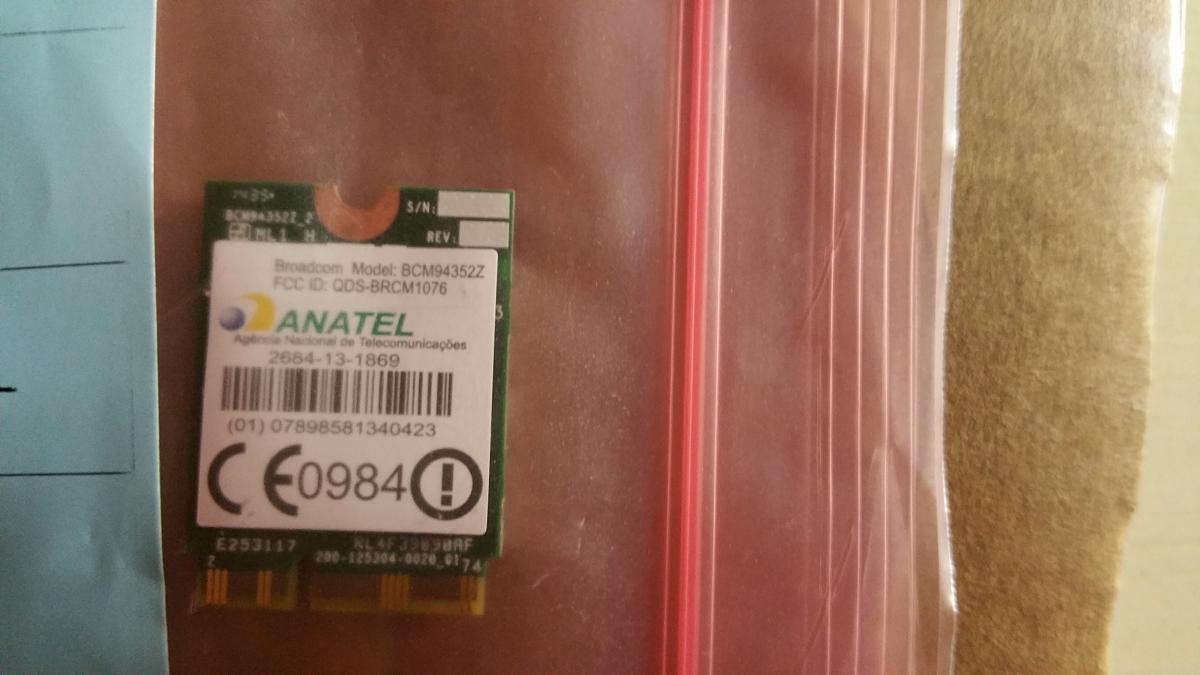

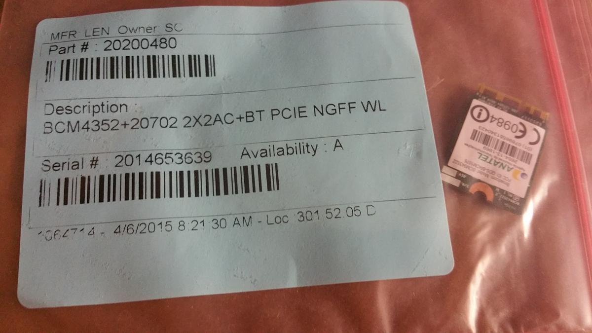

blankmac Posted April 8, 2015 Share Posted April 8, 2015 Just an FYI for those in the US. Partstore.com sells the bcm94352z card under Lenovo part # 20200480, $33 shipped (at least for me in Kentucky). Apparently the stock comes and goes, but it's worth checking from time to time if you're looking for the card. It's referenced a couple different places on Insanelymac but I figured I'd add it to the thread. Link to comment Share on other sites More sharing options...
