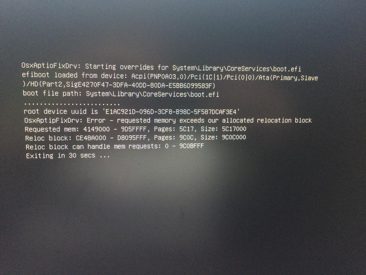

Hackmodford Posted November 10, 2014 Share Posted November 10, 2014 My installation was working just fine. However now when I try to boot I get this message Any suggestions for how to fix this? Link to comment https://www.insanelymac.com/forum/topic/302509-clover-boot-error/ Share on other sites More sharing options...
carbo178 Posted November 10, 2014 Share Posted November 10, 2014 And with chameleon works fine? Link to comment https://www.insanelymac.com/forum/topic/302509-clover-boot-error/#findComment-2083697 Share on other sites More sharing options...
artur_pt Posted November 10, 2014 Share Posted November 10, 2014 hello try to use aptiofix2 http://www.projectosx.com/forum/index.php?act=attach&type=post&id=7888 good hack Link to comment https://www.insanelymac.com/forum/topic/302509-clover-boot-error/#findComment-2083699 Share on other sites More sharing options...
slayer2333 Posted November 10, 2014 Share Posted November 10, 2014 I see that you have an Nvidia GTX 760 4GB, are you using the Nvidia web drivers by any chance ? If so, there are high chances that the web drivers are the cause for this problem. Link to comment https://www.insanelymac.com/forum/topic/302509-clover-boot-error/#findComment-2083700 Share on other sites More sharing options...
Hackmodford Posted November 10, 2014 Author Share Posted November 10, 2014 Yes I do use the web drivers. Should I remove the boot argument? I already have aptiofix in the custom bios. I'm assuming this is a newer version? What would I do in this case? Link to comment https://www.insanelymac.com/forum/topic/302509-clover-boot-error/#findComment-2083701 Share on other sites More sharing options...
slayer2333 Posted November 10, 2014 Share Posted November 10, 2014 Yes I do use the web drivers. Should I remove the boot argument? I already have aptiofix in the custom bios. I'm assuming this is a newer version? What would I do in this case? If you have Chameleon boot loader, try to boot from there and uninstall the Nvidia Web Drivers, rebuild caches and reboot from clover. If you don't have Chameleon try to remove the nvda_drv=1 argument at boot. Link to comment https://www.insanelymac.com/forum/topic/302509-clover-boot-error/#findComment-2083707 Share on other sites More sharing options...
Hackmodford Posted November 10, 2014 Author Share Posted November 10, 2014 removing the boot argument did not fix anything. Using aptiofix2 didn't help either. I believe this is because the first version is embedded in my bios Link to comment https://www.insanelymac.com/forum/topic/302509-clover-boot-error/#findComment-2083795 Share on other sites More sharing options...
Cobra03 Posted November 12, 2014 Share Posted November 12, 2014 I had this same error....It came after trying to inject WIFI card info for me....Tried to fix it many ways with no luck...I was however, able to boot the system by making a USB clover boot device with legacy settings(non-UEFI). So it seems to be UEFI related. Link to comment https://www.insanelymac.com/forum/topic/302509-clover-boot-error/#findComment-2084377 Share on other sites More sharing options...
carbo178 Posted November 12, 2014 Share Posted November 12, 2014 removing the boot argument did not fix anything. Using aptiofix2 didn't help either. I believe this is because the first version is embedded in my bios I had this same error....It came after trying to inject WIFI card info for me....Tried to fix it many ways with no luck...I was however, able to boot the system by making a USB clover boot device with legacy settings(non-UEFI). So it seems to be UEFI related. Try to see the size of the kernel in System/Library/Kernels, should be 10,6Mb, if it's of this size, you can try to start without cache, if it does not work try to delete the file prelinkedkernel (System/Library/PrelinkedKernel). If the kernel size is not 10,6Mb you can extract original kernel from Yosemite image or app (OS X InstallESD/Packages/Essentials.pkg/System/Library/Kernels/Kernel), use Pacifist for this operation, then put the kernel on the right folder Link to comment https://www.insanelymac.com/forum/topic/302509-clover-boot-error/#findComment-2084392 Share on other sites More sharing options...
Alex Mac Posted November 13, 2014 Share Posted November 13, 2014 I have a similar error that happened after installing chimera 4.01, with previous versions of that I could boot either clover in uefi or chameleon in legacy without issues. In my output appears cant find mach-kernel in mavericks or kernel in yosemite...I suspect there must be something related to kernelcache=yes to path to kernel has to be put in someway into clover config...any sugestion? Link to comment https://www.insanelymac.com/forum/topic/302509-clover-boot-error/#findComment-2084878 Share on other sites More sharing options...
Hackmodford Posted November 13, 2014 Author Share Posted November 13, 2014 Try to see the size of the kernel in System/Library/Kernels, should be 10,6Mb, if it's of this size, you can try to start without cache, if it does not work try to delete the file prelinkedkernel (System/Library/PrelinkedKernel). If the kernel size is not 10,6Mb you can extract original kernel from Yosemite image or app (OS X InstallESD/Packages/Essentials.pkg/System/Library/Kernels/Kernel), use Pacifist for this operation, then put the kernel on the right folder Is this something I can do from the recovery partition? That one boots fine. Link to comment https://www.insanelymac.com/forum/topic/302509-clover-boot-error/#findComment-2084949 Share on other sites More sharing options...
crusher Posted November 13, 2014 Share Posted November 13, 2014 First try install another Clover!!Second try to change OsxAptioFix for this link....Maybe you use this command sudo kextcache -prelinked-kernel?This command wants to do a problem on Clover!!!! After go to S/L/E/Cache and remove kernelcache!!!! Link to comment https://www.insanelymac.com/forum/topic/302509-clover-boot-error/#findComment-2084962 Share on other sites More sharing options...
