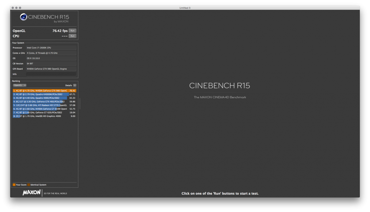

The Real Deal Posted November 7, 2014 Share Posted November 7, 2014 Thx for the report. The purpose of nv disable 1 is to disable to nvidia kexts? latest drivers + nvda drv 1 does not work? I don't get it. Link to comment https://www.insanelymac.com/forum/topic/302429-yosemite-gtx-9xx750750-ti-compatibility-report/#findComment-2082483 Share on other sites More sharing options...
jamiethemorris Posted November 7, 2014 Author Share Posted November 7, 2014 Thx for the report. The purpose of nv disable 1 is to disable to nvidia kexts? latest drivers + nvda drv 1 does not work? I don't get it. Sorry for the confusion... I have nv_disable=1 set it my config.plist so it doesn't kernel panic on boot in Mavericks. When was testing Yosemite, I just manually changed nv_disable=1 to nvda_drv=1 and added kext-dev-mode=1 at the Clover menu. 1 Link to comment https://www.insanelymac.com/forum/topic/302429-yosemite-gtx-9xx750750-ti-compatibility-report/#findComment-2082491 Share on other sites More sharing options...
The Real Deal Posted November 8, 2014 Share Posted November 8, 2014 No problemo Power management is fine? Do you have a Cinebench score? Thanks. Link to comment https://www.insanelymac.com/forum/topic/302429-yosemite-gtx-9xx750750-ti-compatibility-report/#findComment-2082660 Share on other sites More sharing options...

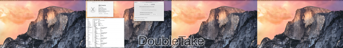

aphex6b Posted November 9, 2014 Share Posted November 9, 2014 It seems like if you want a 9xx card, having one with 3 display ports such as the reference-based GTX 980s (i.e. not the Asus Strix) or the Gigabyte GTX 970s is crucial if you want to use multiple displays. Hi. I just got a Asus Strix 970 last week. I am using a double / triple screen setup including a 4k one and it works ok. Tested DP output and HDMI working fine. 2 Link to comment https://www.insanelymac.com/forum/topic/302429-yosemite-gtx-9xx750750-ti-compatibility-report/#findComment-2083286 Share on other sites More sharing options...
jamiethemorris Posted November 11, 2014 Author Share Posted November 11, 2014 Hi. I just got a Asus Strix 970 last week. I am using a double / triple screen setup including a 4k one and it works ok. Tested DP output and HDMI working fine. Nice, do you get 60 Hz with 4k? Link to comment https://www.insanelymac.com/forum/topic/302429-yosemite-gtx-9xx750750-ti-compatibility-report/#findComment-2083919 Share on other sites More sharing options...

jamiethemorris Posted November 12, 2014 Author Share Posted November 12, 2014 Wow those are actually pretty disappointing scores after looking what others seem to be getting. Oh well, I don't use OS X for anything graphics intensive anyway. Link to comment https://www.insanelymac.com/forum/topic/302429-yosemite-gtx-9xx750750-ti-compatibility-report/#findComment-2084307 Share on other sites More sharing options...

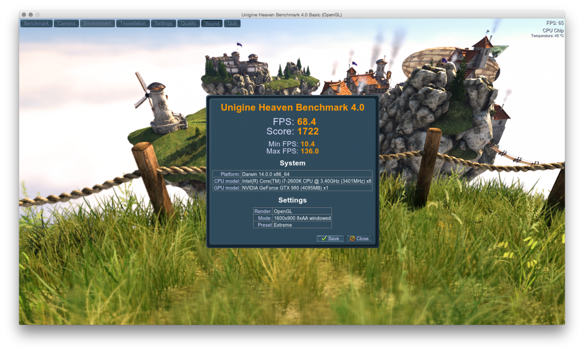

jamiethemorris Posted November 12, 2014 Author Share Posted November 12, 2014 I use a Inno3D GTX 970 OC 4GB in 10.10 with Nvidia webdrivers. Clover as bootloader. The performance is very low. Does anyone know what to do? Performance is pretty bad for me as well. Not as far as usability goes, but the benchmarking I've done is pretty pathetic... What's strange is that other people using the 970 and 980 on other forums seem to have great performance in OS X, both in Mac Pros and hackintoshes. Is your hack just scoring low with benchmarks or is it slow when you are using it normally? Link to comment https://www.insanelymac.com/forum/topic/302429-yosemite-gtx-9xx750750-ti-compatibility-report/#findComment-2084373 Share on other sites More sharing options...
Edkroket Posted November 12, 2014 Share Posted November 12, 2014 Performance is pretty bad for me as well. Not as far as usability goes, but the benchmarking I've done is pretty pathetic... What's strange is that other people using the 970 and 980 on other forums seem to have great performance in OS X, both in Mac Pros and hackintoshes. Is your hack just scoring low with benchmarks or is it slow when you are using it normally? Just low in benchmarks not in normal use. I'll try to find the f01 Webdrivers as I have read that others have better perfomance with that. I'll keep posted the results Link to comment https://www.insanelymac.com/forum/topic/302429-yosemite-gtx-9xx750750-ti-compatibility-report/#findComment-2084417 Share on other sites More sharing options...
jamiethemorris Posted November 12, 2014 Author Share Posted November 12, 2014 Just low in benchmarks not in normal use. I'll try to find the f01 Webdrivers as I have read that others have better perfomance with that. I'll keep posted the results Cool, I forget if I tried the benchmarks with f01 or f02. I'll make sure to test f02 when I get home. Link to comment https://www.insanelymac.com/forum/topic/302429-yosemite-gtx-9xx750750-ti-compatibility-report/#findComment-2084477 Share on other sites More sharing options...

jamiethemorris Posted November 13, 2014 Author Share Posted November 13, 2014 Edkroket are you using multiple monitors? Try turning off "displays have separate spaces." I haven't had a chance to try it yet as my machine is in Mavericks right now cloning my Windows drive and it's taking 13+ hours. Link to comment https://www.insanelymac.com/forum/topic/302429-yosemite-gtx-9xx750750-ti-compatibility-report/#findComment-2084677 Share on other sites More sharing options...

aphex6b Posted November 13, 2014 Share Posted November 13, 2014 Did you experience issues with CoreImage / OpenCL on the 980? Because with the prev drivers (the 10.10.0) one, i had it i.e when using quick-look. Performance in general (desktop effects) are way better compared to 660Ti here running @ 4k. Also i do not understand why turning off "displays have separate spaces" gives better performance in general. I just want Snow Leo's ' Spaces' back. Link to comment https://www.insanelymac.com/forum/topic/302429-yosemite-gtx-9xx750750-ti-compatibility-report/#findComment-2084831 Share on other sites More sharing options...
jamiethemorris Posted November 13, 2014 Author Share Posted November 13, 2014 Did you experience issues with CoreImage / OpenCL on the 980? Because with the prev drivers (the 10.10.0) one, i had it i.e when using quick-look. Performance in general (desktop effects) are way better compared to 660Ti here running @ 4k. Also i do not understand why turning off "displays have separate spaces" gives better performance in general. I just want Snow Leo's ' Spaces' back.It doesn't give better performance, I just wanted to try it. Makes no difference though. I haven't had any weird opencl problems. If you like SL's spaces you should give TotalSpaces a try. It's pretty much exactly like spaces with some extra goodies. Link to comment https://www.insanelymac.com/forum/topic/302429-yosemite-gtx-9xx750750-ti-compatibility-report/#findComment-2084906 Share on other sites More sharing options...
jamiethemorris Posted November 13, 2014 Author Share Posted November 13, 2014 So I checked the benchmarks I was talking about. On voldemort's forum people seem to be getting around 100 fps in Yosemite, and on macrumors people are also getting around 100 fps in their Mac pros, also in Yosemite. No idea what is wrong with our configuration. Fwiw I'm using clover. I really don't think that matters though... Maybe it has something to do with using the legacy part of the vbios as opposed to uefi?? Link to comment https://www.insanelymac.com/forum/topic/302429-yosemite-gtx-9xx750750-ti-compatibility-report/#findComment-2084953 Share on other sites More sharing options...
jamiethemorris Posted November 14, 2014 Author Share Posted November 14, 2014 I just tried the following: -Enabling LoadVbios in config.plist without supplying a rom to force it to load legacy vbios. -Injecting Nvidia (resulted in only 1 monitor working. all of them probably would have worked if I use NVCAP). -Using LoadVbios to load a modded overclocked MSI GTX 980 vbios. -Using LoadVbios to load an EVGA GTX 9809 reference vbios. -Various SMBios: MP31, MP5,1, iMac14,2 Still getting around 75 fps scores. Link to comment https://www.insanelymac.com/forum/topic/302429-yosemite-gtx-9xx750750-ti-compatibility-report/#findComment-2085024 Share on other sites More sharing options...
bbeepp Posted November 19, 2014 Share Posted November 19, 2014 I think that your low cinebench score is caused by your CPU and PCI 3.0 not being used. I have the same 2700k CPU and my GTX 780 scores only 72 fps. The difference between Windows and OSX scores are huge and I don't know the reason why. On the other hand on newer motherboards with 4k cpu series your score would be above 100fps easily on OSX. Use another benchmark, like furmark, which does not depens so much on CPU. Link to comment https://www.insanelymac.com/forum/topic/302429-yosemite-gtx-9xx750750-ti-compatibility-report/#findComment-2087112 Share on other sites More sharing options...

jamiethemorris Posted November 20, 2014 Author Share Posted November 20, 2014 @bbeepp I would be inclined to agree except that people are getting 100 fps scores on old Mac pros, which obviously have older hardware - slower CPU, less pcie bandwidth, etc. @illfatedIM you are the first person I have heard of that has HDMI/dp audio working. Can you post an ioreg dump of before and after the cable is unplugged? Link to comment https://www.insanelymac.com/forum/topic/302429-yosemite-gtx-9xx750750-ti-compatibility-report/#findComment-2087400 Share on other sites More sharing options...
bbeepp Posted November 20, 2014 Share Posted November 20, 2014 I haven't seen any good Cinebench GPU results on Mac Pro with Nvidia GPU. They are even worse than ours: http://forums.macrumors.com/showthread.php?t=1759078 Link to comment https://www.insanelymac.com/forum/topic/302429-yosemite-gtx-9xx750750-ti-compatibility-report/#findComment-2087501 Share on other sites More sharing options...
