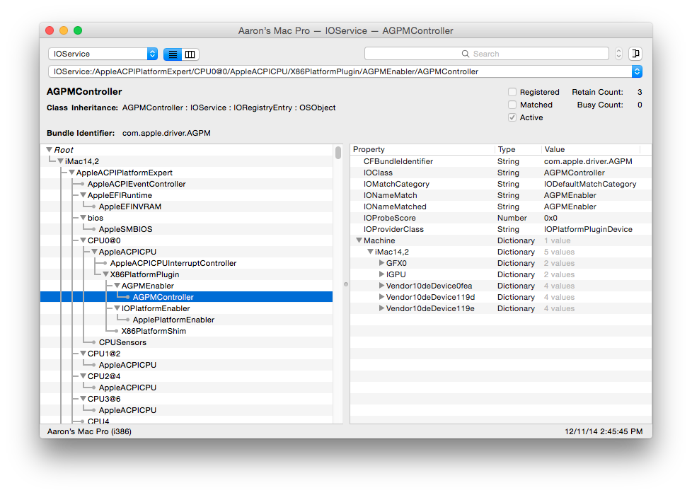

taaronnicholson Posted December 11, 2014 Share Posted December 11, 2014 Edseven's post has me confused. He says he changed info.plist in AppleGraphicsPowerManagement.kext, yet I cannot find that file when I show AGPM's contents. He shows this code: <dict> <key>Comment</key> <string>Nvidia ID AGPM</string> <key>Find</key> <string>Vendor10deDevice119e</string> <key>InfoPlistPatch</key> <true/> <key>Name</key> <string>AppleGraphicsPowerManagement</string> <key>Replace</key> <string>Vendor10deDevice1004</string> </dict> I know I need to substitute my own values, but I don't know where to place the quoted code. Does it go in AGPM's info.plist or in Clover's config.plist? OK, I figured out that I need to use this in Clover's config.plist. There are two sets of values there. I know my vendor id and device id, but I don't know what value I should have Clover find to replace. Link to comment https://www.insanelymac.com/forum/topic/302041-guide-asrock-h97-pro4-yosemite-with-clover-uefi-installation/page/2/#findComment-2094227 Share on other sites More sharing options...
rednous Posted December 11, 2014 Author Share Posted December 11, 2014 There are two sets of values there. I know my vendor id and device id, but I don't know what value I should have Clover find to replace. info.plist of AppleGraphicsPowerManagement.kext [iMac14,2 (Mac-27ADBB7B4CEE8E61) is expanded]: Link to comment https://www.insanelymac.com/forum/topic/302041-guide-asrock-h97-pro4-yosemite-with-clover-uefi-installation/page/2/#findComment-2094264 Share on other sites More sharing options...
taaronnicholson Posted December 11, 2014 Share Posted December 11, 2014 I applied the following to patch AGPM as edseven did in his post, using Vendor10deDevice1187 since I have GTX 760 : <dict> <key>Comment</key> <string>Nvidia ID AGPM</string> <key>Find</key> <string>Vendor10deDevice119d</string> <key>InfoPlistPatch</key> <true/> <key>Name</key> <string>AppleGraphicsPowerManagement</string> <key>Replace</key> <string>Vendor10deDevice1187</string> There was no change. AGPM looks the same both before and after the patch. EDIT: After inspecting further, I found that System Information shows: Chipset Model: NVIDIA GeForce GTX 760 Type: GPU Bus: PCIe Slot: PCI Slot 0 PCIe Lane Width: x16 VRAM (Total): 2048 MB Vendor: NVIDIA (0x10de) Device ID: 0x119e Revision ID: 0x00a2 ROM Revision: preset 1.0.0 119e is not the correct device id for GTX 760, it should be 1187. Maybe I got my values swapped in config.plist. Now, when I select Sleep from the Apple menu the display goes dark as before, the fans run full speed as before, but the HDD does not spin down. However, it wakes! Progress made! Attempting Sleep a second time resulted in the original results: dark display, HDD spindown, fans rolling, no wake. EDIT 2: I tried The Real Deal's solution in the thread you linked and now I have localhost kernel[0]: [AGPM Controller] build GPUDict by Vendor10deDevice119e. Yay! It seemed to make no difference in behavior though, until I removed my TRENDnet Wifi USB adapter. Now it sleeps and wakes properly. The USB dongle may have been the culprit all along. I'm going to look into a more native solution for wifi, such as a Broadcom PCI card. Thanks for your help here! 1 Link to comment https://www.insanelymac.com/forum/topic/302041-guide-asrock-h97-pro4-yosemite-with-clover-uefi-installation/page/2/#findComment-2094301 Share on other sites More sharing options...
rednous Posted December 12, 2014 Author Share Posted December 12, 2014 EDIT 2: I tried The Real Deal's solution in the thread you linked and now I have localhost kernel[0]: [AGPM Controller] build GPUDict by Vendor10deDevice119e. Yay! It seemed to make no difference in behavior though, until I removed my TRENDnet Wifi USB adapter. Now it sleeps and wakes properly. The USB dongle may have been the culprit all along. I'm going to look into a more native solution for wifi, such as a Broadcom PCI card. Thanks for your help here! Cheers and glad this thread helped you to get a step ahead Wish you good luck with the Wi-Fi adapter! Link to comment https://www.insanelymac.com/forum/topic/302041-guide-asrock-h97-pro4-yosemite-with-clover-uefi-installation/page/2/#findComment-2094396 Share on other sites More sharing options...
