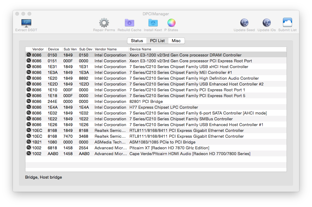

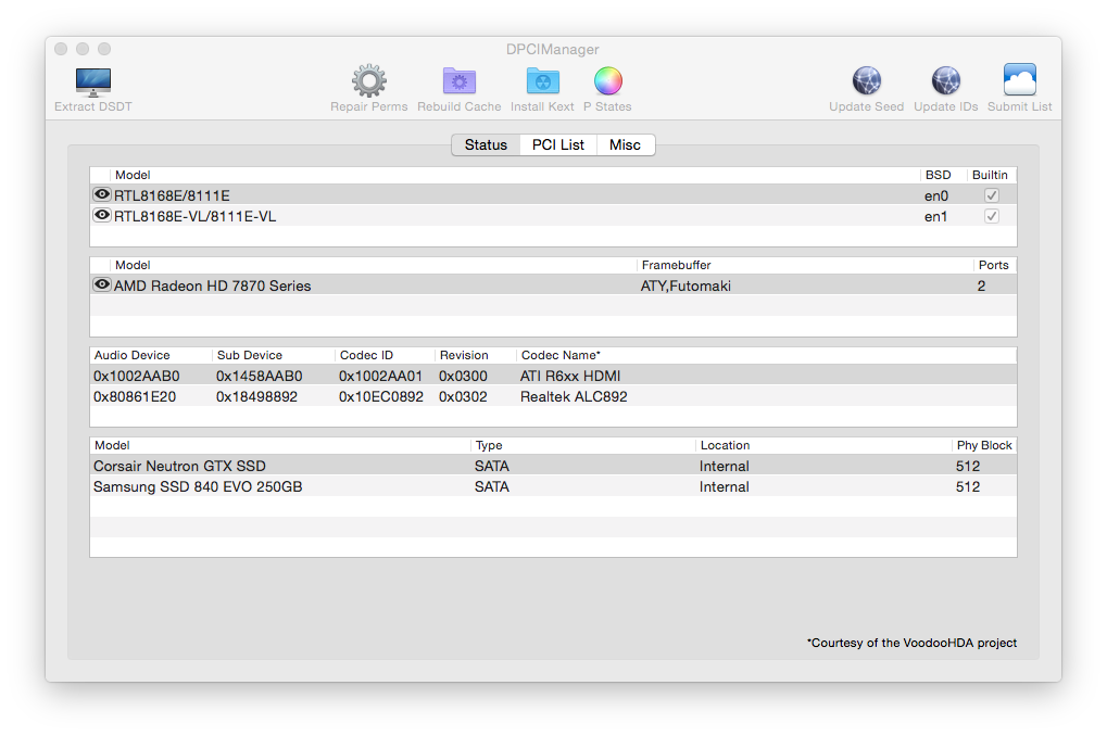

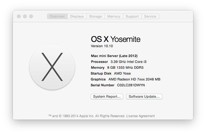

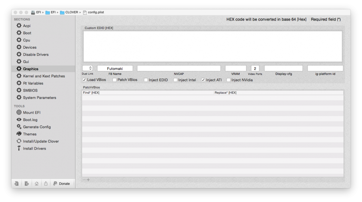

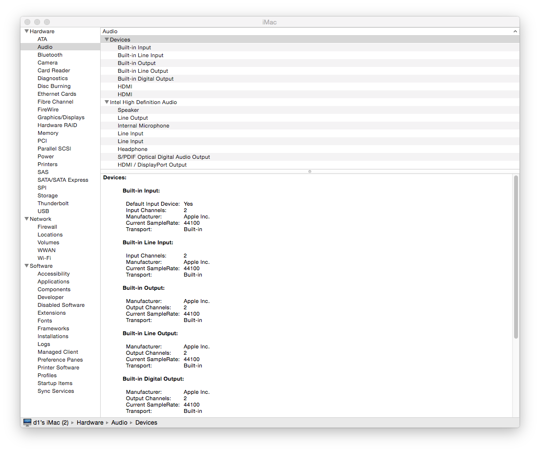

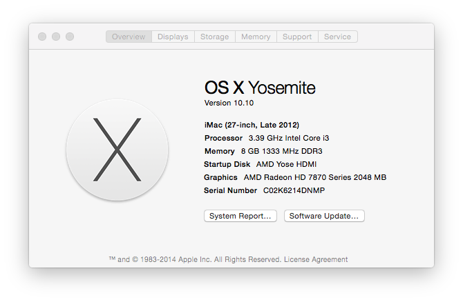

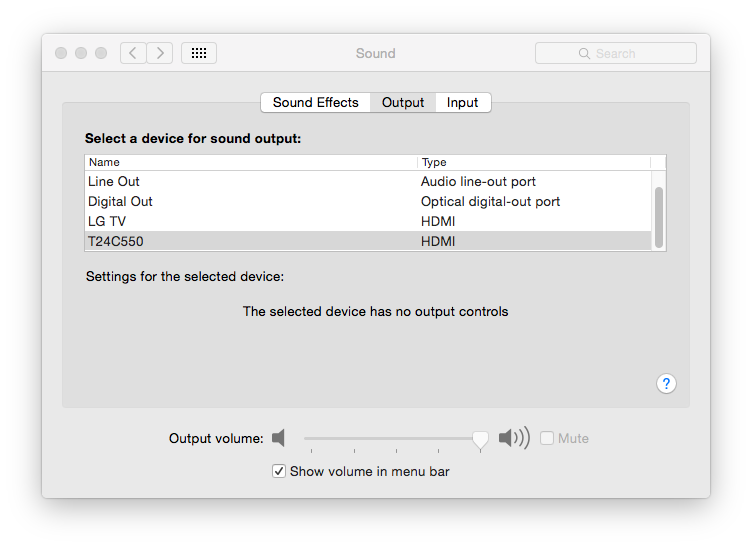

kvonlinee Posted October 31, 2014 Author Share Posted October 31, 2014 some good news, I am able to run AMD Radeon 7870 vanila by injecting into config of clover-graphics-FBname Futomaki-Video Port 2-LoadVBios-Inject ATI this one HDMI through DSDT edit and onboard sound with realtek from tolled ALC command. I have the config and the IOreg for you and some pictures. io-7870-Ivy.zip 7870-vanila-config.plist.zip Link to comment https://www.insanelymac.com/forum/topic/301682-success-yosemite-1010-on-3-desktops/#findComment-2078838 Share on other sites More sharing options...

kvonlinee Posted January 14, 2015 Author Share Posted January 14, 2015 I used clover, disk is GPT parttition dual to native intel cpu, i used seperate hard drive for os (osx and window 7 is seperate). I got lucky to Futomaki, 2 of 78xx series work with it, other menbaer said no. Yes it is not PitCairn framebuffer, i learn it from a different way, with clover it will force to load to work on all connection such HDMI, mini DisplayPort, DVI ( while Futomaki work for 2 only) With clover, inject loadVideoBios, inject ATI, framebuffer=Picairn, videopors=4 and (no videobios to clover). With 7950 i used framebuffer = Tahiti, same concept, work great for me. It could chnage alot due to modify kernel for AMD cpu vs vanilla for Intel cpu. Good luck. Link to comment https://www.insanelymac.com/forum/topic/301682-success-yosemite-1010-on-3-desktops/#findComment-2102896 Share on other sites More sharing options...
