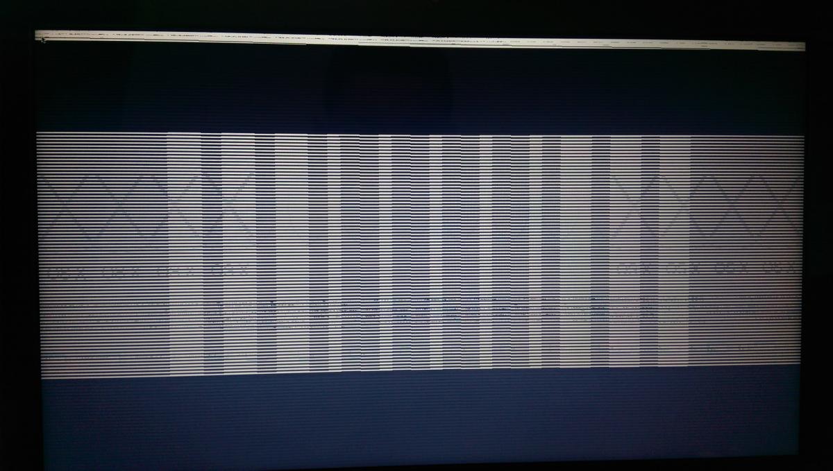

ahmed_ais Posted October 6, 2014 Share Posted October 6, 2014 Hi all, I'm having a problem booting from Yosemite beta 4 usb vanilla installer I made. I'm familiar with this procedure and had Beta 3 installed using Clover EFI but now I have this graphics issue with Beta 4. The usb boots fine but I always get a graphic glitch as appears on the attached image. I've seen this before with Beta 3 and Mavericks which I solved by setting FakeID for graphics in Clover (0x04168086 / 0x80860416 / 0x0a268086) and selecting InjectEDID but none of this work with 10.10 Beta 4. Any help is appreciated. My config.plist is attached and all my specs in my signature. Thanks. config.plist.zip Link to comment https://www.insanelymac.com/forum/topic/301326-yosemite-beta-4-usb-installer-graphics-issue-hd-4600/ Share on other sites More sharing options...

RehabMan Posted October 9, 2014 Share Posted October 9, 2014 Hi all, I'm having a problem booting from Yosemite beta 4 usb vanilla installer I made. I'm familiar with this procedure and had Beta 3 installed using Clover EFI but now I have this graphics issue with Beta 4. The usb boots fine but I always get a graphic glitch as appears on the attached image. I've seen this before with Beta 3 and Mavericks which I solved by setting FakeID for graphics in Clover (0x04168086 / 0x80860416 / 0x0a268086) and selecting InjectEDID but none of this work with 10.10 Beta 4. Any help is appreciated. My config.plist is attached and all my specs in my signature. Thanks. Invalid use of FakeID. Set config.plist/Devices/FakeID/IntelGFX=0. Add nv_disable=1 to config.plist/Boot/Arguments. Link to comment https://www.insanelymac.com/forum/topic/301326-yosemite-beta-4-usb-installer-graphics-issue-hd-4600/#findComment-2067780 Share on other sites More sharing options...
ahmed_ais Posted October 9, 2014 Author Share Posted October 9, 2014 Well, first thank you for the reply. Second, why to put a flag to disable nvidia? I know my system have 2 nvidia cards but I removed the removable one and disabled the internal from bios so basically I'm running only using Intel HD4600. Link to comment https://www.insanelymac.com/forum/topic/301326-yosemite-beta-4-usb-installer-graphics-issue-hd-4600/#findComment-2067826 Share on other sites More sharing options...
RehabMan Posted October 9, 2014 Share Posted October 9, 2014 Well, first thank you for the reply. Second, why to put a flag to disable nvidia? I know my system have 2 nvidia cards but I removed the removable one and disabled the internal from bios so basically I'm running only using Intel HD4600. In that case, you would not need nv_disable=1. But the fact that you really don't have nvidia is not reflected in your signature (if you disable it from BIOS, it is as if you don't have it). Link to comment https://www.insanelymac.com/forum/topic/301326-yosemite-beta-4-usb-installer-graphics-issue-hd-4600/#findComment-2067829 Share on other sites More sharing options...
ahmed_ais Posted October 9, 2014 Author Share Posted October 9, 2014 Alright, I only put the exact hardware details but it seems misleading, I'll edit it. Do you have any suggestion otherwise? thanks. Link to comment https://www.insanelymac.com/forum/topic/301326-yosemite-beta-4-usb-installer-graphics-issue-hd-4600/#findComment-2067833 Share on other sites More sharing options...
RehabMan Posted October 9, 2014 Share Posted October 9, 2014 Alright, I only put the exact hardware details but it seems misleading, I'll edit it. Do you have any suggestion otherwise? thanks. Did you get rid of your bogus FakeID/IntelGFX setting yet? You may also need to try different ig-platform-id values and/or inject EDID. Link to comment https://www.insanelymac.com/forum/topic/301326-yosemite-beta-4-usb-installer-graphics-issue-hd-4600/#findComment-2067834 Share on other sites More sharing options...
ahmed_ais Posted October 9, 2014 Author Share Posted October 9, 2014 I'll try right away. I'll back here soon once I recreate the USB installer again since I formatted it when it didn't work. Link to comment https://www.insanelymac.com/forum/topic/301326-yosemite-beta-4-usb-installer-graphics-issue-hd-4600/#findComment-2067835 Share on other sites More sharing options...
ahmed_ais Posted October 9, 2014 Author Share Posted October 9, 2014 Okay. I left alone FakeID (I don't know why it worked before) and ticked InjectEDID with ig-platform-id set to 0A260006 and this combination worked perfectly. Thanks for your help. Link to comment https://www.insanelymac.com/forum/topic/301326-yosemite-beta-4-usb-installer-graphics-issue-hd-4600/#findComment-2067858 Share on other sites More sharing options...
