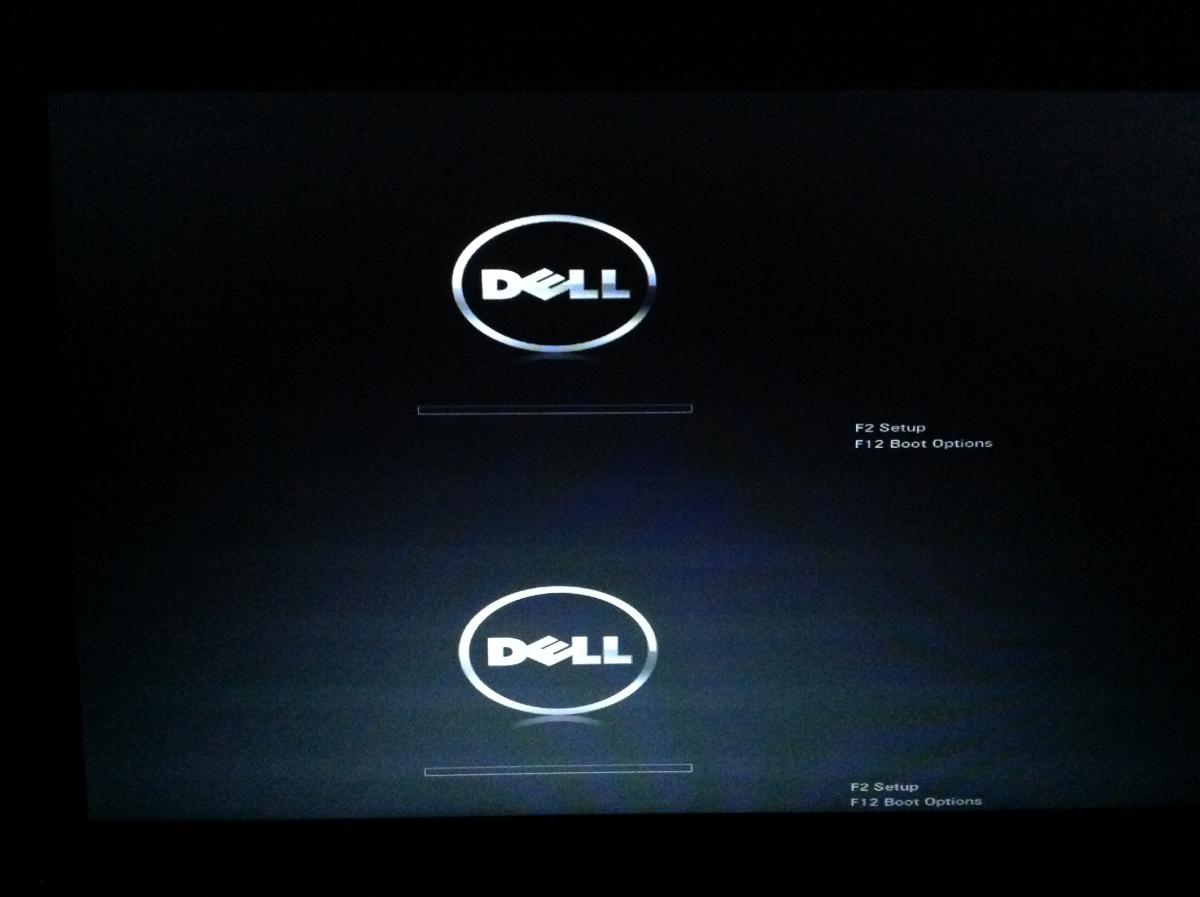

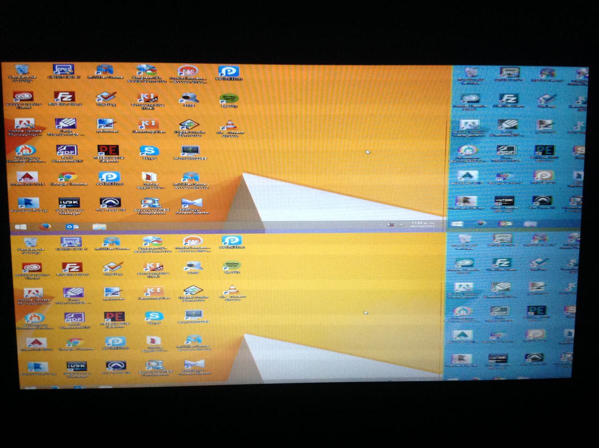

ldaniel-jmz Posted October 3, 2014 Share Posted October 3, 2014 My situation is really strange. I installed Windows 8.1 and Mavericks in one hard disk drive with three partitions, one for each operating system and one just for storage purpose. Since my wireless network card (BCM943142HM) is not usable in OS X, I bought a USB Wifi Adapter (TP-LINK TL-WN725N) so that I could access internet. But when I use a lot of internet bandwidth (downloading torrents) the computer freezes completely. So I decided to work heavy internet use in Windows and just specific tasks on OS X. I’ve been using my computer in this way for almost 8 months without any additional issues. But recently I found somewhere that in order to stop the random freezes caused by the high internet’s bandwidth use, I had to disable Spotlight. So I did it, but the freezes continued. However I noticed that I could use the computer for a longer period of time before it froze again. So here is the problem. Yesterday, after some of this freezes I restarted the computer and now it beeps 8 times while booting indicating a display problem according to Dell, and the display shows up like this while booting and in Windows: But inside OS X the screen turns off. When I perform the display test according to Dell (holding down the D key and then pressing the Power button to turn on the computer) it shows solid colours indicating that the display panel is working correctly. Right now I’m using an external monitor connected to the HDMI port which is working correctly in both operating systems. Inside OS X it’s like there is no display panel connected to the graphics adapter, and in Windows it detects the display panel as a generic monitor. I’m really concerned about this. I know this is not a common problem, so I would appreciate any help! Link to comment https://www.insanelymac.com/forum/topic/301252-uncommon-display-or-adapter-intel-hd-4000-problem/ Share on other sites More sharing options...
ldaniel-jmz Posted October 4, 2014 Author Share Posted October 4, 2014 Someone told me that for some reason "dual link" is now enabled and that I would need to reflash the bios in order to correct the problem. I don´t know what dual link is but I´m going to investigate. Link to comment https://www.insanelymac.com/forum/topic/301252-uncommon-display-or-adapter-intel-hd-4000-problem/#findComment-2066145 Share on other sites More sharing options...
ldaniel-jmz Posted October 5, 2014 Author Share Posted October 5, 2014 I upgraded (flashed) the bios using the installer provided by the Dell support website. And problem solved. Now the display is working correctly throughout the boot process, bios and inside Windows.But after a few days the problem reappeared. This is really odd. Does someone have any idea? Link to comment https://www.insanelymac.com/forum/topic/301252-uncommon-display-or-adapter-intel-hd-4000-problem/#findComment-2066666 Share on other sites More sharing options...
