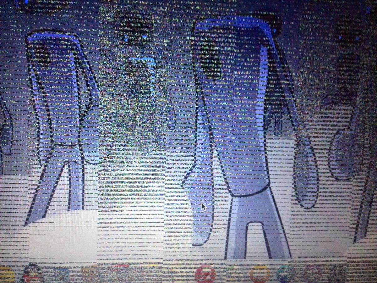

Arslan2012 Posted August 16, 2014 Share Posted August 16, 2014 Well, I have an Intel i5-3337U CPU with a HD4000 Graphic card, I customized my DSDT while I'm using 10.8 ,successfully enabled QE/CI, but my mouse dissappered, I didn't care . But when I've updated my system to 10.9 and 10.10, the mouse problem had gone, but my screen blurs constantly, I have no idea why. Any idea for me? PS: I do tried to change my ig-platform-id in DSDT ,but still the current 01660003 is the only value that can enable my QE/CI. PPS:I open iTunes Visuallizer evey time I start the system, and that could stop the blur for me as long as it's showing ioregDSDTConfig.zip Link to comment https://www.insanelymac.com/forum/topic/300294-intel-hd4000-screen-blurred/ Share on other sites More sharing options...

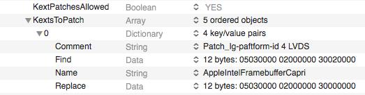

artur_pt Posted August 16, 2014 Share Posted August 16, 2014 hello try to use this with ig-platform-id 4 good hack Link to comment https://www.insanelymac.com/forum/topic/300294-intel-hd4000-screen-blurred/#findComment-2052252 Share on other sites More sharing options...
Arslan2012 Posted August 16, 2014 Author Share Posted August 16, 2014 hello try to use this with ig-platform-id 4 null good hack Wow, it's working man! I have no idea how you did that, I've been bothering by this problem for along time...much thanks! Link to comment https://www.insanelymac.com/forum/topic/300294-intel-hd4000-screen-blurred/#findComment-2052271 Share on other sites More sharing options...
