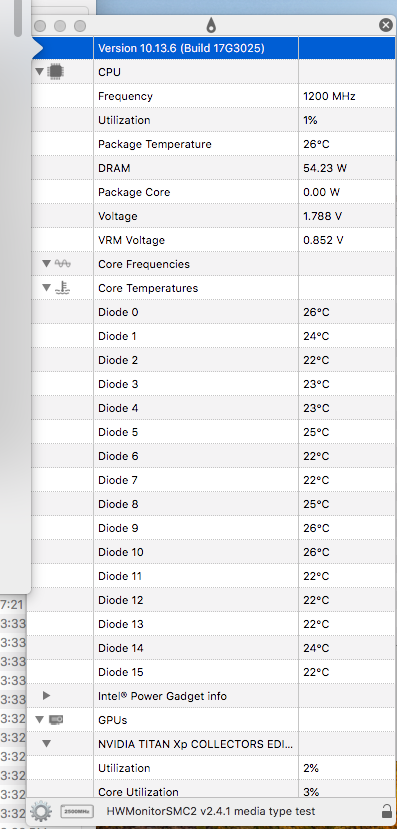

mbrettweigel Posted November 15, 2018 Share Posted November 15, 2018 12 hours ago, vector sigma said: The app at sourceforge require IntelPowergadget to work and you can find it here. I've fixed this already (lazy linking) but changes aren't committed because I was waiting the guy here that has problem with an external GPU but actually has not yet answered with the requested files.... and so to avoid repetitive big changes. Anyway to night I'll finally do that commit since I've wait enough. In the mean time try this one: HWMonitorSMC2.app_2.4.1.zip ... that has all the latest changes done until now. @Andrey1970, please check that app where I fixed spaces beteween the values and the units of measurement. Let me know. I have the latest version of the Intel Power Gadget (3.5.5) installed. I tried the version attached but same effect. It starts then closes (viewed in Activity Monitor). This is the output I'm getting from Console: Nov 14 19:11:06 Michaels-iMac com.apple.xpc.launchd[1] (org.slice.HWMonitorSMC2-Helper[1473]): Could not resolve CFBundleIdentifier specified by service: -10814: org.slice.HWMonitorSMC2-Helper Nov 14 19:11:06 Michaels-iMac com.apple.xpc.launchd[1] (org.slice.HWMonitorSMC2-Helper[1473]): Service exited with abnormal code: 78 Nov 14 19:11:06 Michaels-iMac com.apple.xpc.launchd[1] (org.slice.HWMonitorSMC2-Helper): Service only ran for 0 seconds. Pushing respawn out by 10 seconds. Nov 14 19:11:16 Michaels-iMac com.apple.xpc.launchd[1] (org.slice.HWMonitorSMC2-Helper[1480]): Could not resolve CFBundleIdentifier specified by service: -10814: org.slice.HWMonitorSMC2-Helper Nov 14 19:11:16 Michaels-iMac com.apple.xpc.launchd[1] (org.slice.HWMonitorSMC2-Helper[1480]): Service exited with abnormal code: 78 Nov 14 19:11:16 Michaels-iMac com.apple.xpc.launchd[1] (org.slice.HWMonitorSMC2-Helper): Service only ran for 0 seconds. Pushing respawn out by 10 seconds. Nov 14 19:11:26 Michaels-iMac com.apple.xpc.launchd[1] (org.slice.HWMonitorSMC2-Helper[1487]): Could not resolve CFBundleIdentifier specified by service: -10814: org.slice.HWMonitorSMC2-Helper Nov 14 19:11:26 Michaels-iMac com.apple.xpc.launchd[1] (org.slice.HWMonitorSMC2-Helper[1487]): Service exited with abnormal code: 78 Nov 14 19:11:26 Michaels-iMac com.apple.xpc.launchd[1] (org.slice.HWMonitorSMC2-Helper): Service only ran for 0 seconds. Pushing respawn out by 10 seconds. Nov 14 19:11:36 Michaels-iMac com.apple.xpc.launchd[1] (org.slice.HWMonitorSMC2-Helper[1496]): Could not resolve CFBundleIdentifier specified by service: -10814: org.slice.HWMonitorSMC2-Helper Nov 14 19:11:36 Michaels-iMac com.apple.xpc.launchd[1] (org.slice.HWMonitorSMC2-Helper[1496]): Service exited with abnormal code: 78 Nov 14 19:11:36 Michaels-iMac com.apple.xpc.launchd[1] (org.slice.HWMonitorSMC2-Helper): Service only ran for 0 seconds. Pushing respawn out by 10 seconds. I hope that's helpful. Link to comment https://www.insanelymac.com/forum/topic/299861-hwsensors3/page/55/#findComment-2647674 Share on other sites More sharing options...

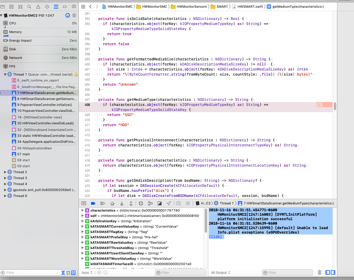

vector sigma Posted November 16, 2018 Share Posted November 16, 2018 12 hours ago, mbrettweigel said: Fatal error: Unexpectedly found nil while unwrapping an Optional value Illegal instruction: 4 Should be easy to fix if you have Xcode 9.4.1 + (better if Xcode 10)..... by compiling the project at 'hwsensors-3/trunk/hwmonitor2/HWMonitorSMC.xcodeproj' ...Xcode will show the line where the error is. Surely it is something that I have taken for granted that it exists, but in your System is missing. If you can do that, please show me the screen shot, thanks. Link to comment https://www.insanelymac.com/forum/topic/299861-hwsensors3/page/55/#findComment-2647946 Share on other sites More sharing options...
mbrettweigel Posted November 16, 2018 Share Posted November 16, 2018 25 minutes ago, vector sigma said: Should be easy to fix if you have Xcode 9.4.1 + (better if Xcode 10)..... by compiling the project at 'hwsensors-3/trunk/hwmonitor2/HWMonitorSMC.xcodeproj' ...Xcode will show the line where the error is. Surely it is something that I have taken for granted that it exists, but in your System is missing. If you can do that, please show me the screen shot, thanks. The app seems to build just fine (I'm using XCode 10.1) and generates no errors when compilied. One warning does appear however related to "Material view only being available in MacOS versions 10.11 and above". Since there were no compile issues other than what was mentioned, I just tried to run the project. This is the result: 2018-11-16 06:31:51.454771-0600 HWMonitorSMC2[1247:16003] [DYMTLInitPlatform] platform initialization successful 2018-11-16 06:31:51.520439-0600 HWMonitorSMC2[1247:15995] [default] Unable to load Info.plist exceptions (eGPUOverrides) (lldb) This is the screenshot from that time: I hope this helps. 1 Link to comment https://www.insanelymac.com/forum/topic/299861-hwsensors3/page/55/#findComment-2647947 Share on other sites More sharing options...

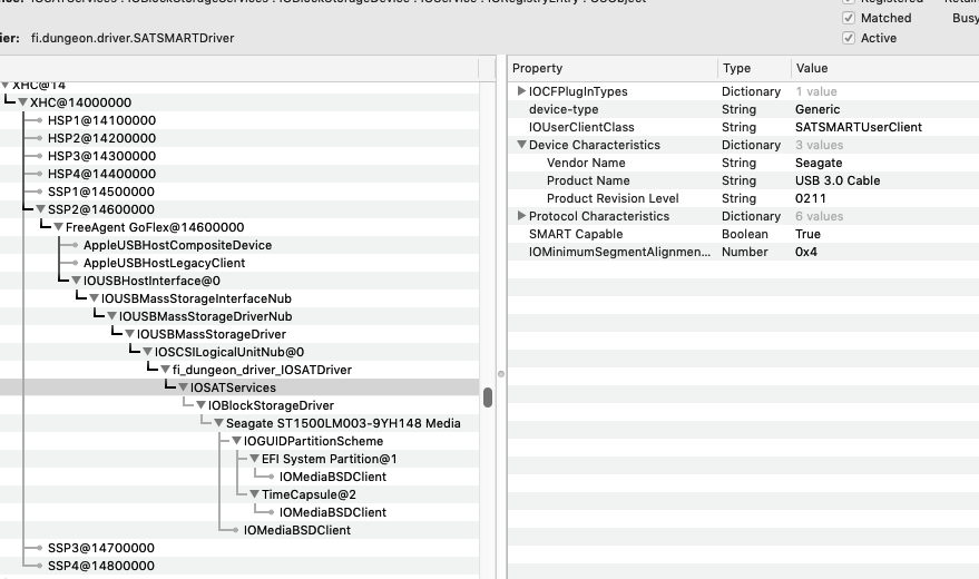

vector sigma Posted November 16, 2018 Share Posted November 16, 2018 3 hours ago, mbrettweigel said: I hope this helps. Sure, this will of big help! Anyway I would like to take a look to your ioreg since looks like the the key kIOPropertyMediumTypeKey is missing, and w/o that I cannot recognize if the disk is a hdd or ssd. Link to comment https://www.insanelymac.com/forum/topic/299861-hwsensors3/page/55/#findComment-2647978 Share on other sites More sharing options...
vector sigma Posted November 16, 2018 Share Posted November 16, 2018 @mbrettweigel, try this: HWMonitorSMC2.app_2.4.1_media_type_test.zip. Should at least not crash, unless something else is missing again. Link to comment https://www.insanelymac.com/forum/topic/299861-hwsensors3/page/55/#findComment-2647998 Share on other sites More sharing options...

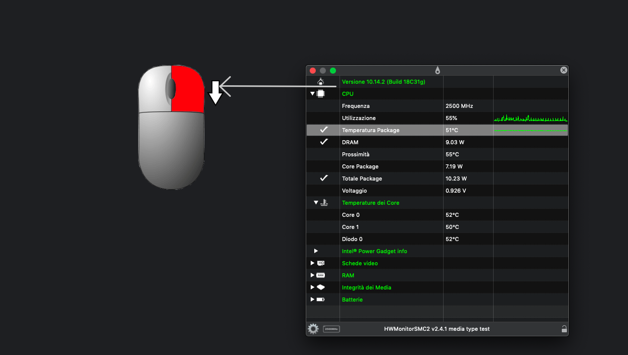

Guest Posted November 16, 2018 Share Posted November 16, 2018 On 11/14/2018 at 7:57 PM, vector sigma said: I've only make the code able to read sensors with new SMC keys with lower cases letters (i.e. "TC0c" vs "TC0C"). This is due to new iMac Pros that apparently uses the new lower one. Probably I've introduced a new bug, but in the meantime can you show me the SMC dump from the app? Hi I do not remember how to do a SMC dump from the app sorry Link to comment https://www.insanelymac.com/forum/topic/299861-hwsensors3/page/55/#findComment-2648009 Share on other sites More sharing options...
vector sigma Posted November 16, 2018 Share Posted November 16, 2018 19 minutes ago, fabiosun said: Hi I do not remember how to do a SMC dump from the app sorry ..then copy to pasteboard. Anyway the app at previous post was corrected, isn't? Link to comment https://www.insanelymac.com/forum/topic/299861-hwsensors3/page/55/#findComment-2648014 Share on other sites More sharing options...
Guest Posted November 16, 2018 Share Posted November 16, 2018 2 minutes ago, vector sigma said: ..then copy to pasteboard. Anyway the app at previous post was corrected, isn't? It seems no And with it I have strange problem if I do some lock / unlock (I can't close it via x button only via monitor force quit) HWMonitorSMC2 v2.4.1 media type test MACHINE STATUS: CPU: Name: Intel(R) Core(TM) i9-7980XE CPU @ 2.60GHz Vendor: GenuineIntel Physical cores: 18 Logical cores: 36 Family: 6 Model: 0x55 Ext Model: 0x5 Ext Family: 0 Stepping: 4 Signature: 0x50654 Brand: 0 Features: FPU VME DE PSE TSC MSR PAE MCE CX8 APIC SEP MTRR PGE MCA CMOV PAT PSE36 CLFSH DS ACPI MMX FXSR SSE SSE2 SS HTT TM PBE SSE3 PCLMULQDQ DTES64 MON DSCPL VMX EST TM2 SSSE3 FMA CX16 TPR PDCM SSE4.1 SSE4.2 x2APIC MOVBE POPCNT AES PCID XSAVE OSXSAVE SEGLIM64 TSCTMR AVX1.0 RDRAND F16C Ext Features: SYSCALL XD 1GBPAGE EM64T LAHF LZCNT PREFETCHW RDTSCP TSCI Microcode version: 33554509 Thermal sensors: 1 Thermal APIC timer: 1 System: 0% User: 0% Idle: 98% Nice: 0% LPCB: IOName: pci8086,a2d2 name: 70 63 69 38 30 38 36 2c 61 32 64 32 00 device-id: d2 a2 00 00 vendor-id: 86 80 00 00 revision-id: 00 00 00 00 subsystem-id: 01 50 00 00 subsystem-vendor-id: 58 14 00 00 MEMORY: Physical size: 128.0GB Free: 117.79GB Wired: 5.09GB Active: 4.49GB Inactive: 625MB Compressed: 0MB SYSTEM: Model: iMacPro1,1 Sys name: Darwin OS Version: 10.13.6 Node name: fabios-iMac-Pro.lan Release: 17.7.0 Version: Darwin Kernel Version 17.7.0: Wed Oct 10 23:06:14 PDT 2018; root:xnu-4570.71.13~1/RELEASE_X86_64 Machine: x86_64 Uptime: 0d 1h 34m 16s Processes: 283 Threads: 1150 Load Average: [1.70, 1.55, 1.60] Mach Factor: [34.46, 34.358, 34.322] POWER: CPU Speed limit: 100.0% CPUs available: 32 Scheduler limit: 100.0% Thermal level: Not Published VIDEO CARD 1: Model: NVIDIA TITAN Xp COLLECTORS EDITION Vendor ID: de 10 00 00 (NVidia) Device ID: 02 1b 00 00 Revision ID: a1 00 00 00 Subsystem Vendor ID: de 10 00 00 Subsystem ID: 10 00 00 00 class-code: 00 00 03 00 IOName: display pcidebug: 193:0:0 built-in: 00 compatible: pci10de,123epci10de,1b02pciclass,030000SL05GFX0 acpi-path: IOACPIPlane:/_SB/PC02@0/BR2A@0/SL05@ffff hda-gfx: onboard-1 rm_board_number: 00 00 00 00 NVDA,noEFI: true NVArch: GP100 rom-revision: VBIOS 86.02.4c.00.01 NVCLASS: NVDA NVCAP: 05 00 00 00 00 00 ff ff ff ff 00 00 00 00 00 0e 00 00 00 00 pci-aspm-default: 0x0 VRAM,totalMB: ff 2f 00 00 device_type: NVDA,Parent NVDA,accel-loaded: 01 00 00 00 vbios-revision: 01 00 4c 02 86 vNVDA,Features: 00 08 00 00 IONVRAMProperty: true NVDAinitgl_created: yes IOPCIMSIMode true NVDAType: Web Additional Properties: AAPL,ndrv-dev: 1 AAPL,slot-name: 53 6c 6f 74 2d 31 00 Metal support: true Metal properties: Max Threads Per Thread group: width 1024, height 1024, depth 64 Max Thread group Memory Length: 49152 Recommended Max Working Set Size: 0x0 Depth 24 Stencil 8 Pixel Format: true Programmable Sample Positions: false Read-Write Texture: 1 Headless: false Is Low Power: false Removable: false Performance Statistics: ioSurfaceReadOutBytes: 0 freeDataBufferWaitTime: 0 vramUsedBytes: 2045825024 textureReadOutBytes: 0 orphanedNonReusableVidMemoryCount: 0 orphanedReusableVidMemoryBytes: 0 inUseVidMemoryBytes: 2008059904 stdTexturePageInBytes: 0 contextVideoCount: 0 contextGLCount: 5 swapBytesPerSample: 0 textureCount: 2183 finishCLWaitTime: 0 recoveryCount: 0 surfaceBufferTextureCreationCount: 0 swapCompleteGLWaitTime: 0 finish2DWaitTime: 0 inUseSysMemoryBytes: 1913495552 hardwareSubmitWaitTime: 0 ioSurfacePageInBytes: 3239936 oolTextureCreationBytes: 0 orphanedNonReusableSysMemoryCount: 0 volatileSurfaceCount: 0 vramLargestFreeBytes: 8287322112 stdTextureCreationCount: 0 agpTextureCreationBytes: 0 oolTexturePageInBytes: 0 freeSurfaceSwapBufferWaitTime: 0 orphanedReusableVidMemoryHitRate: 3 surfaceReadLockIdleWaitTime: 0 orphanedReusableSysMemoryBytes: 94564352 context2DCount: 6 surfaceWriteLockIdleWaitTime: 0 surfaceBufferReadOutBytes: 0 agpTextureCreationCount: 0 gartMapInBytesPerSample: 5455872 gartUsedBytes: 74838016 vramFreeBytes: 10838749184 stdTextureCreationBytes: 0 Device Utilization %: 1 vramEvictionWaitTime: 0 bufferSwapCount: 0 oolTextureCreationCount: 0 agprefTextureCreationBytes: 16384 surfaceBufferPageOutBytes: 0 gartFreeBytes: 45738147840 textureVolunteerUnloadBytes: 0 finishAll2DWaitTime: 0 surfaceCount: 8 agprefTextureCreationCount: 2 dataBytesPerSample: 0 hardwareWaitTime: 52 swapCompleteVideoWaitTime: 0 gartMapOutBytesPerSample: 12288 freeSurfaceBackingWaitTime: 0 orphanedReusableSysMemoryCount: 30 surfaceBufferPageInBytes: 0 GPU Memory Utilization: 50000000 finishVideoWaitTime: 0 dataBufferCount: 0 finishGLWaitTime: 0 texturePageOutBytes: 0 gartCacheBytes: 33554432 surfaceSetShapeIdleWaitTime: 0 orphanedReusableVidMemoryCount: 0 GPU Core Utilization: 10000000 bufferFlipCount: 0 gartSizeBytes: 45812985856 surfaceCopyOutWaitTime: 0 orphanedNonReusableVidMemoryBytes: 0 sysmemUsedBytes: 0 swapComplete2DWaitTime: 0 surfaceCopyInWaitTime: 0 orphanedNonReusableSysMemoryBytes: 0 ioSurfacePageOutBytes: 0 contextCLCount: 4 surfaceTextureCreationCount: 0 iosurfaceTextureCreationCount: 14 orphanedReusableSysMemoryHitRate: 4 clientGLWaitTime: 0 iosurfaceTextureCreationBytes: 462848 freeToAllocGPUAddressWaitTime: 0 SCREEN 1: Framebuffer: 0x1B5611B5 EDID contents: Header: 00 ff ff ff ff ff ff 00 Serial number: f4 d3 05 00 Version: 01 04 Basic params b5 3c 22 78 9e Chroma info: 30 35 a7 55 4e a3 26 0f 50 54 Established: 21 08 00 Standard: 71 40 81 80 81 c0 a9 c0 d1 c0 81 00 01 01 01 01 Descriptor 1: 4d d0 00 a0 f0 70 3e 80 30 20 65 0c 58 54 21 00 00 1a Descriptor 2: 28 68 00 a0 f0 70 3e 80 08 90 65 0c 58 54 21 00 00 1a Descriptor 3: 00 00 00 fd 00 38 3d 1e 87 38 00 0a 20 20 20 20 20 20 Descriptor 4: 00 00 00 fc 00 4c 47 20 55 6c 74 72 61 20 48 44 0a 20 Extension: 01 Checksum: c8 Manufacturer: 1e6d (8=8) Model: 095b Serial Number: 381940 Resolution: 3840x2160 Made week 12 of 2017 EDID version: 1.4 Digital display Established Timings: 640×480 @ 60 Hz 800×600 @ 60 Hz 1024×768 @ 60 Hz Detailed mode (descriptor 1): Pixel Clock: 199.2MHz Horizontal Active: 3840 Horizontal Blanking: 160 Vertical Active: 2160 Vertical Blanking: 62 Horizontal Sync Offset: 48 Horizontal Sync Pulse: 32 Vertical Sync Offset: 54 Vertical Sync Pulse: 5 Interlaced: false Is preferred timing: true Detailed mode (descriptor 2): Pixel Clock: 103.44MHz Horizontal Active: 3840 Horizontal Blanking: 160 Vertical Active: 2160 Vertical Blanking: 62 Horizontal Sync Offset: 56 Horizontal Sync Pulse: 144 Vertical Sync Offset: 54 Vertical Sync Pulse: 5 Interlaced: false Is preferred timing: false Maximum image size: 600mm x 340mm Gamma: 2.20 Model: LG Ultra HD Checksum: 0xC8 (valid) EDID comes from EEPROM SCREEN 2: Framebuffer: 0x43301DE2 EDID contents: Header: 00 ff ff ff ff ff ff 00 Serial number: a3 33 00 00 Version: 01 03 Basic params 80 3c 22 78 2a Chroma info: ee d5 a3 56 50 9f 26 10 50 54 Established: bd 4b 00 Standard: d1 c0 81 80 95 0f 95 00 b3 00 81 c0 01 01 01 01 Descriptor 1: 02 3a 80 18 71 38 2d 40 58 2c 45 00 56 50 21 00 00 1e Descriptor 2: 00 00 00 ff 00 55 48 42 31 34 33 38 30 31 33 32 31 39 Descriptor 3: 00 00 00 fc 00 50 68 69 6c 69 70 73 20 32 37 38 47 34 Descriptor 4: 00 00 00 fd 00 18 4c 1a 53 17 00 0a 20 20 20 20 20 20 Extension: 01 Checksum: 21 Manufacturer: 410c (Philips 278) Model: b9c0 Serial Number: 13219 Resolution: 1920x1080 Made week 38 of 2014 EDID version: 1.3 Digital display Established Timings: 720×400 @ 70 Hz 640×480 @ 60 Hz 640×480 @ 67 Hz 640×480 @ 72 Hz 640×480 @ 75 Hz 800×600 @ 60 Hz 800×600 @ 75 Hz 1024×768 @ 60 Hz 1024×768 @ 75 Hz 1280×1024 @ 75 Hz Detailed mode (descriptor 1): Pixel Clock: 5.7MHz Horizontal Active: 1920 Horizontal Blanking: 280 Vertical Active: 1080 Vertical Blanking: 45 Horizontal Sync Offset: 88 Horizontal Sync Pulse: 44 Vertical Sync Offset: 4 Vertical Sync Pulse: 5 Interlaced: false Is preferred timing: true Maximum image size: 600mm x 340mm Gamma: 2.20 Model: LS Checksum: 0x21 (valid) EDID comes from EEPROM Serial ATA controller: Name: pci8086,a282 Vendor ID: 86 80 00 00 Device ID: 82 a2 00 00 Revision ID: 00 00 00 00 Subsystem Vendor ID: 58 14 00 00 Subsystem ID: 05 b0 00 00 class-code: 01 06 01 00 IOName: pci8086,a282 pcidebug: 0:23:0 built-in: 00 compatible: pci1458,b005pci8086,a282pciclass,010601SATA acpi-path: IOACPIPlane:/_SB/PCI0@0/SATA@170000 NVMe controller: Name: pci144d,a804 Vendor ID: 4d 14 00 00 Device ID: 04 a8 00 00 Revision ID: 00 00 00 00 Subsystem Vendor ID: 4d 14 00 00 Subsystem ID: 01 a8 00 00 class-code: 02 08 01 00 IOName: pci144d,a804 pcidebug: 2:0:0 built-in: 00 compatible: pci144d,a801pci144d,a804pciclass,010802PXSX acpi-path: IOACPIPlane:/_SB/PCI0@0/RP21@1b0004/PXSX@0 MEDIA: BSD Name: disk0 Product Name: Samsung SSD 850 PRO 512GB Product Revision Level: EXM04B6Q Medium Type: SSD Capacity: 512.11 GB (512110190592 bytes) Physical Interconnect: SATA Physical Interconnect Location: Internal Temperature: 28°C Life: 99% S.M.A.R.T. status: Ok BSD Name: disk1 Product Name: Samsung SSD 960 PRO 1TB Product Revision Level: 2B6QCXP7 Medium Type: SSD Capacity: 1.02 TB (1024209543168 bytes) Physical Interconnect: PCI-Express (NVMe) Physical Interconnect Location: Internal Temperature: 34°C Life: 100% Critical Warning: 0% Available Spare: 100% Available Spare Threshold: 10% Unsafe Shutdowns: 777 S.M.A.R.T. status: Ok BSD Name: disk2 Product Name: ST10000VX0004-1ZE101 Product Revision Level: AV01 Medium Type: HDD Capacity: 10 TB (10000831348736 bytes) Physical Interconnect: SATA Physical Interconnect Location: Internal Rotation Rate: 7200rpm Temperature: 32°C S.M.A.R.T. status: Ok BSD Name: disk3 Product Name: ST10000VX0004-1ZE101 Product Revision Level: AV01 Medium Type: HDD Capacity: 10 TB (10000831348736 bytes) Physical Interconnect: SATA Physical Interconnect Location: Internal Rotation Rate: 7200rpm Temperature: 35°C S.M.A.R.T. status: Ok BSD Name: disk4 Product Name: ST4000DM005-2DP166 Product Revision Level: 0001 Medium Type: HDD Capacity: 4 TB (4000787030016 bytes) Physical Interconnect: SATA Physical Interconnect Location: Internal Rotation Rate: 5980rpm Temperature: 29°C S.M.A.R.T. status: Ok BSD Name: disk5 Product Name: ST4000DM005-2DP166 Product Revision Level: 0001 Medium Type: HDD Capacity: 4 TB (4000787030016 bytes) Physical Interconnect: SATA Physical Interconnect Location: Internal Rotation Rate: 5980rpm Temperature: 30°C S.M.A.R.T. status: Ok USB 3.0 controller: Vendor ID: 86 80 00 00 Device ID: af a2 00 00 Revision ID: 00 00 00 00 Subsystem Vendor ID: 58 14 00 00 Subsystem ID: 07 50 00 00 class-code: 30 03 0c 00 IOName: pci8086,a2af pcidebug: 0:20:0 built-in: 00 compatible: pci1458,5007pci8086,a2afpciclass,0c0330XHCI acpi-path: IOACPIPlane:/_SB/PCI0@0/XHCI@140000 USB devices: Name: USB-PS/2 Optical Mouse Vendor: Logitech idProduct: c05027 idVendor: 46d27 Port Num.: 7 Bus Power Available: 250 Speed: 0 Device Speed: 0 bcdDevice: 10016 Serial Number: 0 non-removable: yes Name: USB Keyboard Vendor: idProduct: 170227 idVendor: 4d927 Port Num.: 6 Bus Power Available: 250 Speed: 0 Device Speed: 0 bcdDevice: 257 Serial Number: 0 non-removable: yes Name: 4-Port USB 2.0 Hub Vendor: Generic idProduct: 541127 idVendor: bda27 Port Num.: 5 Bus Power Available: 250 Speed: 2 Device Speed: 2 bcdDevice: 291 Serial Number: 0 non-removable: yes Name: 4-Port USB 3.0 Hub Vendor: Generic idProduct: 41127 idVendor: bda27 Port Num.: 15 Bus Power Available: 450 Speed: 3 Device Speed: 3 bcdDevice: 291 Serial Number: 0 non-removable: yes Name: AppleUSBXHCI Root Hub Simulation Vendor: Apple Inc. idProduct: 800727 idVendor: 5ac27 Speed: 3 Device Speed: 3 Serial Number: 0 non-removable: yes LAN controller: Name: ethernet Vendor ID: 86 80 00 00 Device ID: b8 15 00 00 Revision ID: 00 00 00 00 Subsystem Vendor ID: 58 14 00 00 Subsystem ID: 00 e0 00 00 class-code: 00 00 02 00 IOName: ethernet pcidebug: 0:31:6 built-in: 00 compatible: pci1458,e000pci8086,15b8pciclass,020000GBE1 acpi-path: IOACPIPlane:/_SB/PCI0@0/GBE1@1f0006 WIFI controller: Name: pci8086,24fd Vendor ID: 86 80 00 00 Device ID: fd 24 00 00 Revision ID: 78 00 00 00 Subsystem Vendor ID: 86 80 00 00 Subsystem ID: 10 10 00 00 class-code: 00 80 02 00 IOName: pci8086,24fd pcidebug: 3:0:0 built-in: 00 compatible: pci8086,1010pci8086,24fdpciclass,028000PXSX acpi-path: IOACPIPlane:/_SB/PCI0@0/RP01@1c0000/PXSX@0 SMC DUMP: key: #KEY, size: 04, type: ui32, attr: 00, value: <00000074> key: FNum, size: 01, type: ui8 , attr: 00, value: <05> key: HWS0, size: 08, type: ch8*, attr: 00, value: <47696761 62797465> key: HWS1, size: 20, type: ch8*, attr: 00, value: <58323939 20444553 49474e41 52452045 582d4346> key: RPlt, size: 08, type: ch8*, attr: 00, value: <6a313337 00000000> key: RBr , size: 08, type: ch8*, attr: 00, value: <6a313337 00356100> key: TC0D, size: 02, type: sp78, attr: 00, value: <1900> key: TC1D, size: 02, type: sp78, attr: 00, value: <1900> key: TC2D, size: 02, type: sp78, attr: 00, value: <1600> key: TC3D, size: 02, type: sp78, attr: 00, value: <1700> key: TC4D, size: 02, type: sp78, attr: 00, value: <1700> key: TC5D, size: 02, type: sp78, attr: 00, value: <1800> key: TC6D, size: 02, type: sp78, attr: 00, value: <1600> key: TC7D, size: 02, type: sp78, attr: 00, value: <1700> key: TC8D, size: 02, type: sp78, attr: 00, value: <1800> key: TC9D, size: 02, type: sp78, attr: 00, value: <1800> key: TCAD, size: 02, type: sp78, attr: 00, value: <1900> key: TCBD, size: 02, type: sp78, attr: 00, value: <1700> key: TCCD, size: 02, type: sp78, attr: 00, value: <1700> key: TCDD, size: 02, type: sp78, attr: 00, value: <1700> key: TCED, size: 02, type: sp78, attr: 00, value: <1800> key: TCFD, size: 02, type: sp78, attr: 00, value: <1600> key: TC10, size: 02, type: sp78, attr: 00, value: <1600> key: TC11, size: 02, type: sp78, attr: 00, value: <1700> key: MlCP, size: 02, type: fp88, attr: 00, value: <2200> key: CCPC, size: 04, type: ui32, attr: 00, value: <00000d26> key: MlC0, size: 02, type: fp88, attr: 00, value: <2200> key: CC0C, size: 04, type: ui32, attr: 00, value: <00000d26> key: MlC1, size: 02, type: fp88, attr: 00, value: <1a00> key: CC1C, size: 04, type: ui32, attr: 00, value: <00000a0e> key: MlC2, size: 02, type: fp88, attr: 00, value: <1a00> key: CC2C, size: 04, type: ui32, attr: 00, value: <00000a0e> key: MlC3, size: 02, type: fp88, attr: 00, value: <1a00> key: CC3C, size: 04, type: ui32, attr: 00, value: <00000a0e> key: MlC4, size: 02, type: fp88, attr: 00, value: <1d00> key: CC4C, size: 04, type: ui32, attr: 00, value: <00000b37> key: MlC5, size: 02, type: fp88, attr: 00, value: <1a00> key: CC5C, size: 04, type: ui32, attr: 00, value: <00000a0e> key: MlC6, size: 02, type: fp88, attr: 00, value: <1c00> key: CC6C, size: 04, type: ui32, attr: 00, value: <00000ad4> key: MlC7, size: 02, type: fp88, attr: 00, value: <1e00> key: CC7C, size: 04, type: ui32, attr: 00, value: <00000b9a> key: MlC8, size: 02, type: fp88, attr: 00, value: <2200> key: CC8C, size: 04, type: ui32, attr: 00, value: <00000d26> key: MlC9, size: 02, type: fp88, attr: 00, value: <1a00> key: CC9C, size: 04, type: ui32, attr: 00, value: <00000a0e> key: MlCA, size: 02, type: fp88, attr: 00, value: <1c00> key: CCAC, size: 04, type: ui32, attr: 00, value: <00000ad4> key: MlCB, size: 02, type: fp88, attr: 00, value: <1d00> key: CCBC, size: 04, type: ui32, attr: 00, value: <00000b37> key: MlCC, size: 02, type: fp88, attr: 00, value: <1b00> key: CCCC, size: 04, type: ui32, attr: 00, value: <00000a71> key: MlCD, size: 02, type: fp88, attr: 00, value: <2200> key: CCDC, size: 04, type: ui32, attr: 00, value: <00000d26> key: MlCE, size: 02, type: fp88, attr: 00, value: <1b00> key: CCEC, size: 04, type: ui32, attr: 00, value: <00000a71> key: MlCF, size: 02, type: fp88, attr: 00, value: <1d00> key: CCFC, size: 04, type: ui32, attr: 00, value: <00000b37> key: CC10, size: 04, type: ui32, attr: 00, value: <00000a71> key: CC11, size: 04, type: ui32, attr: 00, value: <00000a0e> key: CCPA, size: 04, type: ui32, attr: 00, value: <0000095b> key: PCTR, size: 02, type: sp78, attr: 00, value: <2862> key: PCPC, size: 02, type: sp78, attr: 00, value: <0000> key: PCPD, size: 02, type: sp78, attr: 00, value: <2f26> key: $Adr, size: 04, type: ui32, attr: 00, value: <00000300> key: $Num, size: 01, type: ui8 , attr: 00, value: <01> key: LsNM, size: 01, type: ui8 , attr: 00, value: <01> key: LsbV, size: 05, type: {rev, attr: 00, value: <01040a00 06> key: MSSD, size: 01, type: si8 , attr: 00, value: <05> key: MSSP, size: 01, type: si8 , attr: 00, value: <05> key: NATJ, size: 01, type: ui8 , attr: 00, value: <02> key: OSK0, size: 32, type: ch8*, attr: 00, value: <6f757268 61726477 6f726b62 79746865 7365776f 72647367 75617264 6564706c> key: OSK1, size: 32, type: ch8*, attr: 00, value: <65617365 646f6e74 73746561 6c286329 4170706c 65436f6d 70757465 72496e63> key: REV , size: 06, type: {rev, attr: 00, value: <02410f00 0001> key: RVBF, size: 06, type: {rev, attr: 00, value: <01300f00 0003> key: RVUF, size: 06, type: {rev, attr: 00, value: <01300f00 0003> key: BEMB, size: 01, type: flag, attr: 00, value: <00> key: EPCI, size: 04, type: ui32, attr: 00, value: <0970f000> key: NATi, size: 02, type: ui16, attr: 00, value: <001e> key: NTOK, size: 01, type: ui8 , attr: 00, value: <01> key: Tm0P, size: 02, type: sp78, attr: 00, value: <2300> key: TC0H, size: 02, type: sp78, attr: 00, value: <3000> key: VC0C, size: 02, type: fp2e, attr: 00, value: <726e> key: VV2S, size: 02, type: fp2e, attr: 00, value: <d628> key: VV9S, size: 02, type: fp4c, attr: 00, value: <c3d7> key: VV1S, size: 02, type: fp4c, attr: 00, value: <50a3> key: VC0G, size: 02, type: fp2e, attr: 00, value: <4ccc> key: VS0C, size: 02, type: fp4c, attr: 00, value: <0da1> key: VM0R, size: 02, type: fp2e, attr: 00, value: <4d91> key: VV7S, size: 02, type: fp2e, attr: 00, value: <d893> key: Vb0R, size: 02, type: fp2e, attr: 00, value: <cf5c> key: FS! , size: 02, type: ui16, attr: 00, value: <0000> key: F0Ac, size: 02, type: fpe2, attr: 00, value: <0bf3> key: F0ID, size: 16, type: {fds, attr: 00, value: <01000000 4d422046 616e2030 00000000> key: F0Mn, size: 02, type: fpe2, attr: 00, value: <0000> key: F0Mx, size: 02, type: fpe2, attr: 00, value: <5dc0> key: F0Tg, size: 02, type: fpe2, attr: 00, value: <0000> key: F1Ac, size: 02, type: fpe2, attr: 00, value: <09cf> key: F1ID, size: 16, type: {fds, attr: 00, value: <01000100 4d422046 616e2031 00000000> key: F1Mn, size: 02, type: fpe2, attr: 00, value: <0000> key: F1Mx, size: 02, type: fpe2, attr: 00, value: <5dc0> key: F1Tg, size: 02, type: fpe2, attr: 00, value: <0000> key: F2Ac, size: 02, type: fpe2, attr: 00, value: <0000> key: F2ID, size: 16, type: {fds, attr: 00, value: <01000200 4d422046 616e2032 00000000> key: F2Mn, size: 02, type: fpe2, attr: 00, value: <0000> key: F2Mx, size: 02, type: fpe2, attr: 00, value: <5dc0> key: F2Tg, size: 02, type: fpe2, attr: 00, value: <0000> key: F3Ac, size: 02, type: fpe2, attr: 00, value: <0862> key: F3ID, size: 16, type: {fds, attr: 00, value: <01000300 4d422046 616e2033 00000000> key: TG0D, size: 02, type: sp78, attr: 00, value: <2a00> key: F4Ac, size: 02, type: fpe2, attr: 00, value: <0190> key: F4ID, size: 16, type: {fds, attr: 00, value: <07000400 47505520 31000000 00000000> key: QENA, size: 01, type: ui8 , attr: 00, value: <01> key: MSTS, size: 01, type: ui8 , attr: 00, value: <12> key: MSPC, size: 01, type: ui8 , attr: 00, value: <0f> key: MSDW, size: 01, type: flag, attr: 00, value: <01> Link to comment https://www.insanelymac.com/forum/topic/299861-hwsensors3/page/55/#findComment-2648019 Share on other sites More sharing options...
vector sigma Posted November 16, 2018 Share Posted November 16, 2018 10 minutes ago, fabiosun said: It seems no He can't: key: TC0D, size: 02, type: sp78, attr: 00, value: <1900> key: TC1D, size: 02, type: sp78, attr: 00, value: <1900> key: TC2D, size: 02, type: sp78, attr: 00, value: <1600> key: TC3D, size: 02, type: sp78, attr: 00, value: <1700> key: TC4D, size: 02, type: sp78, attr: 00, value: <1700> key: TC5D, size: 02, type: sp78, attr: 00, value: <1800> key: TC6D, size: 02, type: sp78, attr: 00, value: <1600> key: TC7D, size: 02, type: sp78, attr: 00, value: <1700> key: TC8D, size: 02, type: sp78, attr: 00, value: <1800> key: TC9D, size: 02, type: sp78, attr: 00, value: <1800> key: TCAD, size: 02, type: sp78, attr: 00, value: <1900> key: TCBD, size: 02, type: sp78, attr: 00, value: <1700> key: TCCD, size: 02, type: sp78, attr: 00, value: <1700> key: TCDD, size: 02, type: sp78, attr: 00, value: <1700> key: TCED, size: 02, type: sp78, attr: 00, value: <1800> key: TCFD, size: 02, type: sp78, attr: 00, value: <1600> keys "TCGD" and "TCHD" are absent. 15 minutes ago, fabiosun said: And with it I have strange problem if I do some lock / unlock (I can't close it via x button only via monitor force quit) I'll check it. Link to comment https://www.insanelymac.com/forum/topic/299861-hwsensors3/page/55/#findComment-2648026 Share on other sites More sharing options...
Guest Posted November 16, 2018 Share Posted November 16, 2018 12 minutes ago, vector sigma said: He can't: key: TC0D, size: 02, type: sp78, attr: 00, value: <1900> key: TC1D, size: 02, type: sp78, attr: 00, value: <1900> key: TC2D, size: 02, type: sp78, attr: 00, value: <1600> key: TC3D, size: 02, type: sp78, attr: 00, value: <1700> key: TC4D, size: 02, type: sp78, attr: 00, value: <1700> key: TC5D, size: 02, type: sp78, attr: 00, value: <1800> key: TC6D, size: 02, type: sp78, attr: 00, value: <1600> key: TC7D, size: 02, type: sp78, attr: 00, value: <1700> key: TC8D, size: 02, type: sp78, attr: 00, value: <1800> key: TC9D, size: 02, type: sp78, attr: 00, value: <1800> key: TCAD, size: 02, type: sp78, attr: 00, value: <1900> key: TCBD, size: 02, type: sp78, attr: 00, value: <1700> key: TCCD, size: 02, type: sp78, attr: 00, value: <1700> key: TCDD, size: 02, type: sp78, attr: 00, value: <1700> key: TCED, size: 02, type: sp78, attr: 00, value: <1800> key: TCFD, size: 02, type: sp78, attr: 00, value: <1600> keys "TCGD" and "TCHD" are absent. I'll check it. Thank you I investigated more on my side Different behavior if I am using fakesmc or virtualsmc set of kext HWMonitorSMC2 v2.4.1 media type test MACHINE STATUS: CPU: Name: Intel(R) Core(TM) i9-7980XE CPU @ 2.60GHz Vendor: GenuineIntel Physical cores: 18 Logical cores: 36 Family: 6 Model: 0x55 Ext Model: 0x5 Ext Family: 0 Stepping: 4 Signature: 0x50654 Brand: 0 Features: FPU VME DE PSE TSC MSR PAE MCE CX8 APIC SEP MTRR PGE MCA CMOV PAT PSE36 CLFSH DS ACPI MMX FXSR SSE SSE2 SS HTT TM PBE SSE3 PCLMULQDQ DTES64 MON DSCPL VMX EST TM2 SSSE3 FMA CX16 TPR PDCM SSE4.1 SSE4.2 x2APIC MOVBE POPCNT AES PCID XSAVE OSXSAVE SEGLIM64 TSCTMR AVX1.0 RDRAND F16C Ext Features: SYSCALL XD 1GBPAGE EM64T LAHF LZCNT PREFETCHW RDTSCP TSCI Microcode version: 33554509 Thermal sensors: 1 Thermal APIC timer: 1 System: 32% User: 1% Idle: 66% Nice: 0% LPCB: IOName: pci8086,a2d2 name: 70 63 69 38 30 38 36 2c 61 32 64 32 00 device-id: d2 a2 00 00 vendor-id: 86 80 00 00 revision-id: 00 00 00 00 subsystem-id: 01 50 00 00 subsystem-vendor-id: 58 14 00 00 MEMORY: Physical size: 128.0GB Free: 119.36GB Wired: 4.88GB Active: 3.31GB Inactive: 440MB Compressed: 0MB SYSTEM: Model: iMacPro1,1 Sys name: Darwin OS Version: 10.13.6 Node name: fabios-iMac-Pro.lan Release: 17.7.0 Version: Darwin Kernel Version 17.7.0: Wed Oct 10 23:06:14 PDT 2018; root:xnu-4570.71.13~1/RELEASE_X86_64 Machine: x86_64 Uptime: 0d 0h 6m 50s Processes: 288 Threads: 1203 Load Average: [2.03, 2.04, 1.29] Mach Factor: [34.295, 34.049, 34.019] POWER: CPU Speed limit: 100.0% CPUs available: 32 Scheduler limit: 100.0% Thermal level: Not Published SCREEN 1: Framebuffer: 0x5B81C5C0 Size: 1600x1200 Depth bits Per Pixel: 24 Depth bits Per Sample: 8 Depth is Planar: false Frame: (0.0, 0.0, 1600.0, 1200.0) Visible Frame: (0.0, 69.0, 1600.0, 1108.0) Depth backing Scale Factor: 1.0 Name: Display Vendor Id: 0x756E6B6E (1970170734) Product Id: 0x717 (1815) Brightness Affects Gamma: true Serial ATA controller: Name: pci8086,a282 Vendor ID: 86 80 00 00 Device ID: 82 a2 00 00 Revision ID: 00 00 00 00 Subsystem Vendor ID: 58 14 00 00 Subsystem ID: 05 b0 00 00 class-code: 01 06 01 00 IOName: pci8086,a282 pcidebug: 0:23:0 built-in: 00 compatible: pci1458,b005pci8086,a282pciclass,010601SATA acpi-path: IOACPIPlane:/_SB/PCI0@0/SATA@170000 NVMe controller: Name: pci144d,a804 Vendor ID: 4d 14 00 00 Device ID: 04 a8 00 00 Revision ID: 00 00 00 00 Subsystem Vendor ID: 4d 14 00 00 Subsystem ID: 01 a8 00 00 class-code: 02 08 01 00 IOName: pci144d,a804 pcidebug: 2:0:0 built-in: 00 compatible: pci144d,a801pci144d,a804pciclass,010802PXSX acpi-path: IOACPIPlane:/_SB/PCI0@0/RP21@1b0004/PXSX@0 MEDIA: BSD Name: disk0 Product Name: Samsung SSD 850 PRO 512GB Product Revision Level: EXM04B6Q Medium Type: SSD Capacity: 512.11 GB (512110190592 bytes) Physical Interconnect: SATA Physical Interconnect Location: Internal Temperature: 30°C Life: 99% S.M.A.R.T. status: Ok BSD Name: disk1 Product Name: Samsung SSD 960 PRO 1TB Product Revision Level: 2B6QCXP7 Medium Type: SSD Capacity: 1.02 TB (1024209543168 bytes) Physical Interconnect: PCI-Express (NVMe) Physical Interconnect Location: Internal Temperature: 35°C Life: 100% Critical Warning: 0% Available Spare: 100% Available Spare Threshold: 10% Unsafe Shutdowns: 777 S.M.A.R.T. status: Ok BSD Name: disk2 Product Name: ST4000DM005-2DP166 Product Revision Level: 0001 Medium Type: HDD Capacity: 4 TB (4000787030016 bytes) Physical Interconnect: SATA Physical Interconnect Location: Internal Rotation Rate: 5980rpm Temperature: 30°C S.M.A.R.T. status: Ok BSD Name: disk3 Product Name: ST4000DM005-2DP166 Product Revision Level: 0001 Medium Type: HDD Capacity: 4 TB (4000787030016 bytes) Physical Interconnect: SATA Physical Interconnect Location: Internal Rotation Rate: 5980rpm Temperature: 30°C S.M.A.R.T. status: Ok BSD Name: disk4 Product Name: ST10000VX0004-1ZE101 Product Revision Level: AV01 Medium Type: HDD Capacity: 10 TB (10000831348736 bytes) Physical Interconnect: SATA Physical Interconnect Location: Internal Rotation Rate: 7200rpm Temperature: 36°C S.M.A.R.T. status: Ok BSD Name: disk5 Product Name: ST10000VX0004-1ZE101 Product Revision Level: AV01 Medium Type: HDD Capacity: 10 TB (10000831348736 bytes) Physical Interconnect: SATA Physical Interconnect Location: Internal Rotation Rate: 7200rpm Temperature: 33°C S.M.A.R.T. status: Ok USB 3.0 controller: Vendor ID: 86 80 00 00 Device ID: af a2 00 00 Revision ID: 00 00 00 00 Subsystem Vendor ID: 58 14 00 00 Subsystem ID: 07 50 00 00 class-code: 30 03 0c 00 IOName: pci8086,a2af pcidebug: 0:20:0 built-in: 00 compatible: pci1458,5007pci8086,a2afpciclass,0c0330XHCI acpi-path: IOACPIPlane:/_SB/PCI0@0/XHCI@140000 USB devices: Name: USB-PS/2 Optical Mouse Vendor: Logitech idProduct: c05027 idVendor: 46d27 Port Num.: 7 Bus Power Available: 250 Speed: 0 Device Speed: 0 bcdDevice: 10016 Serial Number: 0 non-removable: yes Name: USB Keyboard Vendor: idProduct: 170227 idVendor: 4d927 Port Num.: 6 Bus Power Available: 250 Speed: 0 Device Speed: 0 bcdDevice: 257 Serial Number: 0 non-removable: yes Name: 4-Port USB 2.0 Hub Vendor: Generic idProduct: 541127 idVendor: bda27 Port Num.: 5 Bus Power Available: 250 Speed: 2 Device Speed: 2 bcdDevice: 291 Serial Number: 0 non-removable: yes Name: 4-Port USB 3.0 Hub Vendor: Generic idProduct: 41127 idVendor: bda27 Port Num.: 15 Bus Power Available: 450 Speed: 3 Device Speed: 3 bcdDevice: 291 Serial Number: 0 non-removable: yes Name: AppleUSBXHCI Root Hub Simulation Vendor: Apple Inc. idProduct: 800727 idVendor: 5ac27 Speed: 3 Device Speed: 3 Serial Number: 0 non-removable: yes LAN controller: Name: ethernet Vendor ID: 86 80 00 00 Device ID: b8 15 00 00 Revision ID: 00 00 00 00 Subsystem Vendor ID: 58 14 00 00 Subsystem ID: 00 e0 00 00 class-code: 00 00 02 00 IOName: ethernet pcidebug: 0:31:6 built-in: 00 compatible: pci1458,e000pci8086,15b8pciclass,020000GBE1 acpi-path: IOACPIPlane:/_SB/PCI0@0/GBE1@1f0006 WIFI controller: Name: pci8086,24fd Vendor ID: 86 80 00 00 Device ID: fd 24 00 00 Revision ID: 78 00 00 00 Subsystem Vendor ID: 86 80 00 00 Subsystem ID: 10 10 00 00 class-code: 00 80 02 00 IOName: pci8086,24fd pcidebug: 3:0:0 built-in: 00 compatible: pci8086,1010pci8086,24fdpciclass,028000PXSX acpi-path: IOACPIPlane:/_SB/PCI0@0/RP01@1c0000/PXSX@0 SMC DUMP: key: #KEY, size: 04, type: ui32, attr: 80, value: <00000080> key: $Adr, size: 04, type: ui32, attr: 80, value: <00000300> key: $Num, size: 01, type: ui8 , attr: D0, value: <01> key: BATP, size: 01, type: flag, attr: 80, value: <00> key: BEMB, size: 01, type: flag, attr: 80, value: <00> key: CLKH, size: 08, type: {clh, attr: D0, value: <00007080 00011940> key: CLKT, size: 04, type: ui32, attr: D0, value: <0000ad60> key: CLWK, size: 02, type: ui16, attr: D0, value: <ffff> key: CRCA, size: 04, type: ui32, attr: 80, value: <74d4e1b0> key: CRCB, size: 04, type: ui32, attr: 80, value: <1faf7297> key: CRCC, size: 04, type: ui32, attr: 80, value: <a34059e0> key: CRCF, size: 04, type: ui32, attr: 90, value: <faa0faa9> key: CRCK, size: 04, type: ui32, attr: 90, value: <00000000> key: CRCR, size: 04, type: ui32, attr: 80, value: <f6c2cf61> key: CRCU, size: 04, type: ui32, attr: 80, value: <645b2572> key: CRCa, size: 04, type: ui32, attr: 90, value: <74d4e1b0> key: CRCb, size: 04, type: ui32, attr: 90, value: <1faf7297> key: CRCc, size: 04, type: ui32, attr: 90, value: <a34059e0> key: CRCr, size: 04, type: ui32, attr: 90, value: <f6c2cf61> key: CRCu, size: 04, type: ui32, attr: 90, value: <645b2572> key: EFBM, size: 01, type: ui8 , attr: C0, value: <00> key: EFBP, size: 01, type: ui8 , attr: C0, value: <00> key: EFBS, size: 01, type: ui8 , attr: D0, value: <0d> key: EPCI, size: 04, type: ui32, attr: 80, value: <0810f000> key: EVCT, size: 02, type: hex_, attr: D0, value: <0000> key: EVHF, size: 28, type: ch8*, attr: 90, value: <00000000 00000000 00000000 00000000 00000000 00000000 00000000> key: EVRD, size: 32, type: ch8*, attr: 90, value: <00000000 00000000 00000000 00000000 00000000 00000000 00000000 00000000> key: FAC0, size: 01, type: ui8 , attr: C0, value: <00> key: FNum, size: 01, type: ui8 , attr: 80, value: <05> key: HBKP, size: 32, type: ch8*, attr: C0, value: <00000000 00000000 00000000 00000000 00000000 00000000 00000000 00000000> key: LDKN, size: 01, type: ui8 , attr: 80, value: <02> key: LsNM, size: 01, type: ui8 , attr: 80, value: <00> key: MSFW, size: 01, type: flag, attr: C0, value: <00> key: MSPC, size: 01, type: ui8 , attr: D0, value: <19> key: MSPP, size: 01, type: ui8 , attr: 80, value: <00> key: MSPR, size: 02, type: ui8 , attr: 80, value: <0001> key: MSPS, size: 02, type: hex_, attr: 80, value: <0004> key: MSQC, size: 01, type: ui8 , attr: 80, value: <00> key: MSSD, size: 01, type: si8 , attr: D0, value: <05> key: MSSP, size: 01, type: si8 , attr: C0, value: <05> key: MSSW, size: 01, type: flag, attr: C0, value: <00> key: MSTc, size: 01, type: ui8 , attr: 80, value: <00> key: MSTe, size: 01, type: ui8 , attr: 80, value: <00> key: MSTf, size: 01, type: ui8 , attr: 80, value: <00> key: MSTi, size: 01, type: ui8 , attr: 80, value: <00> key: MSTj, size: 01, type: ui8 , attr: 80, value: <00> key: MSTm, size: 01, type: ui8 , attr: 80, value: <00> key: MSWr, size: 01, type: ui8 , attr: 80, value: <00> key: NATJ, size: 01, type: ui8 , attr: C0, value: <00> key: NATi, size: 02, type: ui16, attr: C0, value: <0000> key: OSWD, size: 02, type: ui16, attr: C0, value: <0018> key: RBr , size: 08, type: ch8*, attr: 80, value: <6a313337 00356100> key: REV , size: 06, type: {rev, attr: 90, value: <02410f00 0001> key: RGEN, size: 01, type: ui8 , attr: 80, value: <02> key: RMAC, size: 06, type: ch8*, attr: C4, value: <e0d55e60 9374> --> PRIVATE KEY DON'T SHARE! key: RMSN, size: 17, type: ch8*, attr: C4, value: <43303254 4c314135 48583837 41424344 45> --> PRIVATE KEY DON'T SHARE! key: RMde, size: 01, type: char, attr: 80, value: <41> key: RPlt, size: 08, type: ch8*, attr: 80, value: <6a313337 00000000> key: RSSN, size: 16, type: ch8*, attr: C4, value: <43303254 4c314135 48583837 00000000> --> PRIVATE KEY DON'T SHARE! key: RVBF, size: 06, type: {rev, attr: 90, value: <02280f00 0007> key: RVCR, size: 06, type: {rev, attr: 90, value: <ffffffff ffff> key: RVUF, size: 06, type: {rev, attr: 90, value: <02280f00 0007> key: WKTP, size: 01, type: ui8 , attr: D0, value: <00> key: PC0C, size: 02, type: sp96, attr: 80, value: <0000> key: PC0R, size: 02, type: sp96, attr: 80, value: <0000> key: PC3C, size: 04, type: flt , attr: 80, value: <0b1d1042> key: PCAM, size: 04, type: flt , attr: 80, value: <00000000> key: PCEC, size: 04, type: flt , attr: 80, value: <0b1d1042> key: PCPC, size: 02, type: sp96, attr: 80, value: <0000> key: PCPR, size: 02, type: sp96, attr: 80, value: <0987> key: PCPT, size: 02, type: sp96, attr: 80, value: <0987> key: PCTR, size: 02, type: sp96, attr: 80, value: <0987> key: TC0C, size: 02, type: sp78, attr: 80, value: <1800> key: TC0D, size: 02, type: sp78, attr: 80, value: <1b00> key: TC0E, size: 02, type: sp78, attr: 80, value: <1b00> key: TC0F, size: 02, type: sp78, attr: 80, value: <1b00> key: TC0G, size: 02, type: sp78, attr: 80, value: <0000> key: TC0H, size: 02, type: sp78, attr: 80, value: <1b00> key: TC0J, size: 02, type: sp78, attr: 80, value: <0000> key: TC0P, size: 02, type: sp78, attr: 80, value: <1b00> key: TC0c, size: 02, type: sp78, attr: 80, value: <1800> key: TC0p, size: 02, type: sp78, attr: 80, value: <1b00> key: TC1C, size: 02, type: sp78, attr: 80, value: <1600> key: TC1c, size: 02, type: sp78, attr: 80, value: <1600> key: TC2C, size: 02, type: sp78, attr: 80, value: <1900> key: TC2c, size: 02, type: sp78, attr: 80, value: <1900> key: TC3C, size: 02, type: sp78, attr: 80, value: <1800> key: TC3c, size: 02, type: sp78, attr: 80, value: <1800> key: TC4C, size: 02, type: sp78, attr: 80, value: <1700> key: TC4c, size: 02, type: sp78, attr: 80, value: <1700> key: TC5C, size: 02, type: sp78, attr: 80, value: <1800> key: TC5c, size: 02, type: sp78, attr: 80, value: <1800> key: TC6C, size: 02, type: sp78, attr: 80, value: <1700> key: TC6c, size: 02, type: sp78, attr: 80, value: <1700> key: TC7C, size: 02, type: sp78, attr: 80, value: <1700> key: TC7c, size: 02, type: sp78, attr: 80, value: <1700> key: TC8C, size: 02, type: sp78, attr: 80, value: <1a00> key: TC8c, size: 02, type: sp78, attr: 80, value: <1a00> key: TC9C, size: 02, type: sp78, attr: 80, value: <1900> key: TC9c, size: 02, type: sp78, attr: 80, value: <1900> key: TCAC, size: 02, type: sp78, attr: 80, value: <1600> key: TCAc, size: 02, type: sp78, attr: 80, value: <1600> key: TCBC, size: 02, type: sp78, attr: 80, value: <1700> key: TCBc, size: 02, type: sp78, attr: 80, value: <1700> key: TCCC, size: 02, type: sp78, attr: 80, value: <1900> key: TCCc, size: 02, type: sp78, attr: 80, value: <1900> key: TCDC, size: 02, type: sp78, attr: 80, value: <1700> key: TCDc, size: 02, type: sp78, attr: 80, value: <1700> key: TCEC, size: 02, type: sp78, attr: 80, value: <1700> key: TCEc, size: 02, type: sp78, attr: 80, value: <1700> key: TCFC, size: 02, type: sp78, attr: 80, value: <1700> key: TCFc, size: 02, type: sp78, attr: 80, value: <1700> key: TCGC, size: 02, type: sp78, attr: 80, value: <1800> key: TCGc, size: 02, type: sp78, attr: 80, value: <1800> key: TCHC, size: 02, type: sp78, attr: 80, value: <1b00> key: TCHc, size: 02, type: sp78, attr: 80, value: <1b00> key: VC0C, size: 02, type: sp3c, attr: 80, value: <0d5f> key: F0Ac, size: 02, type: fpe2, attr: 80, value: <0c00> key: F1Ac, size: 02, type: fpe2, attr: 80, value: <09f0> key: F2Ac, size: 02, type: fpe2, attr: 80, value: <0000> key: F3Ac, size: 02, type: fpe2, attr: 80, value: <086c> key: F4Ac, size: 02, type: fpe2, attr: 80, value: <0000> virtualSMC Link to comment https://www.insanelymac.com/forum/topic/299861-hwsensors3/page/55/#findComment-2648032 Share on other sites More sharing options...
vector sigma Posted November 16, 2018 Share Posted November 16, 2018 1 minute ago, fabiosun said: Different behavior if I am using fakesmc or virtualsmc set of kext The corrected IntelCPUMonitor.kext was committed a november 2 2018 (that you already tried some time before),but Slice did not make a release yet. tried to compile yourself? Link to comment https://www.insanelymac.com/forum/topic/299861-hwsensors3/page/55/#findComment-2648034 Share on other sites More sharing options...
Guest Posted November 16, 2018 Share Posted November 16, 2018 1 minute ago, vector sigma said: The corrected IntelCPUMonitor.kext was committed a november 2 2018 (that you already tried some time before),but Slice did not make a release yet. tried to compile yourself? not so skilled I will search for it Link to comment https://www.insanelymac.com/forum/topic/299861-hwsensors3/page/55/#findComment-2648036 Share on other sites More sharing options...

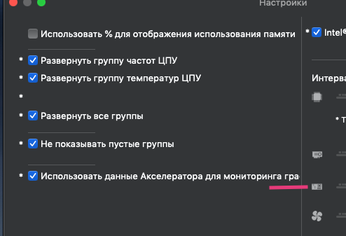

Andrey1970 Posted November 16, 2018 Share Posted November 16, 2018 8 minutes ago, vector sigma said: done. Russian translation, is cut off the end. Will be so shorter, but it is necessary to move slightly. "jea-Yr-Q5W.title" = "Использовать данные Акселератора для мониторинга ГПУ"; Link to comment https://www.insanelymac.com/forum/topic/299861-hwsensors3/page/55/#findComment-2648051 Share on other sites More sharing options...
vector sigma Posted November 16, 2018 Share Posted November 16, 2018 3 minutes ago, Andrey1970 said: Will be so shorter, but it is necessary to move slightly. I'll made it larger for the next commit. For next times can we use the topic here. 1 Link to comment https://www.insanelymac.com/forum/topic/299861-hwsensors3/page/55/#findComment-2648054 Share on other sites More sharing options...
mbrettweigel Posted November 16, 2018 Share Posted November 16, 2018 (edited) 6 hours ago, vector sigma said: Sure, this will of big help! Anyway I would like to take a look to your ioreg since looks like the the key kIOPropertyMediumTypeKey is missing, and w/o that I cannot recognize if the disk is a hdd or ssd. Here is a copy of my ioreg... iMac.zip 5 hours ago, vector sigma said: @mbrettweigel, try this: HWMonitorSMC2.app_2.4.1_media_type_test.zip. Should at least not crash, unless something else is missing again. This ran without crashing, that's a good thing. Edited November 16, 2018 by mbrettweigel Link to comment https://www.insanelymac.com/forum/topic/299861-hwsensors3/page/55/#findComment-2648067 Share on other sites More sharing options...
mbrettweigel Posted November 16, 2018 Share Posted November 16, 2018 5 hours ago, vector sigma said: Sure, this will of big help! Anyway I would like to take a look to your ioreg since looks like the the key kIOPropertyMediumTypeKey is missing, and w/o that I cannot recognize if the disk is a hdd or ssd. Could this be related to a mis-interpretation of a Fusion drive? Just a thought. Link to comment https://www.insanelymac.com/forum/topic/299861-hwsensors3/page/55/#findComment-2648069 Share on other sites More sharing options...
mbrettweigel Posted November 16, 2018 Share Posted November 16, 2018 (edited) 8 hours ago, vector sigma said: Sure, this will of big help! Anyway I would like to take a look to your ioreg since looks like the the key kIOPropertyMediumTypeKey is missing, and w/o that I cannot recognize if the disk is a hdd or ssd. It appears "private func getMediumType(..." may be choking on externally connected USB drives. I stepped through in debug mode and as soon as I encountered the drive that is my external USB (Backup) drive the function crashed. This particular USB drive has no "Medium Type" characteristic. Also "private func isSolidSate(..." fails for the same conceptual reason. I'm no familiar enough with Swift or Xcode to fix it. I'm not a Swift developer but I corrected the issue for myself (note that this is for my educational purposes). I'm certain this isn't exactly right and there is almost certainly a much more elegant way to do handle this use case scenario but here are my edits: private func getMediumType(characteristics : NSDictionary) -> String { guard let _ = (characteristics.object(forKey: kIOPropertyMediumTypeKey) as? String) else { return "EXT" } if (characteristics.object(forKey: kIOPropertyMediumTypeKey) as! String) == kIOPropertyMediumTypeSolidStateKey { return "SSD" } return "HDD" } private func isSolidSate(characteristics : NSDictionary) -> Bool { guard let _ = (characteristics.object(forKey: kIOPropertyMediumTypeKey) as? Bool) else { return false } if (characteristics.object(forKey: kIOPropertyMediumTypeKey) as! String) == kIOPropertyMediumTypeSolidStateKey { return true } return false } Edited November 17, 2018 by mbrettweigel Link to comment https://www.insanelymac.com/forum/topic/299861-hwsensors3/page/55/#findComment-2648081 Share on other sites More sharing options...

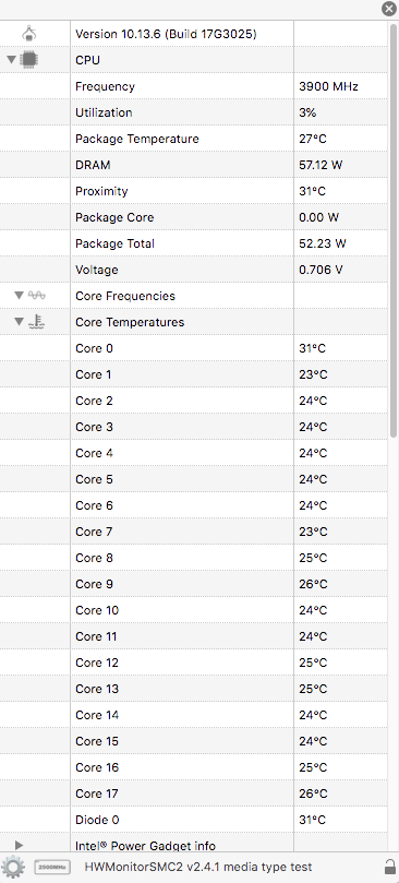

thenightflyer Posted November 17, 2018 Share Posted November 17, 2018 Hi vector...only today i had time to try HWMonitorSMC2.app_2.4.1 and unfortunately it shows only 16 of my 18 cores CPU...the previous releases were ok, infact the last i used was HWMonitorSMC2.app_IPG_optional and it shows all 18 cores temp. Link to comment https://www.insanelymac.com/forum/topic/299861-hwsensors3/page/55/#findComment-2648122 Share on other sites More sharing options...
