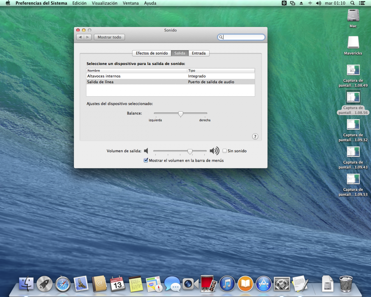

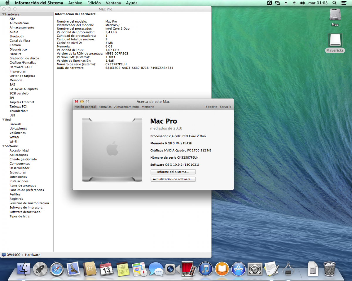

Benjudas Posted May 12, 2014 Share Posted May 12, 2014 I know that this can be an obsolete machine (now I'm XW8600 owner), but this has been my desktop for years, and maybe it can be interesting for some user, so I gonna post how I get this PC running Maveriks 10.9.2. Everything is working, Sleep waking from USBs, CPU Power Management, SpeedStep (Intel Core 2 E6600), Graphics with AGPM (Nvidia Quadro FX1700), Audio with patched AppleHDA (All in-outs even Internal Speaker), Lan (Sleep working thanks to SleepWatcher 2.2), SATA and PCI Firewire card injected thru DSDT. First, I would like to say that my DSDT was edited by me, and I'm not an expert, so use it at your own risk. I did my best. It's very simple, change in Bios settings Sata Mode to ACHI, and install with ##### 10.9.1 and combo update to 10.9.2. Reboot from USB and install AppleHDA, IONetworkingFamily, AppleTyMCEDriver and FakeSMC with kextutility. Original AppleTyMCEDriver.kext produces kernel panic if you use MacPro5,1 smbios.plist, so I created this one that is an empty file, just to prevent the kernel panic. If you use MacPro3,1 isn't needed. Create Extra folder in your HD root, create smbios and org.chameleon.Boot.plist with Chameleon Wizard and install Chameleon Bootloader. Copy inside Extra folder DSDT.aml file. I use MacPro5,1 smbios.plist to get AppleGraphicsPowerManagement.kext working, but if you want to get it, you will need to insert your graphics hardware id in the info.plist. In org.chameleon.Boot.plist you should check Use Kernel Cache, Ethernet Built In, and Restart Fix. In this machine I used a Apple keyboard, but if you want to use the original PS2 keyboard I include a folder with instructions for get it working. The network works with BCM722D.kext of Adlan, the problem is that after sleeping no network. I have solved this with SleepWatcher 2.2 and editing these scripts: rc.sleep: sudo ifconfig en0 down sudo kextunload /System/Library/Extensions/IONetworkingFamily.kext/Contents/PlugIns/BCM5722D.kext rc.wake: sudo kextload /System/Library/Extensions/IONetworkingFamily.kext/Contents/PlugIns/BCM5722D.kext sudo ifconfig en0 up And that's all folks!!! Thanks again to everyone that make this possible. Sorry about my english. HP XW4400 10.9.2.zip Link to comment https://www.insanelymac.com/forum/topic/297989-mavericks-1092-on-hp-xw4400/ Share on other sites More sharing options...
