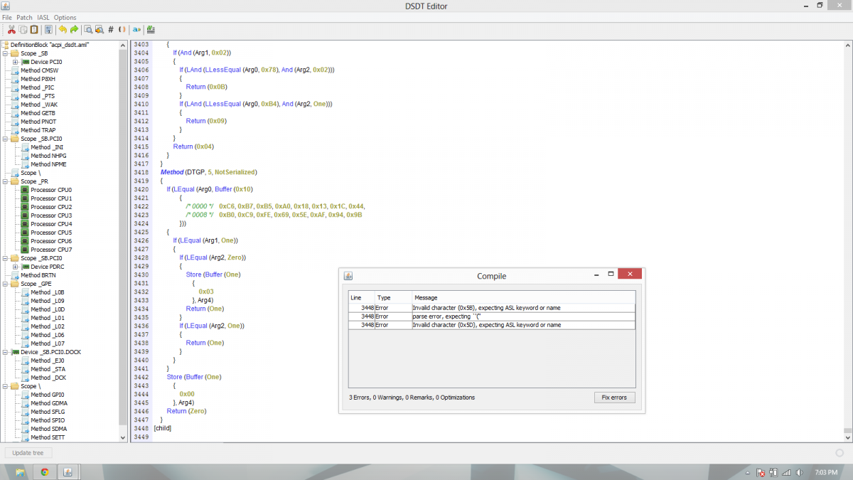

For the benefit of others, the original topic was from here.  Start off from your native DSDT.aml where there were only 2 errors and fix them manually through DSDT Editor like I said in post #72.
You need to carefully read the links I have already provided - see artur-pt's post on enabling HD3000 requires "dual link" property to be inserted in your DSDT for resolutions greater than 1366x768.  To quote him "If you don't have any patch in dsdt, apply also DTGP".
Note: the first part of his post describes how to boot into Mavericks in non graphical "single user" mode to remove the Intel graphics kexts from /System/Library/Extensions to enable you to boot into Mavericks with VESA graphics.  You can do the same thing with transmac (make backup copy first with "copy to" command):
If you are unable to compile the DSDT without errors, please upload your native (unedited) DSDT.aml from AIDA64 in zip format for others to look at.....

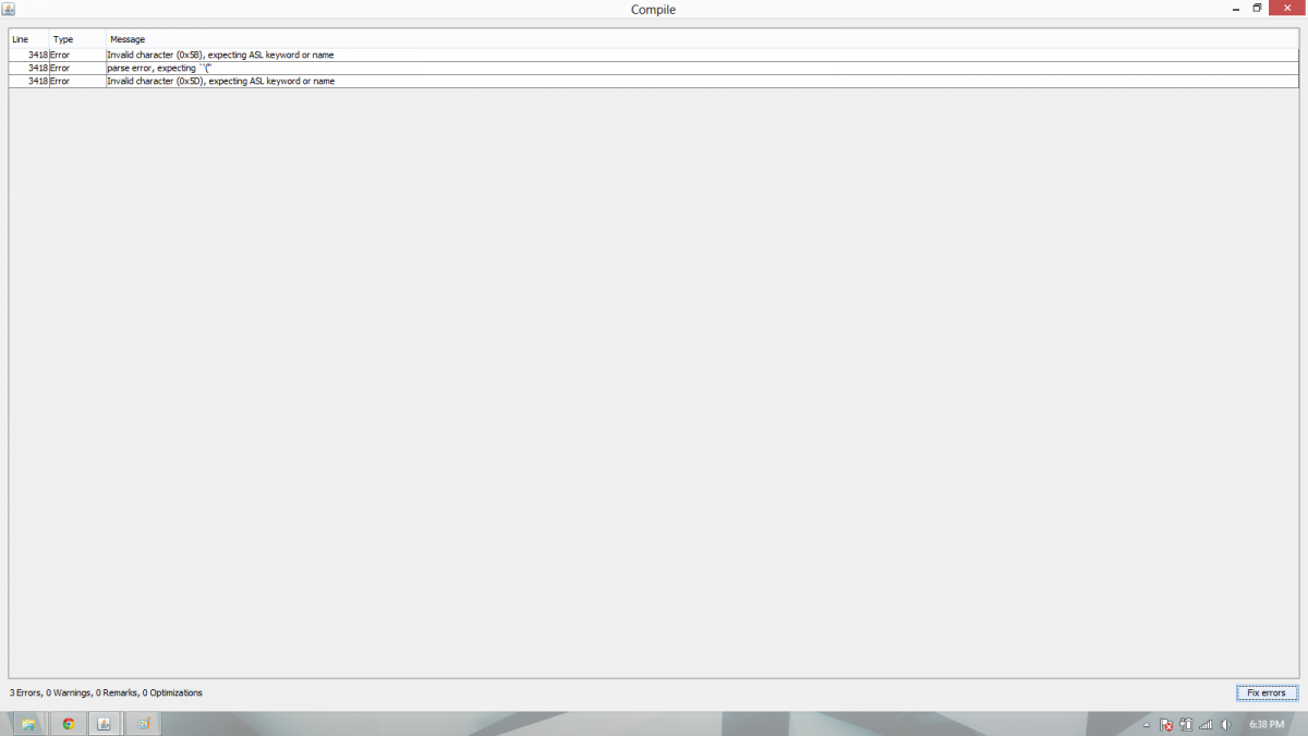

Ok so I applied the dual link patch thing and the DTGP patch. But I still have errors. I am not able to "Save AML as..." because I cannot get past these errors. After applying the two patches and here are the errors:

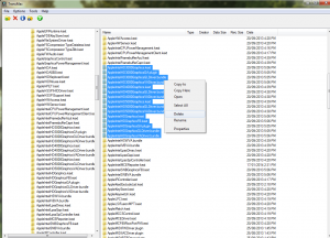

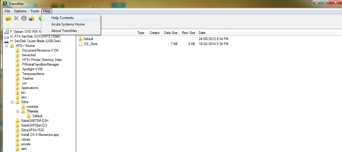

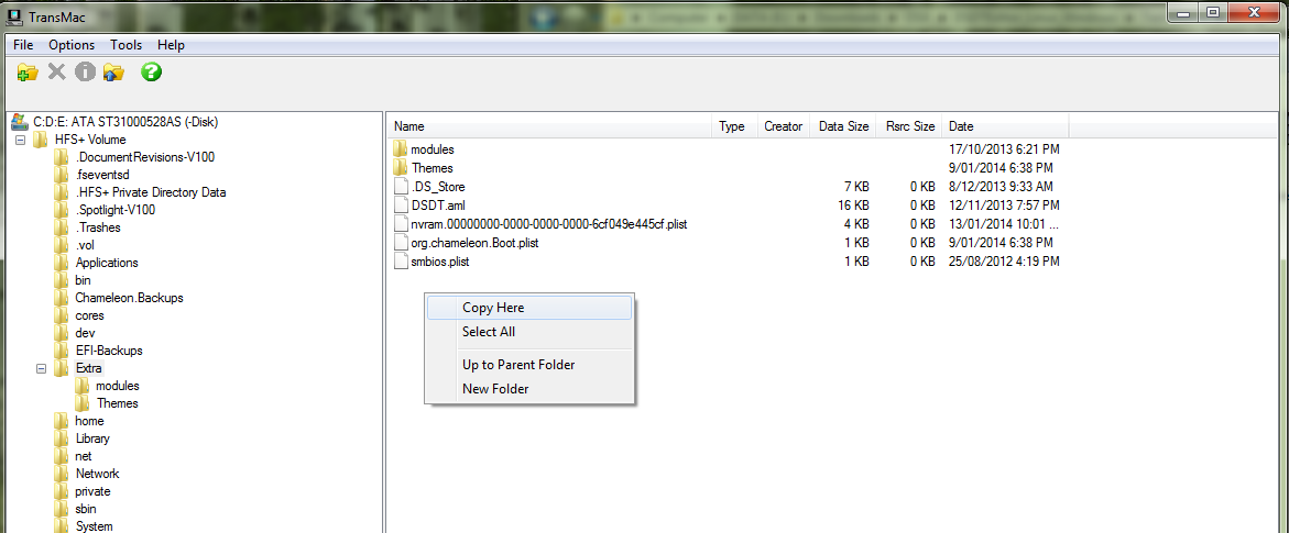

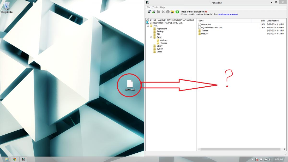

ok so I cannot drag and drop the DSDT.aml file that artur-pt provided for some reason. It is not letting me. Am I doing this right? Sorry for these simple questions. I am just very new to this and I am surprised that I actually got this far. Here is the screenshot:
You have the right idea but...
At the risk of sounding like a broken record, google is your friend and you need to learn to use it more.  Search "transmac to write files to hfs" and you get results like this.  You need to use the transmac file manager window to copy over the file to the Mavericks partition (it doesn't support drag and drop from Windows Explorer).
Edit
Open transmac and have a look at the help menu...
From the quick start guide
Copying files from the PC to a Mac volume:
  • Select a drive in the treeview pane and click on a Mac volume.
  • Browse to where files are to be copied.
  • Drag files from a File Explorer window or other drag source to the listview pane. (An alternate way is to right-click an open area in the listview pane and select "Copy here")
Alternatively, boot into Mavericks in single user mode and use terminal commands as described in Artur's linked post.

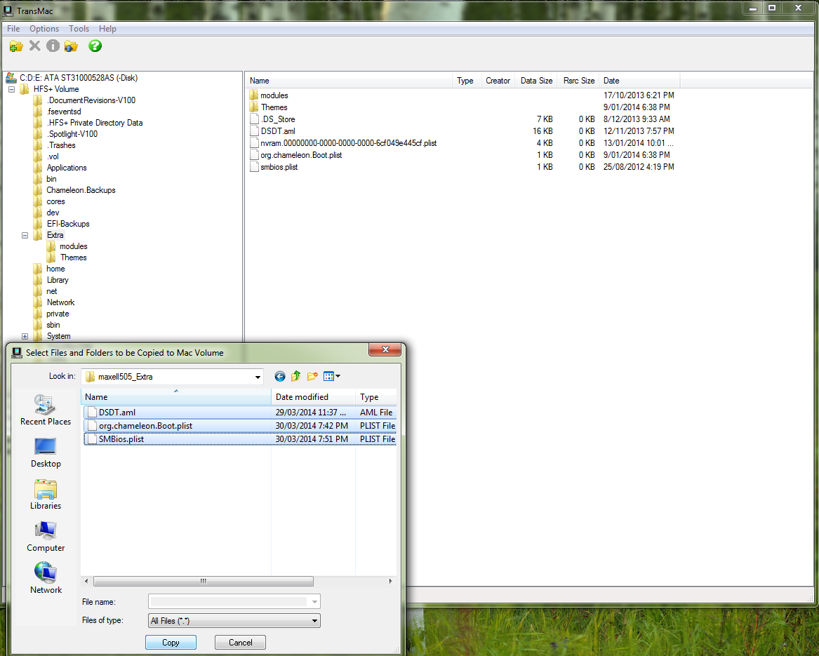

artur just stated he patched your DSDT with the dual link patch so I guess the answer is..........YES!!!!!
He kindly added some other useful patches for good measure.  Now copy his DSDT.aml, SMBIOS.plist for MBP 8,1 and a basic org.chameleon.boot.plist (attached inside "maxell505_Extra.zip") into the Mavericks /Extra folder & try booting with -v -f flags.
maxell505_Extra.zip
Alternatively, boot into Mavericks in single user mode and use terminal commands to copy DSDT.aml into the /Extra folder....google
"OSX single user mode" & "how to use OSX terminal commands to copy a file" before you ask here.....
He kindly added some other useful patches for good measure.  Now you will need to make sure the SMBIOS.plist in /Extra is for MBP 8,1, boot your machine and cross your fingers/pray to the hackintosh gods :D.

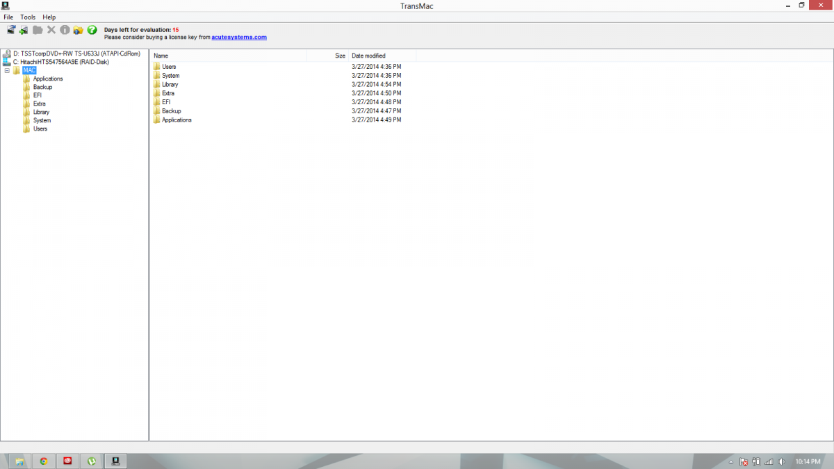

Sorry I am just not good with terminal stuff so I decided to go the transmac way. The only problem is that when I click on my hard drive with the Windows and Mac partition on it, it only shows the Mac one. I cannot access the Windows one at all. Please help.
EDIT: I cannot find anything on google.

I just do not understand how to copy the dsdt.aml file onto the /extra folder on the Mac osx partition on my computer
Can I use this?
http://www.paragon-software.com/home/hfs-windows/

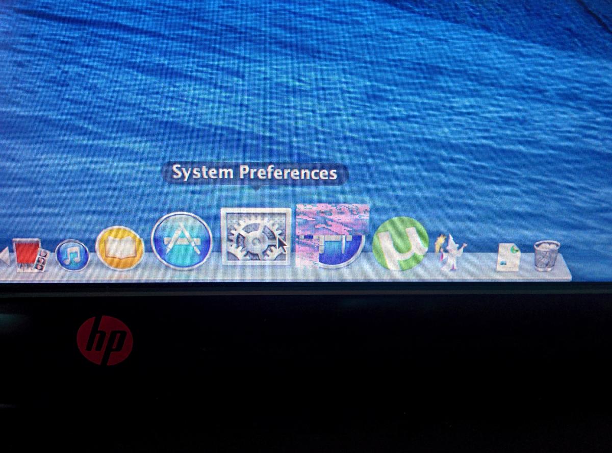

 Thank you. I just had one more question. I don't know if a kext would be able to solve this, but I am having this problem where things are just glitching if I hover over them with my cursor or if I select them and try to move them. I have attached a picture of an example of it.

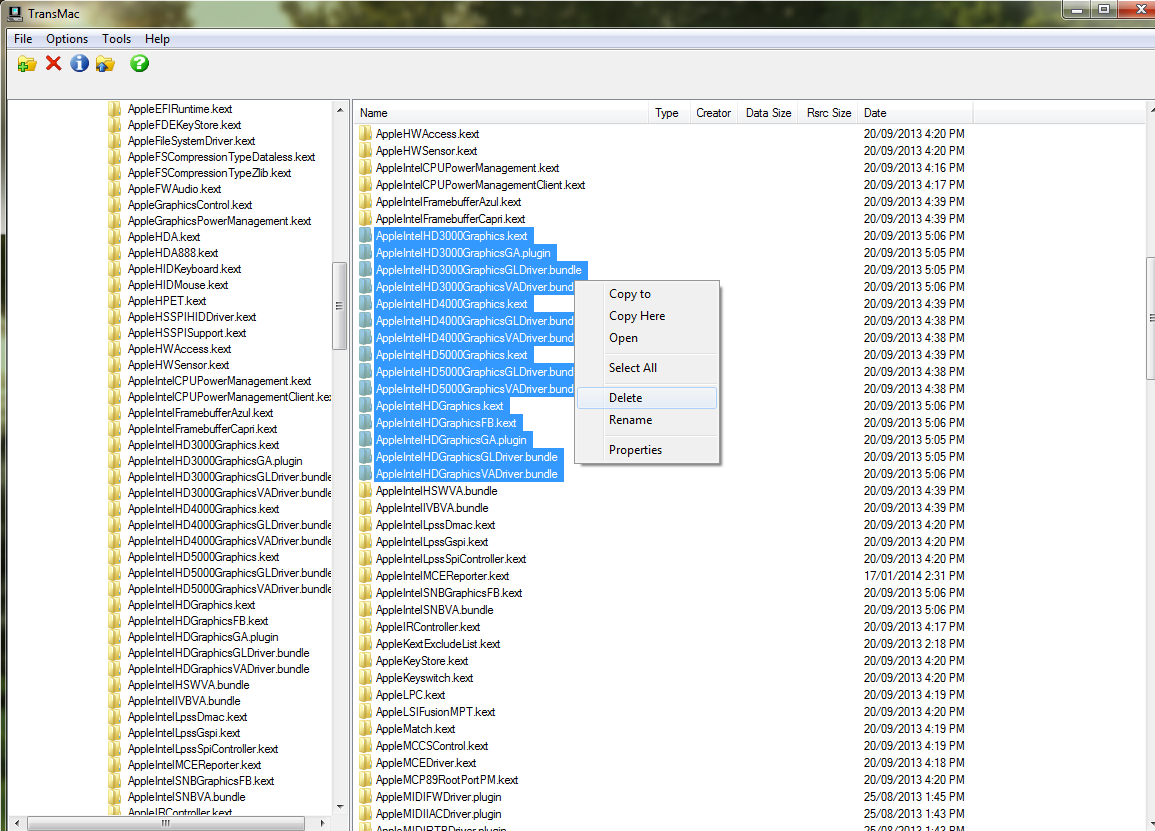

EDIT: Also I installed many kexts using Mxxxxbeast and I want ot get rid of them so I can do a fresh install. I also installed many through kext wizard. How can I remove all of the kexts I have installed so I can start fresh
Unfortunately, you will probably have to live with the occasional graphical glitch in OSX (google "OSX HD3000 graphical glitches").  I don't think I have seen any reliable solution for Intel HD 3000 beyond artur-pt's guide.
Re uninstalling kexts
I would strongly recommend you backup/clone your working Mavericks install onto an external USB hard drive first before you do any further tinkering - better to be safe than sorry...

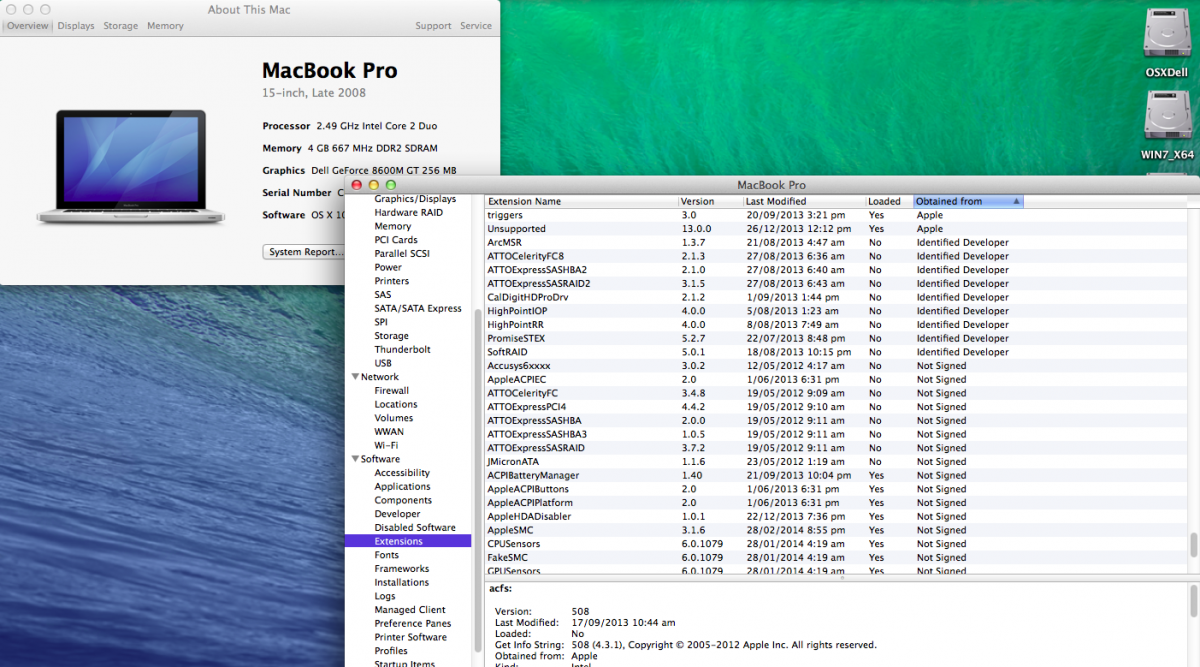

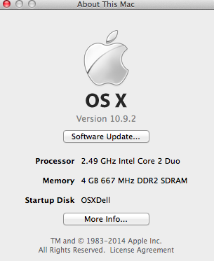

To find out which third party kexts you have installed and loaded, click the Apple menu--->About This Mac--->More Info--->System Report---->Extensions

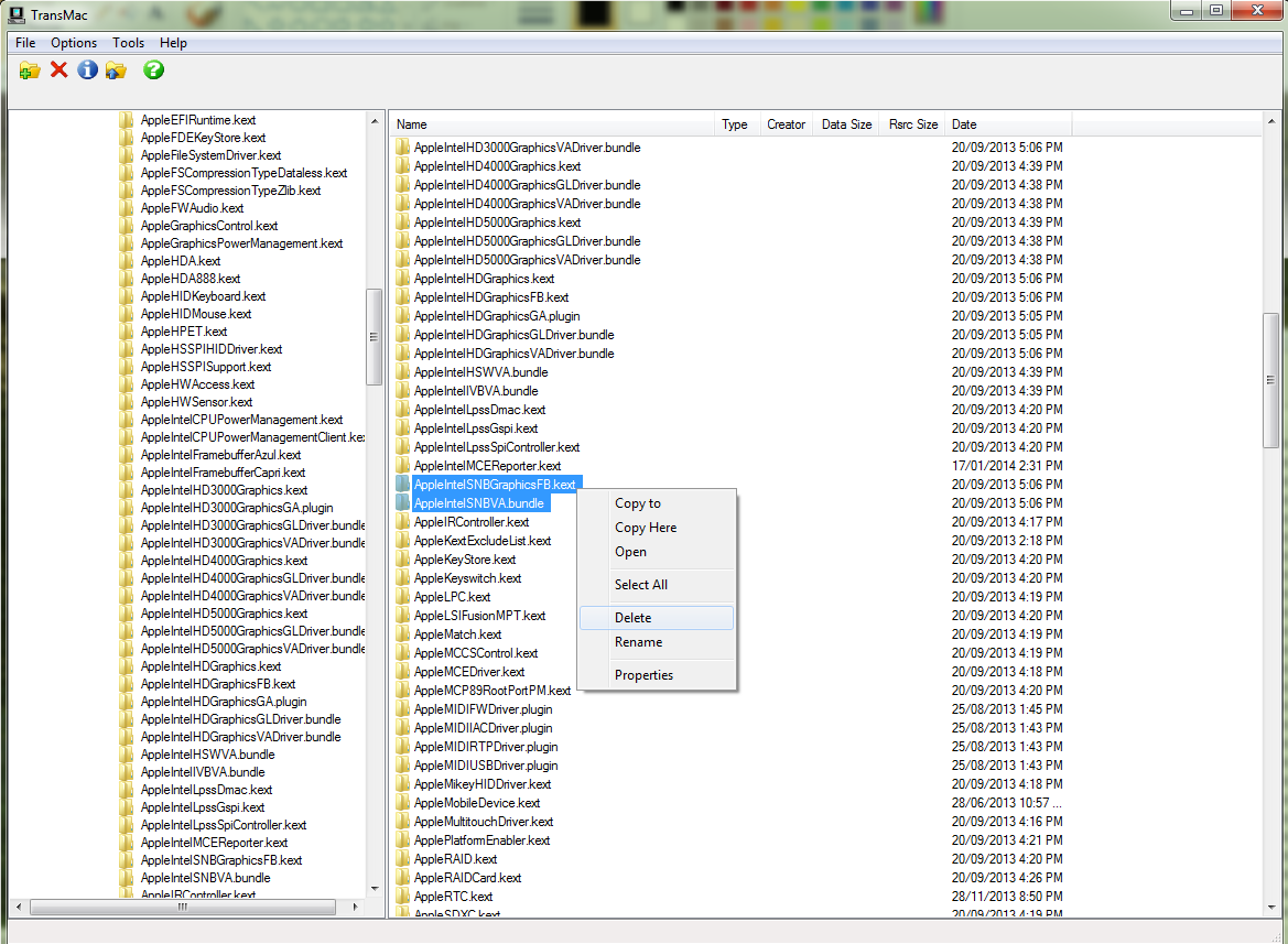

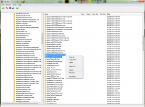

You can delete individual kexts in S/L/E using Finder but make a backup somewhere first.  The non apple kexts are usually unsigned and it is usually OK to delete the ones that are not loaded.  Google the name of the kext to find out its purpose before finally hitting the delete button!  Also make sure not to delete FakeSMC.kext (it is the only mandatory kext for hackintoshes).

Unfortunately, you will probably have to live with the occasional graphical glitch in OSX (google "OSX HD3000 graphical glitches").  I don't think I have seen any reliable solution beyond artur-pt's guide.
You can delete individual kexts in S/L/E using Finder but make a backup somewhere first.  The non apple kexts are usually unsigned and it is usually OK to delete the ones that are not loaded.  Make sure not to delete FakeSMC.kext (it is the only mandatory kext for hackintoshes).
Thank you so much for all of your help. I will first erase all of the kexts and than I will start over by individually installing kext for everything that I need them for. Thank you so much for your help. Can I just post on this topic so you could help me if I need any further assistance?
