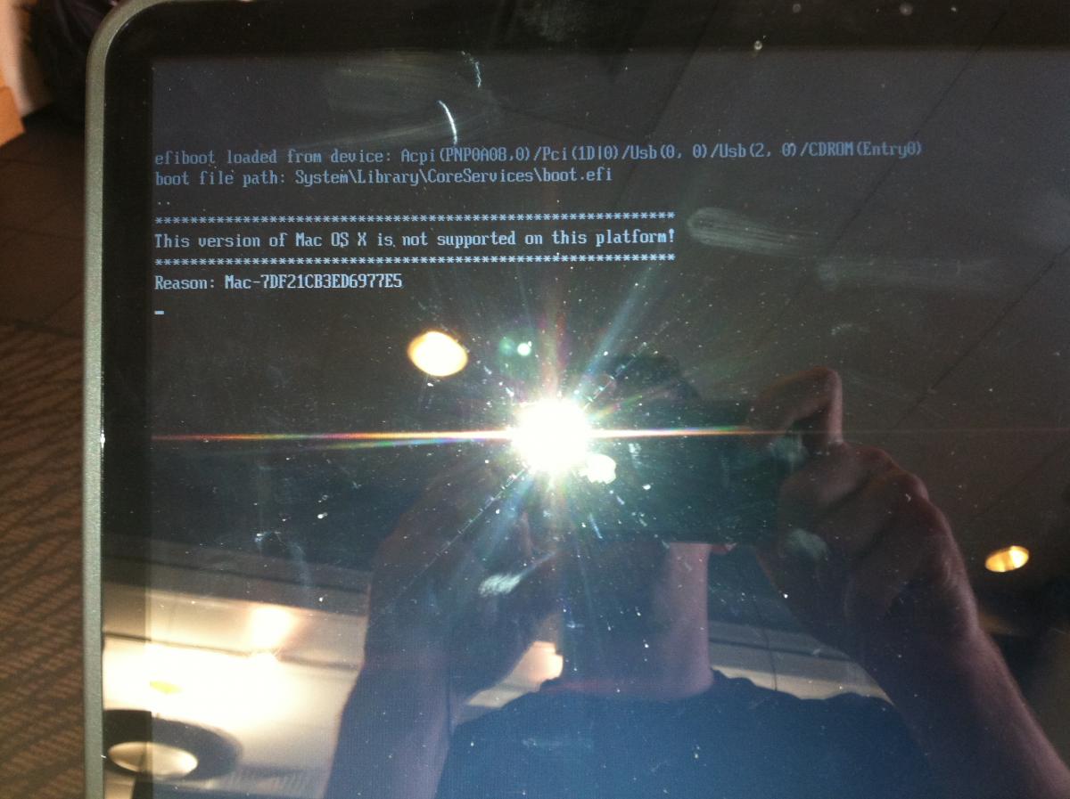

conedmiro Posted March 5, 2014 Share Posted March 5, 2014 First off, I'll start by saying the last hackintosh I built was on an OG Dell Inspiron 15, back when you could use iAtkos, boot to it, and it'd ask what .kexts you wanted to install, so lo and behold, the new Clover boot to Just run the iAtkos ML2 USB I created because of my motherboard got me to do a bit of reading. Specs, let's start here: Video is Intel HD4400 seriesOS Name Microsoft Windows 8.1 ProVersion 6.3.9600 Build 9600Other OS Description Not AvailableOS Manufacturer Microsoft CorporationSystem Name -----System Manufacturer Dell Inc.System Model Inspiron 5537System Type x64-based PCSystem SKU Inspiron 5537Processor Intel® Core i5-4200U CPU @ 1.60GHz, 2301 Mhz, 2 Core(s), 4 Logical Processor(s)BIOS Version/Date Dell Inc. A06, 9/27/2013SMBIOS Version 2.7Embedded Controller Version 1.01BIOS Mode UEFIBaseBoard Manufacturer Dell Inc.BaseBoard Model Not AvailableBaseBoard Name Base BoardPlatform Role MobileSecure Boot State OnPCR7 Configuration Binding Not PossibleWindows Directory C:\WINDOWSSystem Directory C:\WINDOWS\system32Boot Device \Device\HarddiskVolume1Locale United StatesHardware Abstraction Layer Version = "6.3.9600.16500"User Name -----Time Zone Eastern Standard TimeInstalled Physical Memory (RAM) 6.00 GBTotal Physical Memory 5.88 GBAvailable Physical Memory 3.46 GBTotal Virtual Memory 6.82 GBAvailable Virtual Memory 3.90 GBPage File Space 960 MBPage File C:\pagefile.sysHyper-V - VM Monitor Mode Extensions YesHyper-V - Second Level Address Translation Extensions YesHyper-V - Virtualization Enabled in Firmware YesHyper-V - Data Execution Protection Yes Now I have 2 USBs, one containing Clover with a modified config.plist to contain this code from the smbios.plist for a newer MacBook, that I edited to work with the config.plist file according to the clover how to guide <dict><key>UUID</key><string>E031D30A-DBCD-5AD5-90F1-641F7987DF56</string><key>BiosVendor</key><string>Apple Inc.</string><key>BiosVersion</key><string>MBP81.88Z.0047.B04.1102071707</string><key>BoardManufacturer</key><string>Apple Computer, Inc.</string><key>BoardProduct</key><string>Mac-94245A3940C91C80</string><key>Family</key><string>MacBook Pro</string><key>Manufacter</key><string>Apple Computer, Inc.</string><key>Manufacturer</key><string>Apple Inc.</string><key>MaximalClock</key><string>2.30</string><key>MemManufacturer_1</key><string>Samsung</string><key>MemManufacturer_2</key><string>Samsung</string><key>MemSpeed</key><string>1333</string><key>MemType</key><string>24</string><key>ProductName</key><string>MacBookPro8,2</string><key>Serial</key><string>123456789012</string></dict> Because the original 'smbios' clover was seeing was giving me the error: [see attachments as well] and the internal smbios within clover is still defaulting to the MacBook6,2 which is not allowing me to even boot into the disk. [see attachments as well] Now I'm successfully running iAtkos ML2 upgraded to Mavericks in a VMWare Workstation - I tried creating a MyHacks bootable but every time I'd run the initial installer, it'd fail and reset within seconds, so now I'm lost. Any ideas on where to go from here? Link to comment https://www.insanelymac.com/forum/topic/296586-dell-inspiron-15r-5537-woes-issues-what-ive-done/ Share on other sites More sharing options...
dcai777 Posted March 5, 2014 Share Posted March 5, 2014 http://www.insanelymac.com/forum/topic/296469-noobs-guide-how-to-install-os-x-mavericks-from-scratch-in-progress/ look for the thing about "instant reboot haswell cpu" download the mach_kernel and replace it with the one in your os x install usb Link to comment https://www.insanelymac.com/forum/topic/296586-dell-inspiron-15r-5537-woes-issues-what-ive-done/#findComment-2000579 Share on other sites More sharing options...

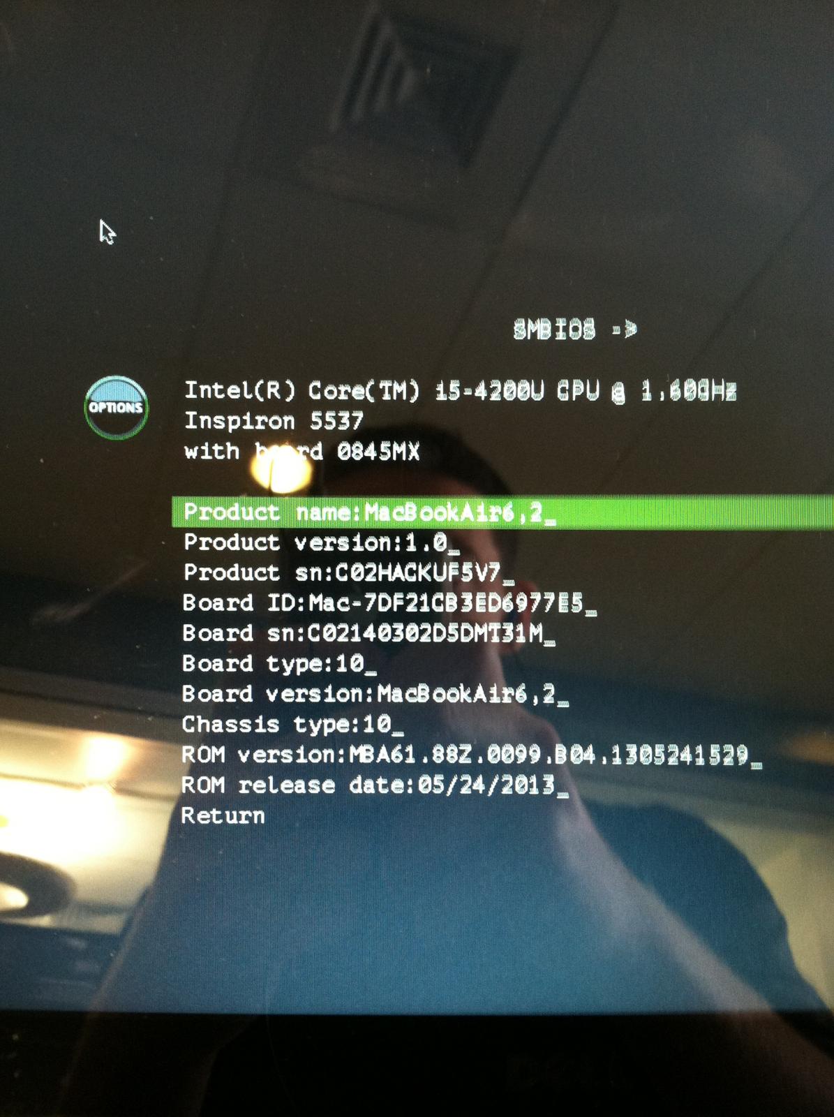

conedmiro Posted March 5, 2014 Author Share Posted March 5, 2014 after going into the smbios settings in Clover and manually changing them to MacBookPro8,2 and setting the board id manually,: -and- after replacing mach_kernel and then booting with the flags -x -f -v -s GraphicsEnabler=Yes UseKernelCache=No I got to this screen: which is funny because it says Voodoops2 etc isn't loaded, which I was pretty sure I had those kexts in there .... So then I changed the flags to -x -f -v -s GraphicsEnabler=Yes UseKernelCache=No ncpi=0x3000 And it took me as far as: Link to comment https://www.insanelymac.com/forum/topic/296586-dell-inspiron-15r-5537-woes-issues-what-ive-done/#findComment-2000625 Share on other sites More sharing options...
