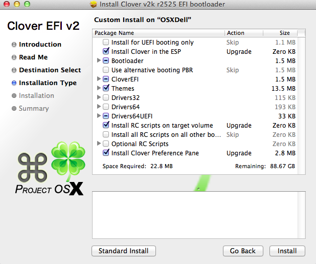

Imothep77 Posted February 3, 2014 Author Share Posted February 3, 2014 Here we go.... I decided to separate my project into 2 parts : install a fully working Mavericks on my laptop (Forgot to tell I'm currently using for the Mac stuff a VM with ML 10.8.2 installed on my desktop PC) Deal with the Multiboot part get the 3 OSs running together get the 3 OSs running together without needing an USB to boot (i.e installing a working bootloader on the HD) get the 3 OSs installed from the same USB stick. First things first: I don't think the Dell A15 Phoenix Firmware/BIOS (I just upgraded) supports UEFI, at least, there is no option about this in the BIOS settings. So I tried this: http://www.insanelymac.com/forum/topic/293925-non-uefi-guide-to-installing-os-x-mavericks-with-clover/ (really like the look & feel of Clover for those asking why not using a non-UEFI bootloader like Chimera/Charmeleon instead) But I'm stuck at the part where I need: to edit the config.plist. I really don't know what to put in there for my Dell... the SDST.aml file (cannot find that) I followed the guide step by step, except for the above 2 issues Installed clover bootloader into my USB key. I configured the EFI using this DSDT.aml file from: http://www.osx86.net/files/file/1557-dsdt-for-dell-studio-xps-1640/ When I boot from my USB and start the OS X Mavericks install (in verbose) I get a "cannot install because your system is not supported" message. Any thoughts? Link to comment https://www.insanelymac.com/forum/topic/295791-wip-dell-studio-xps-1640-triple-boot-macosx-109-mavericks-win-81-pro-linux/#findComment-1990955 Share on other sites More sharing options...

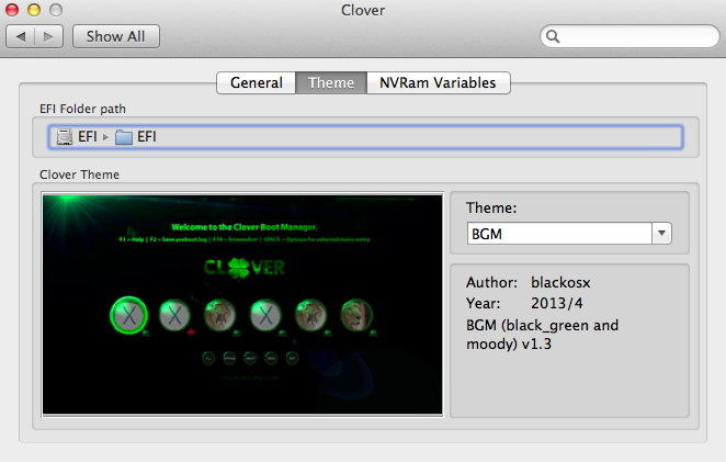

fusion71au Posted February 6, 2014 Share Posted February 6, 2014 @fusion71au (edited my signature btw ) Thank you mate... Now I can't wait to go home to test this !!! I'll edit my message to report success (hopefully) ... or ask more questions :-) --EDIT Used your config.plist ; I didn't copy my DSDT.aml into the EFI partition for now. Booting from Clover with injected kexts is now working and I get the "Welcome" screen (at - oh my God - the correct resolution!!!) but I'm still unable to use neither my touchpad nor my keyboard. Will try to load a voodoo kext and see what it gives. --EDIT Used the kext from here: http://forum.osxlatitude.com/index.php?/topic/1948-elan-touchpad-driver-mac-os-x/ Keyboard's now working but still no luck with the trackpad. So I copied all kexts from here: http://www.osx86.net/files/download/997-10-8-kexts-for-dell-studio-xps-16/ No more luck.... Actually I made a big mistake and left the old Elan ApplePS2Controller.kext instead of taking the one from the 2nd link just above... I now have both my trackpad and mouse working.... About to re-partition my hardrive and install Mavericks now, wish me luck... --EDIT 1 hour later... Mavericks is WORKING!!!!!!! No sound No WiFi No Bluetooth Video on webcam OK (launched Facetime & PhotoBooth) The system is SUPER fast (using a standard HDD) Hey... Installed Clover to my laptop's HDD, was working fine but still I needed to hit space and then choose "boot without cache with kexts injected". So I tried to continue and follow this guide: http://www.insanelymac.com/forum/topic/293574-beginners-guide-to-uefi-tripledual-boot-os-x-windows-and-linux-kali-on-an-single-true-gpt-ssd/ I installed the kexts (same as the ones I had on my USB "EFI/Kexts/10.9/" directory) to S/L/E using KEXT Wizard I also renamed my boot folder in my HDD EFI partition as suggested in the above guide. Now when I boot from my HDD, I get an error at boot, Clover is not even loaded... I tried to boot from the USB using the standard boot without cache with kexts injected but it freezes on an all grey screen until it displays some glinches... I'm stuck now and trying to manually remove kexts from the HDD. and rename back my boot folder to "boot"... using the USB installer. The problem was due the renamed boot folder - must have misunderstood the statement on the other guide. I used the USB installer again (Terminal --> mounted the USB/EFI partition --> renamed to 'boot') and restarded. NOW: Mavericks booting without even hitting a key!! Will try to resolve my audio / WiFi issues now, if someone has ideas, please drop them here. --EDIT Still no luck with audio when everybody says it's working... For me it is only able to play sound through one of my airplay compatible devices but not through the speakers ; no entry device detected either. Sound now working!!! I just used Clover configurator to change my SMBIOS settings... to MacBookPro 5.5 (instead of 7.1) For the Intel 5300 AGN WiFi Adapter, I think I'm gonna need to change my mini PCI-e card to another WLAN adaptor. I also figured out my Ricoh internal card reader is not working. Bluetooth still no working When the laptop goes to sleep, God, it's waking up SOOOOO damn fast, but I'm loosing the trackpad (keyboard OK) Inside Clover configurator, in the GUI tab, when I try to change the theme, nothing happens, I still get the same theme I installed when creating the EFI Clover partition on my HDD, whatever theme I chose eventhough I copied the themes in the EFI/Themes folder... Can someone please help? Try running the Clover installer on your HD again and make sure all themes are selected for install as well as the Clover Prefpane. After this, open the prefpane in System Preferences and choose the desired theme there.... Re Non Functional Devices: run System Info App (needs internet connection to access its database) and determine which kexts are available for your hardware - post by Cassio. Sound ---->try installing VoodooHDA.kext ver 2.8.4 from DarwinX's package with kext utility. Make sure to first delete AppleHDA.kext or install the HDADisabler to prevent kernel panics Bluetooth ----> have you tried DellBluetoothHCI.1.2.pkg from matty9119? If your card is Broadcom, try BroadcomAppleBluetooth.kext in DarwinX's package Ricoh internal card reader---->VoodooSDHC.kext may work but some people have reported it as buggy. Re Wifi: Cards based on Atheros AR5B91 & Broadcom BCM94321MC chipsets will work for all 3 OS. Re Sleep Issue: Try adding boot flag darkwake=0 to your config.plist (under boot tab if you open with Clover Configurator) or a different PS2Controller.kext. I can't guarantee either will work - sleep issues are notoriously difficult to diagnose & fix. Link to comment https://www.insanelymac.com/forum/topic/295791-wip-dell-studio-xps-1640-triple-boot-macosx-109-mavericks-win-81-pro-linux/#findComment-1991744 Share on other sites More sharing options...
