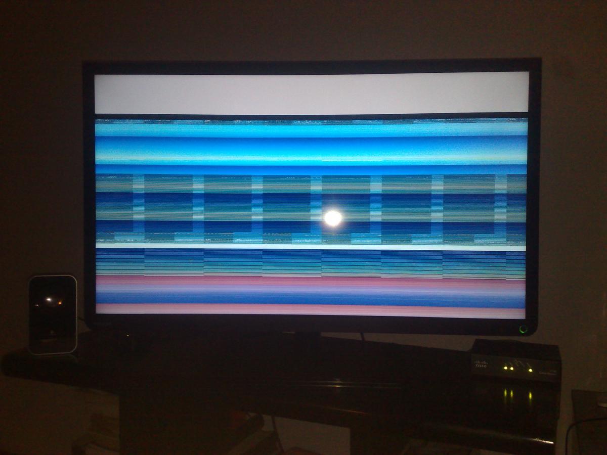

hiperborean Posted November 30, 2013 Share Posted November 30, 2013 Ok.. Created Installer Usb disk with MyHack 3.3, downloaded proper kernel etc etc.. Usb boots, no errors, and just after apple logo screen when it should show "Welcome and stuff" - graphics part of installer it shows picture like attached System is Athlon II X2 250 4gb ddr3 5670/512ddr5 /Redwood Monitor is Toshiba 32'' fullHD LedTV connected via HDMI I tried without any bootflags, and with GraphicsEnabler=Yes/No SkipAtiGfx=Yes/No, "GraphicsMode"=...... same results. I guess it has something to do with resolution/video mode of graphics installer, like it`s out of sync Link to comment https://www.insanelymac.com/forum/topic/294266-out-of-sync-or-what/ Share on other sites More sharing options...
tragediana150 Posted November 30, 2013 Share Posted November 30, 2013 Try to boot with -x (safe mode )and -v (verbose mode) What kernel are you using right now? What is your Extra kexts? You could try Clover instead of Chameleon. Good Luck Link to comment https://www.insanelymac.com/forum/topic/294266-out-of-sync-or-what/#findComment-1972579 Share on other sites More sharing options...
hiperborean Posted November 30, 2013 Author Share Posted November 30, 2013 I use generic MyHack Extra folder And kernel is: http://www.osx86.net/files/file/3649-kernel-os-x-mavericks-109-amd-20/ I`ll try more bootflags, and just found how to force EDID. Link to comment https://www.insanelymac.com/forum/topic/294266-out-of-sync-or-what/#findComment-1972598 Share on other sites More sharing options...
tragediana150 Posted November 30, 2013 Share Posted November 30, 2013 I use generic MyHack Extra folder And kernel is: http://www.osx86.net/files/file/3649-kernel-os-x-mavericks-109-amd-20/ I`ll try more bootflags, and just found how to force EDID. Maybe -blacklist and npci=0x2000 / npci=0x3000. I don't know which kernel it is :/ Try to use latest kernels of Bronya and Andy. 1 Link to comment https://www.insanelymac.com/forum/topic/294266-out-of-sync-or-what/#findComment-1972602 Share on other sites More sharing options...
hiperborean Posted November 30, 2013 Author Share Posted November 30, 2013 Maybe -blacklist and npci=0x2000 / npci=0x3000. I don't know which kernel it is :/ Try to use latest kernels of Bronya and Andy. Will try! Link to comment https://www.insanelymac.com/forum/topic/294266-out-of-sync-or-what/#findComment-1972605 Share on other sites More sharing options...
hiperborean Posted November 30, 2013 Author Share Posted November 30, 2013 ok switched to Bronya latest rc4 fix.. Installer boots with same problem.. Dumped EDID - Have Inserted forced EDID in Overrides, but forgot to applay fix Applaying now Link to comment https://www.insanelymac.com/forum/topic/294266-out-of-sync-or-what/#findComment-1972621 Share on other sites More sharing options...
hiperborean Posted November 30, 2013 Author Share Posted November 30, 2013 Ok PciRoot=1 and npci=0x3000 and voila! Install went smothly, MyHack installed Chameleon, EE, an other automatic stuff. New problem now, Mac Os wont boot! -v shows me that it hangs at AppleRTC from EE directory.. Tried -blacklist -v -x -f npci=0x2/3000, PciRoot, UseKernelCache.... in all combos... Always stuck at AppleRTC.kext followed by reboot. Sugestions? Link to comment https://www.insanelymac.com/forum/topic/294266-out-of-sync-or-what/#findComment-1972654 Share on other sites More sharing options...
