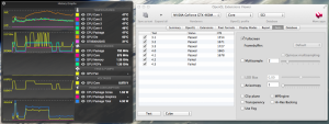

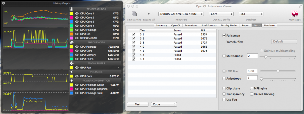

I'm not sure about AGPM but looks like it's working fine using threshold values from jeffc2009 in LegacyAGPM. Here are the test results
