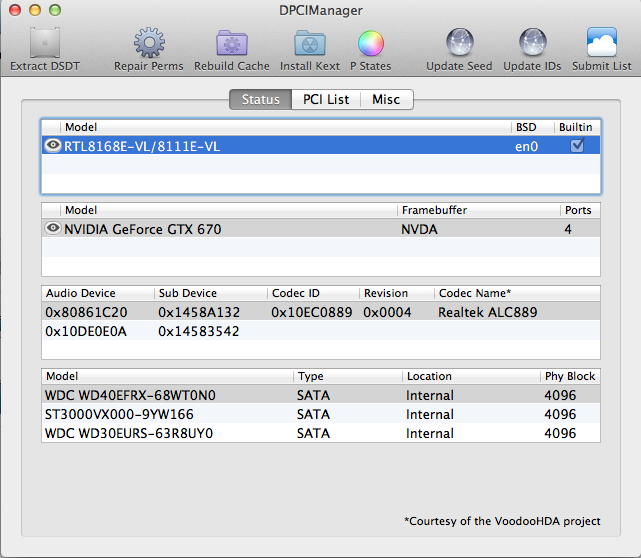

I have a short question. Under Mavericks 10.9.2 HD3000/6 Series MB HDMI Audio SSDT.aml UEFI did not work anymore under my Sandy Bridge Board. (No problems under .0 and .1) Now I have downloaded the UEFI SSDT.aml for HD4000/7 Series MB HDMI Audio and it works fine. Are there any problems if i use this 7 Series SSDT under my Sandy Bridge board? Thank you.
Confirmed. On my ga-z68xp-ud4 i have working 670GTX HDMI and ALC 889 with "audio_ssdt-hdmi-ami_hd4k-amd-nvidia-3_v5". HD3000 not tested till unused.

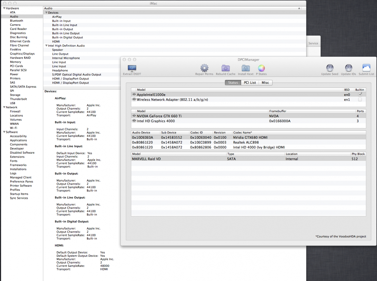

Different issues:
trivias, Award BIOS not AMI. Use audio_ssdt-hdmi-award_hd3k-amd-nvidia-3_v2
alenchev AMI 6/UEFI, Not AMI 7/UEFI.  Available in a day or so.
But it works. I have been attached DSDT and IOReg. If you interested.
