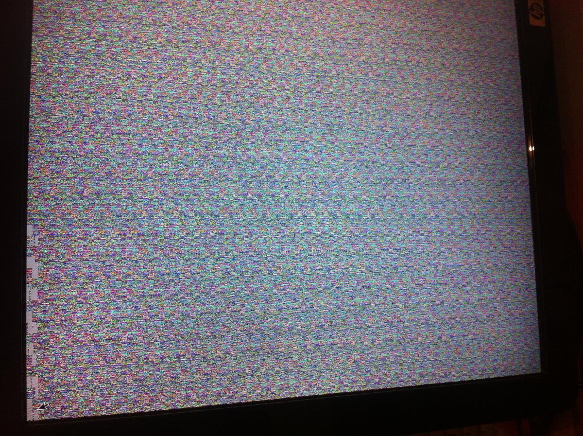

JCollins6695 Posted September 27, 2013 Share Posted September 27, 2013 Well installed 10.9 via myHack, the installation went smooth but post-intall I'm forced to boot with -x.I have resolutions in safe mode, and my GFX card is recoginized as the Intel 4000HD, but obviously I don't have QE/CI.I've not swapped kexts or anything of that nature, the only changes I have made are:System Definition change: Mac Mini 6,1Device Properties in Boot Plist (Since been removed, made no difference)Removed GraphicsEnabler Yes flag in Boot.plist as well, removing it didn't make a difference.Inserted a Custom DSDT downloaded from another forum, didn't help nor hurt anything.* I updated to DP2 via Apple Updater HOPING that would fix my issue, didn't help.BIOS is set to 32m (Although I've tried 96 and 64 as well)Celeron g1610Dev/ven [0152:8086]Aside from that everything has been left alone. I've attached a picture below that shows what I see when booting without safe mode.Any ideas? Link to comment https://www.insanelymac.com/forum/topic/292220-help-with-intel-hd-2500-on-ga-h61m-usb3h-dp2/ Share on other sites More sharing options...

JCollins6695 Posted September 27, 2013 Author Share Posted September 27, 2013 hello so my advice to u .. buy a cheap discrete graphics card.. that intel is ugly card.. like all intelhd is a poor graphics card .. no solution for nothing.. intel is cpu no graphics.. good hack Sounds rather foolish to ditch an integrated card so soon, that keep in mind is being recognized natively as far as resolutions and System Profiler are concerned. I mean if I wanted to take the easy route and just throw money at it, shouldn't I have just bought a mac in the first place? Anyways, as if it this isn't a given, the problem is within the acceleration aspect of AppleIntelHD4000.kext by nullifying it I can boot reguarly, but I obviously don't have any acceleration. I attempted editing the info.plist and changing the codecs from Gen7 to Gen6 (Because I have a 6 series setup, and for some reason with fouled logic I was hoping it may work)... yet it didn't. Link to comment https://www.insanelymac.com/forum/topic/292220-help-with-intel-hd-2500-on-ga-h61m-usb3h-dp2/#findComment-1949152 Share on other sites More sharing options...

theconnactic Posted September 30, 2013 Share Posted September 30, 2013 Your card is supported, but it's very very hard to get it working, and it won't ever work with VGA - you need either DVI or HDMI. If you're trying this with VGA, you're wasting your time (and ours, meaning nobody will help you). Otherwise, take a look here: http://www.insanelymac.com/forum/topic/287668-guide-intel-hd2500-full-resolution-and-qeci-1083/ All the best! Link to comment https://www.insanelymac.com/forum/topic/292220-help-with-intel-hd-2500-on-ga-h61m-usb3h-dp2/#findComment-1949679 Share on other sites More sharing options...
