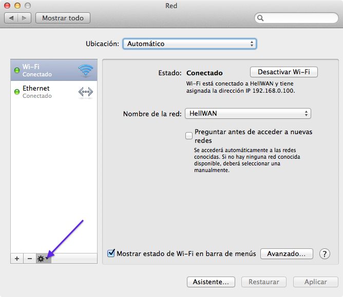

Maniac10 Posted August 29, 2013 Share Posted August 29, 2013 You may need to reorder your network connections from the "Network" pref pane. Just click here: And put the Wi-Fi on top. I have to do that every time I reset my network preferences, else the ethernet has a higher priority by default. I have the same model and mine works with just this DSDT addition, no need to edit any kext: Device (ARPT) { Name (_ADR, Zero) Name (_PRW, Package (0x02) { 0x09, 0x03 }) Method (_DSM, 4, NotSerialized) { Store (Package (0x0A) { "device-id", Unicode ("*"), "subsystem-vendor-id", Buffer (0x04) { 0x6B, 0x10, 0x00, 0x00 }, "name", "pci168c,2a", "compatible", Buffer (0x0B) { "pci168c,2a" }, "IOName", Buffer (0x0B) { "pci168c,2a" } }, Local0) DTGP (Arg0, Arg1, Arg2, Arg3, RefOf (Local0)) Return (Local0) } } 1 Link to comment https://www.insanelymac.com/forum/topic/291517-wifi-is-working-but-theres-no-internet/#findComment-1942048 Share on other sites More sharing options...
